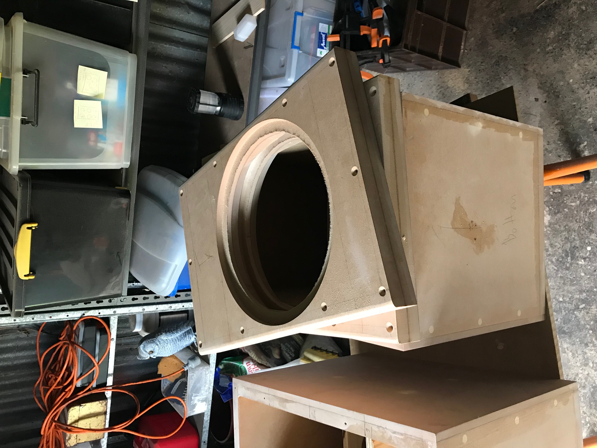

Update for Wright!!!
Have now finished both subs and wired in 1 * UcD400HG module. I'm out of room to lay the 2nd UcD400HG module without re-configuring the layout.
So at this stage running as a 2.1 setup which will have to persist for the minute.
With some qualitative testing, I'm crossing at 200Hz and sound is definitely better. I wont elaborate until i spend time tuning and measuring quantitatively.

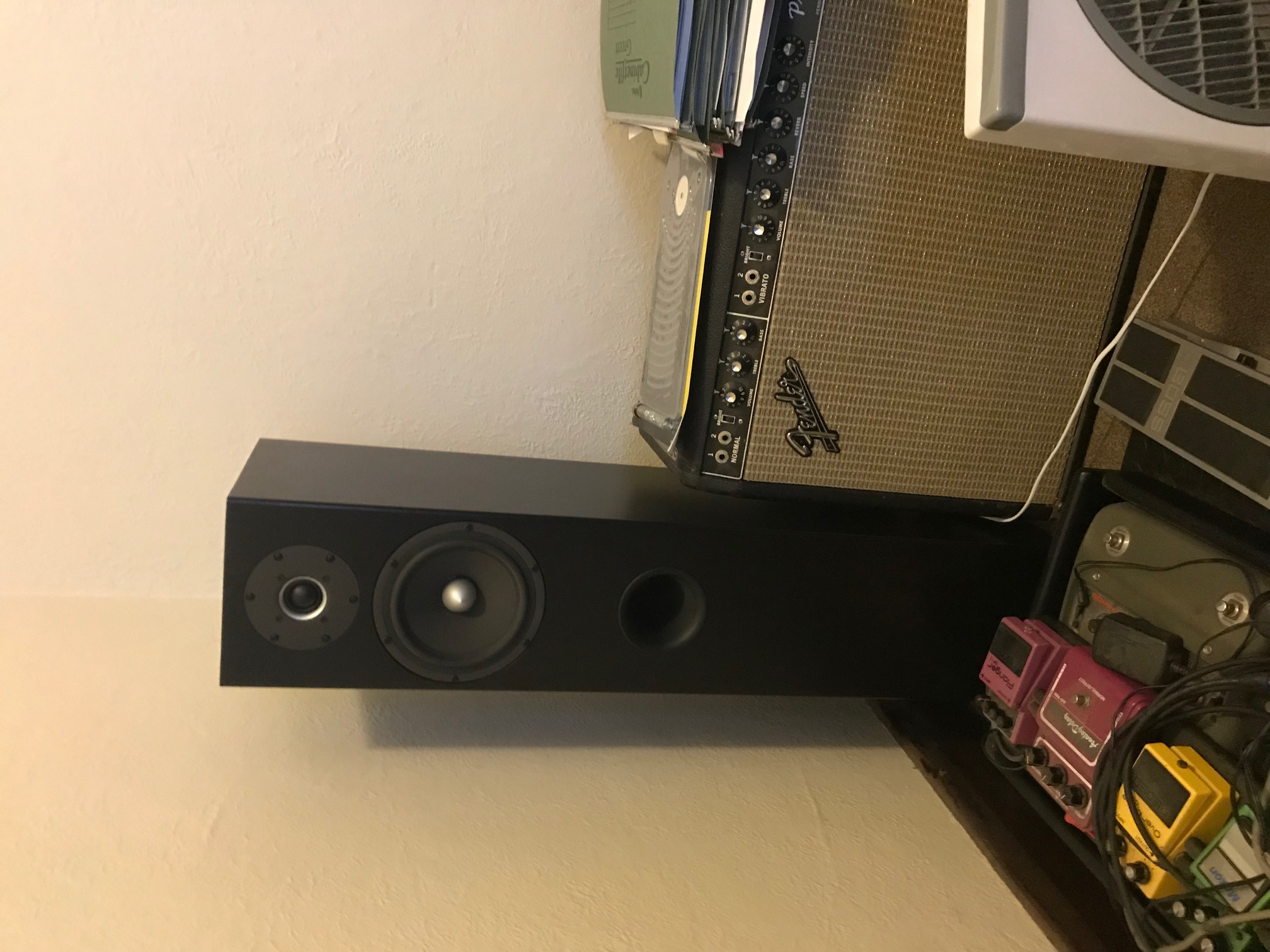

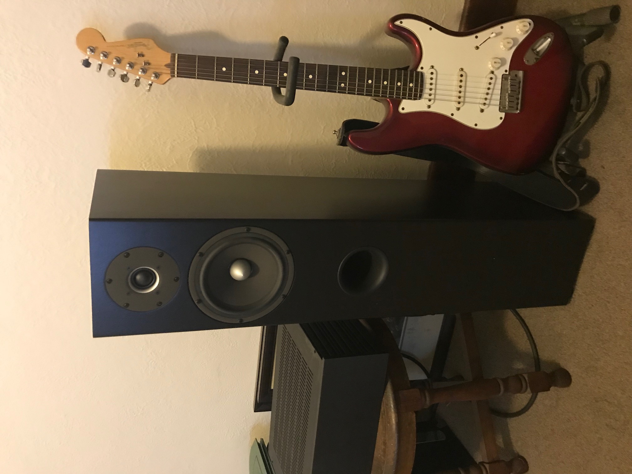

For the Speakers
  • Troels CNO-25 – pretty much to plan, but
    • Made out of MDF
    • Front baffle is 36mm slightly larger than plan but internal dimensions maintained. Why, I could glued 2 x 18mm sheets together.
  • Mod’s – since the plan was to actively bi-amp, have installed a 4 core Neutrik Speakon socket and wired with Van Damme 4 core pro series speaker cable (might not be the exact name)
  • Speakers – Woofer’s W18NX001 and Tweeter T29CF002. Why? Well whilst expensive wasn’t material in the overall project cost so thought why risk? Still don’t know if they are that much better than the SEAS T25CF001…but I’m not losing sleep over it.

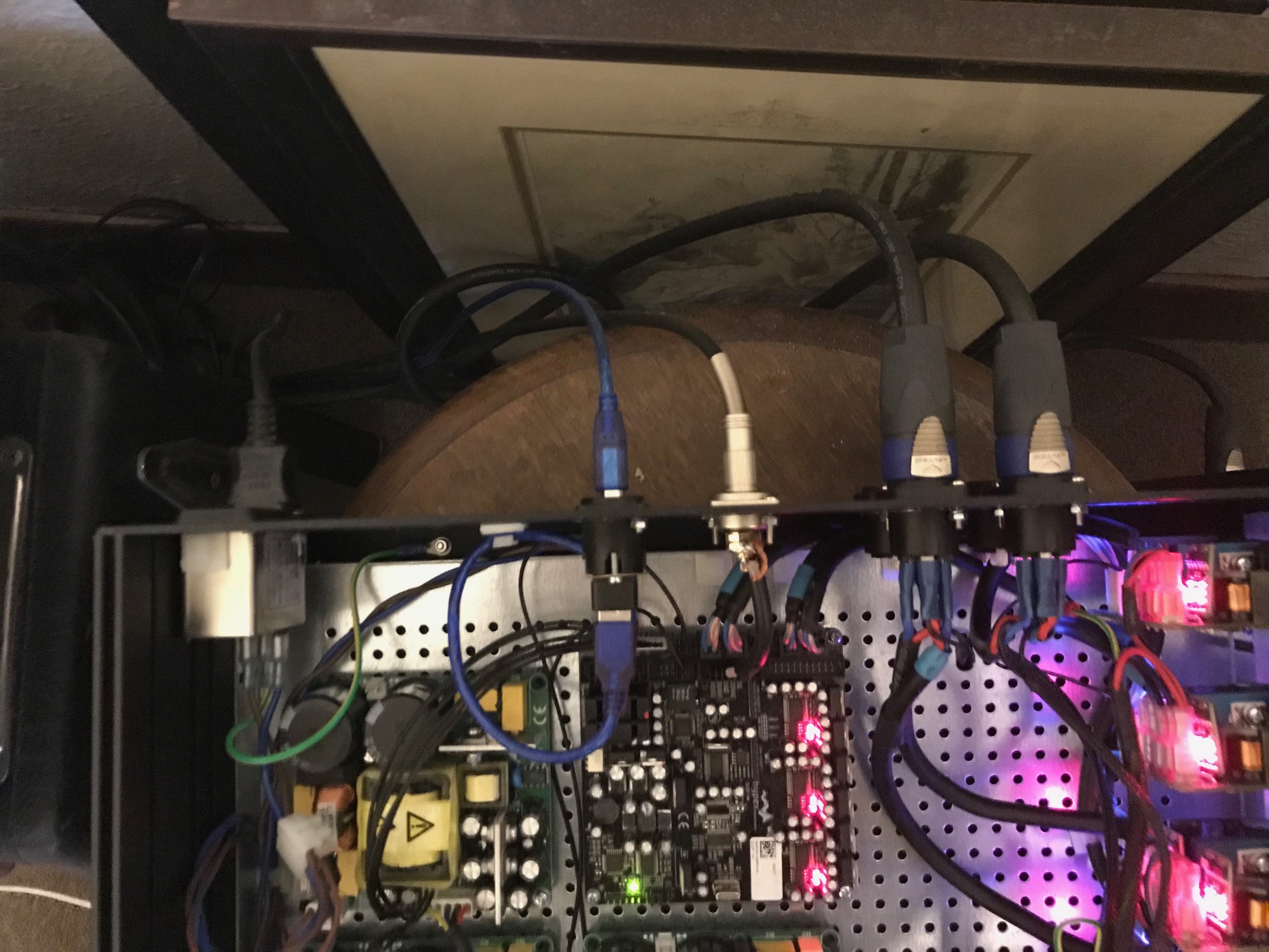

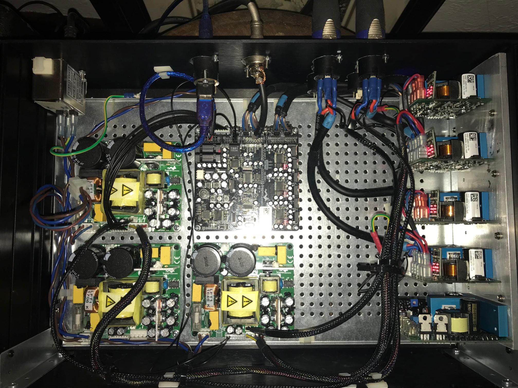

For the amp
  • 4 x UcD180 w/HxR’s to biamp the CNO-25’s. powered with 2 * SMPS400A180’s
  • On the DAC I went with the Hypex DLCP in the end (shift in direction). Why?
    • Simplicity – all in one solution for DSP and DAC, 6 channels for 2 * 3 way.
    • miniDSP – feedback is mixed, generally need a separate DAC solution if hi end
    • DLCP
      • Overall great product
      • USB input is only 16-48. Need to use SPDIF or AES for higher…really just a function of product life-cycle

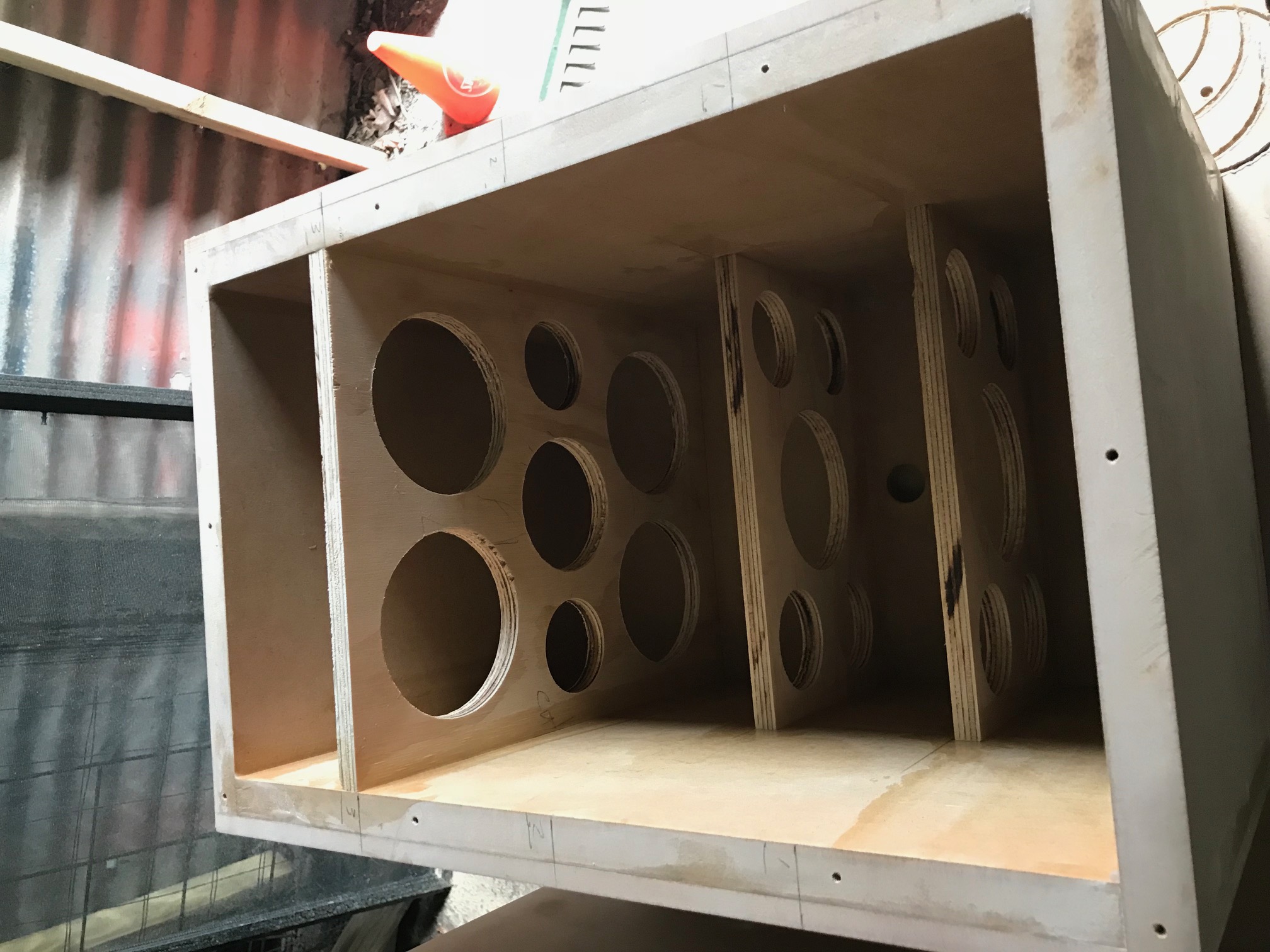

Plan for the Subs
  • I haven’t started the build but have parts ready to go
    • Will be Sealed SUB’s
    • 2 x SEAS L26ROY
    • 2 x UcD400’s to drive (I dropped the HxR on these as I understand no audible benefit as low frequencies). A SMPS400A400 to power
And the result
  • Overall I’m satisfied but looking to optimise a few things before I pass judgement.
  • As documented, Troel’s CNO designs can lack in bass response. I have found this to be the case if I crossover and do not apply room correction EQ.
    • Active EQ’ing changes this paradigm somewhat. Particularly when the DSP and DAC implementation are great (i.e. Hypex DLCP). Having said that, at loud volumes and the mood confirms would be good to have a bit more bottom end on tap to move some air...
    • The Sub’s I have planned will address this. When I get there it will be interesting as to where to cross the SUB’s and the CNO’s i.e. how low do I want the Sub’s to go??? How much lower mid to pass to CNO woofer’s etc. So many possibilities.
