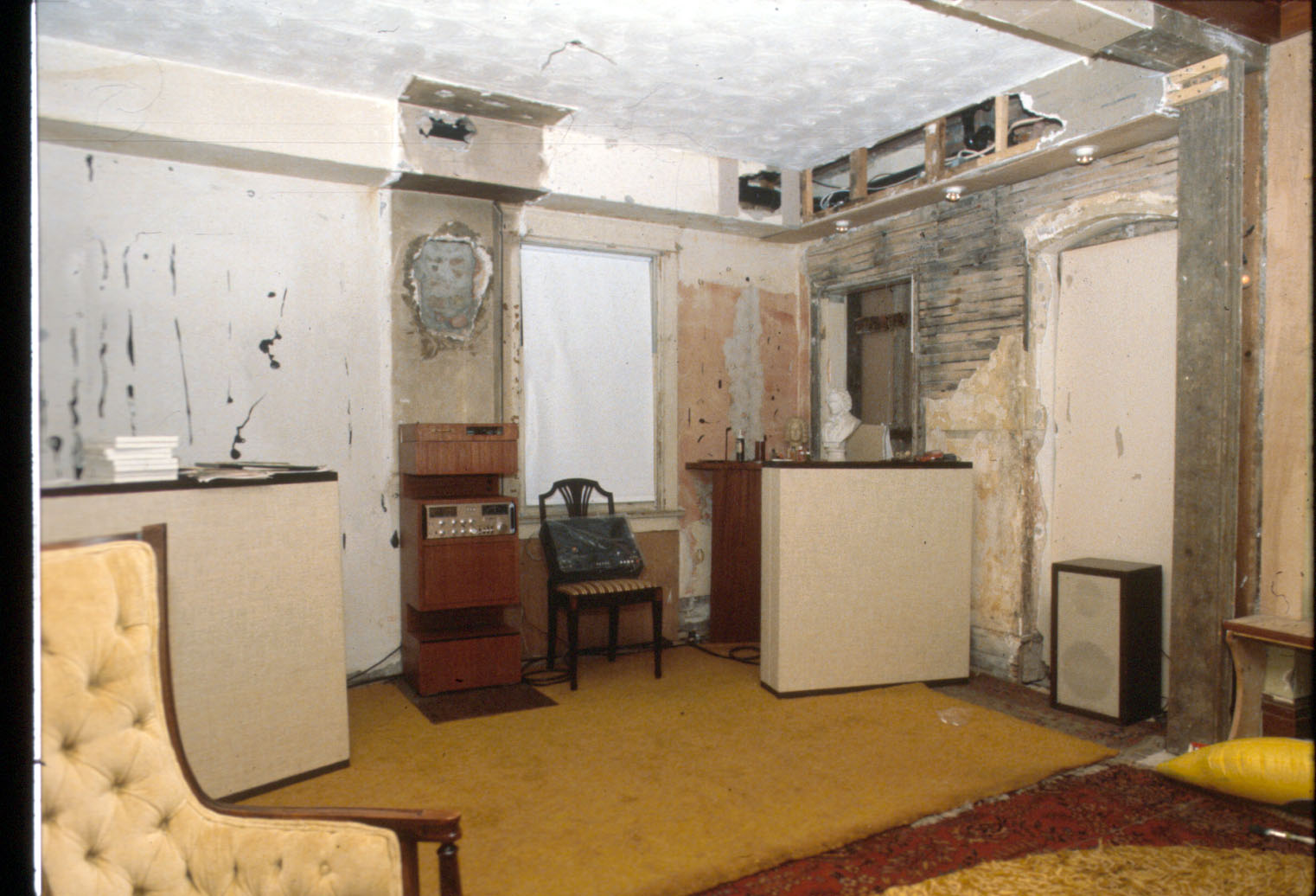

Yeah, wish I still had that beautiful beamed ceiling music room. Some folks from the Toronto audio club might remember it... and my high-voltage direct-drive-amp Dayton-Wright electrostatics. Here's a look during renovations. The doorway between the Klipschhorn bass and the ESLs became a sealed enclosure for 9 drivers. That's a genuine 1955 AR-1w (I am using it now, no kidding).

No radio-wave echoes! Instructive to consider that those radio wavelengths can be just fractions of an inch as compared to 50+ feet for sub-sonics. Not sure why you'd need any chamber, except to keep out of the Canadian winter weather. Maybe real function is as an isolation chamber, a very different issue.
Even mighty Harman Corp's anechoic chamber didn't/doesn't go very low and needed math tricks to estimate low frequency performance, if I read Toole correctly.
Few truly big-scale anechoic chambers like the biggie at Bell Labs in Murray Hill, NJ, where I fiddled with motional feedback 45 yrs ago. I'm not sure how low that went. Anybody? Or the EMI building??

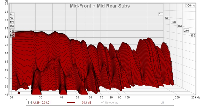

I use that method in my theater. The front Sub is 4x15 IB with the manifold in-room. The rear sub is a 16 cuft sealed sub with a 18" Dayton Ultimax powered by a Crown XLS2500 (bridged).
There was significant improvement in the smoothness throughout the space, and FR at the MLP improved. With just the IB, there was a big null at 20 and 76Hz, now smooth at 20 and much improved at both points now.
Here is the waterfall plot, measured at the MLP, it reflects my house curve EQ, which is why the <80Hz rises.
Room was ideally sized, and then extensively treated. Subjective bass is very smooth and clear. And that IB goes deep, shakes the whole structure, the door will occasionally pop open due to pressure and vibration releasing the latch!
But more importantly, music is crystal clear even at high SPL.
I do plan to add another 16cuFt sealed (identical to the rear unit) at roughly the mid-point sidewall location, almost parallel to the MLP. as a way of further smoothing some of the resonances at 27 and 41Hz.
