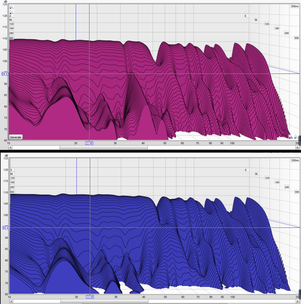

There's one thing I'm not getting about the 'EQ fixes ringing' thing. -
Say you have a mode ringing at 40Hz and it is +6dB above the rest of the curve and you then EQ it down 6dB for a flat response.
The ringing does reduce somewhat as it will be -6dB at whatever ms compared to before.
However, if you compare 40Hz @ 90dB pre EQ and post EQ the ringing will be exactly the same ? So EQ has not had any effect on the ringing, whereas bass trapping would show shorter decay times at 40Hz @ 90dB compared to 40Hz @ 90dB in the same room without treatment ?
When I look at the waterfall charts even after EQ the ringing frequencies still have big 'bumps' compared to the rest of the plot so the ringing is still there. It hasn't been fixed.

same can be said for subwoofers. graphs dont show significant reduction of ringing (decay) with subwoofers when not in DBA arrangement.These plots confused me too - How can you EQ 40Hz up by a couple of dB and the ringing drops considerably ?
but the argument/theory is that the ear is very poor at LF to detect ringing.
My answer is that adding bass traps which reduced significantly decay at LF, in my room, also very significantly improved the SQ of my bass.
So in my experience, in practice, the ear must be quite sensible to LF decay and any system would greatly benefit from reduction of LF resonance.
You're not getting it because it isn't exactly intuitive. Buy reducing the peak via eq DOES reduce the decay time. It DOES address ringing. But any reduction of a peak at one location may be deepening a null at a distant position, so what you can do for large seating areas using just one sub and an eq is limited. What you can accomplish with multiple subs and comprehensive eq is impressive.Say you have a mode ringing at 40Hz and it is +6dB above the rest of the curve and you then EQ it down 6dB for a flat response.
Don't cling to the assumption that frequency adjustments can't alter time behavior - ringing, decay time, whatever you want to call it. It CAN and does at low frequencies in domestic sized rooms because of the physics of how long waves in small boxes behave.
Look up minimum phase. That simple definition is a good starting point. That's what subs in our rooms are.
BTW, traditional IIR filters (eq) are minimum phase. Minimum phase corrections are adequate and appropriate to minimum phase errors. The guy above who used FIR filters in the subwoofer region is misguided. He has intentionally addressed frequency response problems WITHOUT addressing ringing in the time domain. Backwards approach for subs, debatable but not without merit for higher frequencies.
QUOTE]
The bit where you're shouting 'DOES reduce the decay time' I actually stated that myself in the post you quoted - " The ringing does reduce somewhat as it will be -6dB at whatever ms compared to before."
My point was that even if you EQ a peak down to make a flat response, the specific frequency that you EQ'd will still be ringing away compared to the rest of the passband.
So I guess I'm still not getting it - how can EQ fix the ringing ? Can EQ make 40Hz @ 90dB decay quicker in a room ?
That sounds illogical to me - reducing the energy going into the peaks will also reduce the energy going into the corresponding nulls resulting in less deep nulls.
Poor wording on my part. It doesn't increase relative depth of the null, but by bringing down the peak at that frequency the null also decreases in amplitude. You haven't made it any better.
And I guess I don't know what definition you are using for ringing, because it clearly isn't exactly the same after eq.
