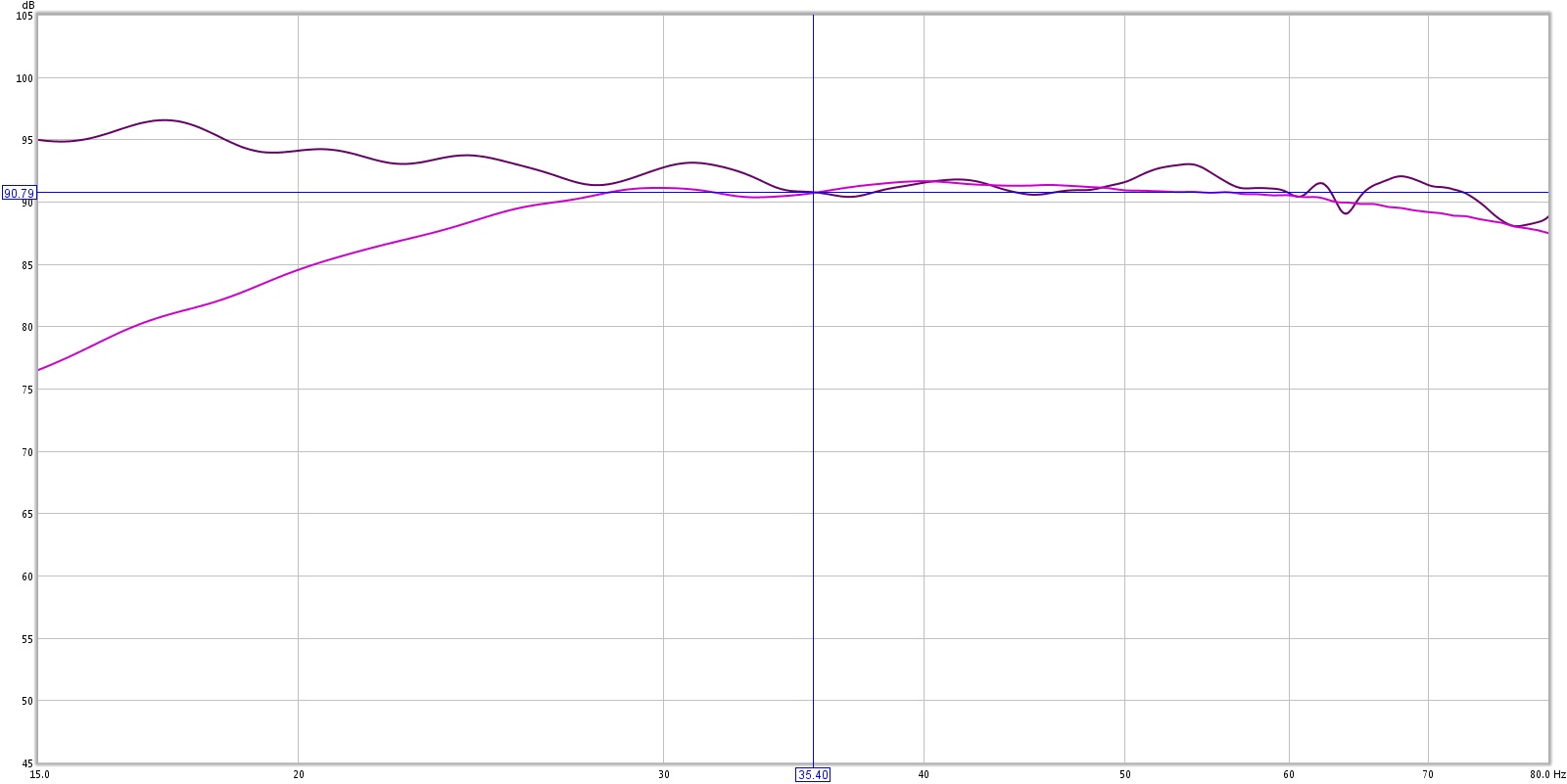

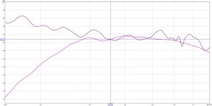

Near field measurement of one of my subs:
Listening position response*:
Slightly larger than average room in an old stick built Craftsman style home. Nothing special and certainly not a car, bunker nor shipping container.
*Mismatched horizontal scale as these were made for my own edification and not intended to myth bust. Sorry. Check for clearer frequencies in attachments.

Then you are familiar with how easy it is to separate room rattles from gain in REW with quick, low level sweeps and waterfall plots. Hopefully, you're not being willful in your presentation of room rattles as providing a broad spectrum boost at a fairly consistent per octave slope as is expected with that "mythical" room gain. The rattles are obvious high Q peaks and dips in the graphs I've already provided including that nasty mass damping my floor provides around 8.5Hz (crank it up and I can see the floor boards moving significantly, simultaneously disturbing and awesome); increasing the signal strength or duration of the sweep only makes the peaks and troughs more pronounced, the average remains evenly boosted. Besides, something acoustically real is exciting those rattles down low, something strong enough to be measured at a high level and it isn't leprechauns and unicorns banging on the walls. 😀

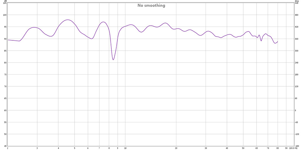

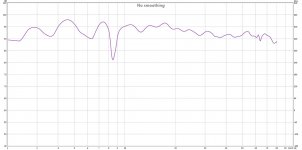

My room's characteristics have become quite familiar to me: I'm well aware of the 2.4Hz resonance of the long wall, the 4.8Hz harmonic that makes the large window rattle, the 8.5Hz floor mass damping, the 16Hz short wall resonance, the 31Hz fireplace insert rattle, the 34Hz long dimension node doubling up on it, the 52Hz drywall and clock rattle on the SW wall, the 62 and 67Hz short dimension headaches that forced me to move my listening position, etc and all the rattles an old house gains after decades of use and November winds. They're just narrow spectrum noise on the significant signal of room gain.

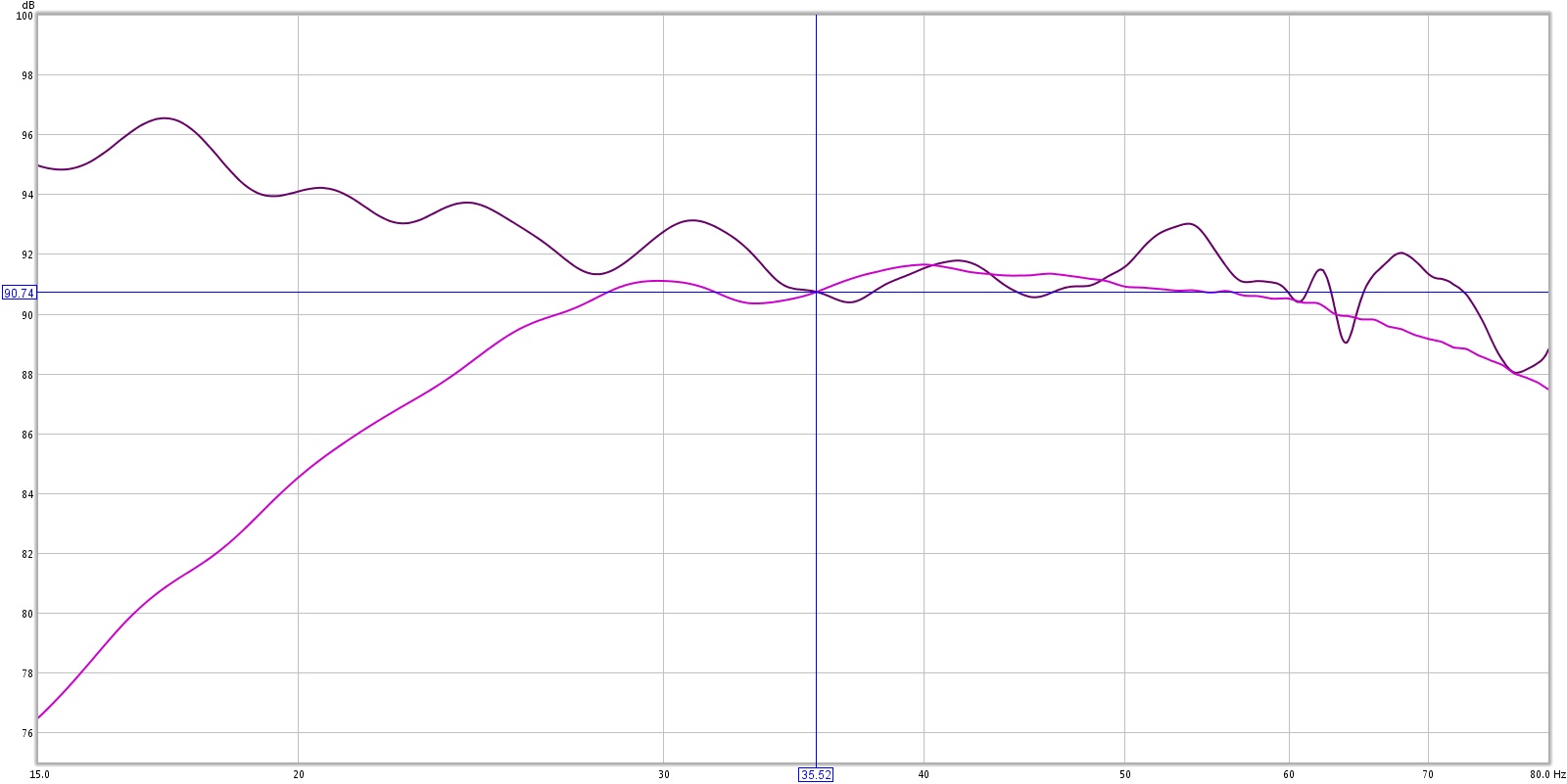

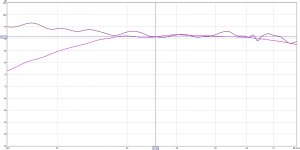

Earlier, I found the thumb drive I had stashed my measurements on and combined the above two graphs for a direct comparison leaving the colors the same to avoid confusion.

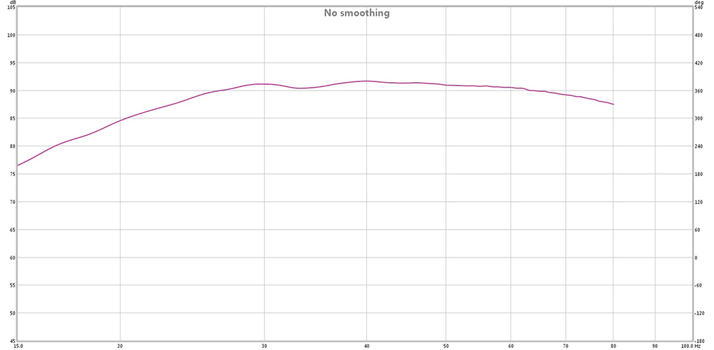

Nearfield measurement vs. listening position, low level quick sweep to minimize excitation of rattles:
Expanded scale:
Larger versions attached.
The rattles can be seen, comparatively insignificant as they are.
The driver is in a slightly too small cabinet (bit higher Q than I'd prefer), so the steeper than expected roll-off for a sealed alignment helps keep the overall response fairly flat. Though, as is seen in the expanded scale graph, the boost is still at a greater slope meaning that were this my permanent listening room. With a lower Q sub in a smaller room, the low end would be boosted sufficiently above the rest of the bass level to perhaps elicit complaints about "boominess". Too much room gain might even cause issues enough to move someone towards an open baffle sub to minimize it. 😉
Back off this minor hijack, though, I think we may agree in a way about the topic of the thread. I mentioned a fledgling theory I've been toying with about acoustic impedance matching being a cause of tactile differences (hair and all) between small drivers and larger transducers. I've a love-hate relationship with horns and planars, for all their faults, both have that palpable presence with music that small driver speakers don't seem to possess. Why would that be? Perhaps... perhaps it's because planars offer a large surface area, obviously, and what are horns but acoustic impedance matching transformers making a smaller diaphragmed transducer interface with the air as though it has a larger diaphragm?

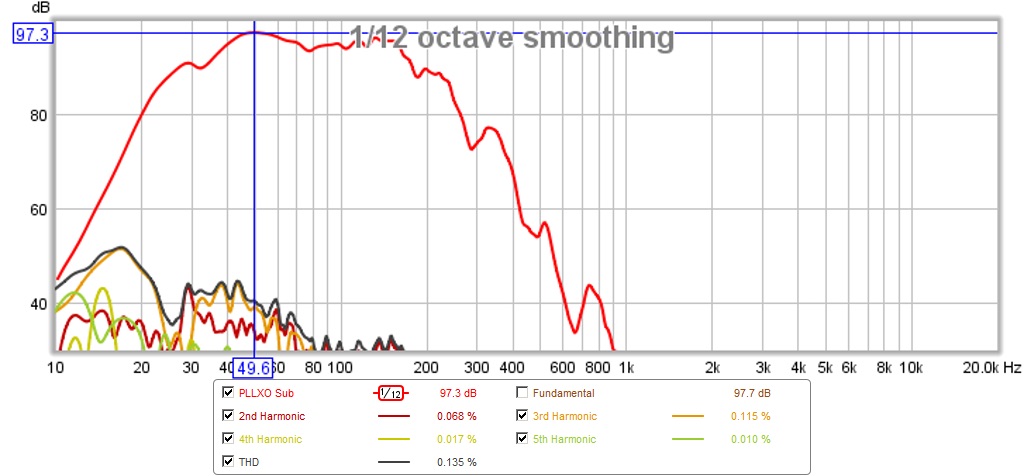

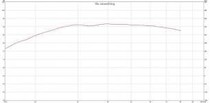

This measurment was made for the purpose of demonstrating a passive line level XO (low pass 2nd order) to achieve a low cost filter for a sub in another thread.
