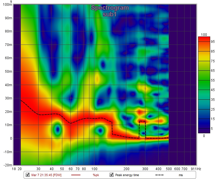

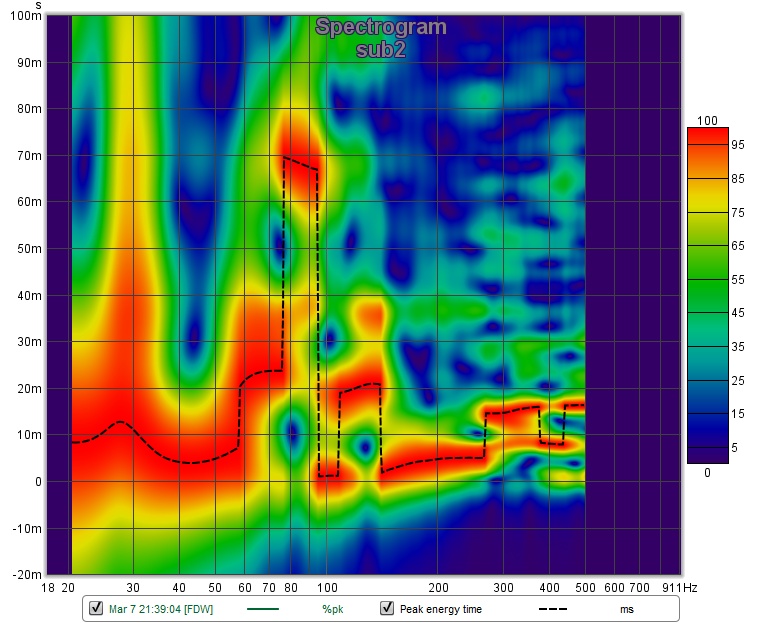

I'd vote for multiple smaller subs running in mono. Here are some spectrograms not to be fully subjective.
Two subs are located in corners of the front wall. Single subs give the following picture:
attachment.php
attachment.php

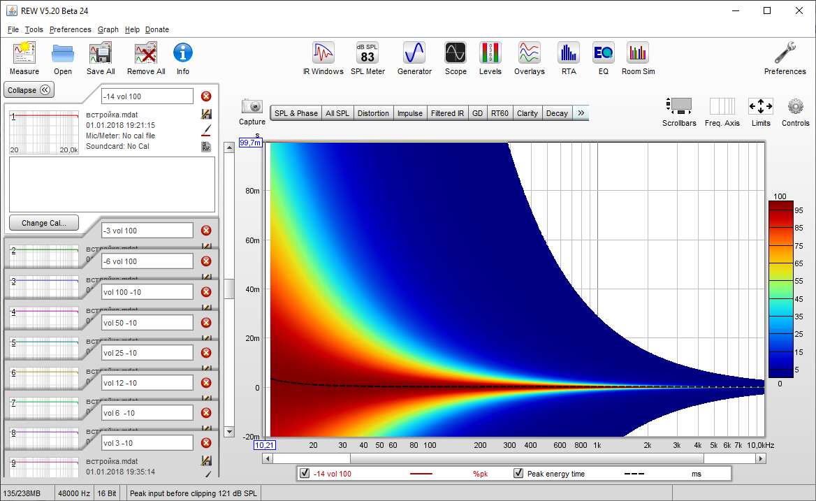

If you're not familiar with spectrograms, these type of charts show if every note is playing at the same time and how fast they are fading. Ideal spectrogram will look like this:
attachment.php
Every note is playing at the same time and immediately disappears. Red zone becomes wider towards the lower notes because lower notes have longer waves.

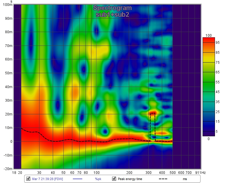

Running two in mono mode with a delay for one of them, gives much smoother bass response:
attachment.php
Third sub make the spectrogram is little bit better.
