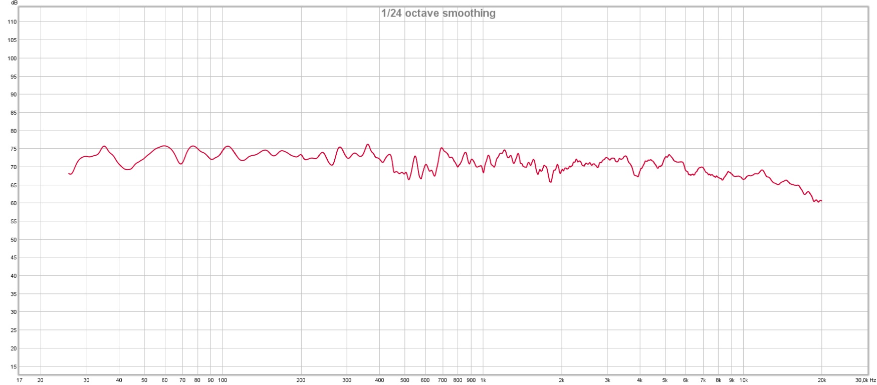

Open Baffle system

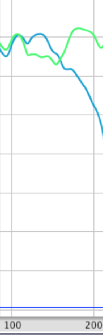

Here's a set of curves from a (now disassembled) dipole planar setup with BG RD-75's @ 15 feet, 0, 15, 30, 45, and 60 degrees off axis: (not much smoothing) crossover @600hz, 2nd order electrical
rather uniform across a broad swath, the 15 degree off axis(red) is actually smoother than the on-axis (green) response from maybe 1K on up:
Did not run below 200 hz... as I have 4 12" subs arrayed around the largish room (25' x 20' x 2 story) positioned empirically for smoothest bass in the listening area. I have awesome smooth, clean, punchy, and not overpowering bass, but I may try some measurements to validate what I hear (or not)!!

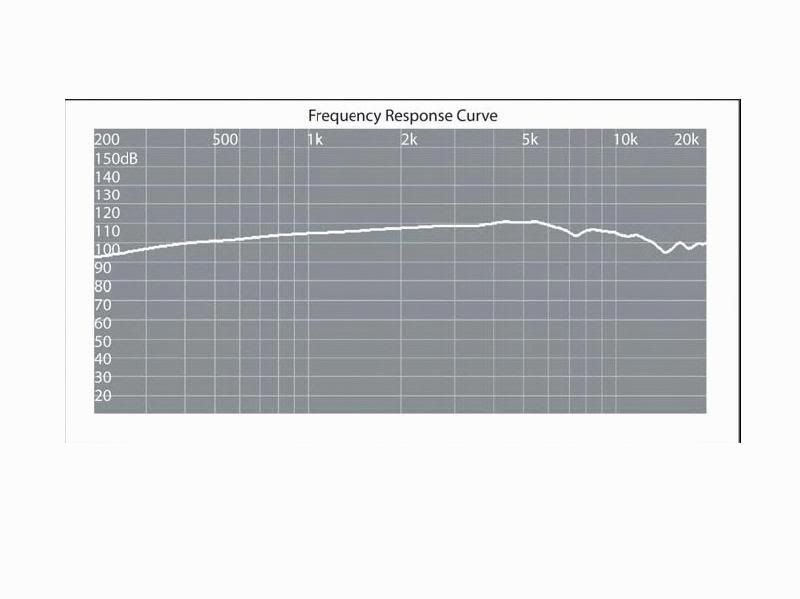

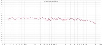

resolution
auplater:
A resolution of 15 dB is very high. Use 5 dB increments like the one below instead.
Hi
Yeah, whatever... curves are curves in engineering you know?? It's what you DO with them that matters
... it was 8 years ago, during setup and I lost many of the higher rez scans...
Plus, I was in the middle of setup and looking mostly at dispersion, not flat response.
I actually achieved very flat response (maybe +/- 4db 400 hz - 12 khz) with room correction, but disliked the sound

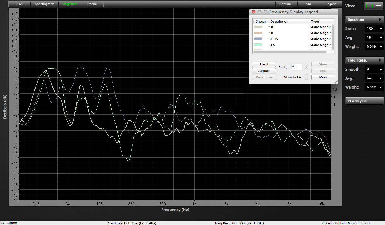

You describe a system and placement prone to large deviations in room frequency response, with measurements to back up said description.
If you were to draw out your room with speaker and listening positions and dimensions the reason (if not caused by the speaker's response) for the nulls would be possible to solve.
With either L or R mains with the corner horn there is a 16-20 dB dip at 65 Hz.
1130 FPS/65 =17.38 feet, from your room descriptions sounds like the horn path length + the extra distance from the mains could be causing the null, the orange trace in # 1715 has 5 dB less null at 60 Hz.
If the corner horn or either L/R speaker don't show the deep null from 55-80 Hz when played individually, the problem is time alignment, if they still show the null individually, it is a combination of the room and LP (measurement Listening Position).
If the ESLs radiate from the back as well as the front, the distance from the rear wall will of course be a "choose your poison" decision regarding the frequencies that will null at any given LP.

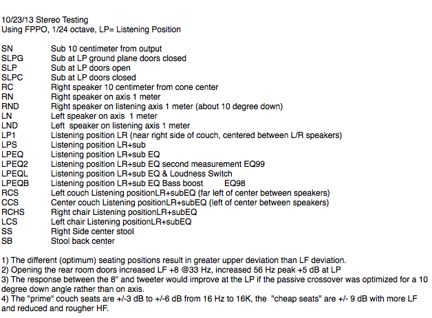

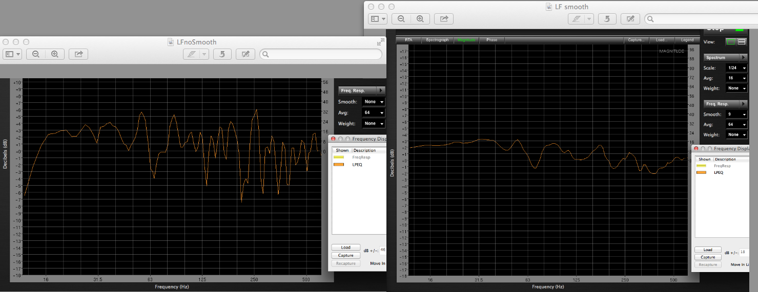

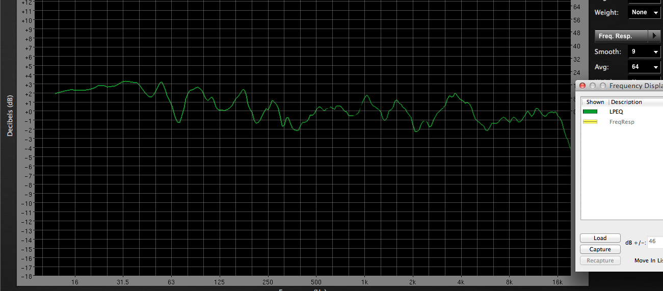

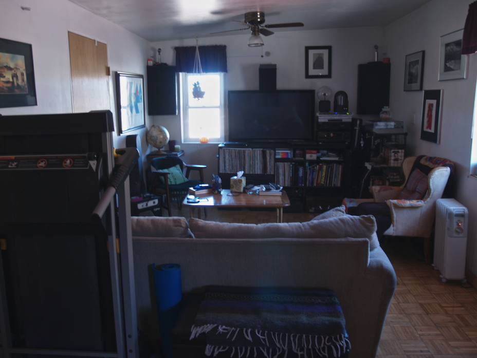

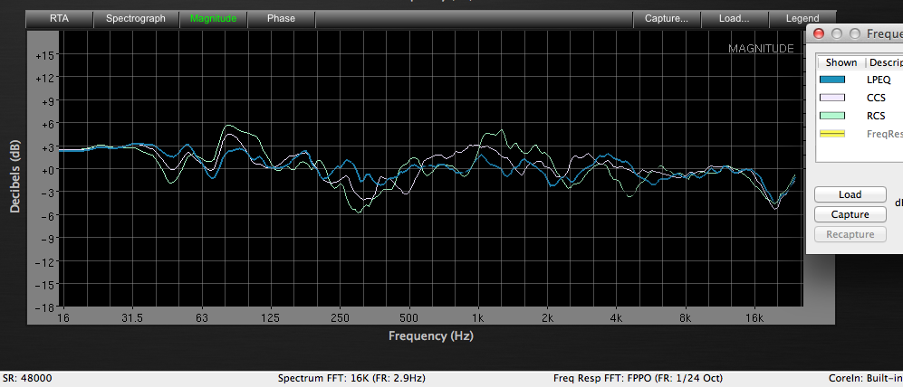

Today I did some testing at a variety of positions in my room.
With the exception of the long dimension of our rooms, our rooms are not much different in size, mine is 10' 9" wide x 7'7" on the low side x 8' on the high side x 19'11" long (3.3m x 2.3 m x 2.46m x 6.13m).
However, my subs and mains are within 2-4 ms arrival time at the LP, within 1/4 wavelength through (most of) the acoustical crossover.
With EQ (and smoothing) the response at the "prime" couch seats are +/-3 dB to +/-6 dB from 16 Hz to 16K, the "cheap seats" off axis along the wall are +/- 9 dB with more LF and reduced and rougher HF.
No smoothing, +/- 6 dB.
With more data points in, we have Markus' system showing a starting deviation similar to the 16-25 dB deviations in your posts 1397 and 1713, his post #1625 shows a reduction in frequency response deviation in the crossover transition region from around 17 dB to only 8 dB using delay on (some of) his subs.
Brian 's post in #1718 shows a wider deviation of 27 dB, in 1721 he says it was "a bit better" after adjusting phase and positioning.
Paul posts in 1722 around +/- 5 dB deviation.
Omholt in 1724 has a similar deviation to mine, +/-3 dB.
Auplater's curve in 1725 shows around 18 dB variation between 200 Hz and 5 Khz, the widest deviation posted, it would be interesting to see if the addition of his four 12" subs around the room result in a measurable improvement.
So far those posting charts with time alignment capability have shown improvement, while Earl found in his system it made things worse in some positions while improving others, as one would expect.
We can't all sit in the best seat 😉.
Art

Not that simple here. My receiver does both TA and EQ via an automated process. While it is easy to switch off the TA/EQ to do before/after measurements, but it may not be easy to determine which are due to TA adjustment and which are due to EQ adjustment.

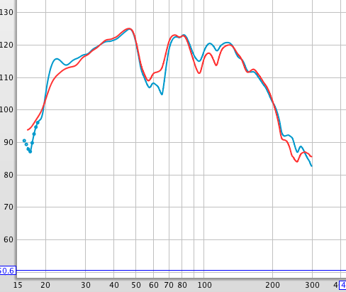

OK, here're the charts, 16-300 Hz. This afternoon with some traffic outside, there is variability even in successive identical tests.
The first chart shows the horn and then the horn plus the OB. Pretty major room (or room, speaker location, chair location, speakers, etc.) influence, very minor speaker interaction or alignment problems.
The second chart shows the horn and OB (repeated from first chart) and then with the mid added. Again, its the room anywhere south of the cross-over region. And the cross-over region isn't too bad*.
Hope that puts the matter of bass alignment to rest (at least for my room).

Ben,The first chart shows the horn and then the horn plus the OB. Pretty major room (or room, speaker location, chair location, speakers, etc.) influence, very minor speaker interaction or alignment problems.
If you used a shallow crossover slope with speakers extending lower the big dip could have been due to alignment, but with a 24 dB per octave crossover at 110 Hz looks like alignment is not the problem there.
The 6 dB drop in the crossover region when the mids are added indicate they are reverse polarity from the lows, if in polarity the 110 region should rise in level when added.
Typically to compensate for too much level at the crossover point one uses an "underlap", say 110 Hz for the lows and 120 Hz for the mids, or just drop the level with EQ at the crossover point.
Still curious what the combination of OB and horn look like when the OB polarity is reversed.
Not sure as I appreciate you again offering me patronizing newbie kind of advice as if I haven't explored all that kind of simple stuff for many decades. No doubt your intentions are well-meant, but gimme a break.Ben,
I posted my curves to disprove your point of view (which I think they did successfully a few times over).... not to get your advice on my system, even when well-meant.
Tomorrow should we arm-chair psychoanalyze your bumps and dips?
