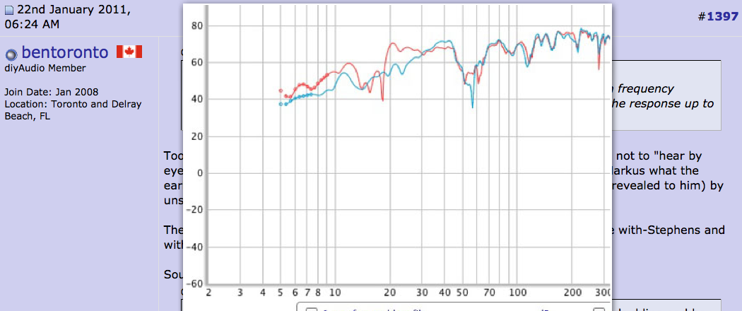

The frequency responses you posted in #1394 and 1397 show huge variations (20+dB) in LF response, given your choice of speakers and locations, hard to say how much improvement you will see/hear with time alignment at the listening position.

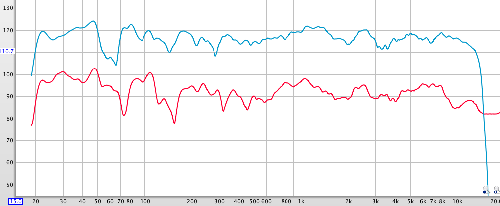

Ignoring those old traces for a moment, here're some rather nicer new ones made with REW a few minutes ago.Ben,
If you are crossing your subs around 100 Hz, any usual head movement probably won't have much effect on what you hear in the crossover region, but a few feet in any direction could have large (+/- 12 dB) variations. Of course, that is already occurring now, without DSP, with DSP at least you could get fairly flat (+/- 6 dB) response in one location, which does not appear to be the case presently.
After you get your MiniDSP and do some testing and listening you will be able to answer the questions for yourself.
Good luck, have fun!
The upper trace is where my nose usually is when listening to music. I have some pride in these results for a smallish room, pretty much within 5 dB, 19 Hz to 15 Hz, give or take a bit, above the bass. (It would be interesting to see weltersys's traces?)
The lower one, shifted for clarity, is made by moving my listening easy-chair 24 inches back. Treble sadder. The bass fluctuations are still roughly where they were but changed in level.
Awaiting the comments of others, my first impression is that it is my room (15.0 x 9.48 x 8.05 feet) that is a dominant influence, with alignment not mattering so much. Or has the mis-alignment carried over?

Ben,Ignoring those old traces for a moment, here're some rather nicer new ones made with REW a few minutes ago.

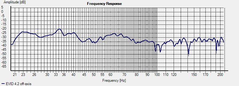

Don't know about his room, but here's mine, taken a few minutes ago:
I suspect it would be even smoother in the 50 Hz region and the phase at the x-over frequency needs to be adjusted a little , but SWMBO's in there folding clothes and has two of the windows near to the listening position open and she's not conducive to sine sweeps at the moment, so...
The subwoofers? One 10" driver in a 2.5 cu.ft. vented alignment (Fb=21 Hz) , in the front right corner of the living room.
