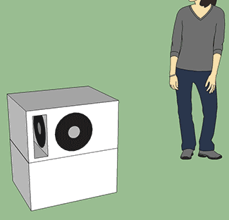

I tested the effect of an auxiliary sub. Both in simulation and IRL. Simulation suggested that best placement was the opposite wall, but it didn't work out well. I put it on top of a bookshelf (near the ceiling) and middle of side wall. This was best of the test for me.

Best to stay near the middle of the room however. At "subwoofer" frequencies the differences in space are not that great, but yes, some average in space is always advised.

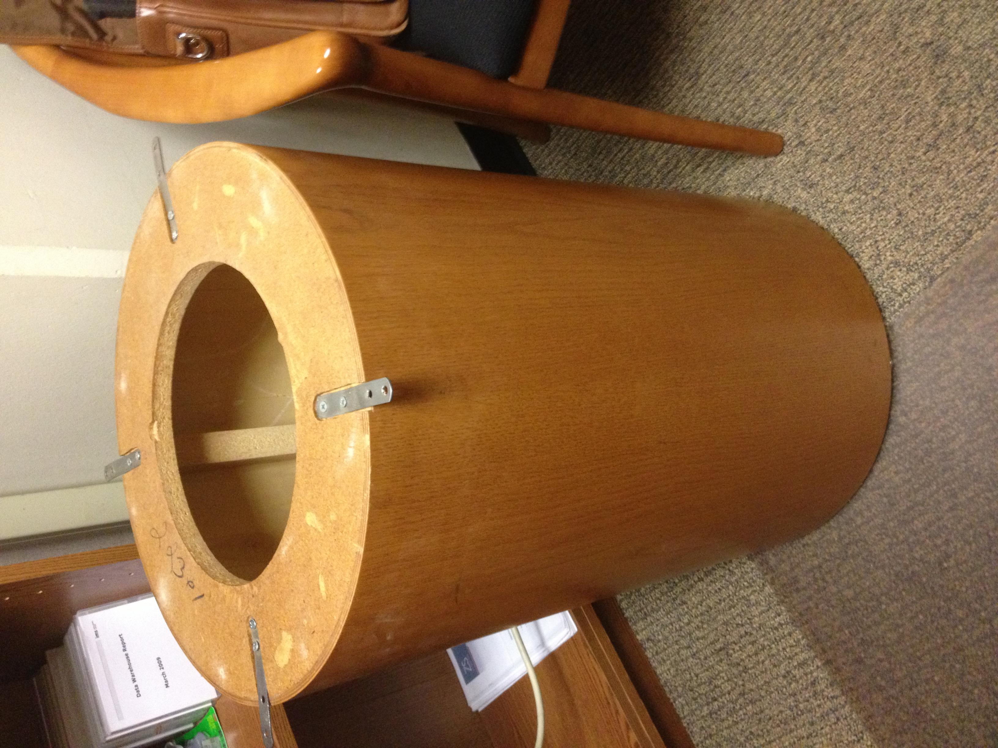

My current setup has 2 dual isobaric 12"s- but keeping an eye on some of our tables being decomissioned at work has paid a dividend:
Free 5/16" ply veneered shell for a pseudo-sono-sub. My plan is to put isobaric pairs on either end and do the best job of force cancellation I can to keep from having to "build up" the existing walls. There is some bracing already present that I can leverage, however.
By having a driver on either end there's a bit of spatial separation, and I'll be setting this on top of one existing cabinet that's side-firing, so there'll be 3 sources each separated by a couple feet.
