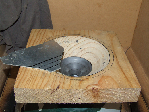

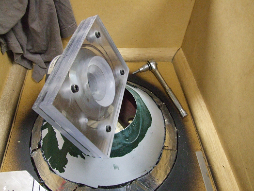

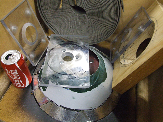

Thank you. The picture shows only half of the length constructed.
For a given axial length (throat to mouth), increasing the radius decreases the length of the waveguide proper. Is both this length and the radius a tradeoff against the lowest frequencies to be produced? When I try to prove this I always find inconsistencies.
