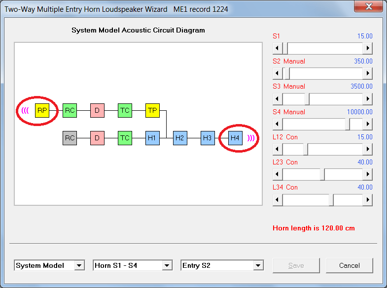

can you model ‘ports’ (that is to say channels from the chamber of a synergy horn, which radiate into a point offset further along the horn’s length) in Hornresp?
No.
As Rob has indicated, and as shown in the attachment below, Hornresp simply combines the output from the rear chamber port with the output from the horn.

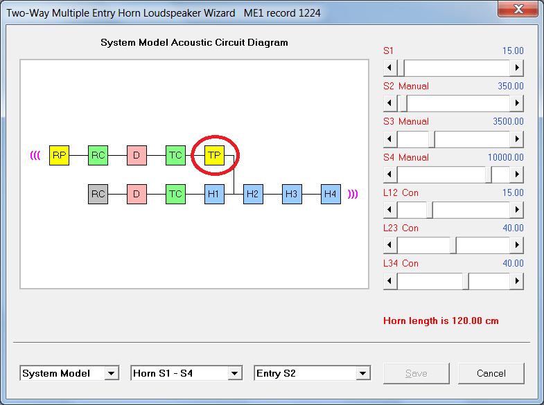

Just to clarify - I have assumed that you are referring to a port in the rear chamber behind the ME1 offset driver, and not to a port in the throat chamber (which of course does feed into the horn at the designated offset point).

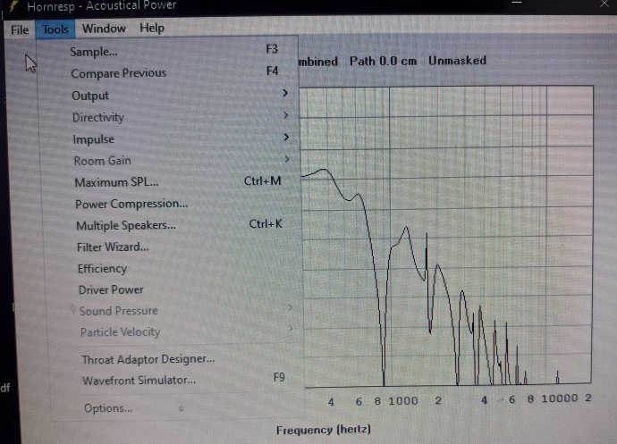

Is there a reason why particle velocity is greyed out when I have the rear chamber ported ?
Hi Rob,
Sorry for the delay in replying, I missed seeing your post until now 🙂.
The Particle Velocity menu command is greyed out because the combined response is being displayed. Use Tools > Output to select the desired output and the Sound Pressure and Particle Velocity menu commands will then be enabled for that output.
How does one calculate the size of the ports in the throat chamber? Is it relative to 1/4 the size of the lowest wavelength you want to exit into the horn? Is there a reason many are rounded rectangles instead of circles? Should they be from the edge of the cone?
