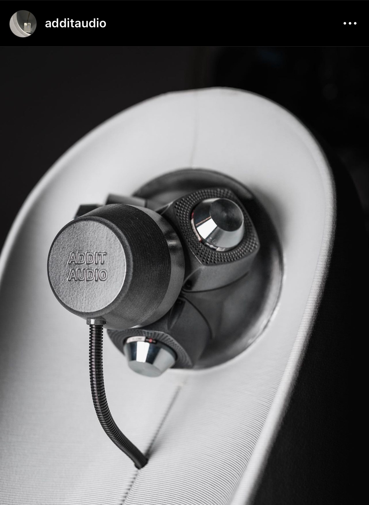

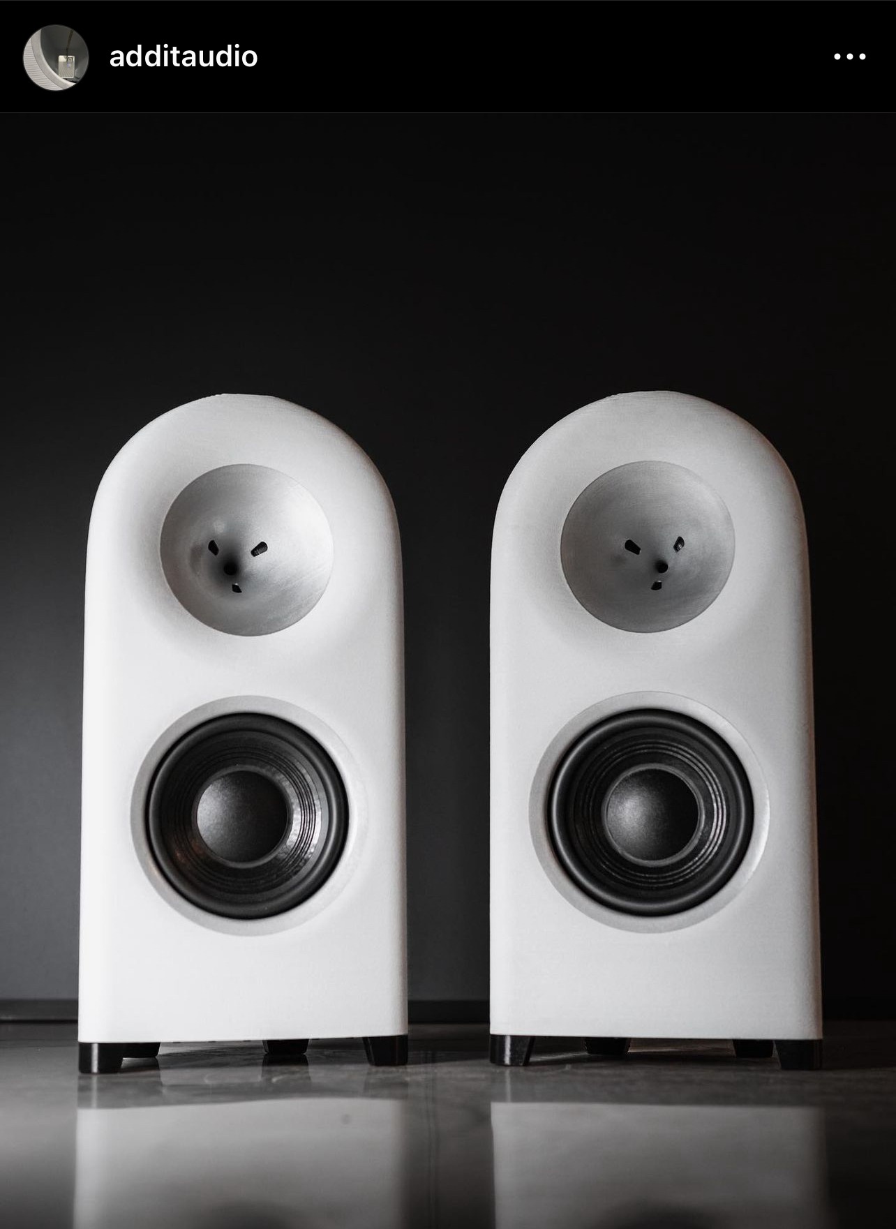

More inspiration for leaking midrange.
https://www.instagram.com/s/aGlnaGx...3099086584270671090&igsh=MW42MzlnaDkzOW56bA==

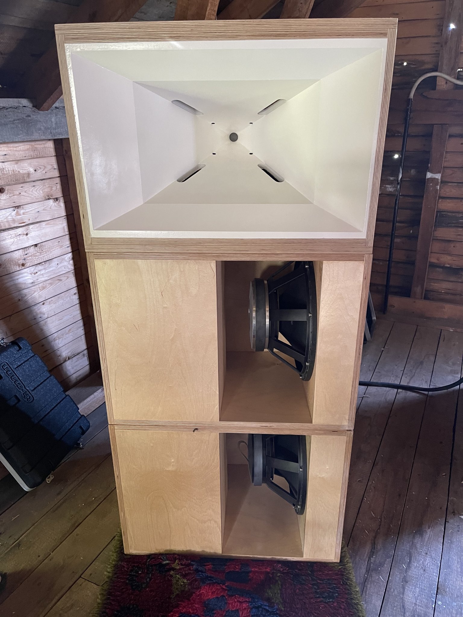

The best compromise I've come up with is the build i call syn-10. https://www.diyaudio.com/community/threads/syn-10.383607/
It's a 90x60, 36" wide x 22" tall x 22" deep. Uses two 12"s, four 4"s, and a coax CD.
And weighs only 51 lbs. Part of the catch with weight though, is the horn has no back....the CD and mid drivers are exposed off the back of the horn.
It has a handle on the top, and I can get it thru doors, up/down stairs, etc easily enough. That said, it is a bit awkward just because it's a big triangle/pyramid, but if this 71 yr old can move it around, can't be too bad 🙂
If I had to move it to a difficult location, the CD comes off with 2 screws, which knocks 6+ lbs and 4" of depth off the tab.
When it come to the smallest, lightest, version I've built that i think worked....it was another 90x60 31" wide x 19" high.
It used two 10"s.
I really don't think that getting below 30" wide is going to allow anything other than small lows, and like you said, doesn't get to 500Hz pattern control.
I've also built versions that had 36" wide primaries, and detachable flares that expanded them to 48-49" wide.
Detachables work, but are a PIA to make, imo. Art Welter might have them best solution there.
I've had trouble with resonances at cranking SPL.....bass energy from subs want's to turn the flares into energy grabbers i think.
Anyway, just some random thoughts/experiences...hope they help...

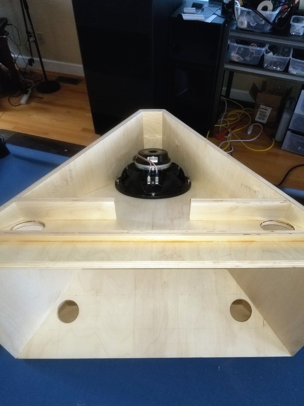

For a bass-reflex idea you might want to look at what I called syn8. It's the only reflex i tried (other than the huge syn11 with 18"s that was a clear reflex failure.) Syn8 reflex worked...got the 8" down to 80Hz. https://www.diyaudio.com/community/threads/a-somewhat-easier-to-build-synergy.362087/
It ended up with removable wood flares...straight ones, not curved. As I recall, initially i liked it's 75x50 pattern over previous 90x60, but ended up going back to 90x60. No real answer there...

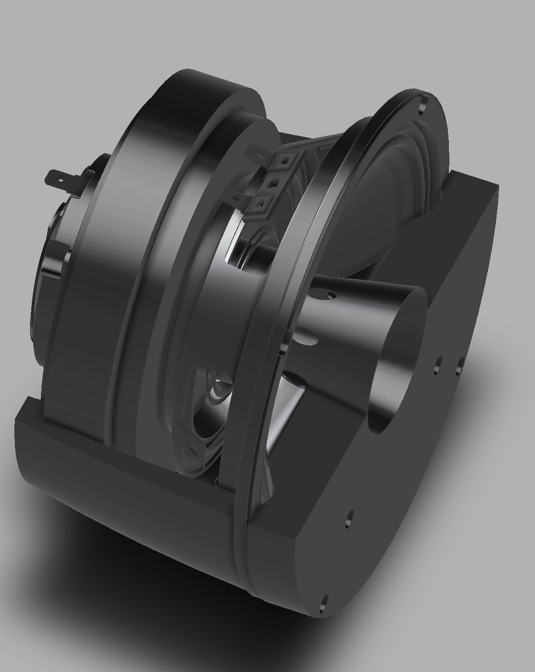

Yow. If that data sheet is accurate, that looks like just the thing for a small synergyish horn. Kinda wish I was still building such things.Go for it, the 6” is cheap, they even provide a cad model on their site https://www.redcatt.net/cx6f-140f.html
https://redcatt.de/REDCATT-CX601X8
https://hifi-selbstbau.de/index.php/hsb-datenblaetter/koaxialchassis/redcatt-cx6f140fx8

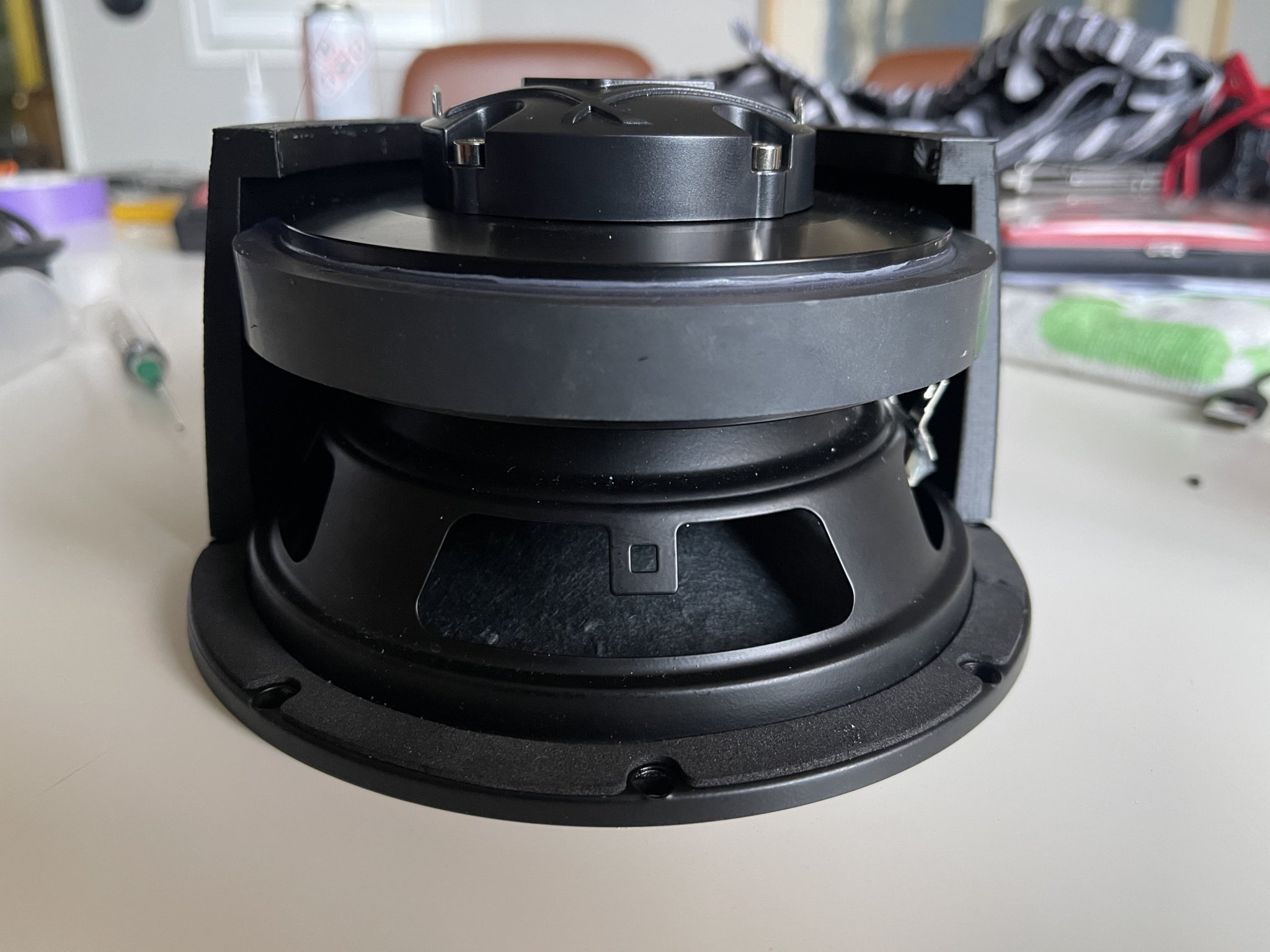

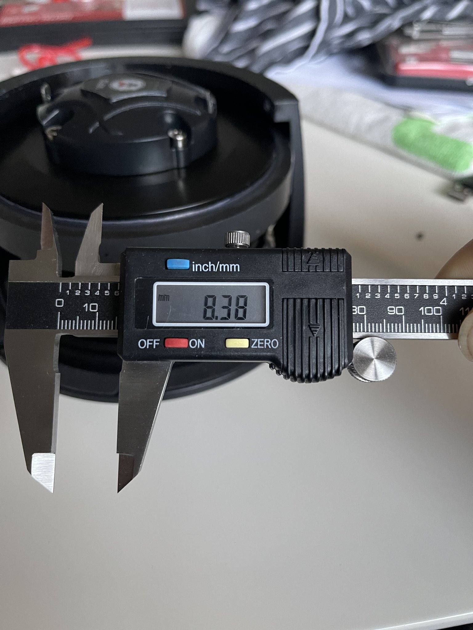

Unfortunately redcatt’s data sheets are a little off.
And the model isn’t as accurate as I hoped.
A perfect fitting back chamber in the virtual world vs printed on the driver.
But it’s still a nice one.
That is indeed unfortunate. I suppose they don't specify a tolerance on their dimensions, but that amount of difference looks more like a mistake (or unpublished design change) than a reasonable deviation. I agree that it remains a very interesting driver, though; especially for compact designs.
For the current build, I will probably use a more conventional combo of compression driver and separate midranges. I already have some high quality compression drivers that I really like, and they would also be smaller at the pointy end of the horn (for cases where the speaker might be fitted into a corner). But I thank you for posting about these redcatt drivers, as I can already think of a few other projects where they would be quite useful, and I hope that your own experiments with them bring a fruitful outcome.
