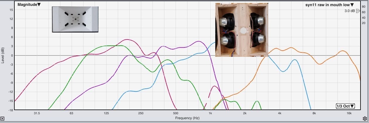

The purple trace in Mark100's Syn11 is the response of four B&C NDF34, nicely covering 180Hz to 1kHz.
On a conical horn, I'd prefer their sound in the 400-1kHz range over any compression driver.
Mark is crossing them ~700 Hz to the B&C DCX 464 coax compression driver.
Four NDF34 can do ~116dB at 160Hz at one meter within Xmax, they can be crossed to low frequency drivers mounted internally or externally.
I've listened to them outdoors on a horn with a mouth the size of the back chamber in the above photo playing above three EV MTL4 (quad 18") subs, they got louder than I'd care to listen to at under 8 meters or so.

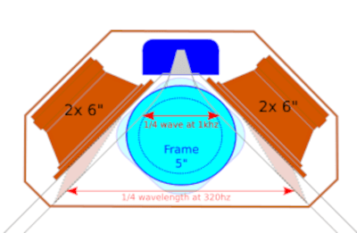

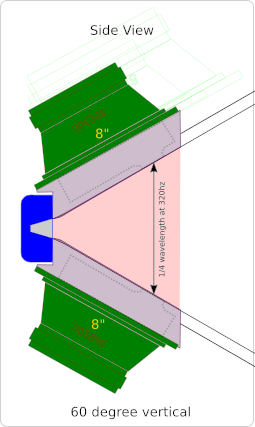

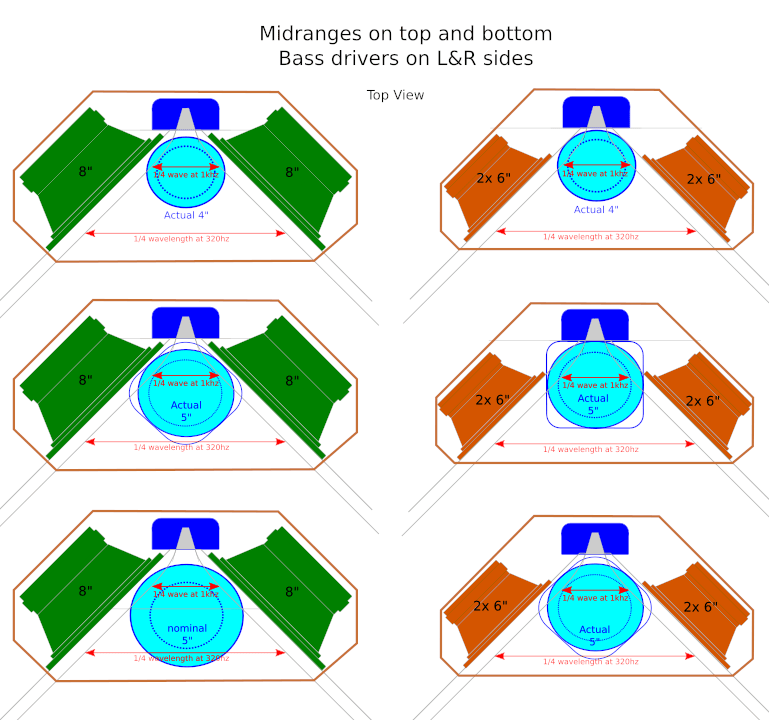

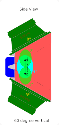

Still no MS windows (for hornresp) as I'm waiting on a replacement SSD for the laptop. However I've had a look at how 2-way and 3-way versions might work with my requirement for a compact enclosure (before adding removable cone extensions and flare).
Aside from a couple of awkward shapes, adding four midranges almost always makes things noticeably bigger. However adding two midranges can be done with little or no increase in size, if they use two sides of the horn and the woofers use the other two. That is assuming that two midranges would achieve sufficient SPL anyway, which I believe they could for home listening purposes.
e.g:
A few sizes of midrange might work, but (looking at say 1khz tap positions on a 90degree cone) 4" or 5" true frame size might be most optimal. 4" is a little smaller for spanning two corner taps (though I could move them in a bit) whilst any bigger than 5" starts to move the driver further down the cone (even a 'nominal' 5" cone with larger frame size) .
In a 3-way there are obviously a second set of taps for the bass drivers; which will need to be some distance along the cone. This makes little difference for 8" woofers, but for 6" woofers it probably means moving them further down the cone to reach the tap; they therefore offer less space saving (over an 8") than they would in a 2-way configuration. Though this is at least slightly helpful in leaving more space for midranges to overlap the corners of the cone.
Overall then, a 3-way might not be 'quite' as compact as a 2-way could be, but it could still be acceptably sized. There are of course more "ways" to deal with but in mitigation it seems easier to cover the range in three ways instead of two ways; 8" MEH drivers certainly can reach a 1khz crossover in the right hands, but I have found threads with people struggling with even 6" - and I don't yet know how skilled (or unskilled) I will be in this respect.

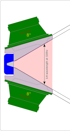

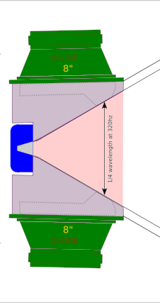

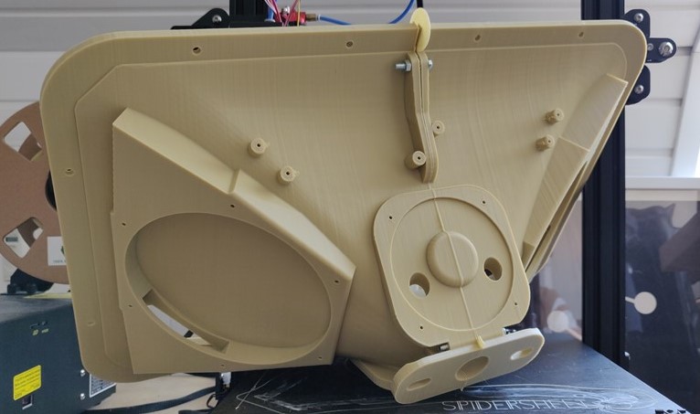

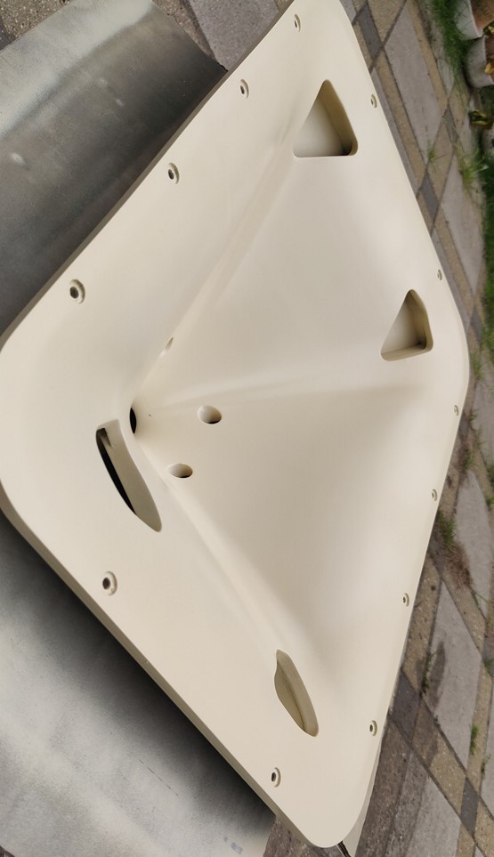

I found that thread I mentioned earlier, with the front chamber being used to put taps/ports further out into the corners of the horn (than the driver itself reaches). It was bwaslo's rather advanced and inspiring printed waveguide thread. Zaxder later made an impressive version in a lighter coloured material that is a little easier to make out in the photos, if I might refer to them for illustration:
It differs a little from my intent, because this/bwaslo's waveguide is the full size (not expecting extensions), but the front chamber and tap arrangement are very interesting.
Though the chamber is smaller than I was envisioning, and no doubt the simulations will show why. Though hopefully that won't matter. As I see it, provided the outer edge of the front chamber and taps remain where they should be (i.e. without needing a long port or tunnel), it possibly doesn't matter where the rest of the driver and chamber is. So they could be angled relative to the cone, to leave more space for midrange and compression driver clearance.
e.g:
or even:
(that latter seems extreme unless you wanted to fit 4x big bass drivers, which I don't. But by exaggeration it illustrates the principle I'm thinking of).
e.g:
or even:
Very interesting.
Quite something that printed one.
Perhaps you covered it earlier and I missed it - you have taps for the MF and LF as usual, nicely 1/4 wavelength.
Will you have ports for the bass reflex effect too?

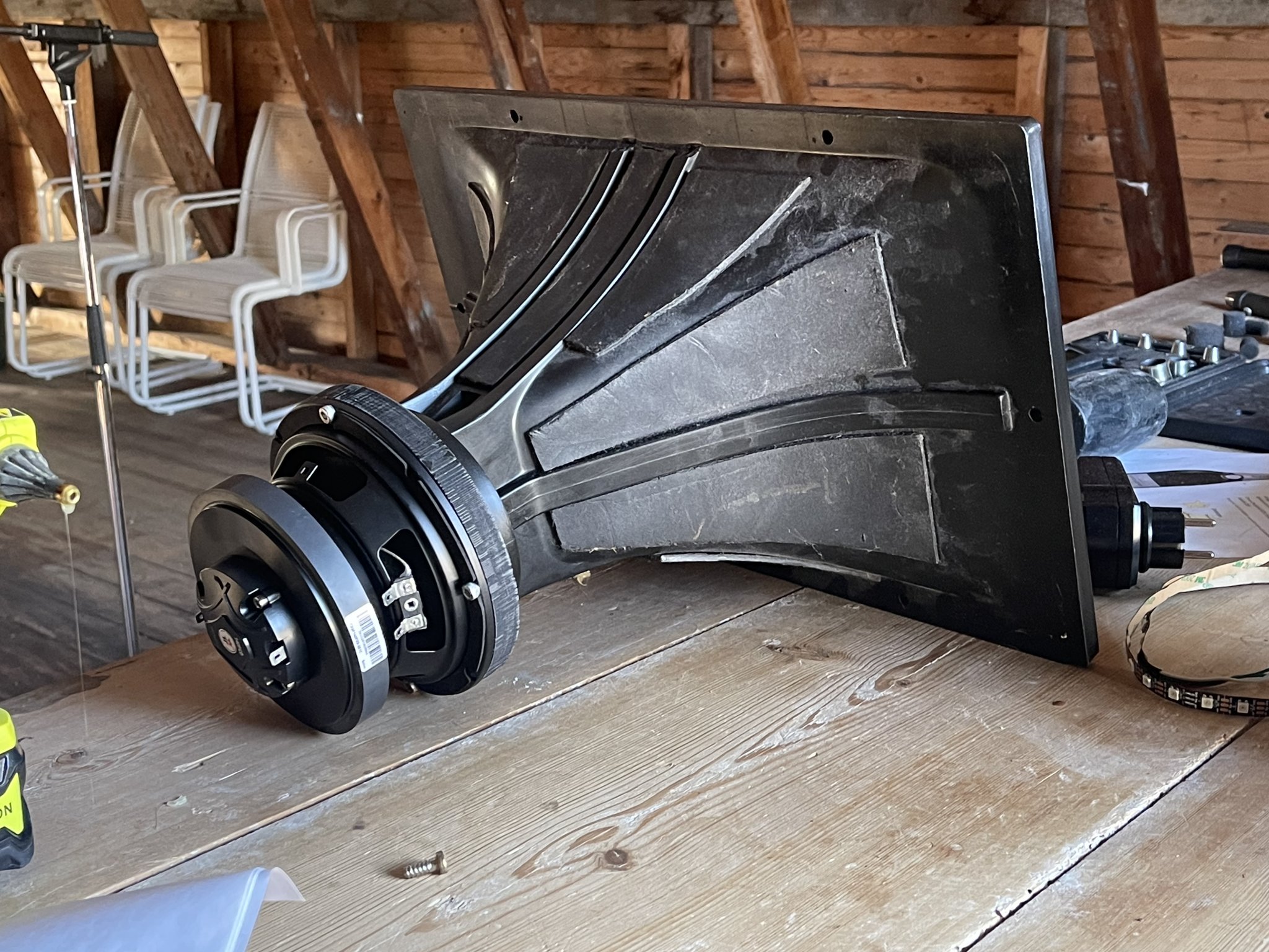

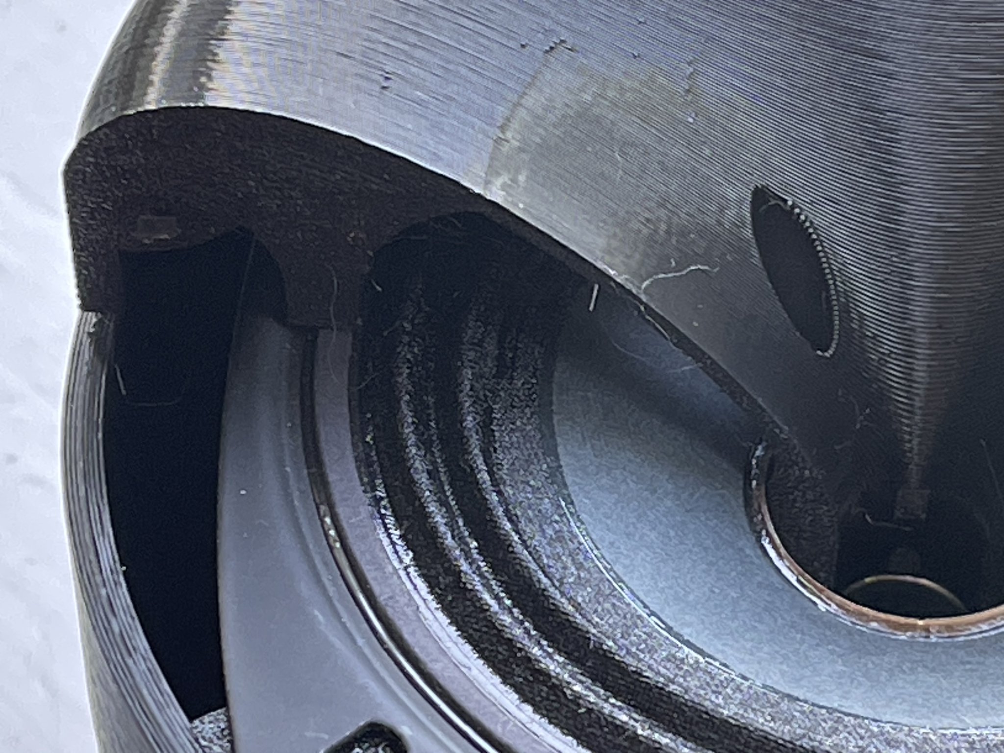

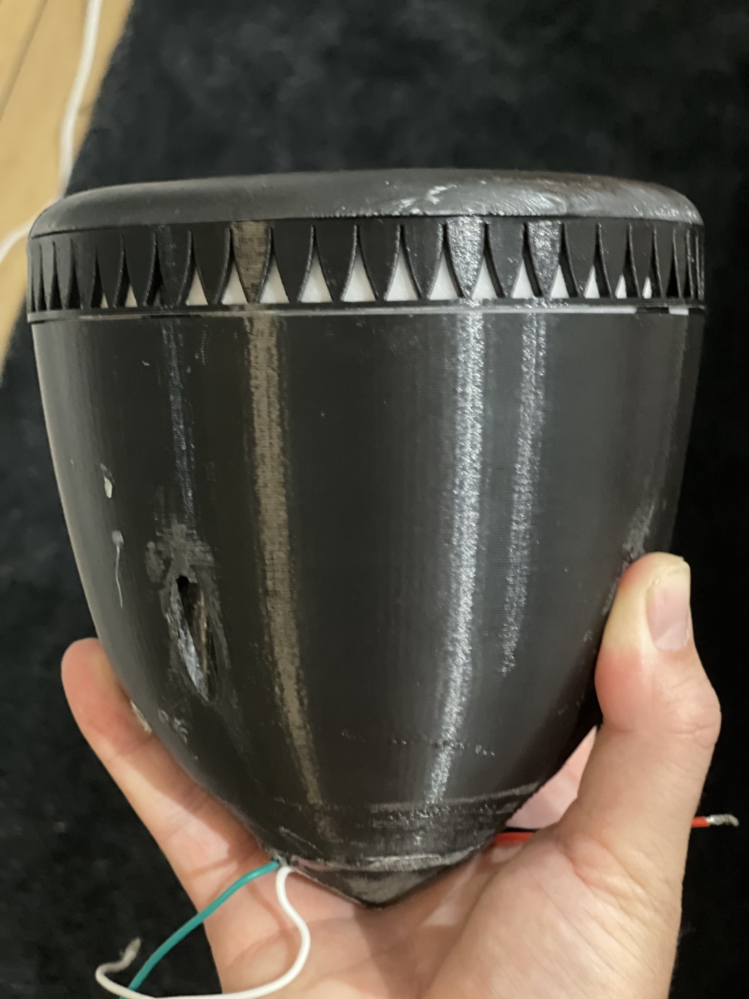

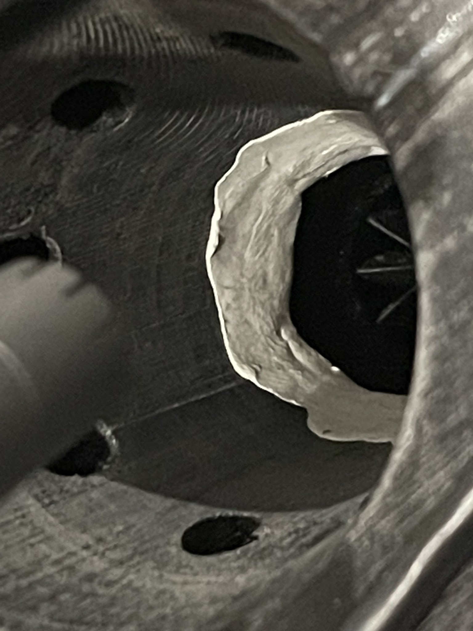

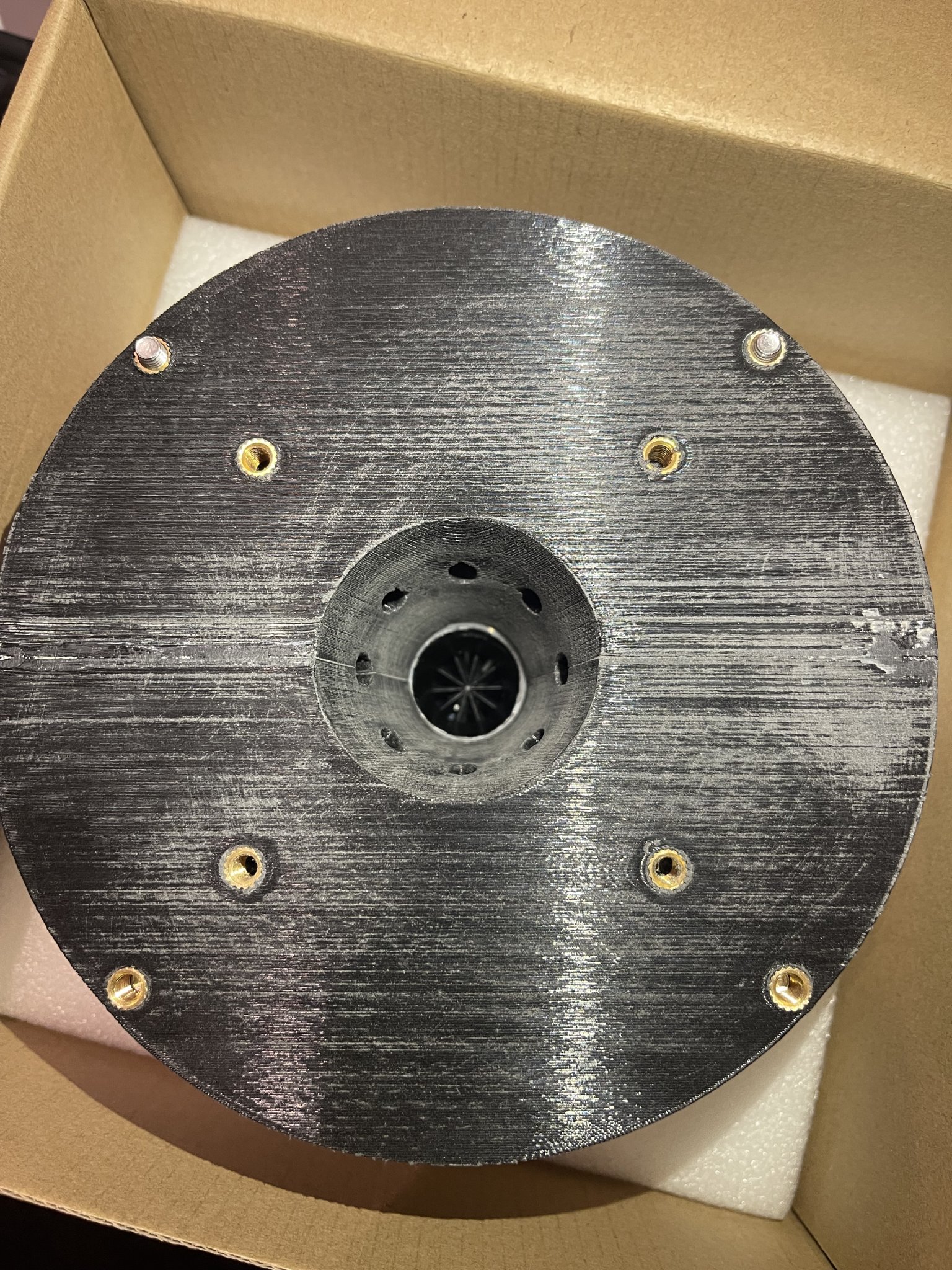

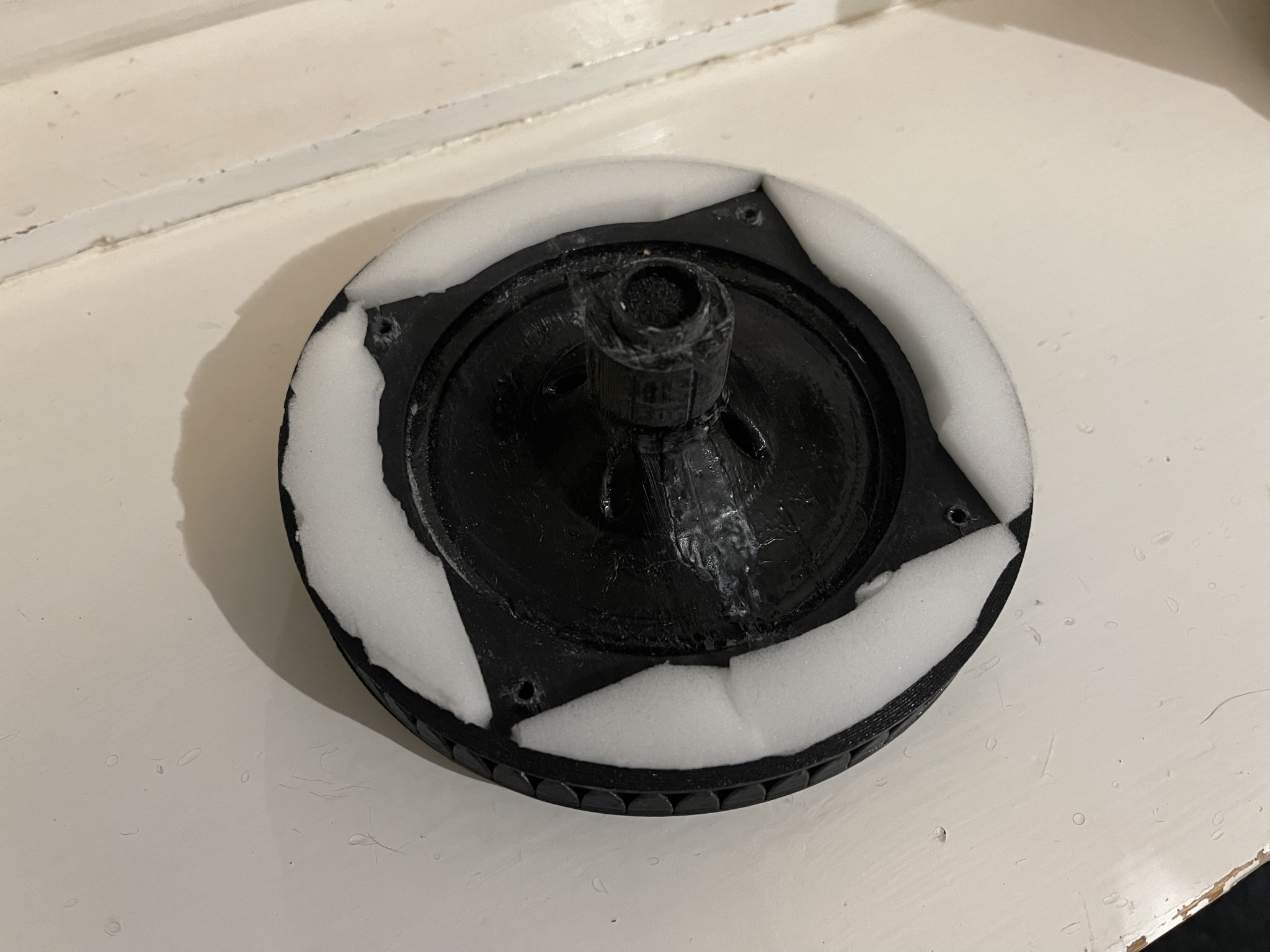

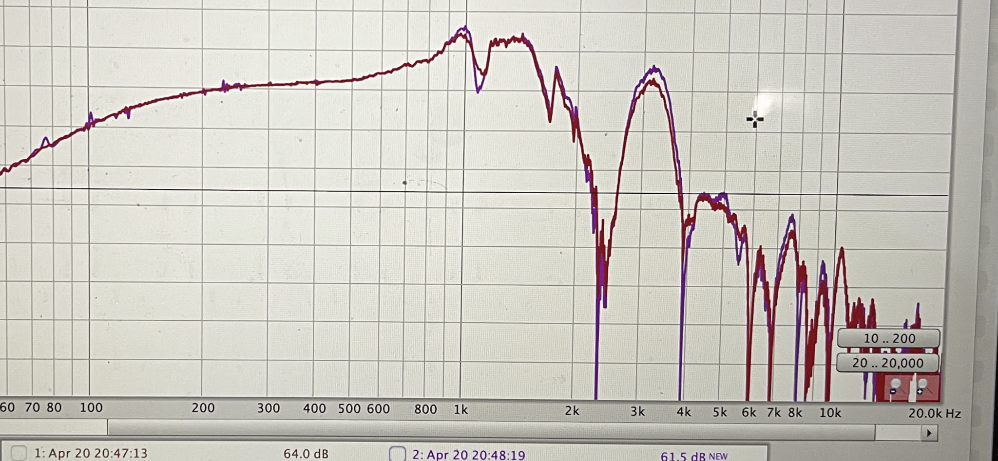

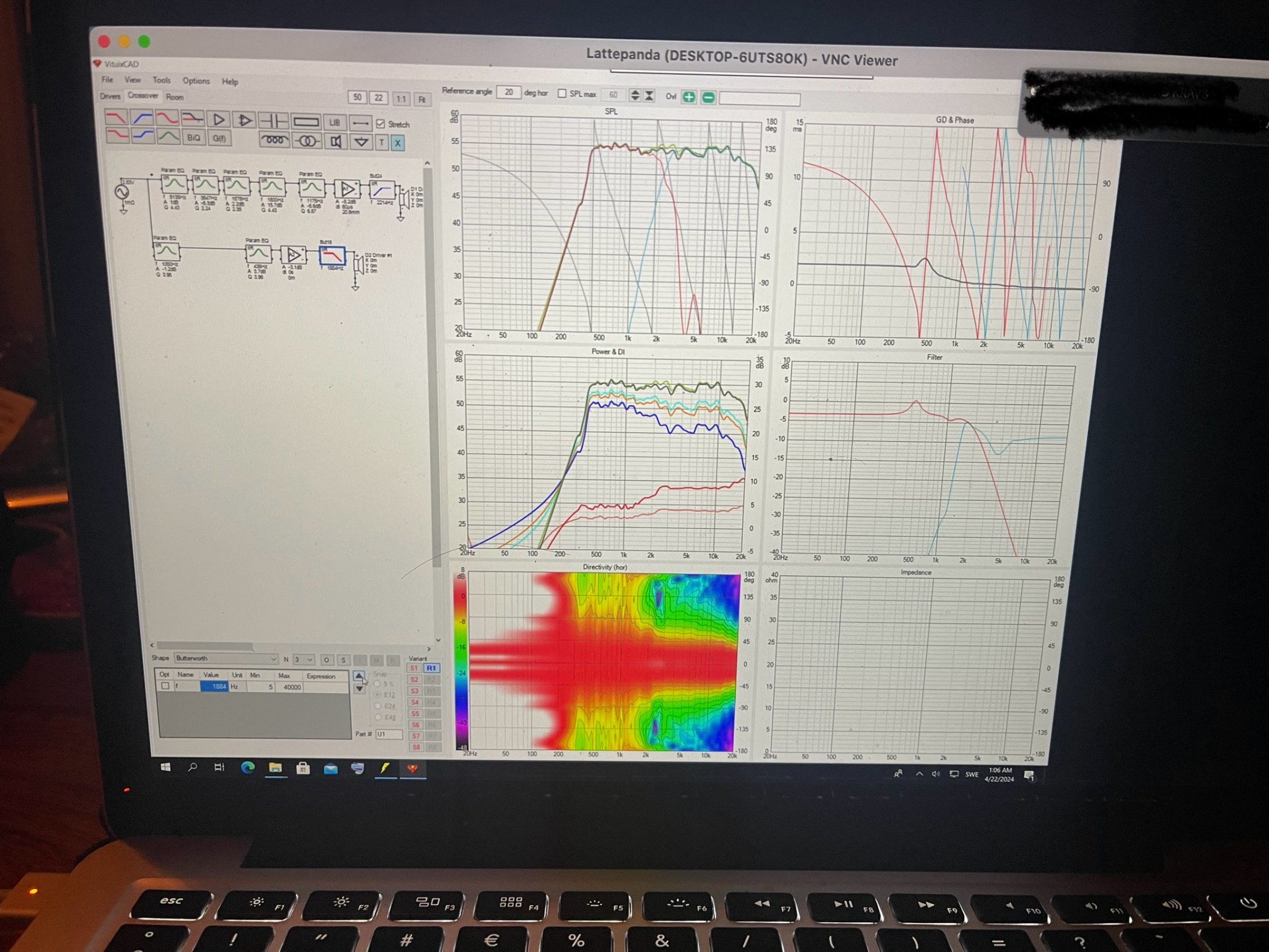

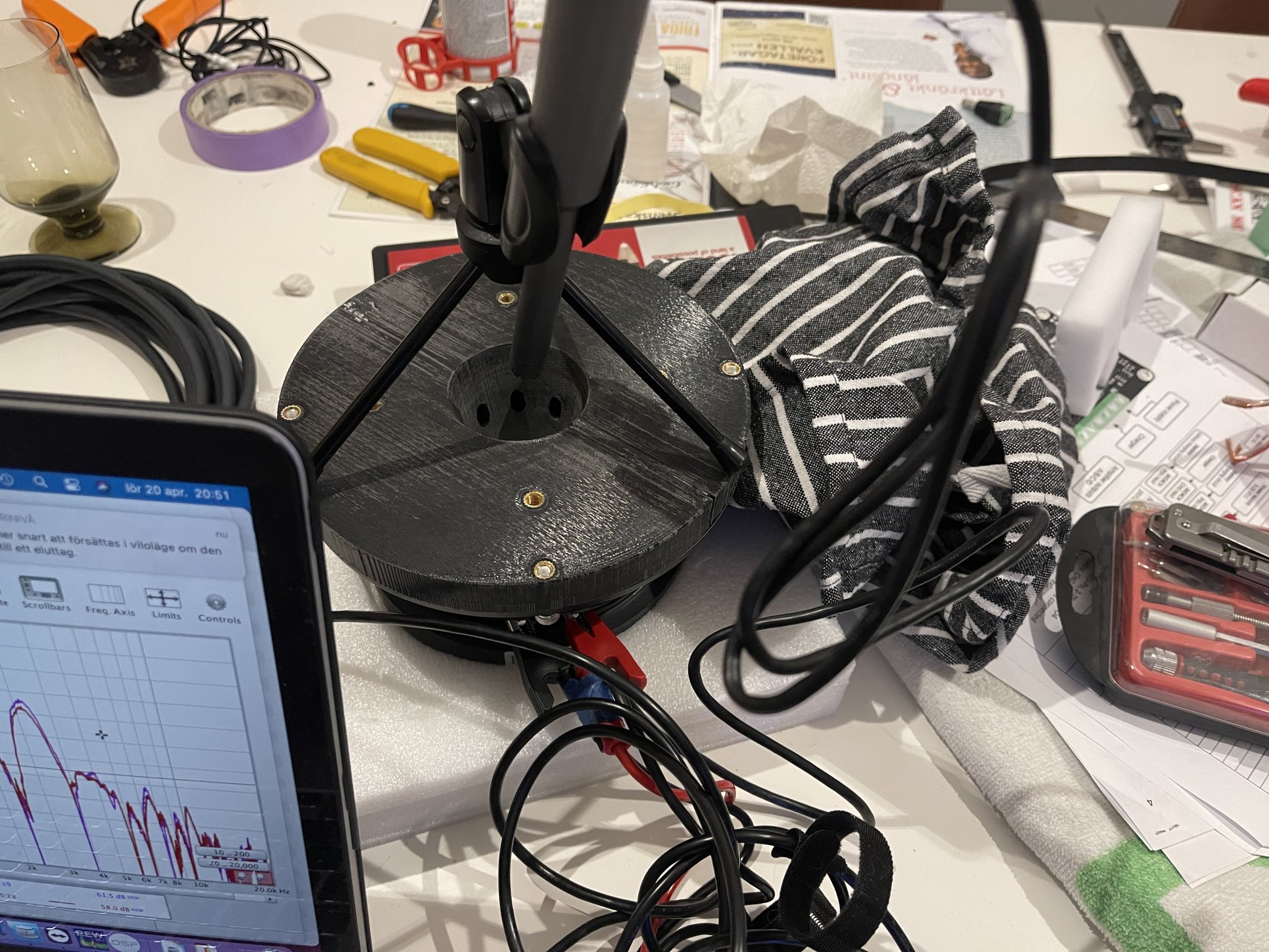

Not going in to details here but I’ve been doing some experiment with pro coax in the style of Danley patent fig 7 and renkuz-Heinz coentrant driver and it’s a really nice way to get the midrange taps close to the tweeter and potentially make it as compact as possible.
The latest experiment with 6” redcatt coax on a 2” horn shows potential.

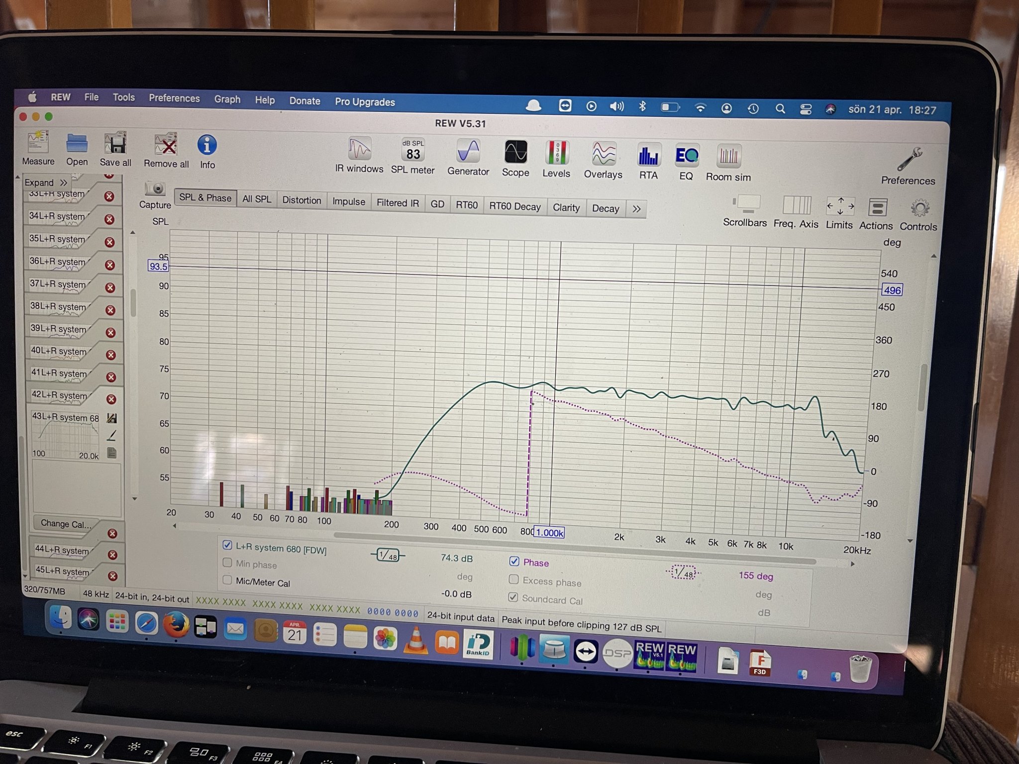

Raw nearfield of only the coentrant driver.
The red is with some melamine foam pushed down to where the phase plug ends.
And the dip at 1100Hz is leakage from where the printed part meets the aluminum conical part of the driver. A quick test with blutack confirmed it.

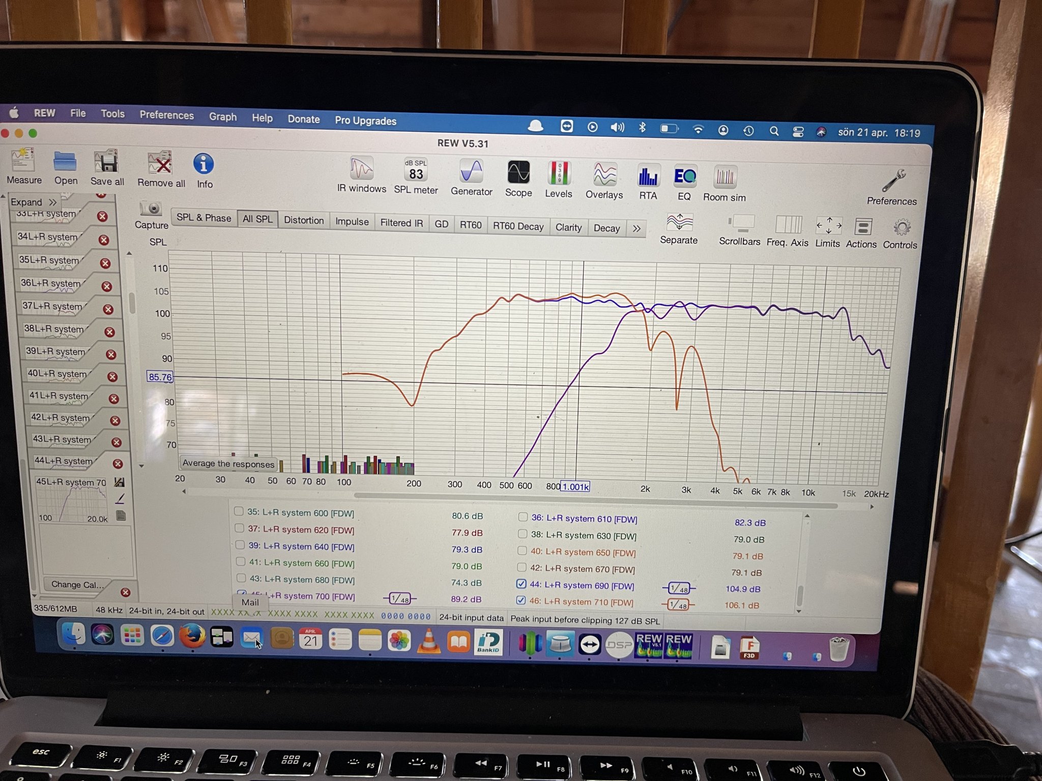

And so sorry for my rant here, but my little 4” with passive cardioid can control directivity down to 500Hz. But will probably be limited in max spl.
A MEH doesn't have to be big..
It started here:
https://www.diyaudio.com/community/...he-easy-way-ath4.338806/page-671#post-7417700
And along the way I investigated passive cardioid https://www.diyaudio.com/community/...he-easy-way-ath4.338806/page-676#post-7425742
But the attached is the latest bigger leakage and melamine foam version.
