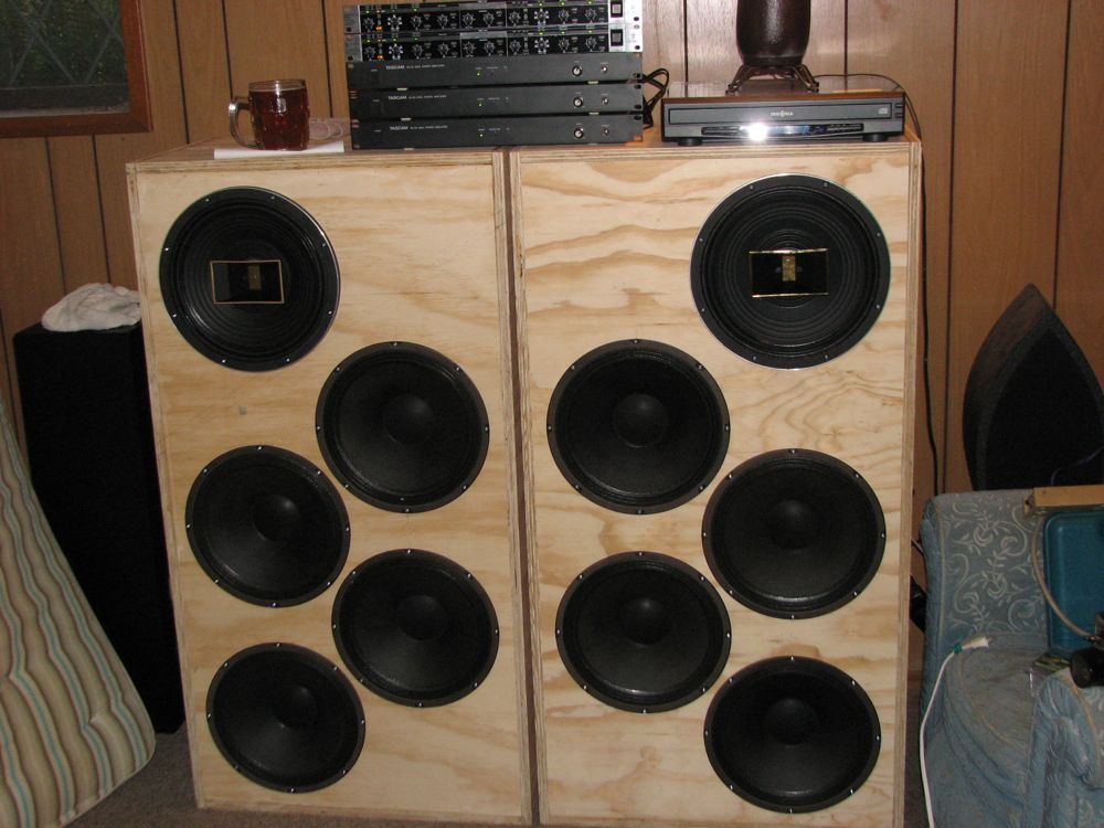

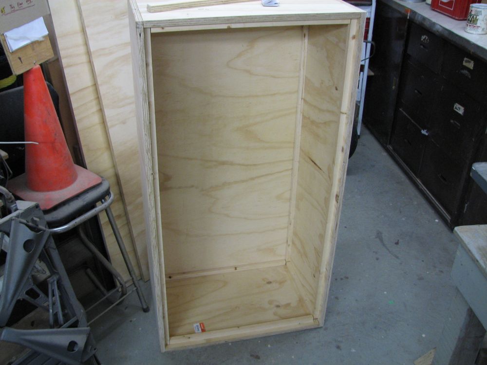

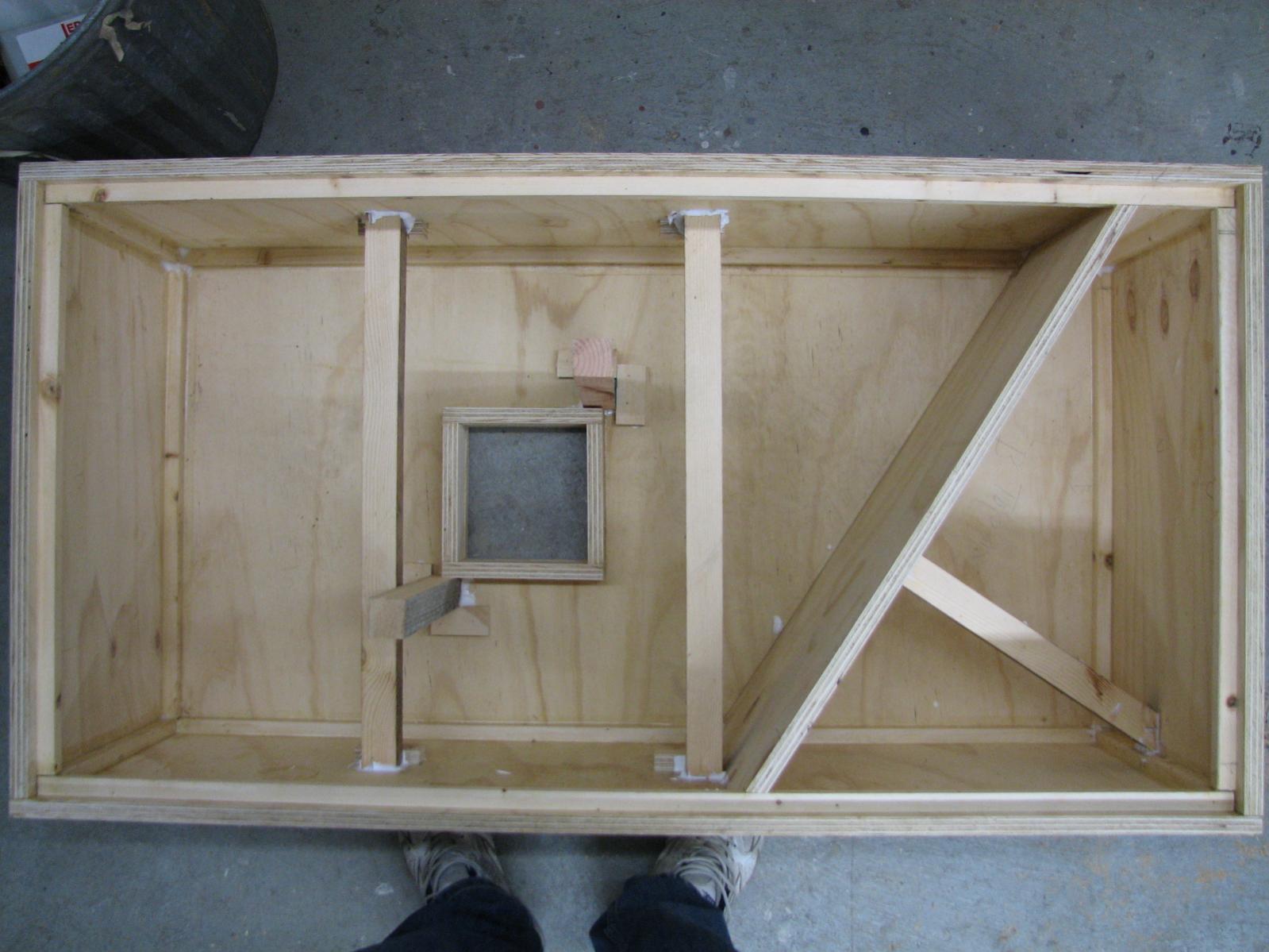

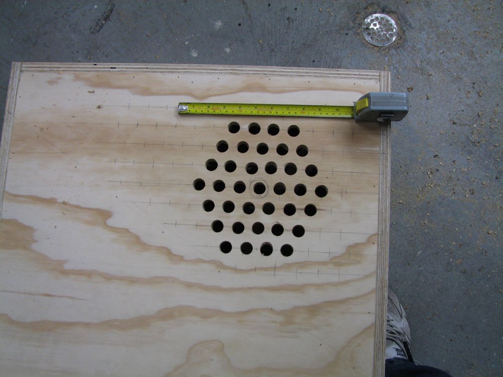

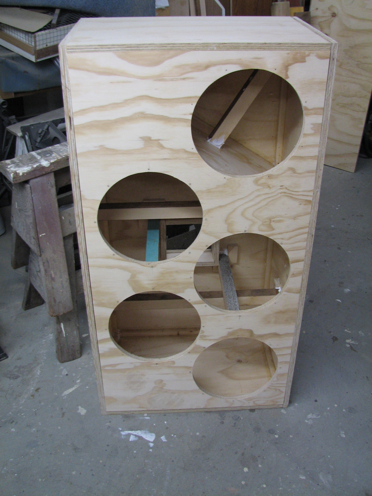

These are 12's and the fifth one is a coax but if you want party and not critical listening then you already have someone who's done what you want. The woofers are BR, and the coax is rear vented. System is tri-amped with about a 200Hz high pass on the coax, and 2500 on the CD.
