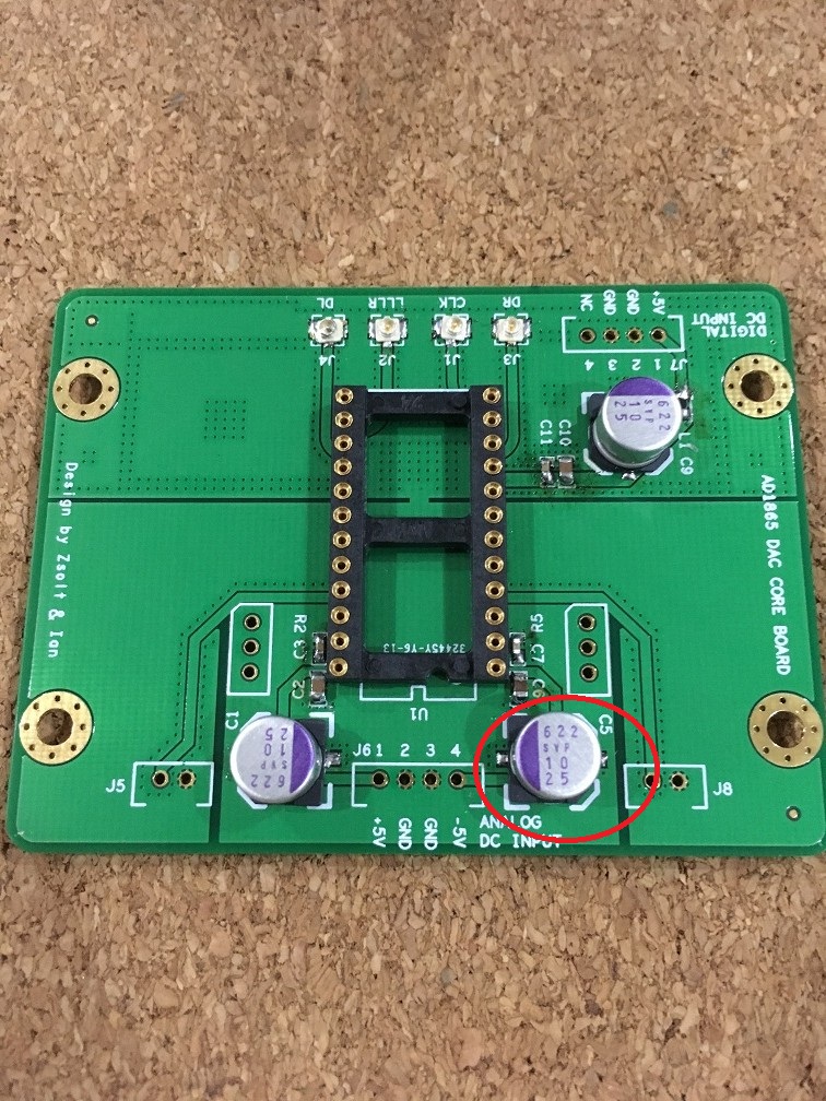

Hi Vzs & Ian,
Thanks for the ad1865 core board and the layout is indeed very nice. While I was populating the PCB, I realized there is an incorrect silk for C5 polarity. Shouldn't the Vcc- be connected to the negative polarity of the capacitor?

I haven't populated my board yet but after reading Cheng's post, I looked at the schematic and the board and it does appear to me that the polarity of the capacitor on the -5v analog supply line is backwards.
Thank you guys for pointing this out, C5 is indeed reversed in the schematics and thus the silk is incorrect, should be reversed.Hi Vzs & Ian,

I was lucky the electrolytic did not exploded as I was using it reversed.

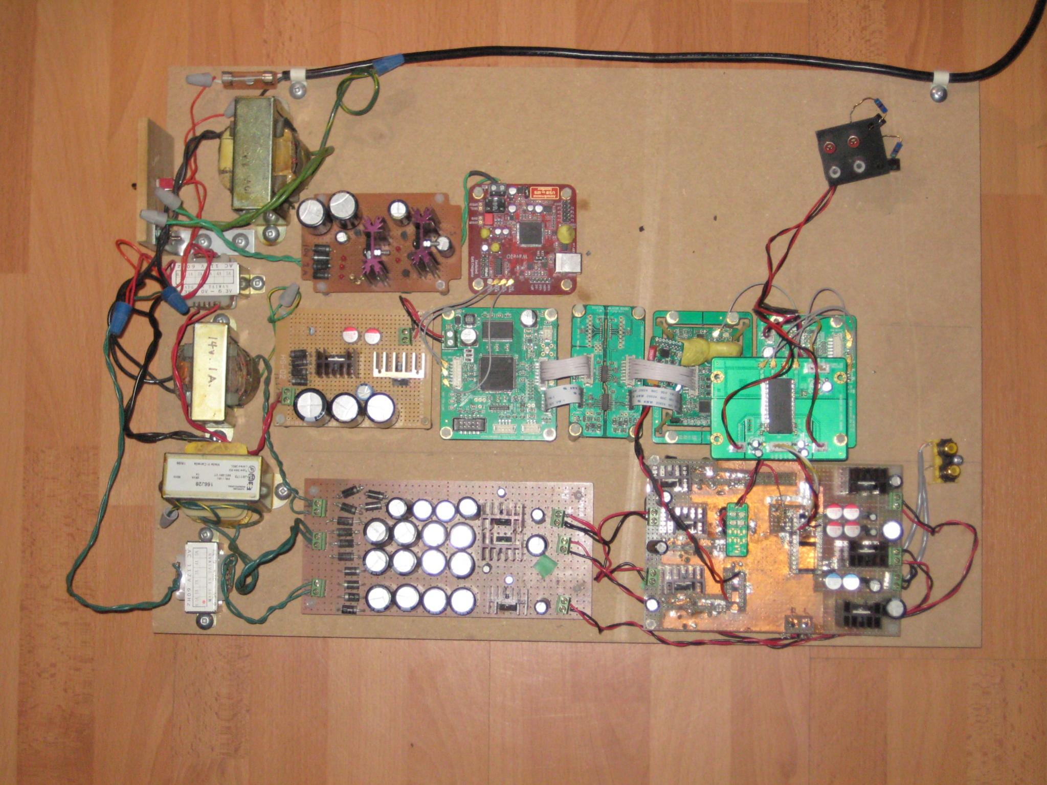

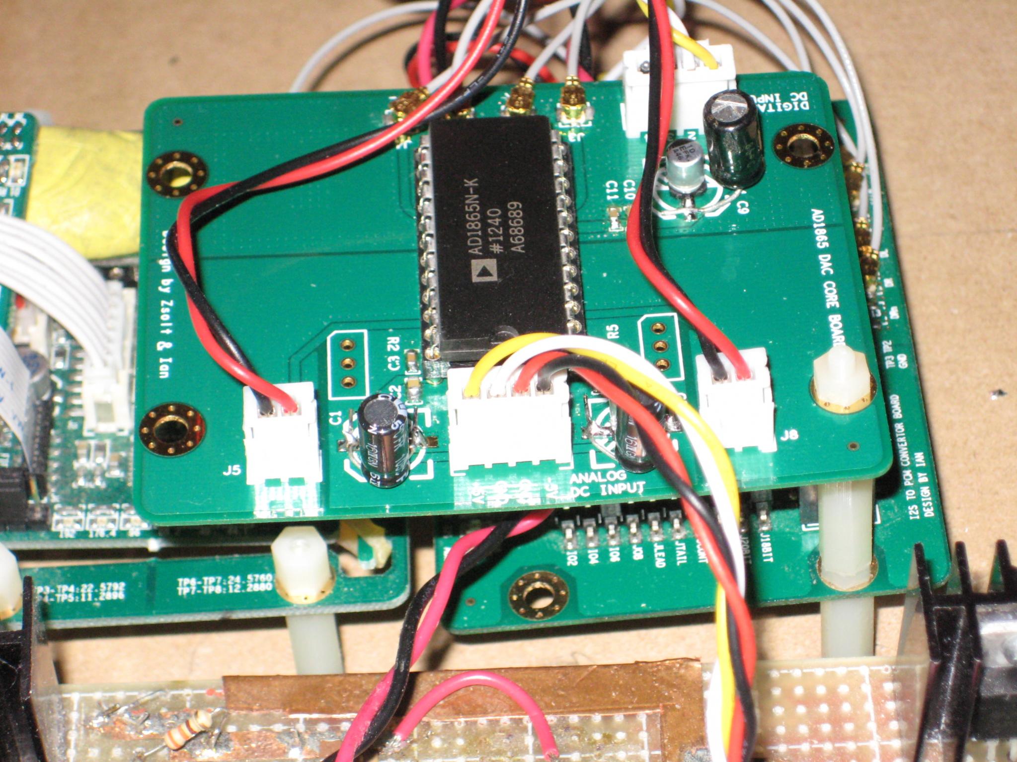

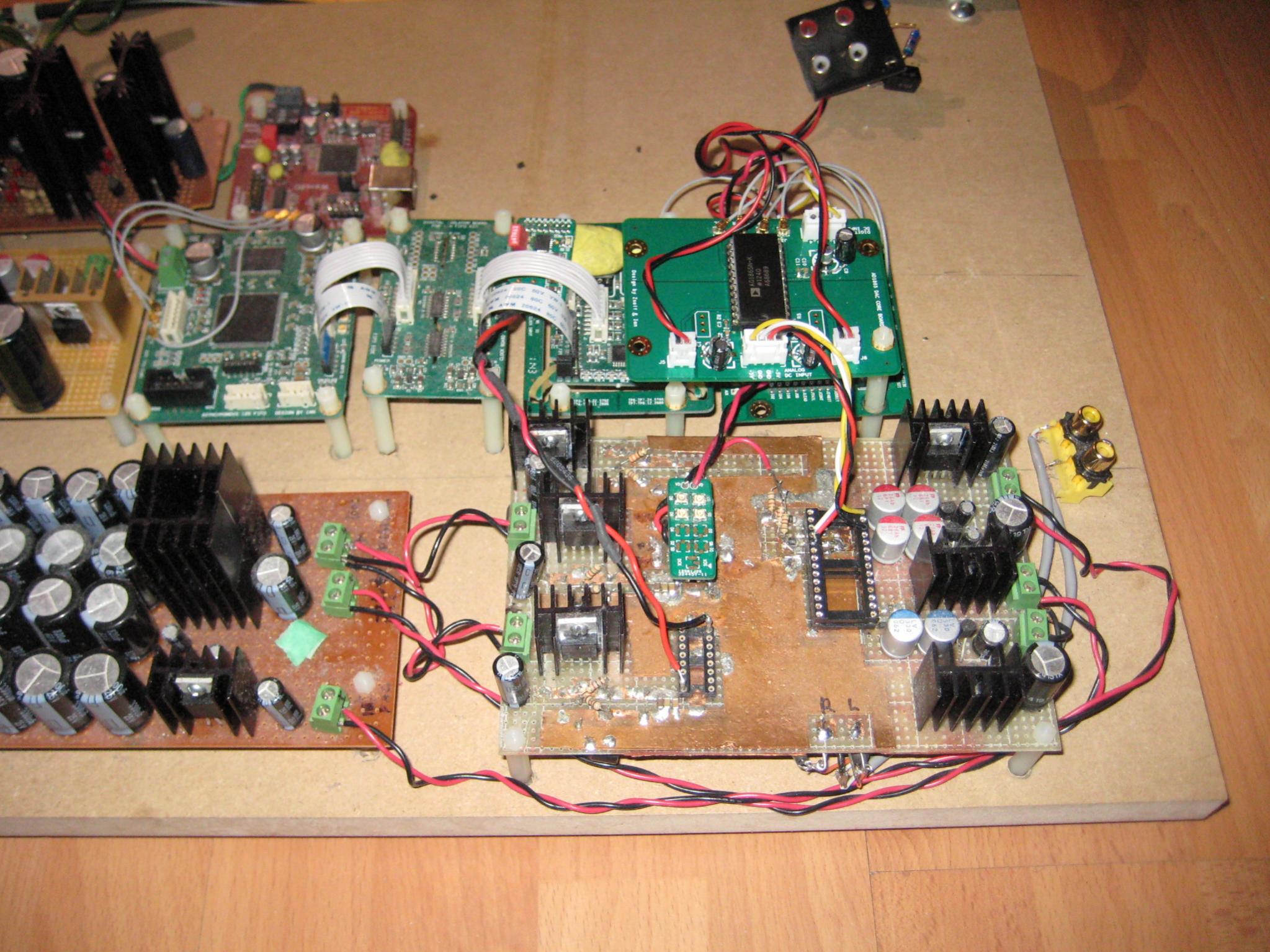

Here are pictures of my board and the dac system that it is attached to.
The construction went smoothly except I applied too much solder paste on C8 (X2Y cap) and I ended up with a short when I checked it. With smd components I always order extra so I redid it with less paste and all was fine.
I also noticed that the electrolytic caps that I ordered (Panasonic FK series) were a lot smaller than the caps on your board. It was then that I realized that I didn't check for fancier caps such as aluminum organic polymers when I ordered the caps. In the end I checked my parts box I found one used Black Gate 22uf which I added to the digital supply and two Panasonic FR 100uf to the analog supply just to feel good.
For power, the digital supply is from the I2S-PCM board as you had done. The two analog supplies are from my diy veroboard/copper foil TDA1541a board that I had done years ago and that I still use. I took off the TDA1541a and took the +5 and -5 volts off the chip supply socket pins. The I2S-PCM board power is also from this board, but from a now unused socket that was previously used for a reclocking chip. I built this board a few years before Ian's fifo was a reality. All of the supplies on the board comprise LM317 pre-regulator, LM317 constant current source, ferrite rings with choke in between, TL431 regulator, and various capacitors including smd at the power pins. The supplies (and veroboard/copper foil board) were based on Thorsten Loesch's tips and recommendations in this diyaudo thread:
http://www.diyaudio.com/forums/digital-line-level/203511-any-good-tda1541a-dac-kit-36.html
For IV, I used a 50 ohm resistor paralleled with a 10nf capacitor. I didn't want to use a higher value resistor because the output goes to a 5842 tube stage that I use with my TDA1541a, and the 50 ohms give enough voltage so that the 5842 output is not too high.
The AD1865 chip was purchased on ebay from China. It is labeled as AD1865N-K and the cost with shipping included was less than 17 USD. I don't know if it is a genuine N-K or not but it works. It seems to be a fairly low price for a N-K and there seems to be a lot of them available on ebay.
After listening to this board for a day, I think that it is similar in sound to my TDA1541a. I don't know whether I can say that one is better than the other. I can say that I enjoy the music from both boards and that is all that matters to me.
Again, thank you for the board.

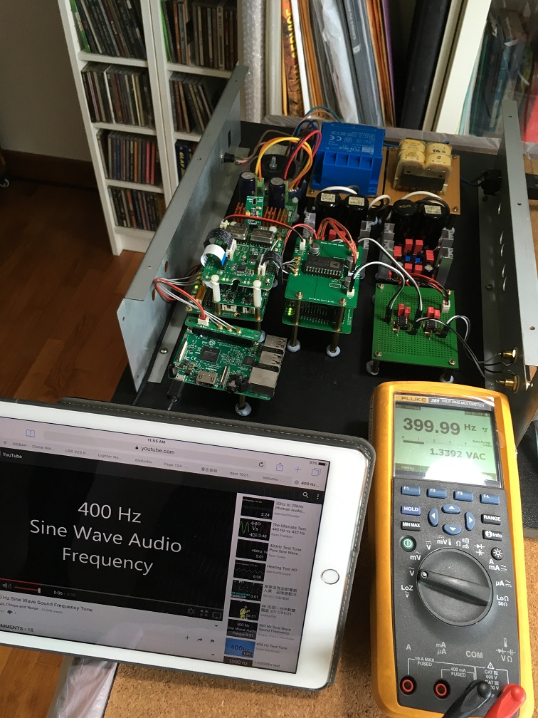

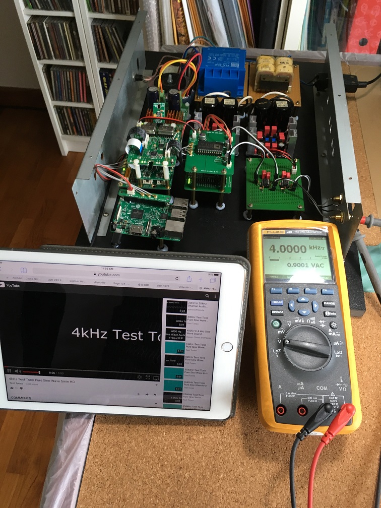

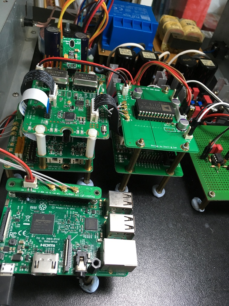

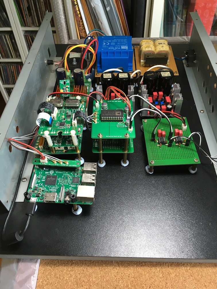

Hi Vzs & Ian,
Managed to get the AD1865 core board to sing with the following setup.
Rpi>Ian Fifo>Ian Isolator>Ian Dual Clock>Ian PCM>AD1865 Core Board>Opamp IV
Still trying to figure out what is wrong with the previous Kali setup, but this confirmed that the AD1865 Core Board is good and thank you both again for the wonderful creation 🙂
Next on the test bench:
1. Triple AD844 IV
2. OPA861 IV
3. Sen & Cen IV
Cheng

Hi Cheng,
Very well finished DAC. Good and clean setup. Good job!
I'm interested in your I/V, if it is possible, please give us some information.
BTW, you have an oscilloscope on your cell phone? What's that?
Good weekend.
Ian

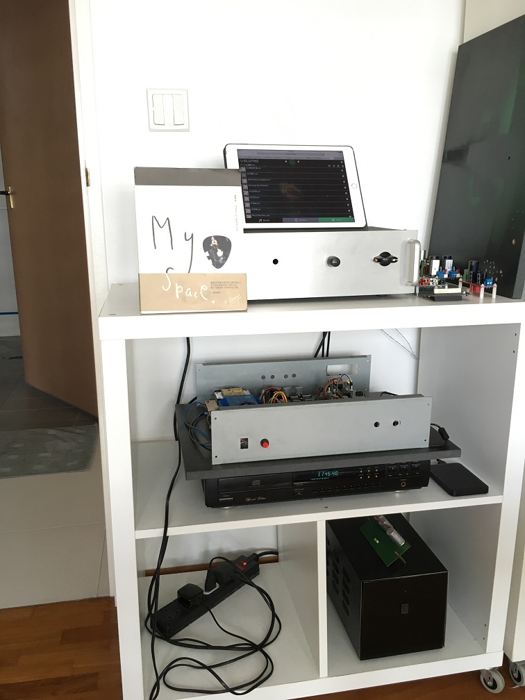

Hi Ian,
Thanks for the compliment. It is just an quick simple dual opamp iv stage that I have done up to test on the dac. Nothing fancy.
The ipad is use to stream the frequency signal from youtube (via volumio) to rpi for testing purpose (to confirm the output) before connecting to amplifier & speakers.

Thanks Cheng, can you give the links to the test signals? Very good idea.
Ian
Hi Ian,
I not sure if anyone does this, but i find it useful and convenient to check the output via DMM before connecting to the system. Below are the link for all the test tone. plenty from others too.
