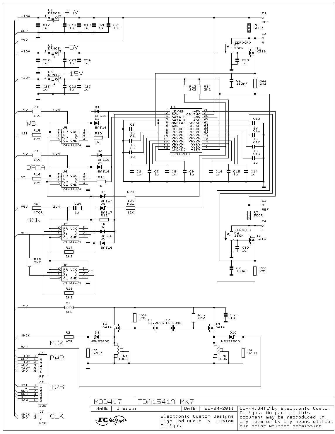

Ian, when you have time please have a look at this: TDA1541A schematics. We don't need from here the PSU part and the 74HC175 reclocking but seems that DEM clocking needs a master clock (MCLKI) input. Do you think one of this beast will fit on an 80x60mm board?
Zsolt
Yes, schematics are impressive and really fine.
Solution of 14 SMD 1206 size decoupling capacitors is simple and perfect, as ordered 🙂

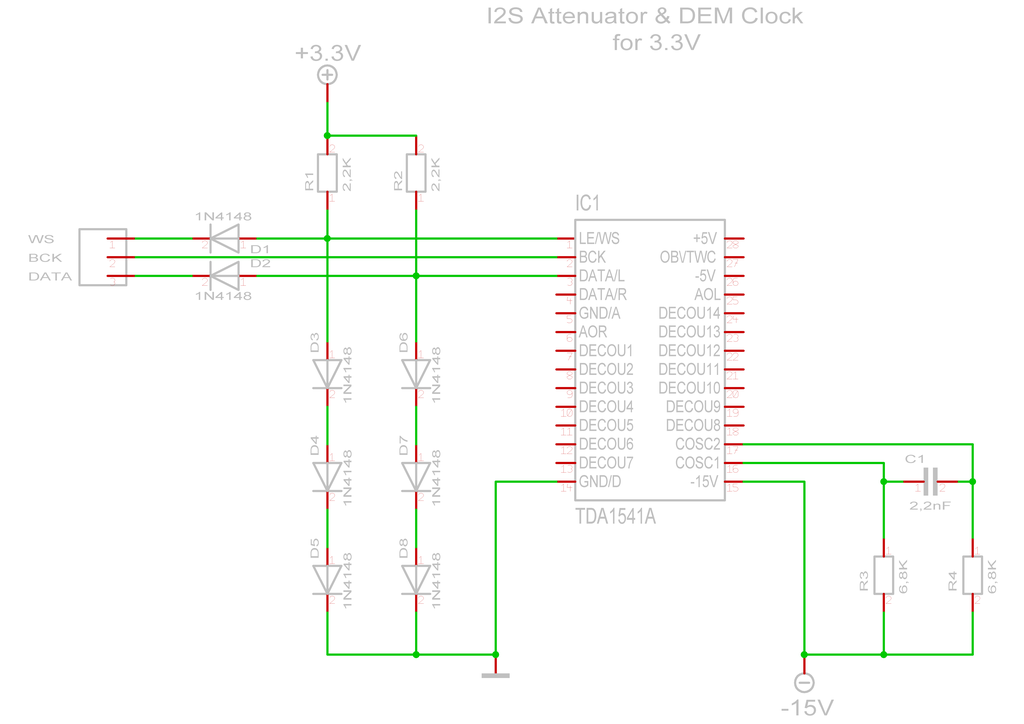

Maybe I'm wrong, but it looks like digital attenuators in TDA1541A schematics are for 5V, not for 3.3V signals.
I2S-PCM board output signals are 3.3V.

Concerning 3.3V attenuators - I'm not sure those are needed at all, because "bouncing effect" is most sensible with 5V levels.

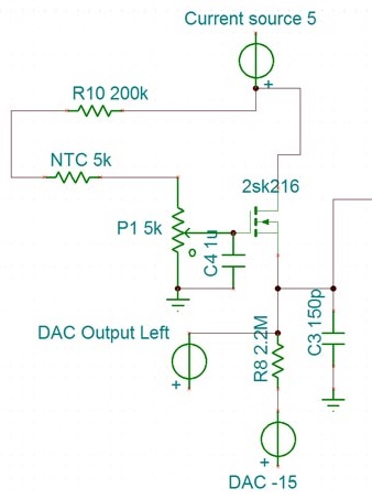

- the board should provide a CCS to nulling the offset caused by the current output characteristic of the TDA1541A (from 0 to -4 mA). Also, this offset circuit should have very low drift. Somehing similar to the circuit used from Oliver in his Red Baron should be ok, adding an NTC.

- for the I2S attenuation i'll post the link to John's solution

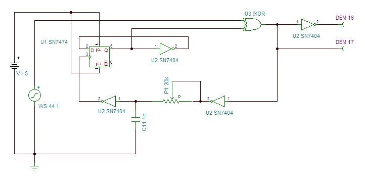

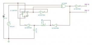

I prefer free running DEM, but with possibility to connect external clock. Look into attachment for Olivier's (with help by John) schematic for free running DEM clock as well as 3.3V version of I2S attenuator.
We can use same attenuation circuitry for DATA/L and DATA/R, BCK and LE do not need attenuation. Problem here can be 3.3V clean source.
If you mean excellent MK7 type reclock with D flip flops without passive attenuation, I have attached that schematics here, but I doubt we would use such a complicated circuitry for debouncing in core board...Link is here - http://www.diyaudio.com/forums/digital-line-level/79452-building-ultimate-nos-dac-using-tda1541a-366.html#post2549175

I would vote for 1206 size capacitors SMD type, like in schematics provided by Zsolt: Setup TDA1541A DAC, on the bottom side under TDA1541.

- I2S attenuation: noizas has just provided the schematic, I subscribe that way
- offset nulling: we could use part of Red Baron schematic, with 2SK216, removing the IV resistor and adding an NTC in series with the trimmer (I attach a schematic, courtesy of Ryanj). The 150pF capacitor at the output limits the bandwidth.

Again, the TDA1541A DAC chip is totally different from the other DAC. In my AD1865 DAC there are a few components (DAC chip, one 74HC04 and a few decoupling capacitors), but the TDA1541A is another story.
I subscribe for all above - it is all reasonable, main ideas are tested by many DIYers and flexible options are welcome.

Thank you guys for extracting information about open questions.
Summarizing:
- All core boards are thought to be used after I2S-PCM board only, _no I2S input_: dvb projekt comment about I2S input when testing I2S-PCM with his Red Baron v5.0: "i will never go back to the I2S input!"
- free running DEM clock: support for both SMD (1206) and thorough-hole (5mm ?) footprints
- sync DEM: master clock U-FL input needed only for this DAC
- IV resistor: since many are using these DACs with passive I/V (resistor || capacitor) and require low board space I think we should add this
- I2S attenuation: schematics attached by noizas in #53 - will need to recalculate the 2.2K resistors for 5V supply
- offset nulling: Pedja's Aya DAC shows a simple solution around a low noise JFet
- decoupling: SMD caps only (Successful PCB grounding with mixed-signal chips - Part 2: Design to minimize signal-path crosstalk | EDN)
- paralleling: only dual-mono configuration through provided U-FL connectors. Piggybacking ICs or core boards (e.g. with pin headers/connectors) will not be provided due to signal integrity concerns
- size: with most of your suggestions it should probably fit on a "standard" size core board - don't know exact size yet but will target 80x60mm
Thanks,
Zsolt

Excellent summary 🙂
1. About free running DEM clock through hole capacitor:
most of polystyrene in range 470pF - 2nF are 3-8 mm in diameter, as usual about 10mm lenght (depends on voltage). So it would be better to have at least 7.5 footprint.
2. About I/V resistor - I would make two sets of footprint - for axial and for compact size (MK132).
3. LVTTL 😉 attenuation with 5V instead of 3.3V: I see no need to increase 2K2 resistors, because signal swing anyway will be between 0.6V and 1.8V (diodes), just current through 2K2 will be increased by 0.8mA.
Change 2K2 to higher value would lead to worse slew rate on inputs of TDA1541 (increased RC value).
However this suggestion simply replace 3.3V by 5V source should be checked by Ian - I do not know I2S-PCM board's output capability to sink such additional 0.8mA current (actually almost 2mA instead of 1.2mA).
Saulius
TDA1541
One aspect regarding TDA1541 core board was not decided: synchronous DEM clocking
I'm not sure we should follow Setup's design as there are many different DEM clocking circuits floating around... from ones like Henk Ten Pierick’s to others using a simple inverter on BCK. Also this thread discusses TDA1541 DEM reclocking but I'm sure -ecdesigns- marathon thread has lot of information.
Which implementation should we use?
What about having free running DEM clock only on the core board and have synchronous DEM clocking on a daughter board - e.g. simply plugged into an 14pin IC header or similar - one could try different implementations like that. Nevertheless we should implement one of the synchronous DEM clocking solutions on this daughter board.
