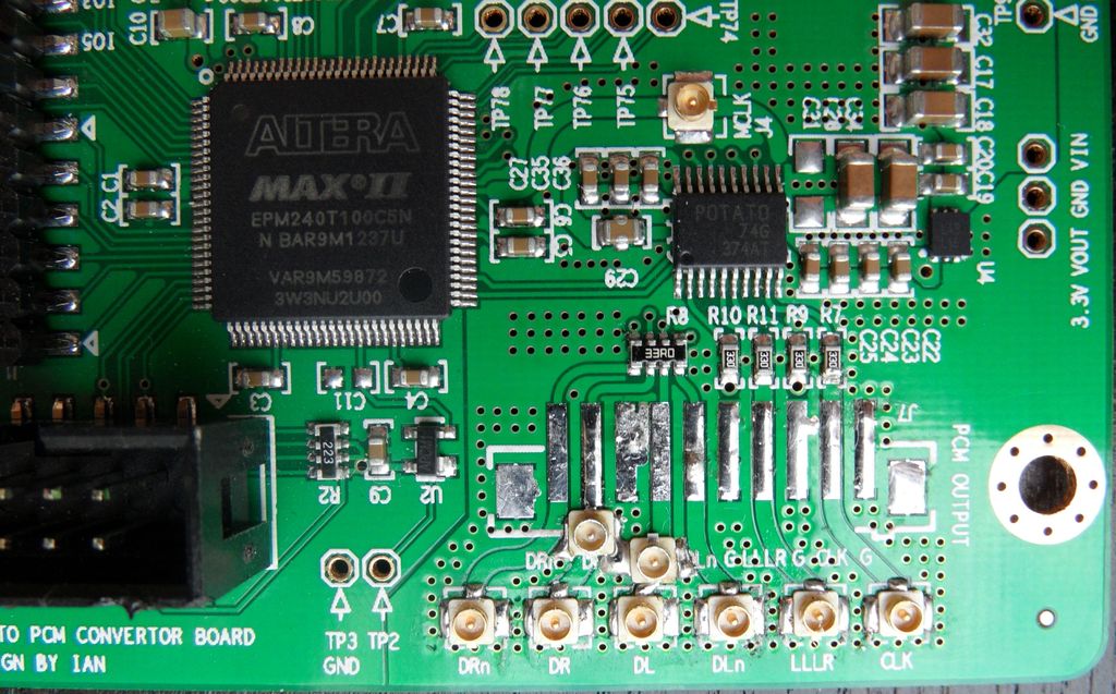

Multibit DAC core boards coupled with I2S-PCM driver board
Since the I2S-PCM driver board is soon to be released the idea came up to create some bare DAC boards that could be coupled with.
The concept is a core board for multibit DACs, with keeping anything else such as digital front end, I/V, power supply external. To reduce the complexity and cost each DAC will have its own core board with same size and same interface, so it can become a standard part in the system.
Why only a core board with everything else external?
- to let us easily swap the DAC
- most of us already have different breeds of power supplies
- some may have an I/V but want to try out others. Would be nice to continue this idea for different I/Vs as well.
There were some starting ideas about this board:
- 2 layers (if mostly possible)
- options for stereo / balanced / dual mono configurations - this means it has to hold 2x stereo DACs or 4x mono DACs
Open questions (that comes to my mind):
- size of the board
- how to integrate it with other components
- power supply options
- I/V options
Once we decide about the questions, volunteers are needed to design the PCB and/or prototype and test it. I'm offering to design, prototype and test the AD1865 DAC and later on the PCM1704.
L.E. Policies for better readability: since this thread is dedicated for multiple core boards let's use the Title of a post to differentiate between subjects, like this:
- Core Board: posts related to standardization of the core board and _not_ specific DACs related: e.g. size of the core board, connector placement, etc
- AD1865: related to this DAC
- TDA1541:....

Core Board
The main idea is that all DAC boards will share the same size and have the same connectors to be easily replaceable.
Data input: all output connectors of I2S-PCM driver board: 10pin PH2.0 + all U-FL connectors.
PSU input: highly differs between multibit DACs but I think +0- for analog side and +0- for digital side covers all: so 2 x 3pin connectors.
Output: Since we have dual-mono/balanced then 4 x 2pin connectors.
Size and placement: we have from 20pin SOIC (PCM1704) to 28pin DIP (PCM63) everything. If we want to stick to the dual-mono/balanced setup for most common multibit DACs we have to be able to accommodate the largest footprint needed 4 x 28DIP. Maybe the size of FIFO-Clock board would be enough and this board could be placed alongside FIFO-Clock board...

Core Board
Size matters 🙂
I made some sketches with DACs to see how they fit... Those DIP 28pin mono DACs are mammoths, they need double space in comparison with smaller ones. If we want same size boards it's a waste of space/money when used for small ones.
I suggest to keep the balanced/dual-mono idea for small DACs and make stereo core boards for large DACs. If dual-mono or balanced is wanted for those simply stack them and use U-FL connectors - see how dvb projekt did the same with his DACs used in parallel.
If we go this route the core board could be the size of I2S-PCM board.
