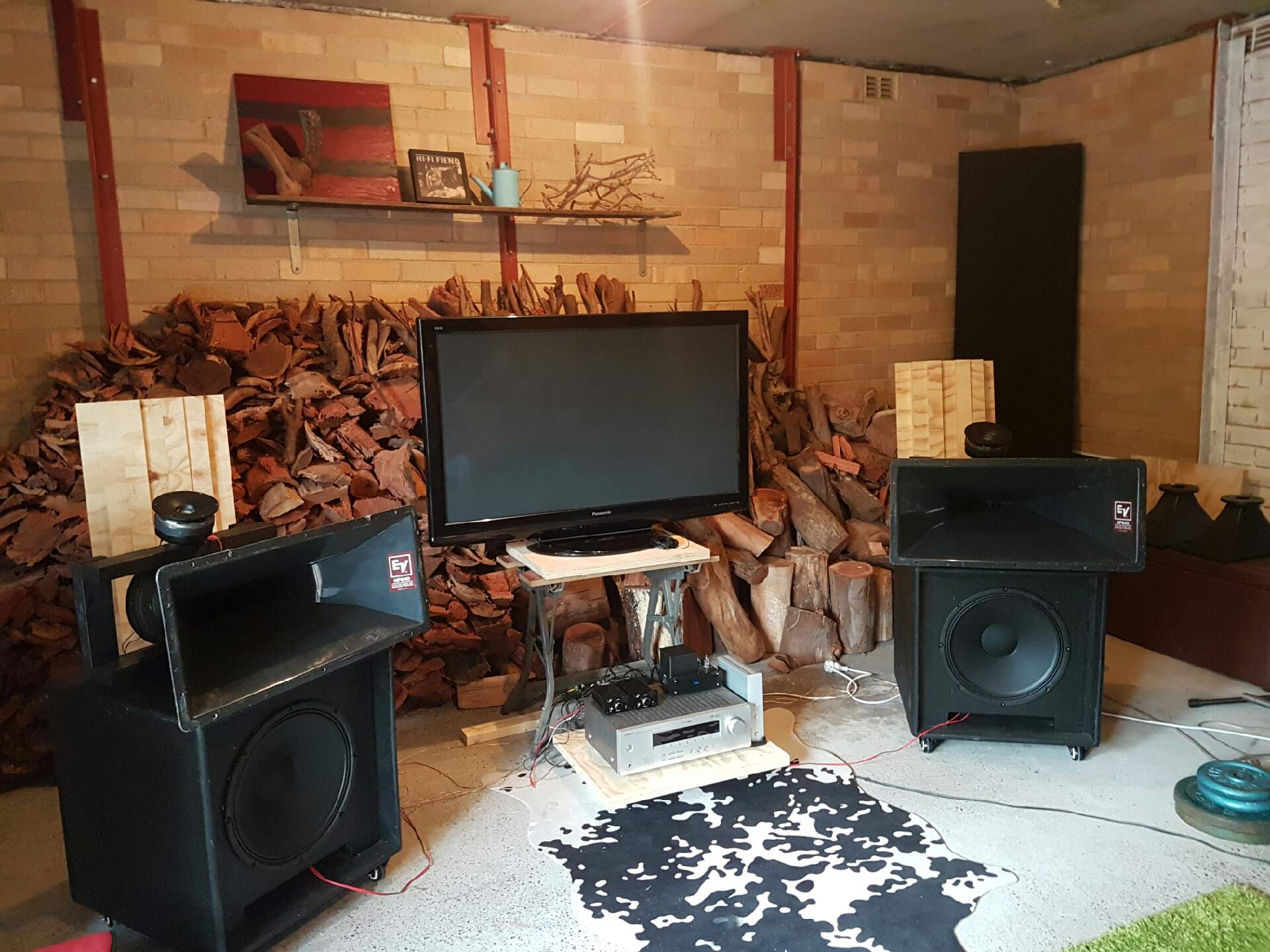

Yes that's pretty much the plan. I swapped parts in and out over the weekend, measured, adjusted and listened. Conclusion was that I prefferd the EV 12" driver as a midrange over the horn loaded cone and comp driver. It just has a better illusion of scale from 500hz to 1000hz. The horn goes omni below 500hz but above this does a decent job. I tried with and without the ribbon and preferred with. I find the highs cleaner and smoother than either domes or compression drivers. More experimenting to follow.
I'll take some more measurements and photos of the diaphragm for you when I get a chance. Stay tuned 🙂
I have the celestion woofers installed and all sounds good without any measuring or tweaking as yet
I installed some room treatment and the effect is dramatic to say the least even when using the horns to control directivity down to 700hz. The source of the sound completely follows the recording and with eyes closed I can't locate the speakers.
The most intersting result was swapping the mcm waveguide for a a VERY wide angle visaton tweeter waveguide with the 1" RCF compression driver. The sound is so clear, clean and wide without any colouration. I'd like to experiment more with wider angle horns.

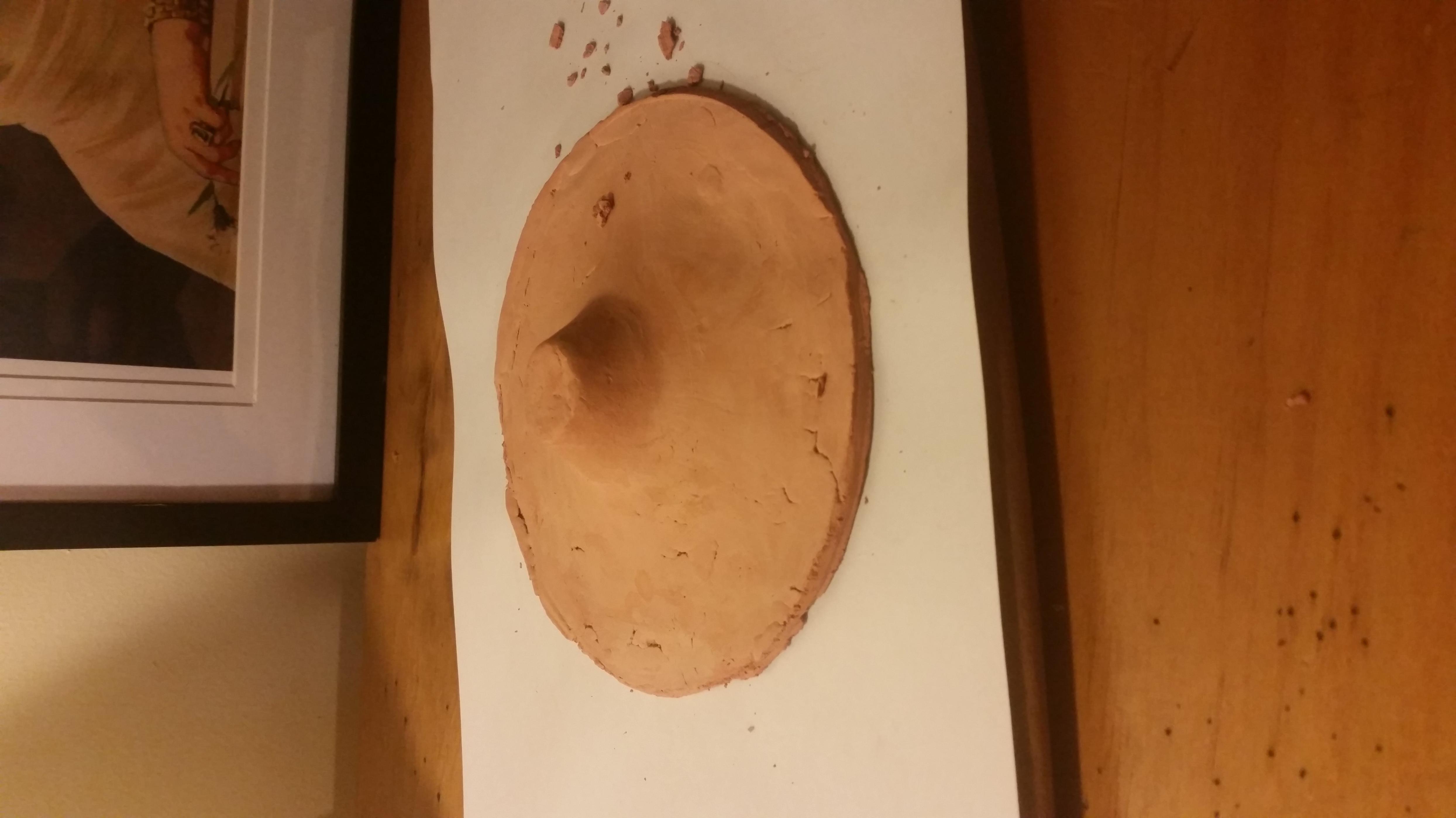

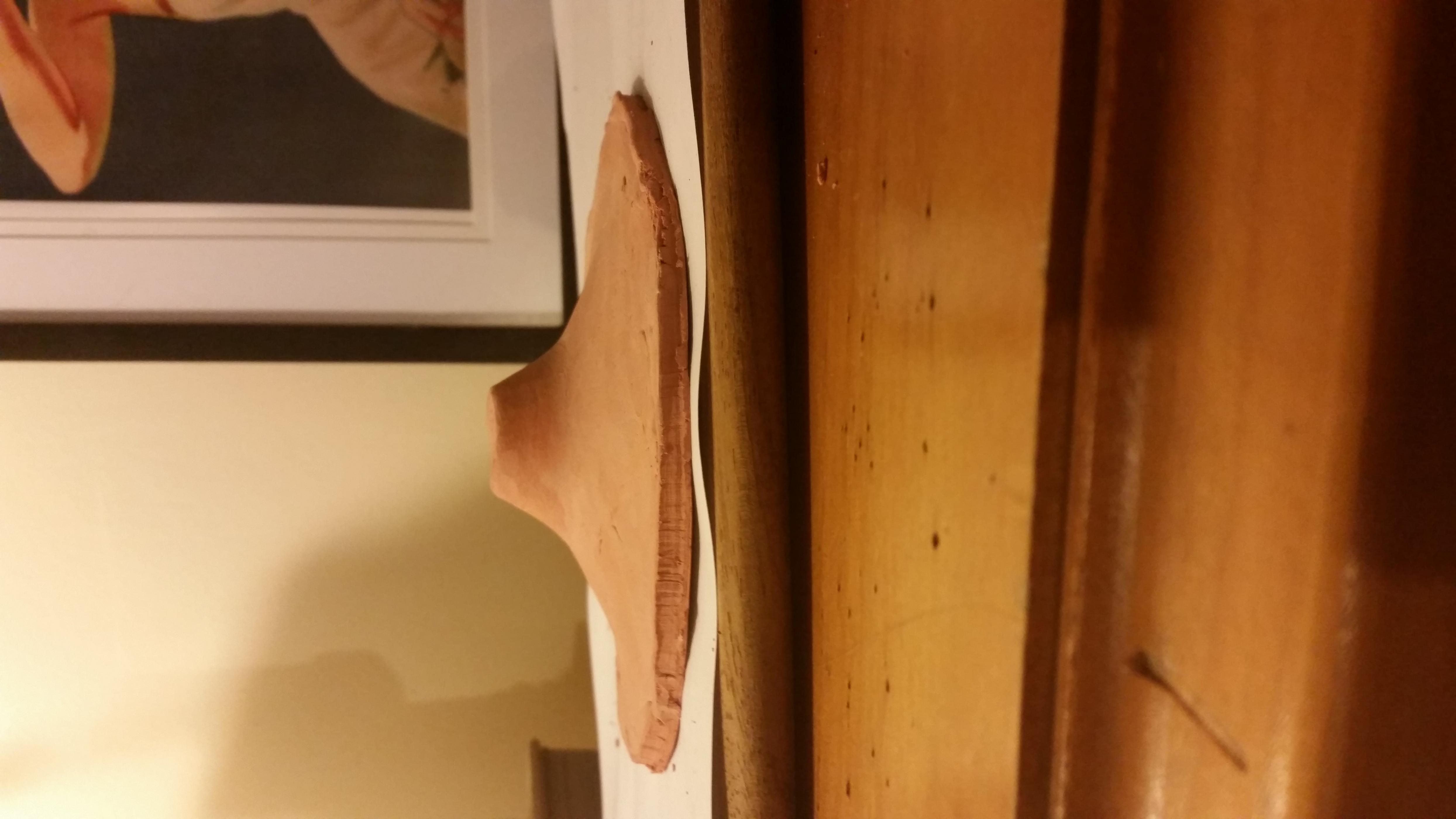

How even/accurate do you expect to get it frangus?
Probably good enough for some experimentation. I'll use joint compound and sandpaper to level out the depressions and fill the gaps.

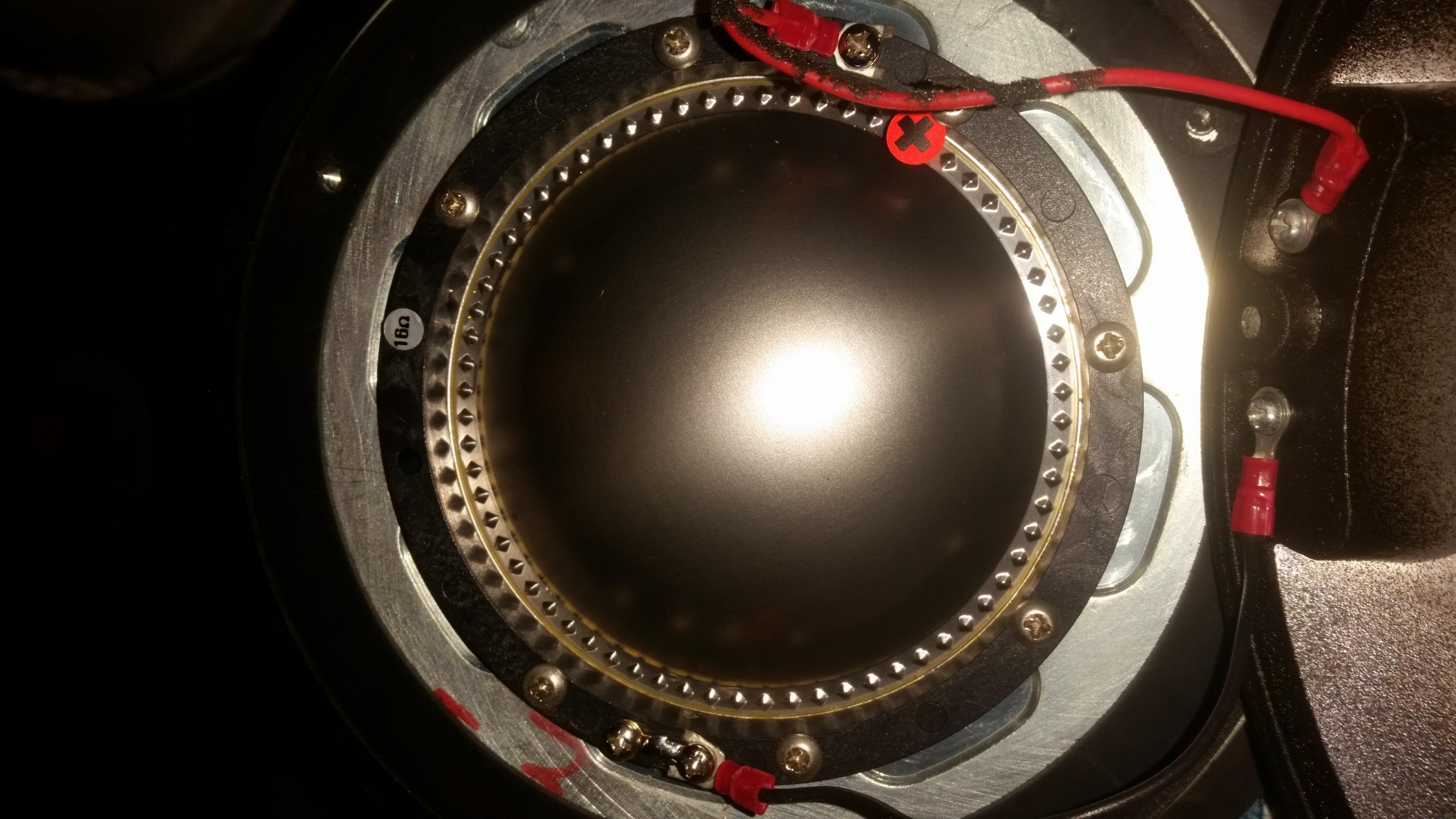

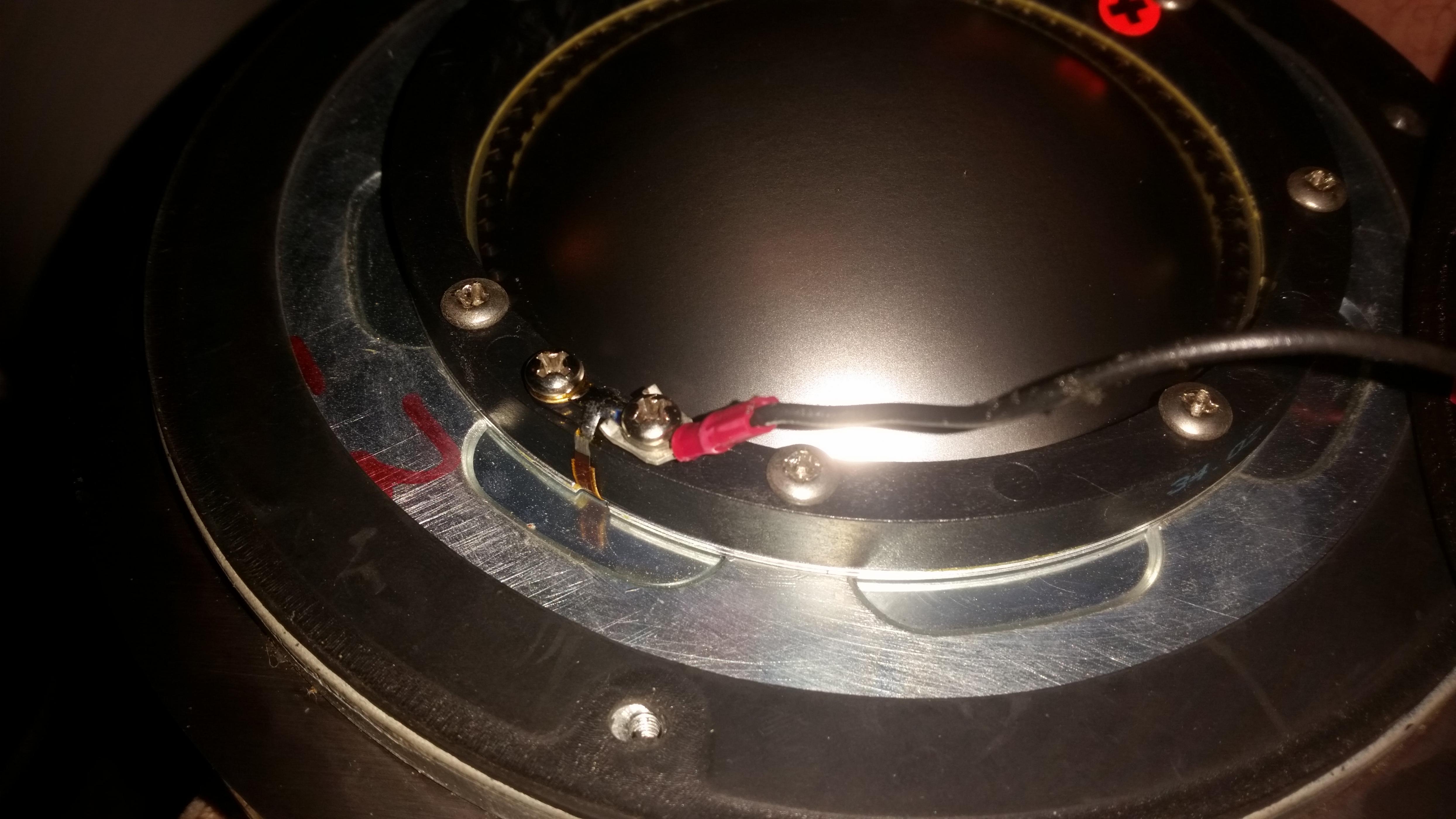

Hollowboy, see photos of diaphragms below. Both the same, both in good nick it seems. Are yours the same?
Your drivers do look like they are in good shape.
Thanks for the photos. The diamond-embossed suspension is the same, but mine have ribbed domes.
I think that means yours look like originals (or clones based on them), and mine are more recent (or clones based on them). I just posted a new thread asking for info on them.

Edit - poking around that website a bit more - yours might be the SS audio aftermarket parts. Some of those have the little "+" sticker on the positive terminal, whereas I think the originals simply had a dab of red paint.

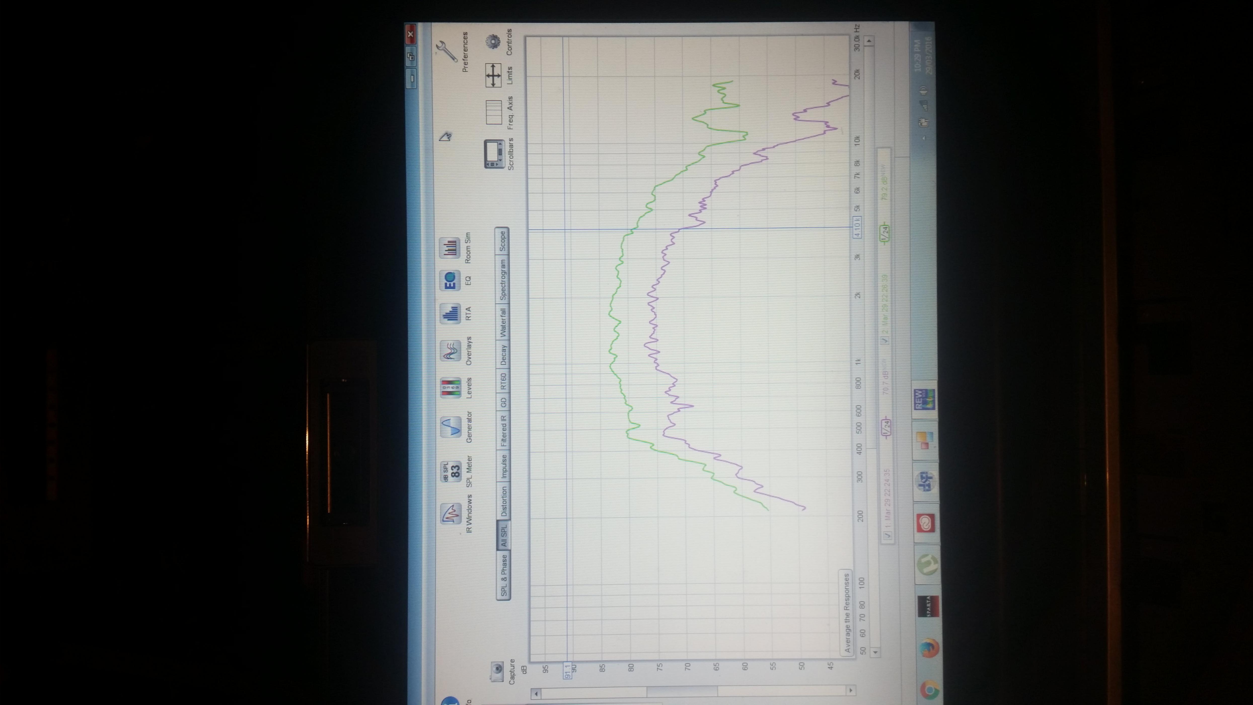

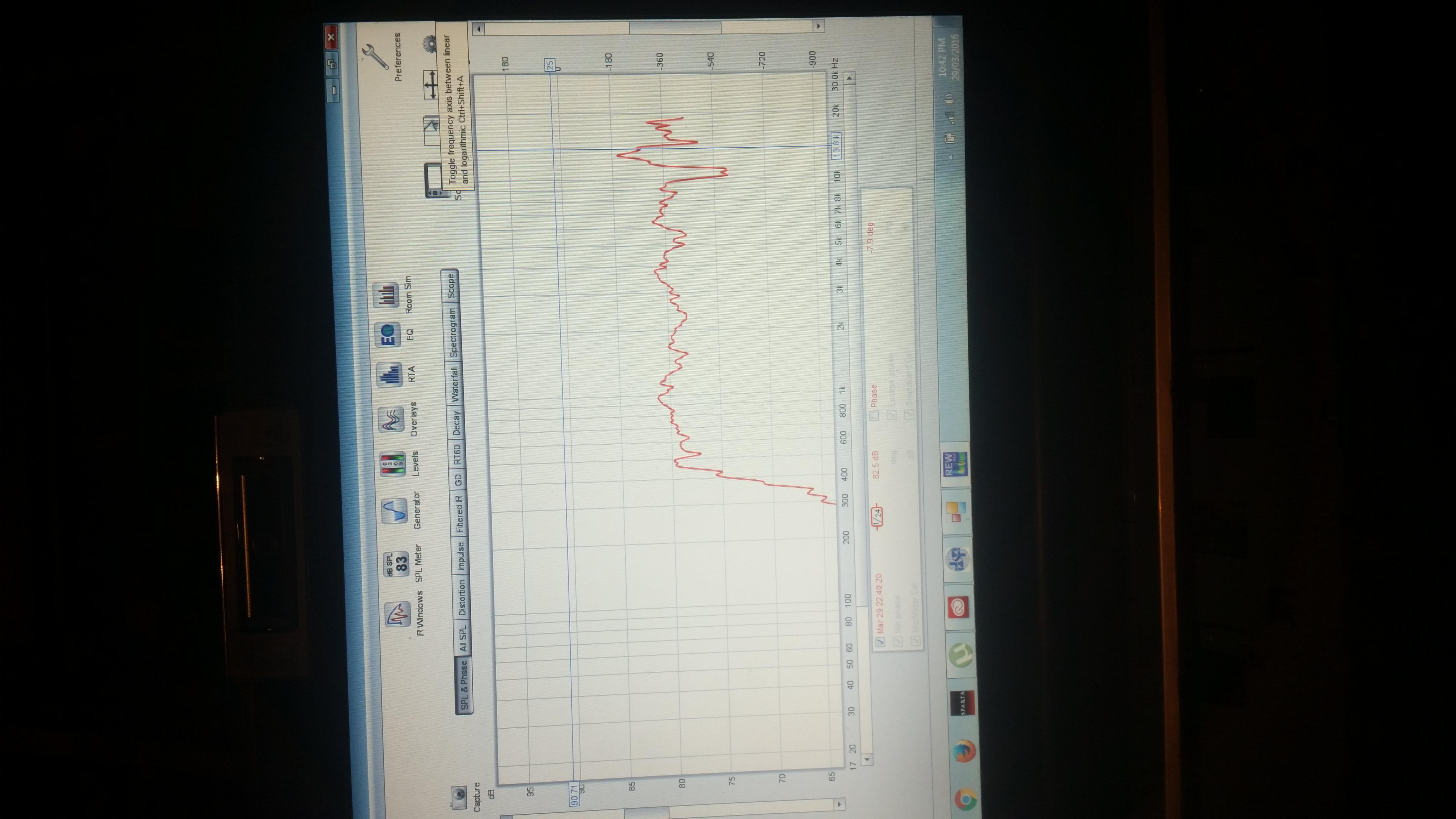

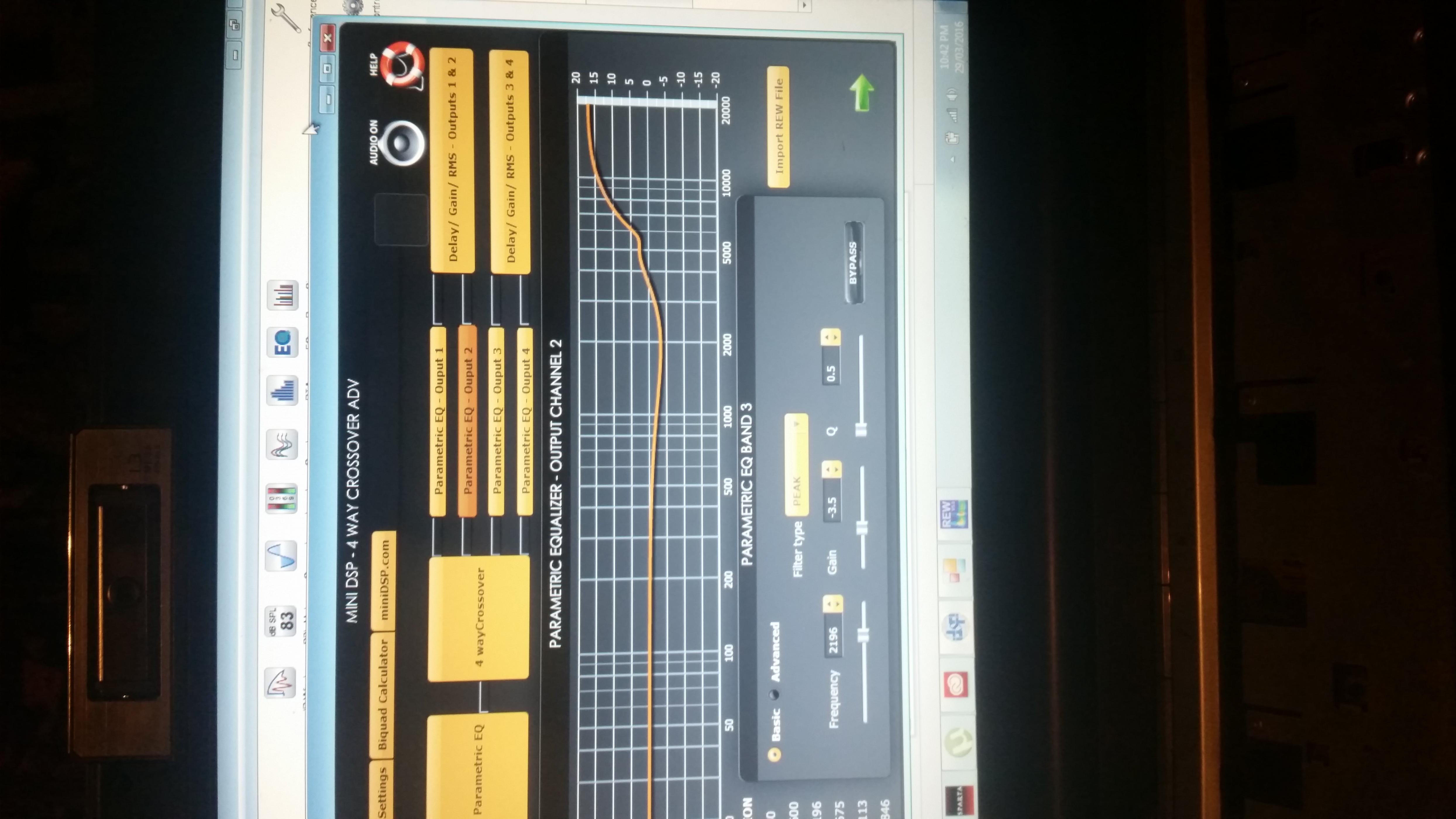

Measurements of 2445J on VFM 2" bi-radial horn attached
1. raw on-axis and off-axis
2. CD response corrected
3. MiniDSP correction EQ screenshot
These are ungated taken at about 2" in front of the mouth

Some progress
The EV horns were a positive addition to the system. The cabinet is undersized for the 15's and thinking of switching to an open baffle or cardioid to take advantage of the high QTS and control the pattern in the lower range.
- Multi way horn laboratory - aka man cave
