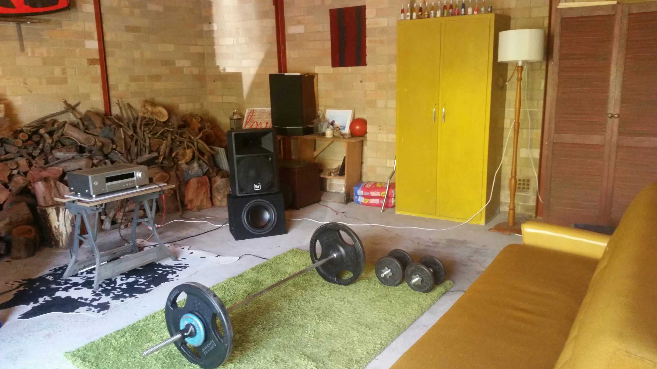

6m x 6m garage with solid walls. All mine 🙂

To start
Start with something relatively simply, to get an earful of what the room sounds like.
Set your equipment up on shelves set off to the side (NOT in between your loudspeakers) and accessible from the back as well (to make changes easy).
Don't forget to treat the garage door (for both acoustics and noise insulation) as well.
Obtain a very large cooler to store the beer in, for you and your buddies 🙂
Embryonic phase...

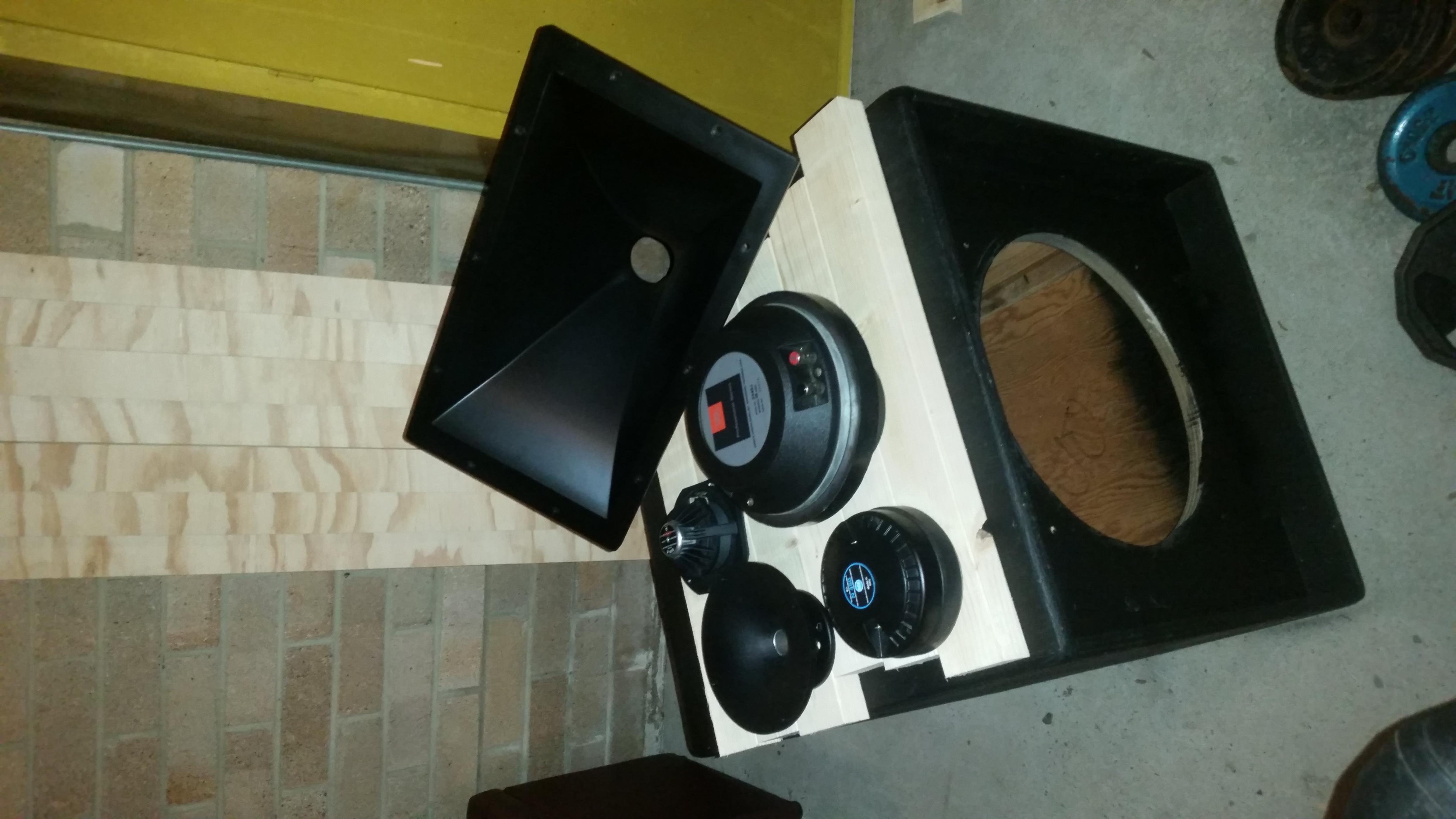

driver pics next

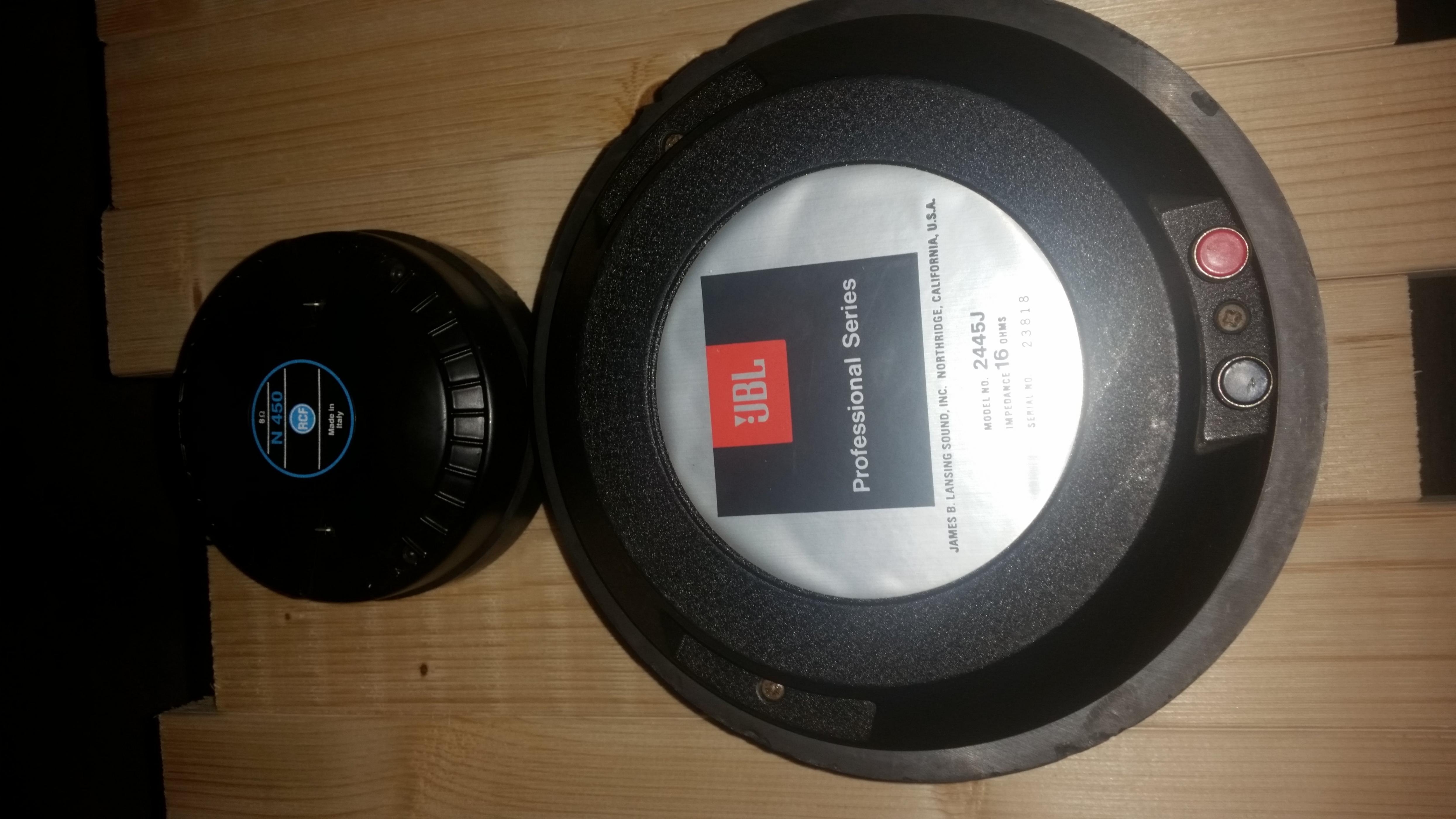

Picked up some JBL 2445j thanks to hollowboys scouting and ordered the celestion woofers earlier today. I will have all the drivers in a few days and then the fun part begins 🙂

1. The aim is to use off-the shelf waveguides to build synergy - type point source horns
2. Rather than use compression drivers, these devices use cheaper small full range drivers (that also have better lower frequency response) for treble
3. Typically, the front of the midrange drivers fire into the horn at a point <= 1/4 wavelength of the crossover point, In this case, larger drivers are used (to extend the response lower) and inject into the horn closer to the mouth. Using a DSP for crossover and delay (as well as conventional full range drivers for tweeters) allows us to still make the arrangement work.
I had most of that under my belt but you shed light on a few things. Thanks for the summary.
What im still working on is injection port size/shape/location? Seems location is as near the throat as possible? Apparently these other parameters can be forgiving?
Then i need to figure out the right sized/shaped horn.
Swell. I'd be grateful if you could post measured FR for these + pictures of the diaphragms.
(From the same seller) I have 2 cores and 3 diaphragms:
1 that looks normal, measures as expected (good, but with ragged HF)
1 that has an unusual rib pattern; HF measures better (less droop + much smoother >10kHz)
1 that has an unusual rib pattern; HF measures better when it works - but it is faulty (high Re and sometimes doesn't play at all - cracked VC wire?)
...and I'm curious about which type you got. I haven't yet been exhaustive so it may not be just the diaphragm that explains the measured difference.
