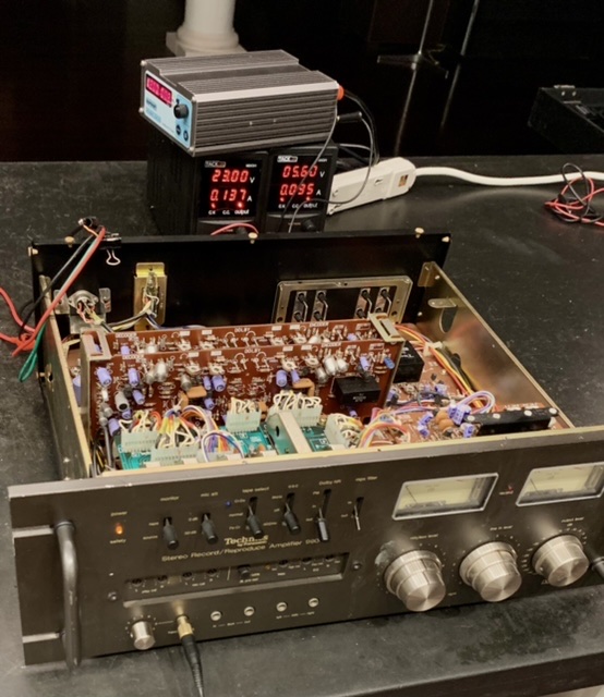

I have a solid state preamp that requires +23@135mA, +5.6V@95mA and -12V@9mV.

Technics RS-9900
No, it is cassette recording and playback amp. The power supply (and bias oscillator) is in the mechanical section, which I do not have. I use it with other devices that run at 1-7/8 ips.

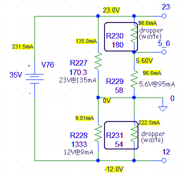

His +23..,... and -12V cleverly add-up to his "stiff 35VDC".
Altho the +23V is at 11 times the current of the -12V, so not much synergy.
Take the three specified loads, the specified power source, and two "dropper" resistors, it works out fine.
The unit in question:

Well, the synergy is really in having a simpler power source.
Couple of questions:
-- According to my calculations, this wastes approximately 5W total
-- I probably should add capacitors past the resistors to stabilize the voltages?

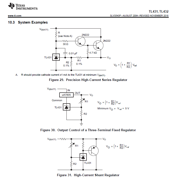

TL431
Since I am not familiar with this device, what is its function in Fig. 30, when there is already a fixed voltage regulator?
