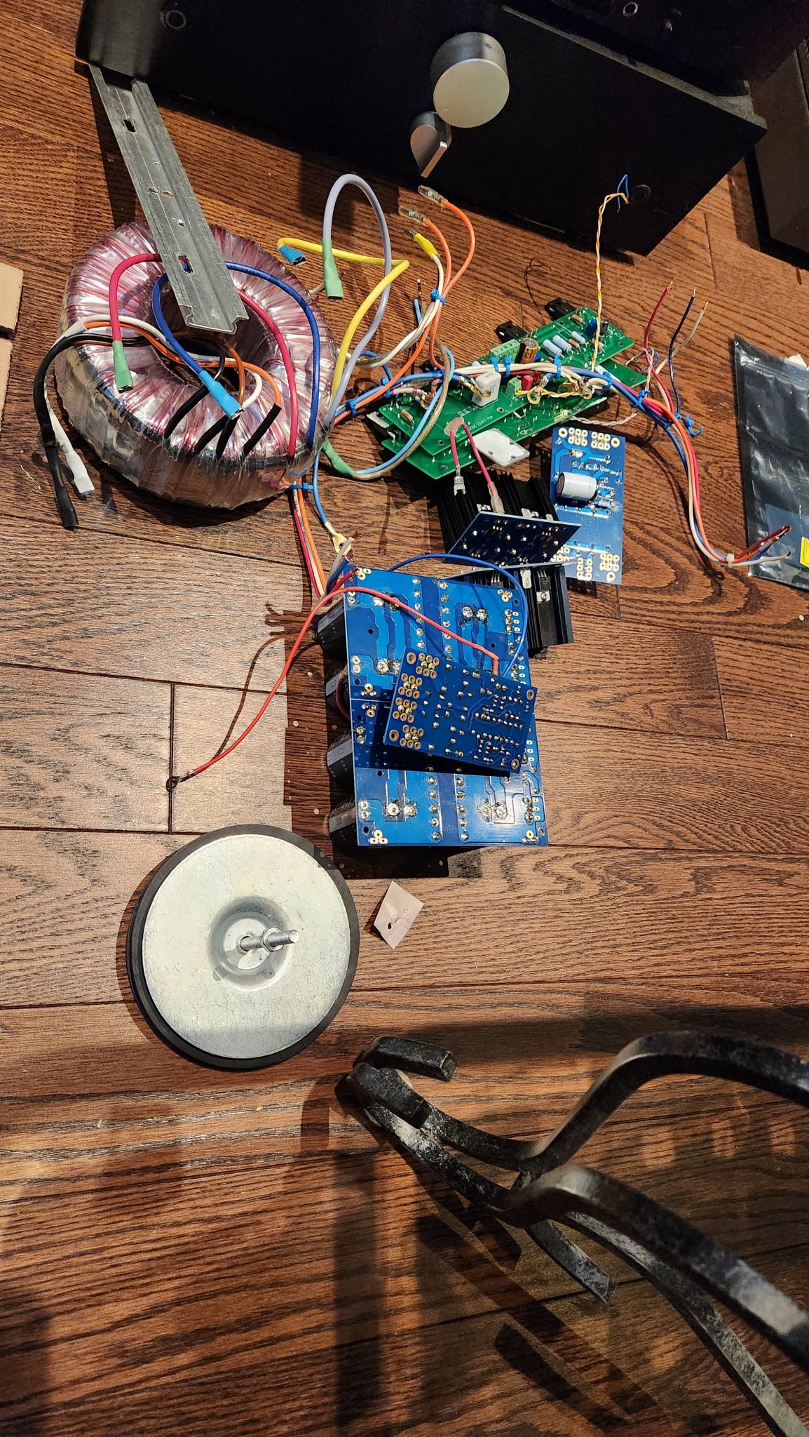

Multi Configurable Testing PCB for Papa’s SIT-PMosfet, SIT-NMosfet MUFF and DEFiSIT Amplifier

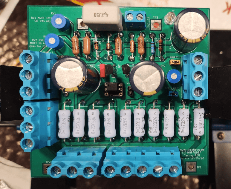

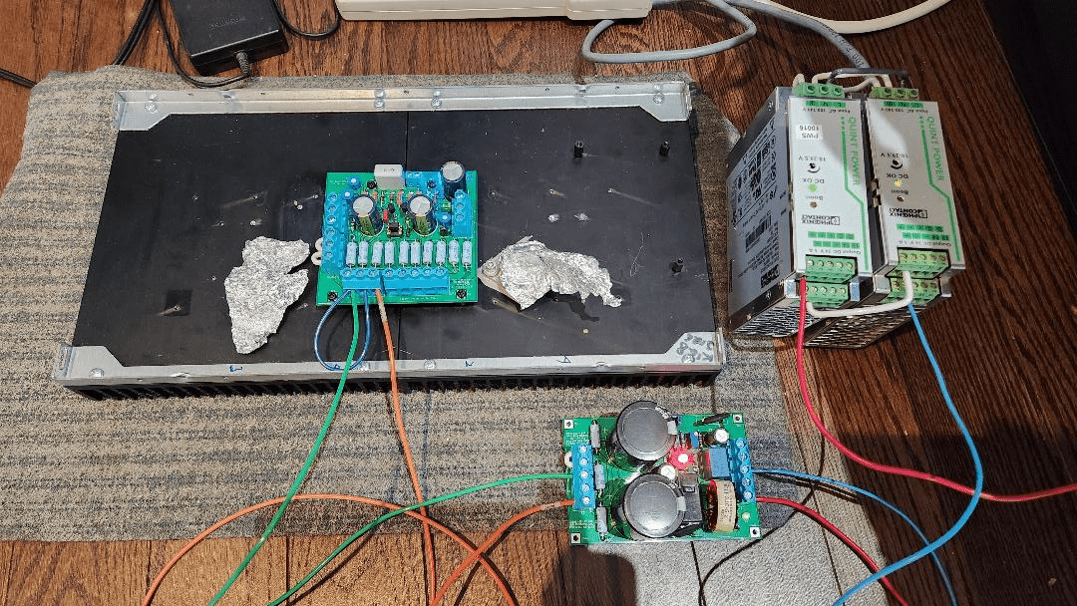

Amp boards assembled.

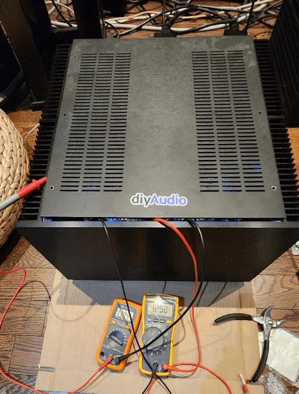

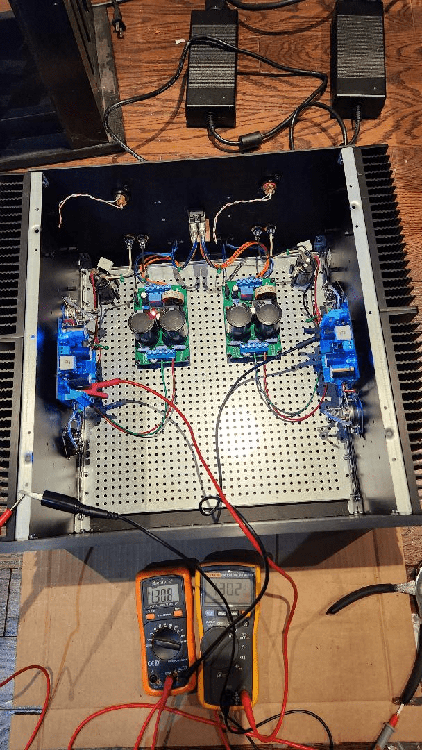

Power on without SIT and NMos. Bias preset.

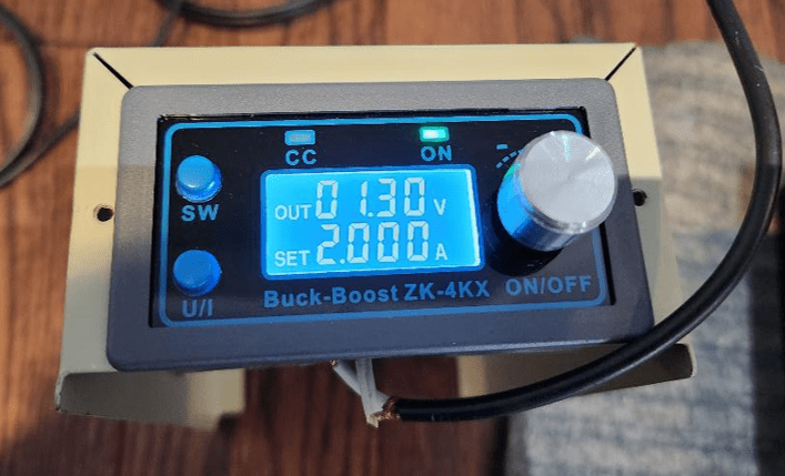

48VDC on, no smoke. Adjusting RV1, G of SIT terminal block around 22.5V. Applying 1.3VDC on S of NMos terminal block, simulating 2A bias, adjusting RV2 the voltage G of NMos terminal block to around 5.5V.

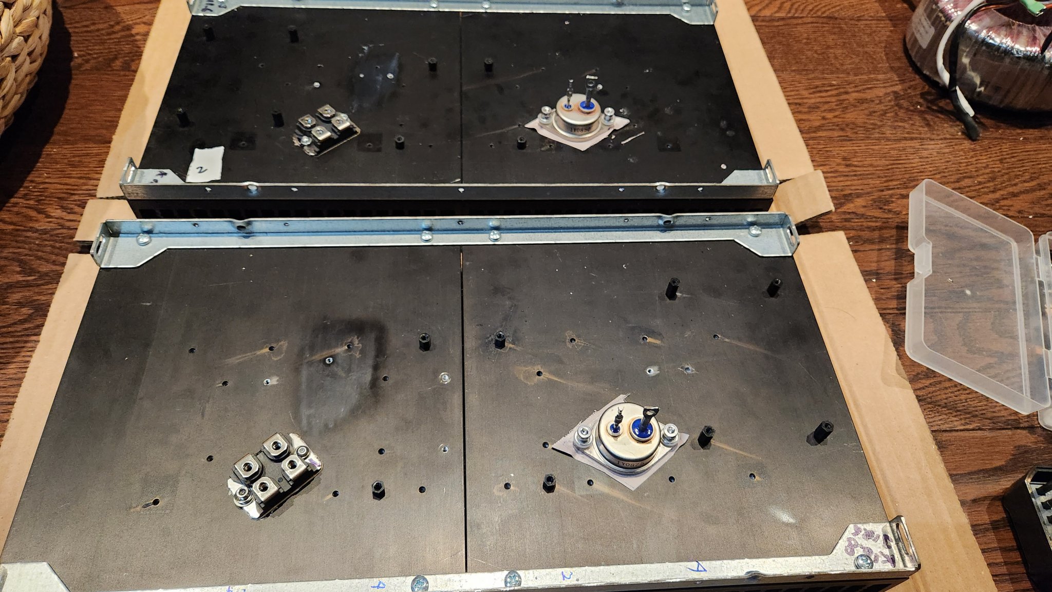

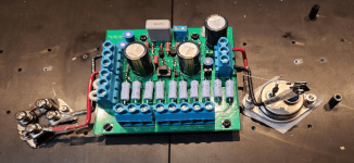

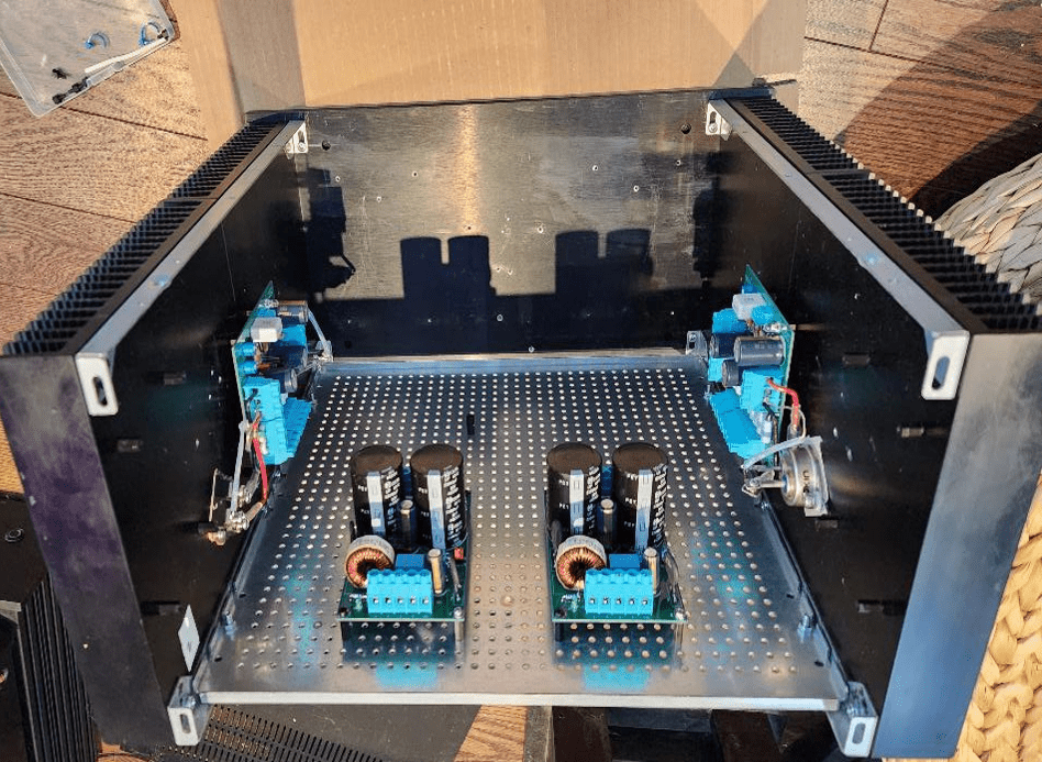

Connecting SIT and NMos, and power on again. Adjusting RV1 and RV2 again to get 24V Vds on SIT and 2A bias. It is very stable. After fine tuning of two modules, they are in the 5U case.

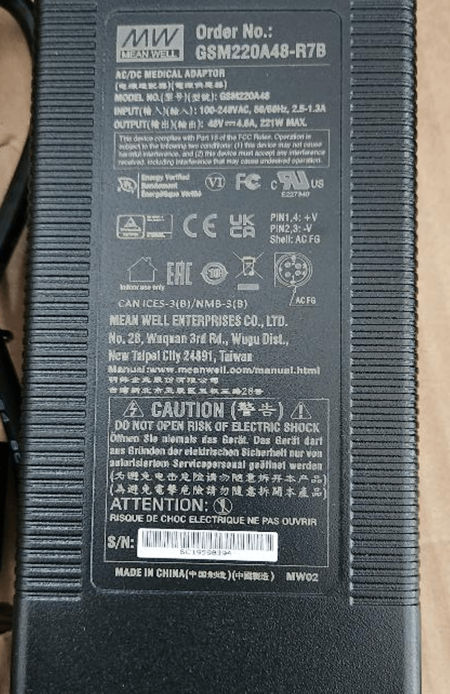

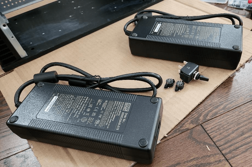

From the beginning, considering the case I have and copying Papa’s Sony V-fet, a single 48VDC power supply and around 2A bias is in mind. Checked all Mean Well 48VDC adapters, found the V- is not connected to Safe earth in its medical model GSM. All GST model including what is used in the Sony VFet has it V- connected to the earth. Two GSM220A48-RB7 are selected for the power. They are expensive.

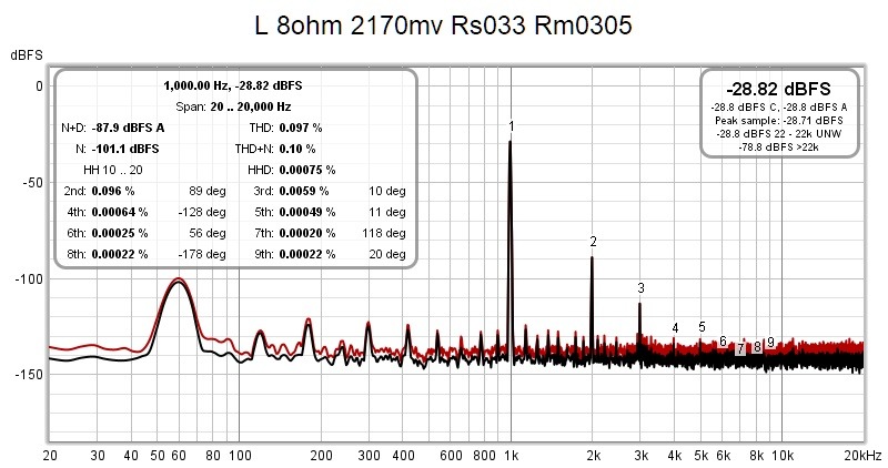

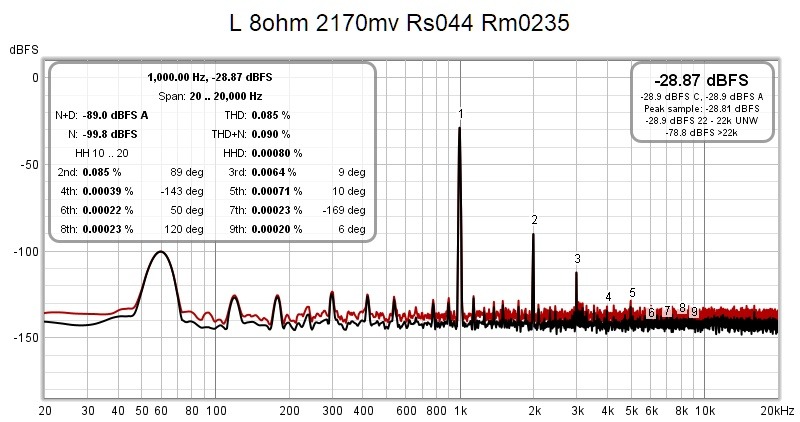

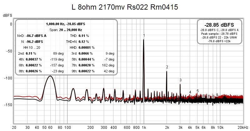

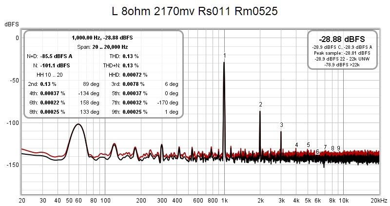

when started this build, one goal is clearly set: the amp has to have same measured signature as Papa's SIT model. that means similar THD and 2nd is dominant(negative, as Pa' often says)
picture 1 to 4, speaker negative terminal connected from top(close to S of NMOS) to bottom (close to GND).
Rs/Rm = 0.11/0.565ohm, 0.22/0.445ohm, 0.33/0.335ohm, 0.44/0.235ohm, Iq=2A, SIT Vds=24V at 2.17Vrms output(max I can get with Focusrite) and 8ohm load.
It is very clear that THD is 2nd at +89. The 3rd is 20db lower than 2nd. the speaker- terminal goes from up to low, THD reduces slightly. the minimal 3rd is around 50%/50% Rs/Rm.
The THD number is very close to Pa's number.
Reactions: PierreQuiRoule

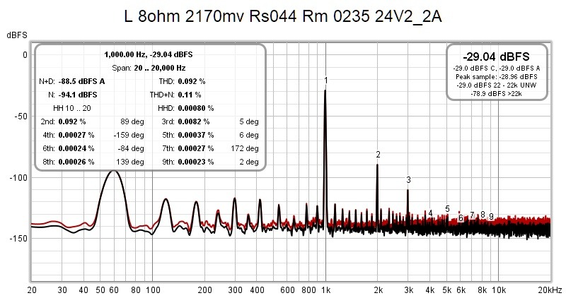

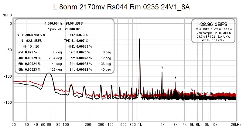

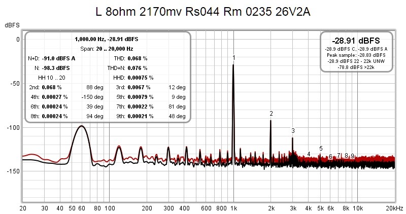

the influence of bias current
from left to right, Iq=1.8A, 2A, 2.2A, Vds 24V, Rs/Rm=0.44/0.235ohm, 2.17Vrms at 8 ohms.
THD reduces slightly with a decreasing Iq. 2A Iq has minimal 3rd at the testing conditions.

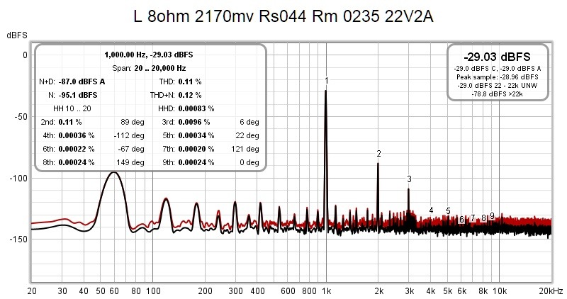

the effect of SIT Vds.
from left to right, Vds=22V, 24V, 26V. Iq=2A, Rs/Rm=0.44/0.235ohm, 2.17Vrms at 8 ohms.
Increasing Vds reduces THD, but still minimal 3rd is around 24V Vds.
