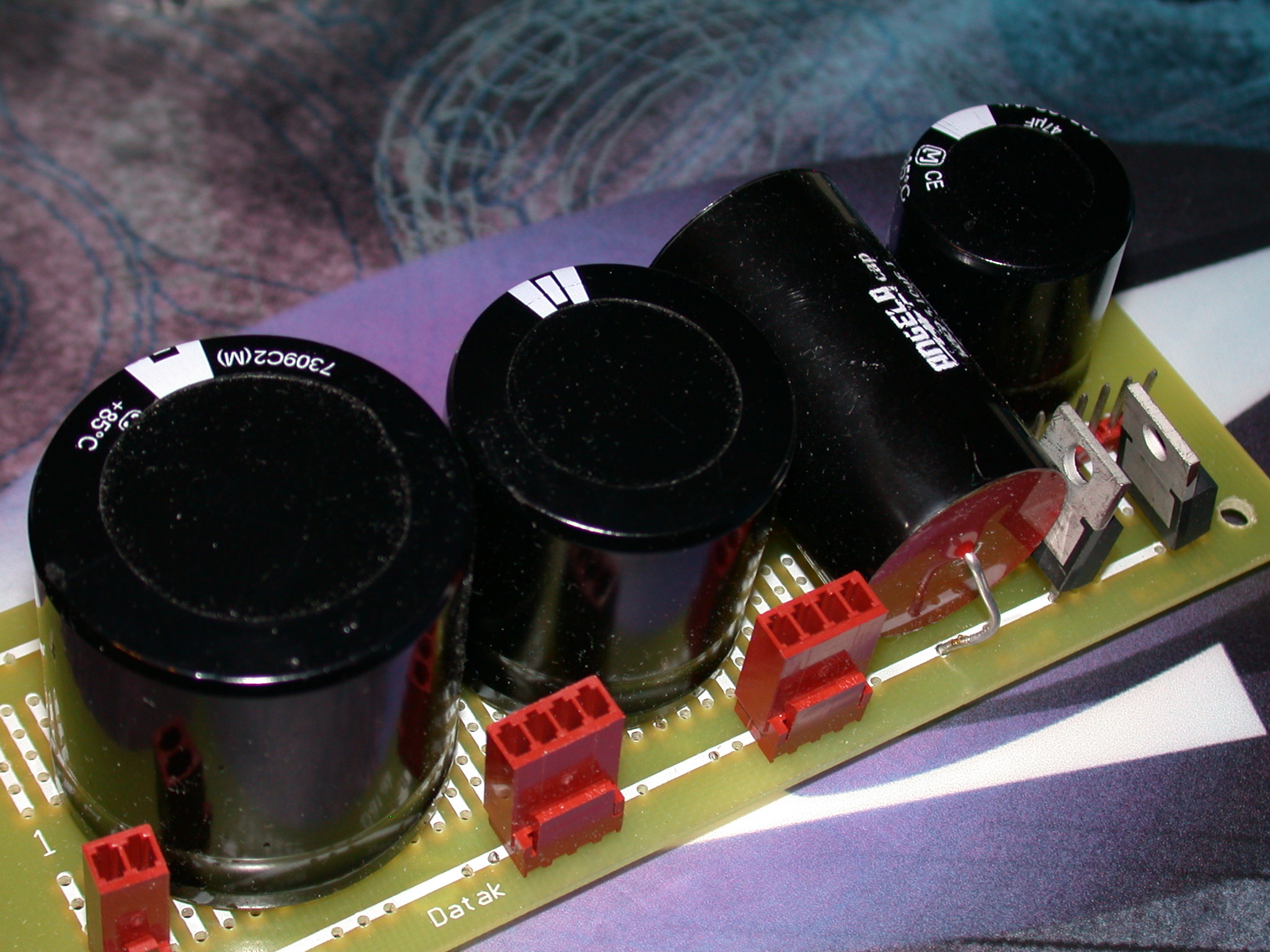

Geek over in Vendor's Bazaar sells power supply PCBs.
You can do SS or tube rectification, CLC, CRC, etc. If you decide to use this pcb, order the TS-UP caps in the taller/skinnier form factor when given a choice, as the caps spec'd are large and the PCB may get crowded.

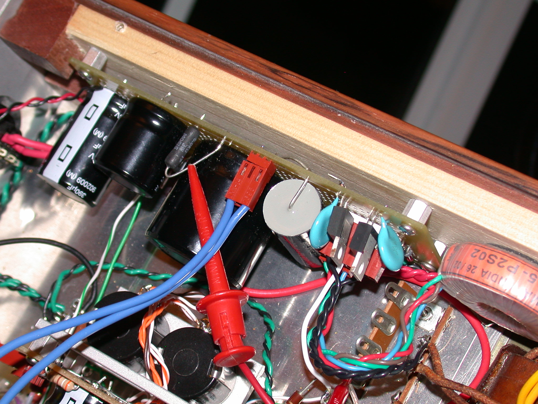

- Tubes / Valves
- Mullard 5-20 KT88 PP blocks!
