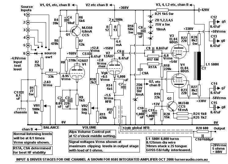

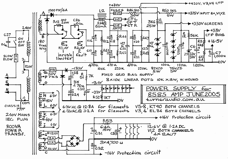

This is my build i'm starting Patrick Turner design 85 watts with a heap of class A. I don't have the iron but do have the components. I'm using mullard AU7 phillips EL84's and either EH or the genelex reissue. Building them on dual mono chassis.
The PSU and protection circuit will be built on 2.4MM PCB all other circuit hard wired maybe using some Keystone turret strips on the 3 mm ge material.
How much space should i allow around the KT88's?

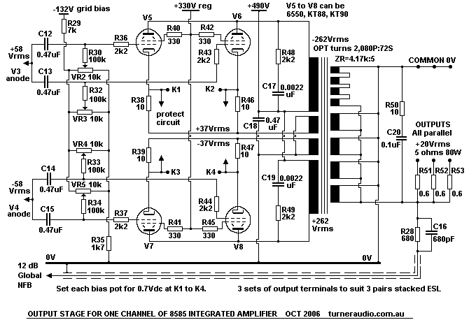

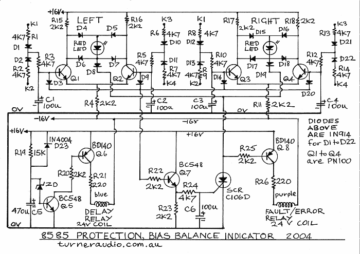

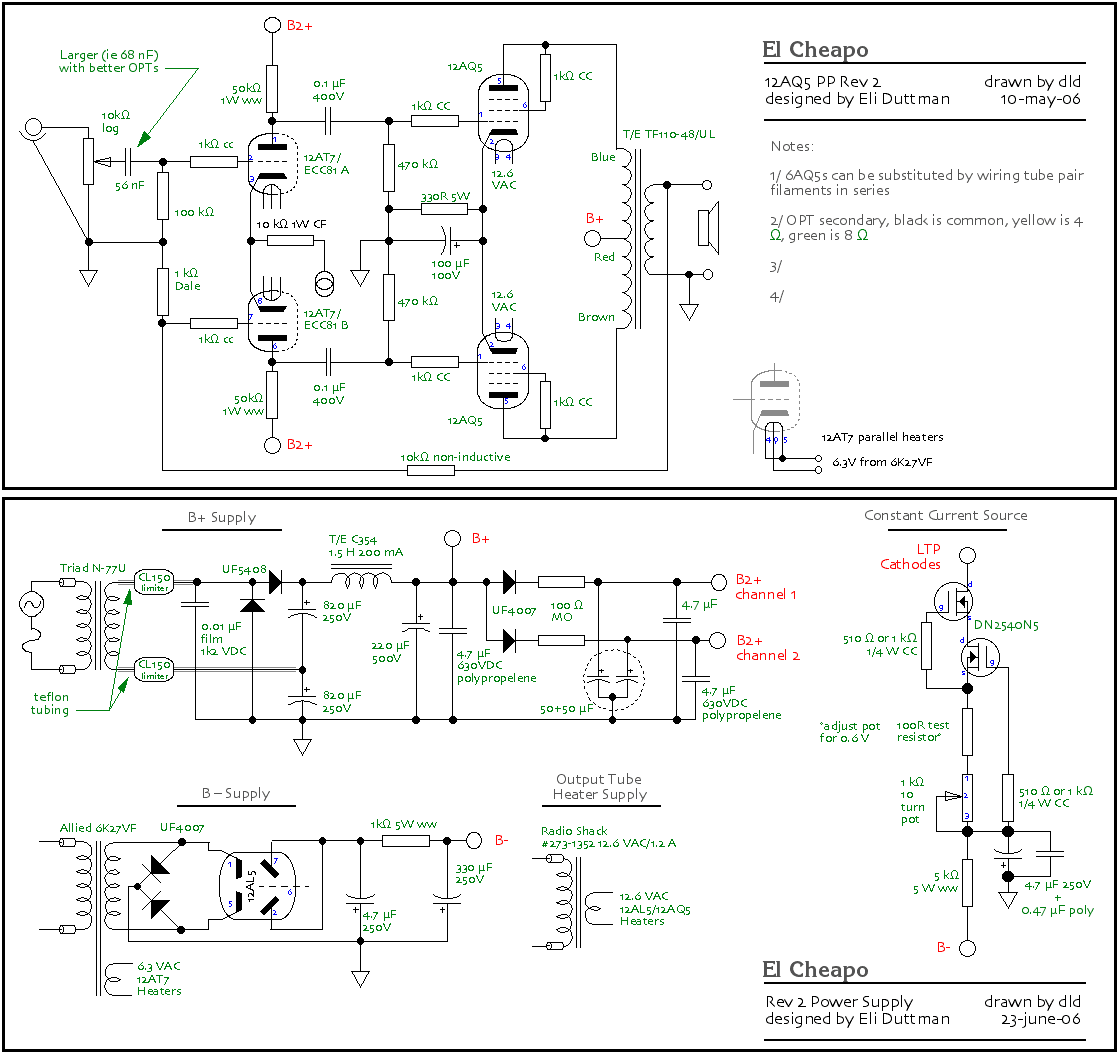

Here's the deal with the 12AT7 LTP: 200 to 220 V. on the plate and IB = 3 mA. sounds GOOD.
You can buy the cascode CCS from K/K or you can use what we did in "El Cheapo" and save a few coins. Check Jim McShane's site out. AAMOF, you may be able to get away with the 10M45S IC.
Don't be fooled by appearances. The "reissue" GEC tube IS better than the EH tube. However, the EH tube is an excellent value.
It's likely that a single negative supply can take care of both O/P bias and the LTP tail. A good CCS will "eat" many Volts, if necessary.

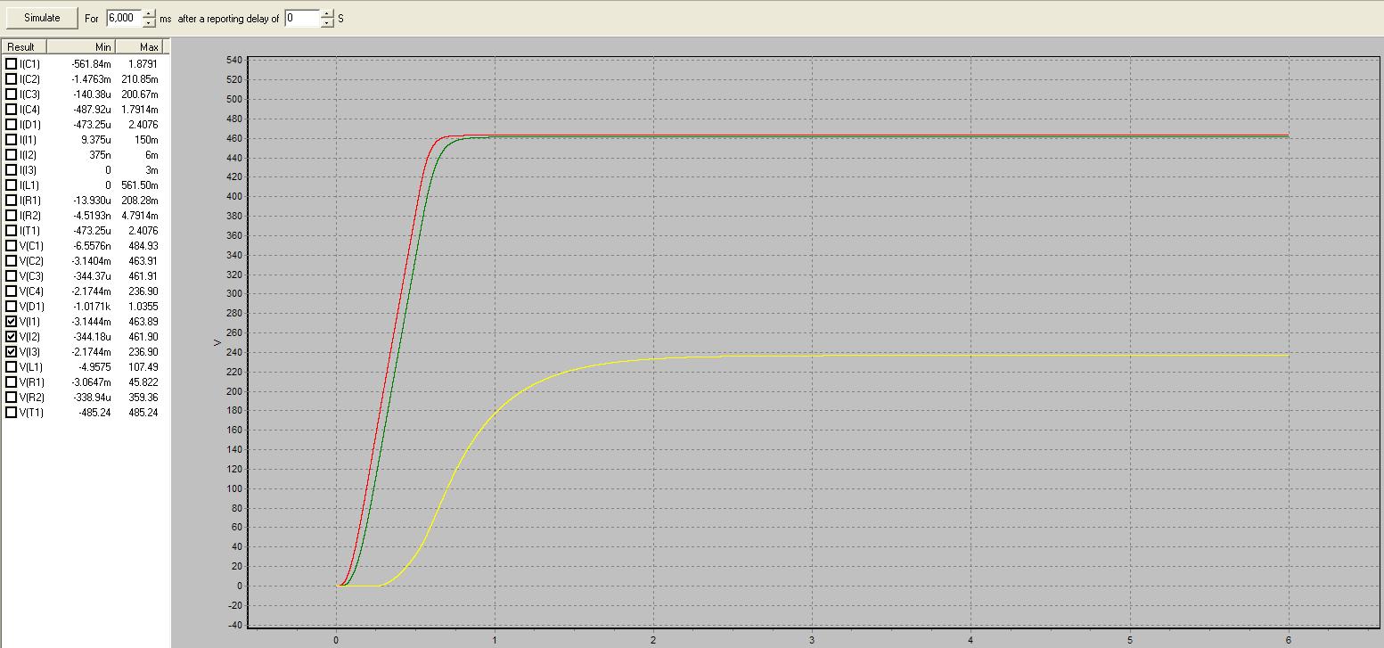

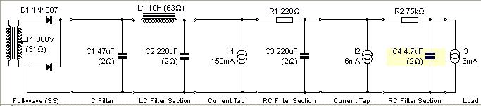

Here is my semi-newbie attempt at a PSUD model for the PS, with the following assumptions:
assumption 1: B+ for KT88 output tubes is 465V @ 75 ma/tube (150 ma for a monoblock pair)
assumption 2: B+ for 12AT7 is around 460V @ 6ma for both sides total. Tubemack, the schematic that you sent me shows 480V B+ for 12AT7 with a KT88 B+ of 520V-I am assuming that you want to end up with a KT88 B+ around 460V..so this would drive a slight reduction in the values of the matched pr of 56K anode load R's to get back to 3 ma/side, unless the B+ for the 12AT7 was the first tap, probably not a good idea for ripple, etc.
assumption 3: B+ for the EF86 is 240V @ 3ma
The ripple voltage for the KT88 B+ is 10mv, the remaining B+ voltages are flatter than a pancake.
Current tap I1 is the 460V for the KT88 pairs, I2 is 460V for the 12AT7, and I3 is the tap for the EF86.
The power transformer is an Edcor XPWR002 (360-0-360 @ 220 ma), vertical mount, and very affordable. There are other possibilities, such as the Triode electronics PA135 (370-0-370 @ 150ma), although that may be marginal.
The diodes are Fairchild 8A 1200V Stealth (Mouser P/N ISL9R8120P2) bypassed with 2KV 10nf ceramic caps (other suggestions welcome). The vanilla 1N4007s shown are a PSUD limitation.
The caps are all Panasonic TS-UP series (500V) or other 500V rated caps. IIRC Allied electronics sells Cornell Dublier 500V electros as an alternative. The Panasonic TS-HB series may work, but are on the ragged edge for overvoltage during startup (360V x 1.41=507V). The 450V TS-HB is rated for 500V surge, and the TS-UP is rated for 550V surge. You could always stack lower voltage caps in series with suitable bypass R's..
The choke is a Hammond 193M (10H @300 ma, 63 ohm R)
If any of the above volts/ma need to be tweaked, please post and I'll update the PSUD model.

The 'T7 sounds GOOD, with a 200 to 220 V. plate to cathode differential and IB = 3 mA. You can use the "check valve trick" we used in "El Cheapo" to minimize decoupling network losses. That allows good sized LTP load resistors.
Adding a CL150 inrush current limiting thermistor to the B+ supply delays rail rise for a few seconds. That's enough time for the instant on bias supply to provide electrostatic protection against cathode stripping.
The AnTek AN-2T350 toroidal power trafo costs $35 and it rates to prove satisfactory. Parallel the 2X HV secondaries and bridge rectify. A nice tweak here is to use snubbed UF5408s on the ground side of the bridge and 3 A./600 PIV Schottkys on the "hot" side. This setup is as quiet as vacuum rectification, while being economical. :)
Caps. are less costly than power magnetics. Use good sized caps. in a CLC filter and the $16.18 (from Allied) Triad C-17X 1.5 H./300 mA. choke. A way to blacken the background is to insert a "hash" filter made of a RF choke and a 1000 pF. NPO ceramic cap. between the 1st filter cap. and the main inductor.

Here's the current Schematic i'm building from. Any final tweeks or sugguestions are welcome.
I'd like to thank Boywonder for helping with the PS. Also a thanks to Eli, and the others for all the good suggestions!
Here's where i'm at:
I took a few days off to complete my tube reference library, and purchase a new Rigol DSO to complete my test gear setup. I should have everything I need now to do fairly extensive testing on the the project. I now just need to make sure the schematic is locked down, and the PS is complete. Any suggestions on specific componet types /brands are greatly appreciated! I want to go with all excellent stuff just short of those $100 each capacitors! I've been studing my Morgan book, but will still need much help. The chassis will be a standard wood frame / top plate design. After the transformers are bought, i'll start design of the top plate using Front Panel Express, (I'm farming it out to them). I may try my hand at the wood frame. I'm purchasing the black walnut this week.
As to the PS, I like it! I do want to stay with the standard transfomer, but i like that hash filter Eli mentioned. I like black backgrounds! The inrush filter is a go too.
I found the teflon caps from russia on EBAY look promising. I mostly used 2 watt resistors (welwyn) excpet where disspiating more power. I'd be keen to hear more on the difference between the two KT88's.
For my power supply i have designed PCBS to accomodate snap in electros, discrete diodes for the bridges (P600 & P1000) and the 5 wattt zeners. I also found some 1 watt trimpots by meggit (Tyco) so made up a little board so i can adjust them through the top of the chassis.
I orginally intented to hard wire everthing, but the cost of the electros with screw terminals is significantly more than the pcb types. Ketsyone have some nice terminal boards and turret strips. I'm going to make my own from teflon insulated turrets mounted on 3 mm fiberglass pcb material.

In the CCS, replace that lower BD139 with BC549C and the two small signal diodes with a single red LED. Rccs seems unnecessary - that 6mA isn't critical. You could remove it and just set the 6mA by checking you have roughly 150V dropped across those 56k anode resistors. What is the purpose of R18?

The "hash" filter is important, when large value cap. I/P filters are employed. A large 1st filter cap. is associated with a small conduction angle and a very sharp, "triangular", ripple waveform. Fourier's Theorem tells us that such a waveform contains overtones of the ripple fundamental extending well up into RF. The many turns of wire in a PSU filter choke create sufficient capacitance to short the choke out at RF. The LC section made from RF components ("hash" filter) "dulls" the ripple waveform down, which permits the main inductor to do its job well.
If i were to build this i would use a different CCS which doesn't require a negative supply.
Agreed, I want to simplfy the CCS, and use a basic simple Cascode using Supertex mosfets with no external supply. Can anyone draw this up?

You can get away without a B- supply under the CCS, IF enough Volts (about 30) to operate the CCS and to provide compliance with the I/P drive signal are available. The LTP's driven grid is DC coupled to the EF86's anode and is at the same potential. Therefore, at "idle", the cathodes will set up at a somewhat higher potential consistent with the forced IB and the LTP anode potential. Are enough Volts left to operate the current sink and provide compliance? If not, changing to a depletion mode MOSFET cascode as the CCS will not eliminate the need for a negative rail. FWIW, I prefer the FET cascode CCS as it's simple and very effective.
For the PSU "hash" filter you select a RF Choke that can comfortably handle the DC draw, without saturating. Long time coil winder J.W. Miller is still on the job and Mouser carries their production. :) The Mouser catalog page for Miller RFCs is here. Mouser stock # 542-5800-152-RC looks good to me.
