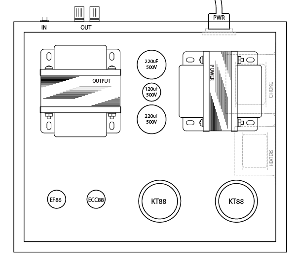

Okay, I read the appropriate section of BVA. Not sure I applied all of it, or even understood some of it, but here's my 3rd kick at the can. Any comments? It's 10 x 12".

Your layout looks fine to me, although it may get a little busy under the deck, based on the dimensions. You could also flip the input tubes and the output tubes locations, but it's a trade. Right now you have the input jack far away from the PS (good) and it can run along the side of the chassis to the input tubes, but the wiring from the output tubes to the transformer will be diagonal across the center of the chassis.
Having the output tubes in front of the output transformers makes for short easy wiring, but then you'll have to re-think the input wiring a little. I'd probably go with the way that you have it drawn.
Another alternative is arranging the phase splitter and the output tubes in a triangular pattern, that can make for clean, short, symmetrical wiring of the coupling caps etc between the stages.
What are you planning on using for a choke? That also has to go somewhere. Do you need a volume control or are these strictly power amps?

I'm not planning to add volume controls to the amps.
The choke will fit underneath assuming a 3" chassis height. I did that because the choke is ugly.
I'm working on a paper wiring diagram. I don't have the iron to breadboard it, and won't be getting it for a while yet, so I'll do it on paper first. No rush. 🙂

I'm finding that it's harder to layout a monoblock, and have it be, symetrical, functional, and still look look "pretty". Especially since my Pow, and OP transformers vary greatly in size. A stereo amp just seems easier. I think i'll be doing some mock ups this weekend. I want to see if a 17"x10" chassis is going to look too bare?

For open frame chokes that have a sufficient current rating, there are only a couple readily available off-the-shelf. Back when the post count was still in the double digits Eli suggested the Triad C-17x (1.5H, 300 ma). The Hammond 159T (2.5H, 300 ma) is the other easy choice. To get more Henries than those (and less B+ ripple), you need a enclosed Hammond 193 series choke or equivalent. These need some real estate above the deck, and they cost more. For the Hammond 193 series, you can easily get 5H or 10H 300ma rated chokes.
The open-framed ones get a little large for this current rating, but is appears that they will fit a 3" tall case.
Keep in mind that more henries=less ripple=less hum. Also remember that you need to add the ripple current to the B+ current to get the current rating for the choke.
I don't recall which choke is in my layout drawing, but it's the Hammond one from the BoM we made up earlier, and it fits in 3" tall space, but that height is a bit unsightly itself.
The bigger ones with end bells, mounted on top, might be a good idea to simplify layout and wiring underneath and increase visual wow factor (to tube geeks at least), at the expense of budget of course. The caps can go underneath instead. It's worth considering.

Small hint regarding chokes:
Remember that somewhere there is an air-gap, in the proximity of which there can be quite strong magnetic fields. Careful with these close to an input stage, even in power amplifiers. Should a choke-input filter be used (I don't think that is the case here), it is almost impossible to fit such a choke on a small chassis without some magnetic influence, even with the usual stray field precautions. A pity.
If you position the power transformer with one side of the coil fitted into a rectangular hole in the chassis and mount an output transformer on endbells with feet, with the long side of the core touching the chassis but oriented as the cross bar in a capitol T, you can mount a choke between these two objects and most stray flux from the gap will be attracted to the core of both. This will not cause noise and can be quite useful. The choke should also be mounted like the OPT, with reference to the power transformer. Obviously, two OPT's can be mounted to form a capital H configuration.
