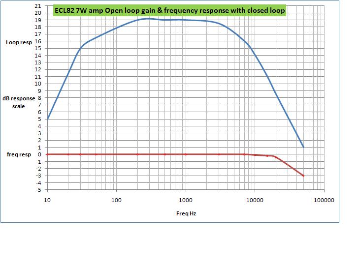

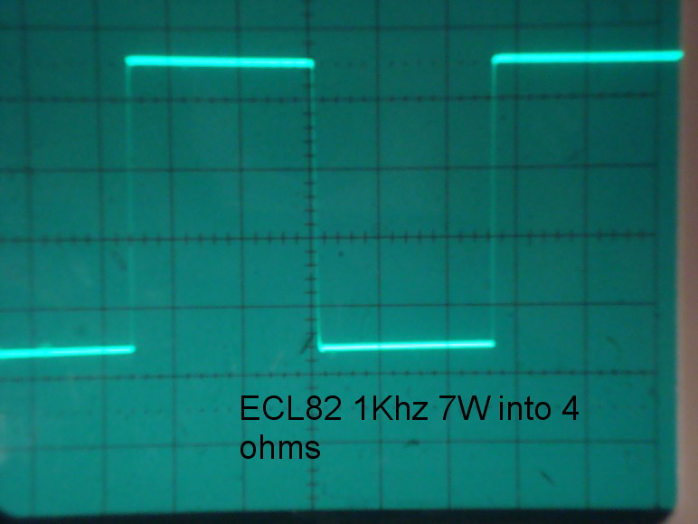

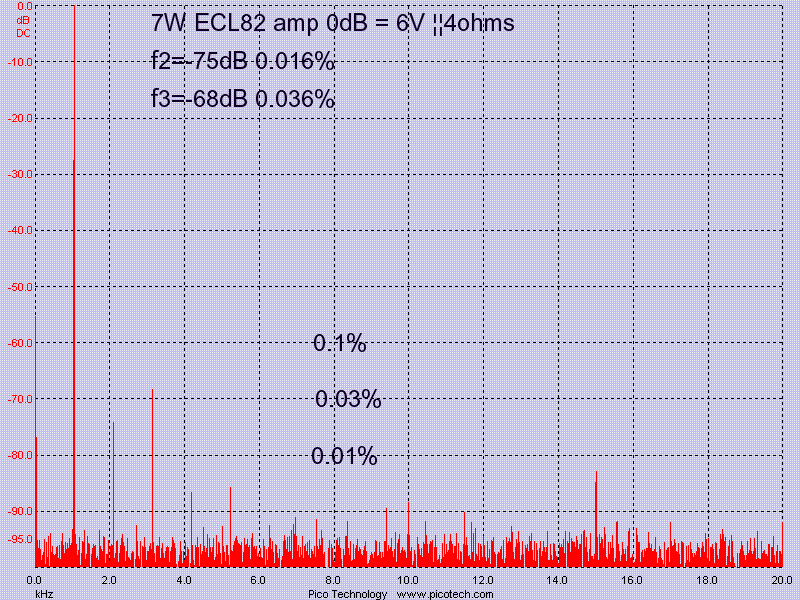

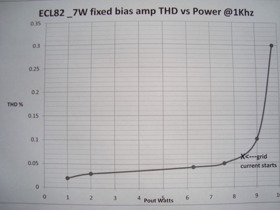

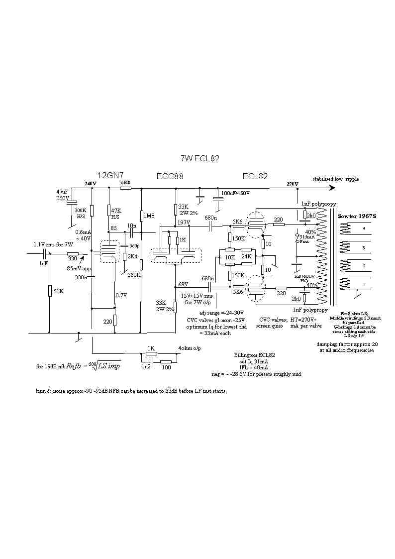

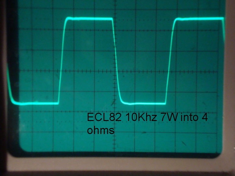

I listen to my version of the ECL82 Junk box amp alot.....7W. Study the graphs. I also had too much gain for line amp apps so I completely butchered the phasesplitter into a concertina using an ECC88 with both sections paralled and simply left the ECL82 triode sections redundant, requiring re math the global nfb loop values. I could have used the ECL82 triode sections but took the decision that the wiring would be too close to the o/p circuit which was asking for trouble so I used a surplus 12GN7 from the junk box for the front end.....there are better tubes for this purpose and less microphonic.
Sowter has an o/p transformer for this amp. Despite it's low power, it has a very clean spectrum and quality of my 150W lumps. The output stage is optimised with each tube taking 31mA quiescent. The entire heater line is lifted to suit the ECC88.
Note o/p stage snubbers, and these are required.
Even though the ECL82 tube was in 1960's small B/W sets as a sweeper, I "never did get on" with the triode section, falling between an 82/83 the mu didn't behave right as a concertina so I scrapped the section.
Those examining the spectrum sidebands will notice the psu ripple is exceedingly low around -92dB down fundamental 7W.....a stabilised 270V psu and the distortion is considerably less than the Mullard version.
