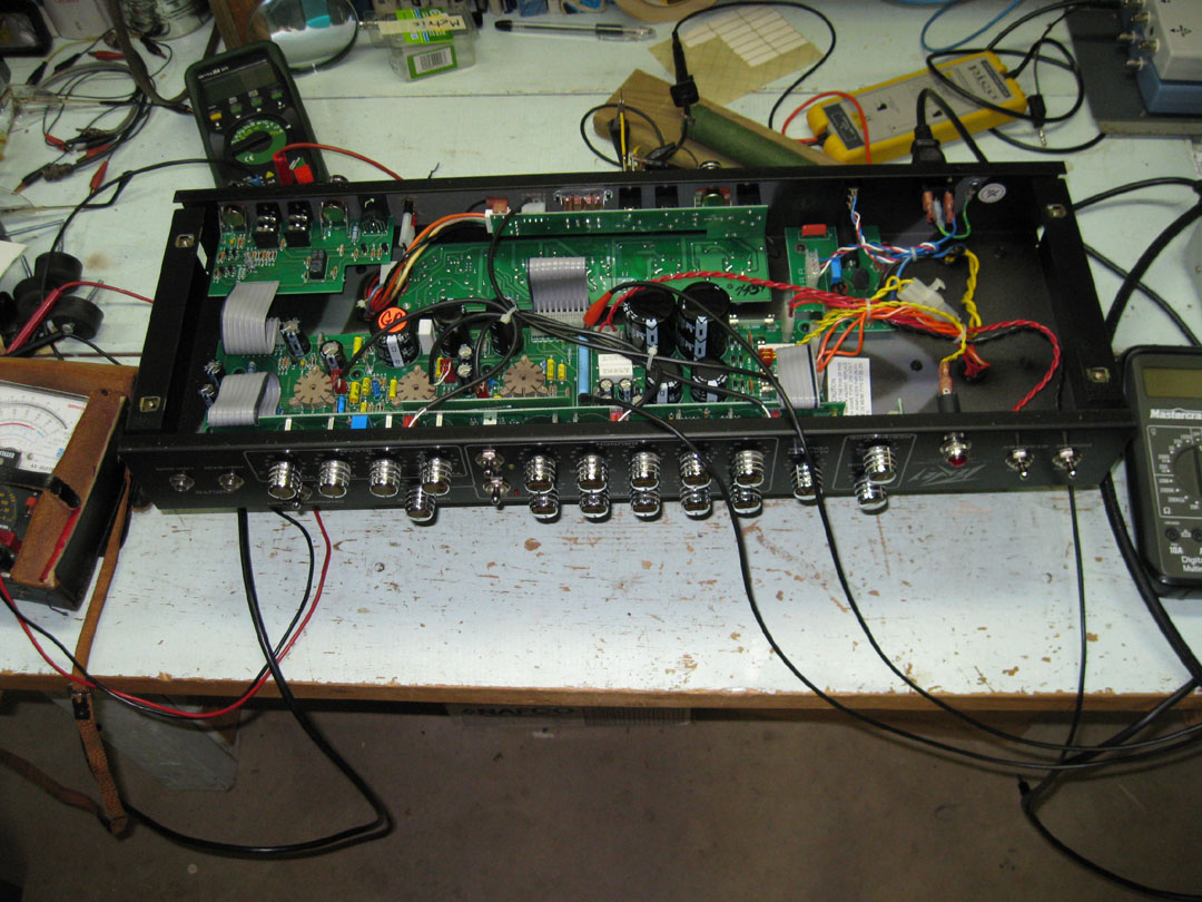

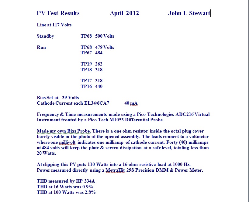

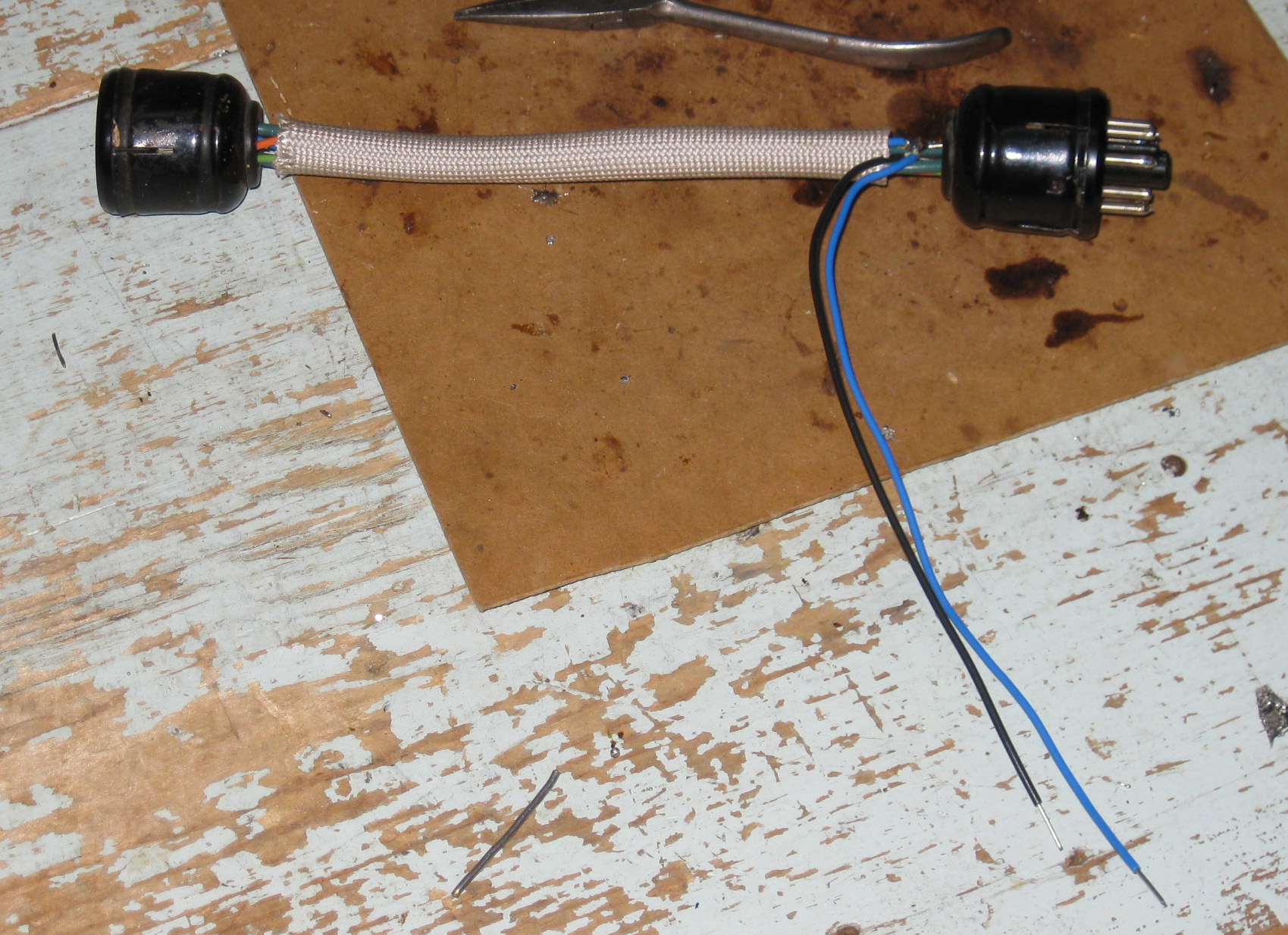

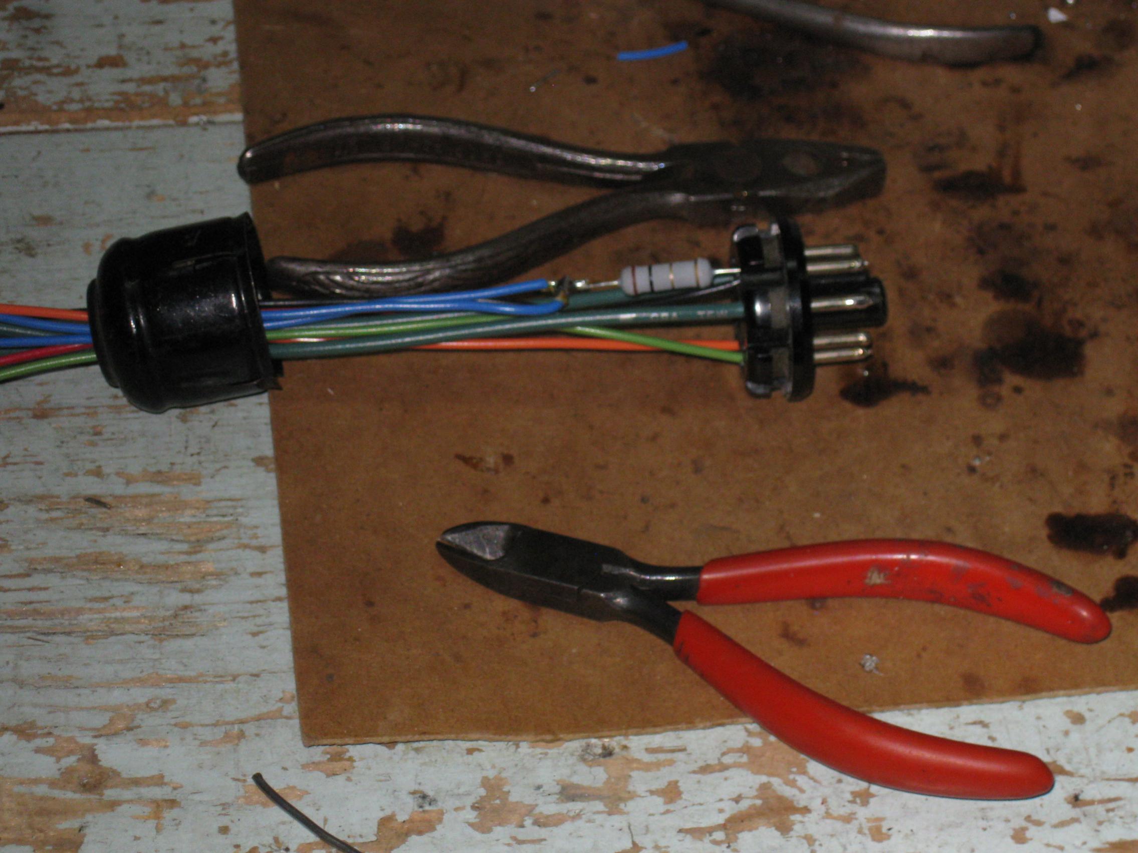

One of my Grandsons has a PV JSX. The build quality is first class. And it does very well on the test bench.:)
