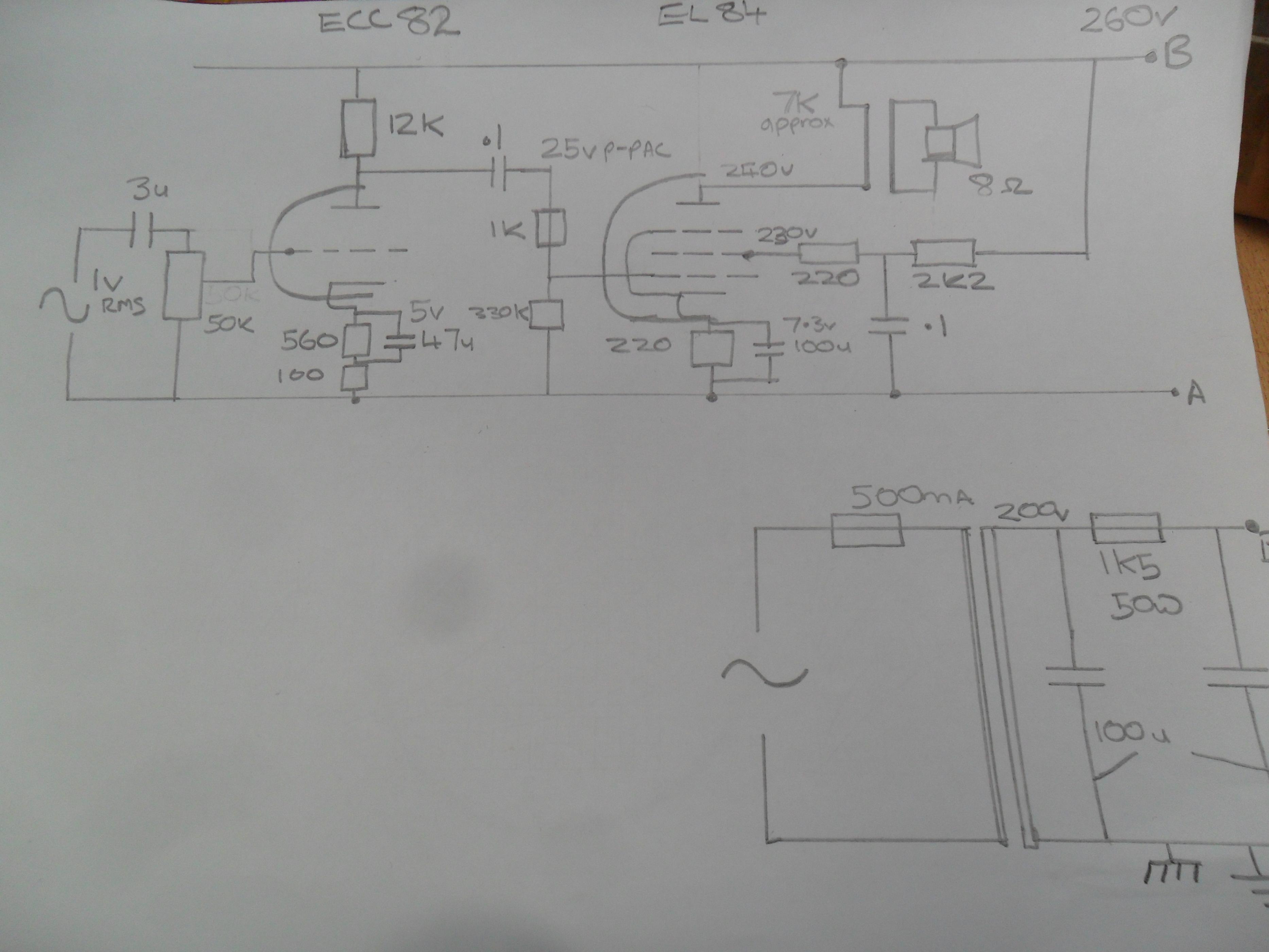

Chis already mentioned most important issues with this design. . Poor open loop frequency response, far too high negative feedback, still far too high sensitivity. EF86 operates at starving voltages. If you have well equipped lab, then go ahead. If not, something more straightforward is my recommendation.
Something like this:

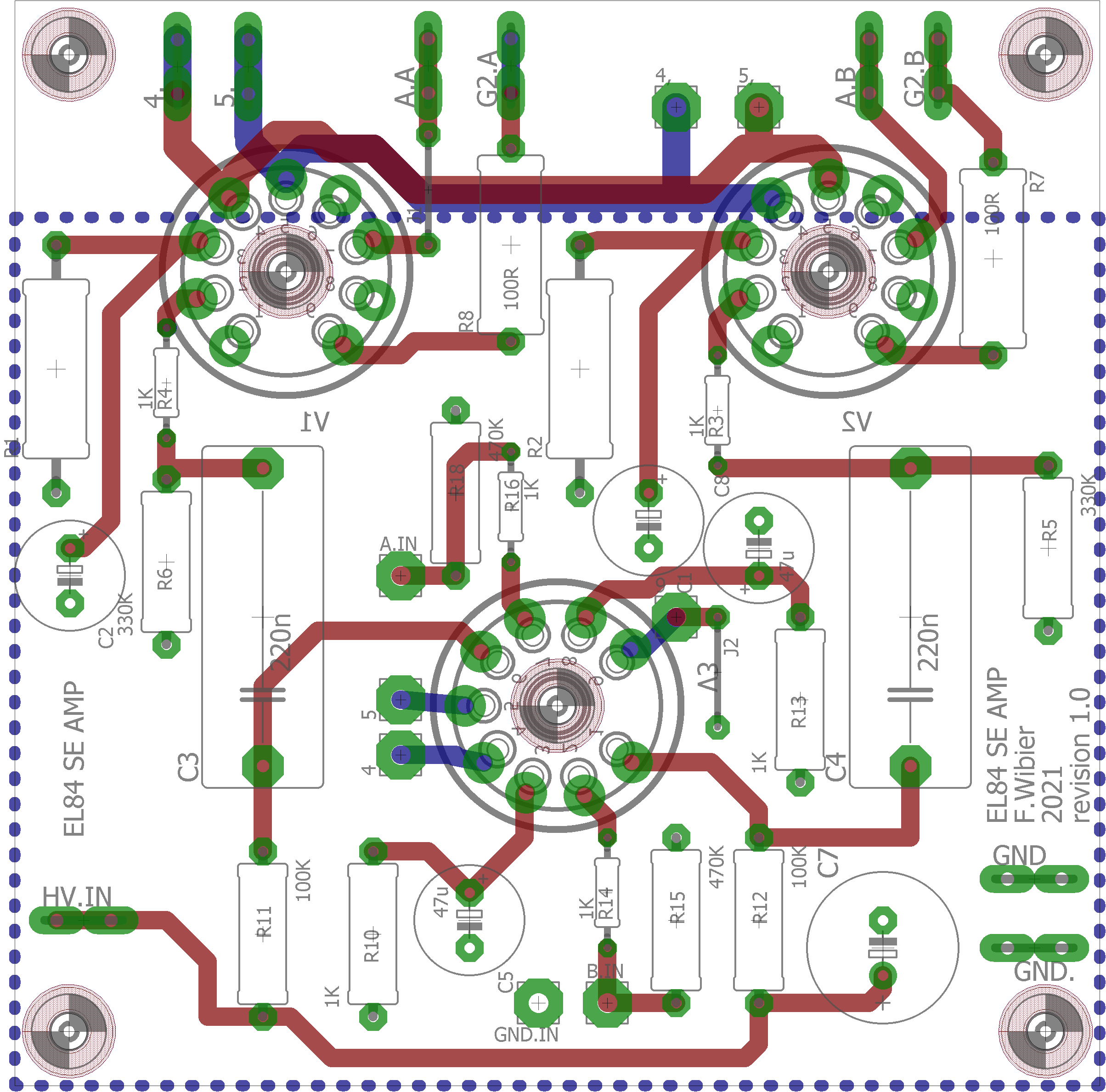

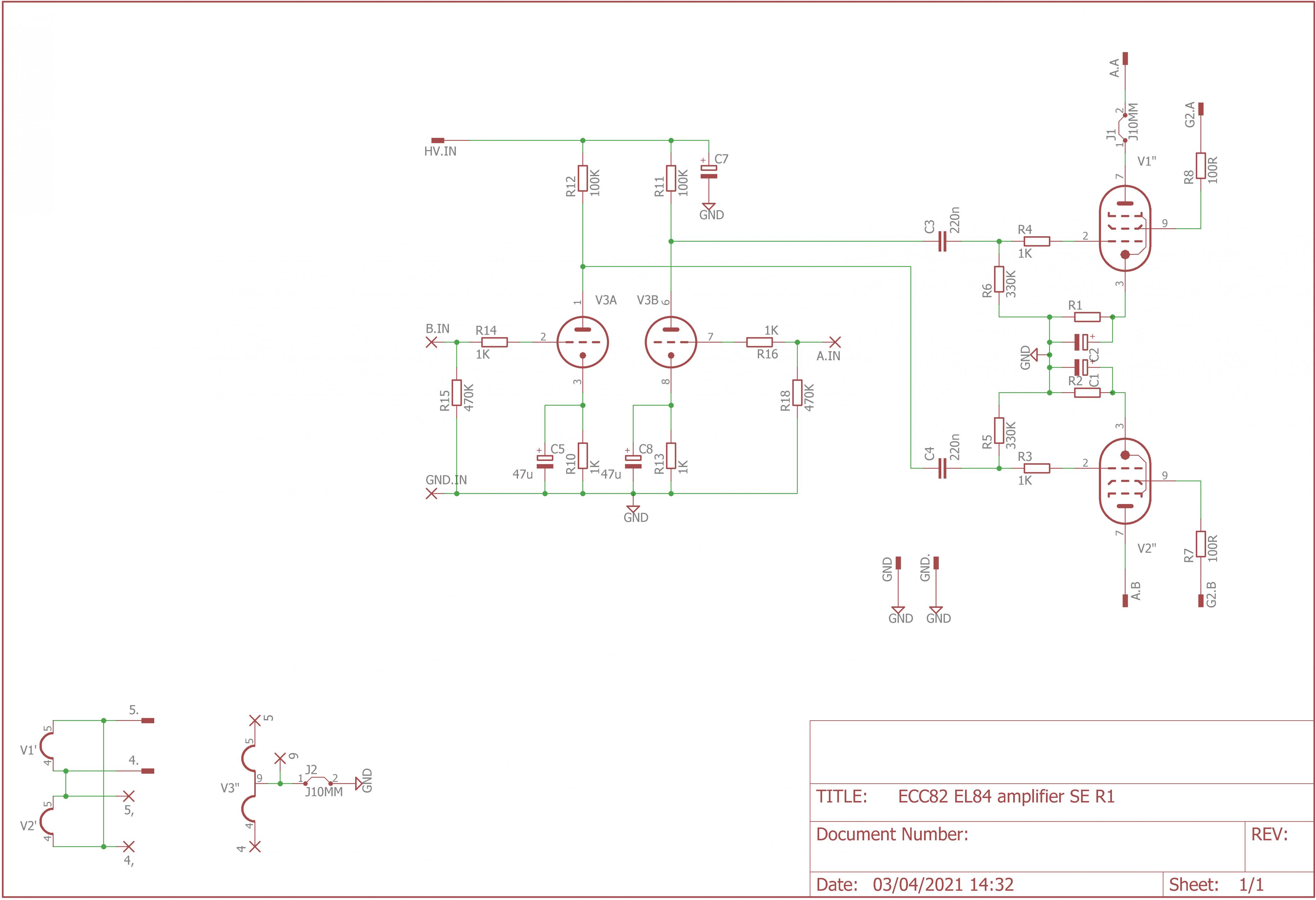

I have a few 100x100mm boards for that circuit in the mail.
If OP needs any.

Lastly I've attached a schematic for a 3w amp I built, it may have not be perfect,it's the first attempt at designing an amp I did some years ago, the result though was very good,to my ears at least.

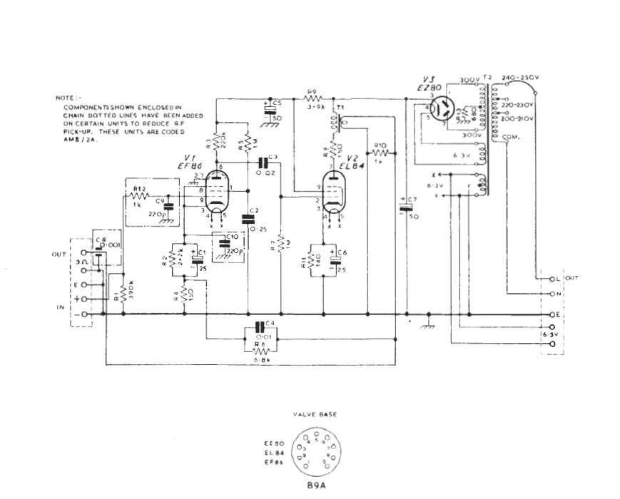

Just for information the modified BBC circuit (AM8-2/A) using cap coupling between the stages. And the information pdf.

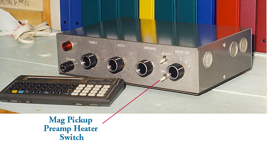

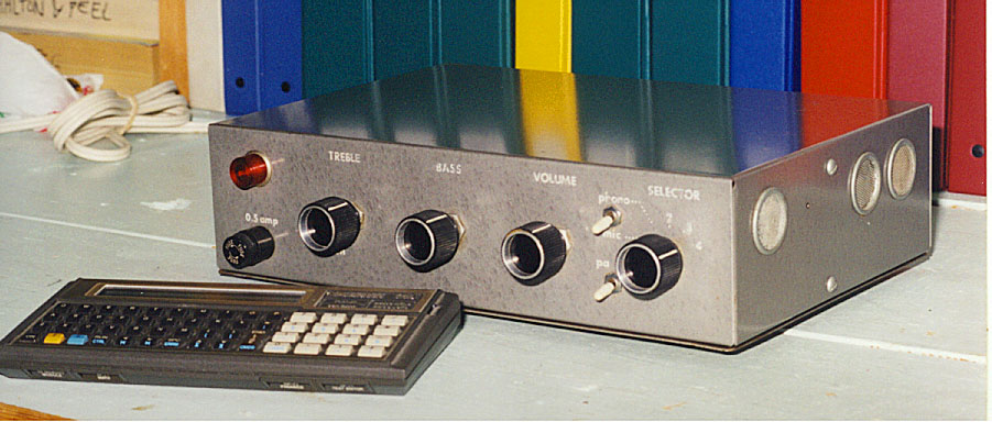

Did this one in 1968, its still running in the workshop today. Think the 6AQ5 was replaced once. And no problems at all with the NFB.:)

Alan4411,
Thanks for the schematic, and the posted article.
The first thing I noticed about the modified Mullard 3-3 schematic is:
The high frequency negative feedback path is . . .
Output transformer secondary to
C4 0.01 uF to
C1 25 uF to
The EF86 cathode and suppressor grid to
C10 220pF to ground.
Output transformer secondary drives
0.01uF drives
25uF drives
220pF to ground
Can anybody explain the purpose and function of C10, 220pF?
My guess is the re-designed amplifier was built near a high power RF transmitter or high power RF antenna tower.
For more evidence, look at the amplifier input low pass filter, a 1k Ohm series resistor and 220pF to ground, the filter connects to the EF86 control grid.
And, depending on the test equipment frequency, 1k in series with 220pf to ground does not measure to be 150pF at the input, but the article says it does.
How many more versions of modified Mullard 3-3 are there?
Why are they so popular?
