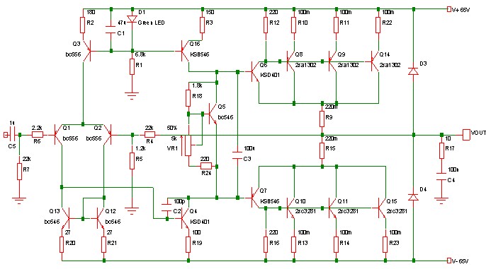

You don't need two sets of LED/R networks for the current sources. Use D1/R1 and connect the base of Q16 to the same point as the base of Q3. Get rid of D2/R8. Also you can bypass the LED with an electrolytic cap to increase stability of the current source.
You should also bypass the Vbe stage with an electrolytic cap (40-100 uF).

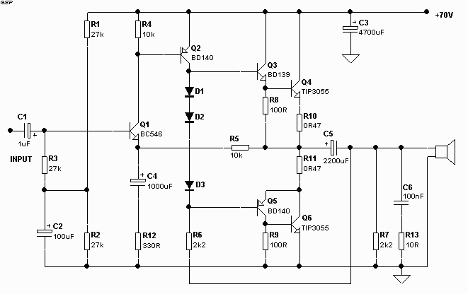

If you don't have a center tap on your transformer you can use an output cap like ESP's "El Cheapo". This is cheaper and generates less heat than two enormous resistors.

Will the capacitors have to draw as much power though? It seems to me that wether resistors or capacitors are used on the AC to create an artificial ground, it would be much the same in principal. Capacitors alone on the DC side of the rectifier would not make a good ground right?
Like this...
So the amp won't really have any ground at all. Hmmm, interesting concept (well, I actally have seen that done), but he'd need an output cap. Those have their disadvantages too, like limited performance, limited power output, cost, etc. and they can heat up some too. I guess it's up to Duo.

And, I'll get the constant current thing fixed, but when you say Vbe stage, what are you talking about(Q5???) I'm not sure.

what exactly do you mean by the Vbe stage?
Duo, you're correct in assuming that it is Q5 I'm talking about. Q5 forms a Vbe multiplication stage along with R18, VR1 and R24.
The resulting bias voltage appears from collector to emitter on Q5 and with your component names the formula is:
Vce = (1 + R18/(VR1+R24))*Vbe
Since this is only for DC bias point, the signal has to make its way through Q5 the best it can and a cap from collector to emitter would help up the signal path.
