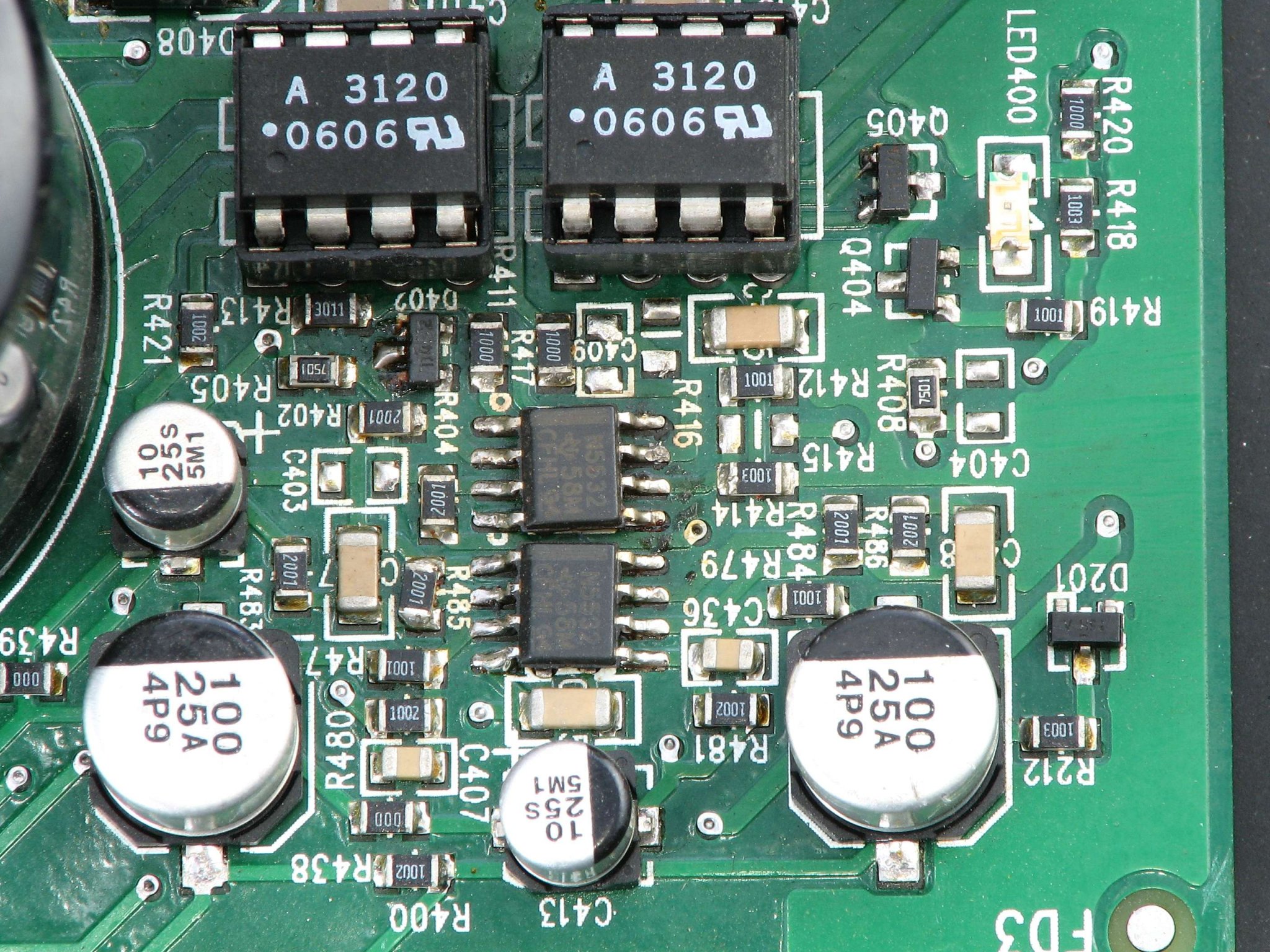

Hi there guys,
Does anybody know the value of R417 and R412?
Does someone has the schematics of this amp?
Also, what output fets are suitable for this amp?
Thanks for the photo Perry.

For pins 1-4 of the 3120s, the only terminals used are 2 and 3.
What's the rated voltage of the rail caps in that amp?

Perry, 100v rail caps

Correct Bertje. C414 was not installed in the amp, as well as the output fets.
There is 60V across the pads of C414.
A new cap will fail instantly since the capacitor rating is 25V looking to perry's photo in post #2
Also C413 reads a not stable 27-30v across the pads. It looks like there is a 25v cap installed. Not good I suppose.

The NE5532 PS pins are directly connected. The 25v 10uf caps seems to be the PS caps for the NE5532. They arr connected via a 0ohm fuse resistor. Strange readings from post #16

Install a capacitor in place of C414 that can withstand the voltage and re-check its voltage.
Confirm that C413 is within tolerance.
