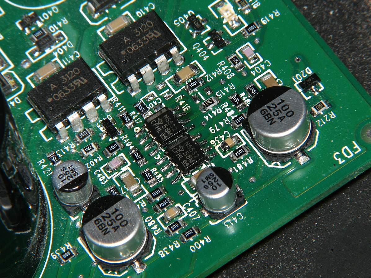

Ok I replaced the opamps on the preamp board .Plugged in the preamp board and all the settings work and amp produces clean audio .

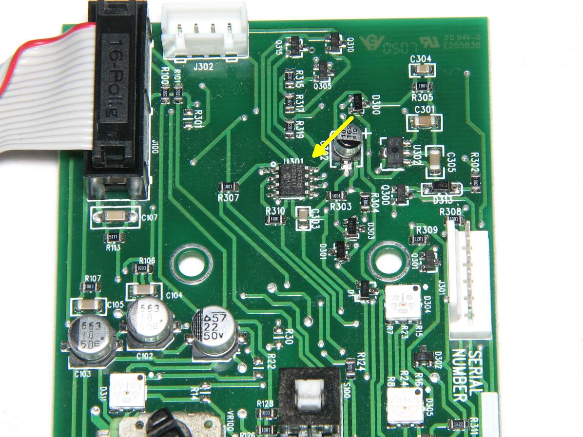

None of the leds light up on the preamp board .any ideas on what to check next ?
There is still a problem tho .
Did you try all of the various settings for the LEDs?
The LED driver IC could have been damaged if it was powered by the regulator.
U301 is the microcontroller that drives them.
What is the supply voltage across terminals 1 and 8?
Do you see any activity on any of the other terminals (on the scope)?

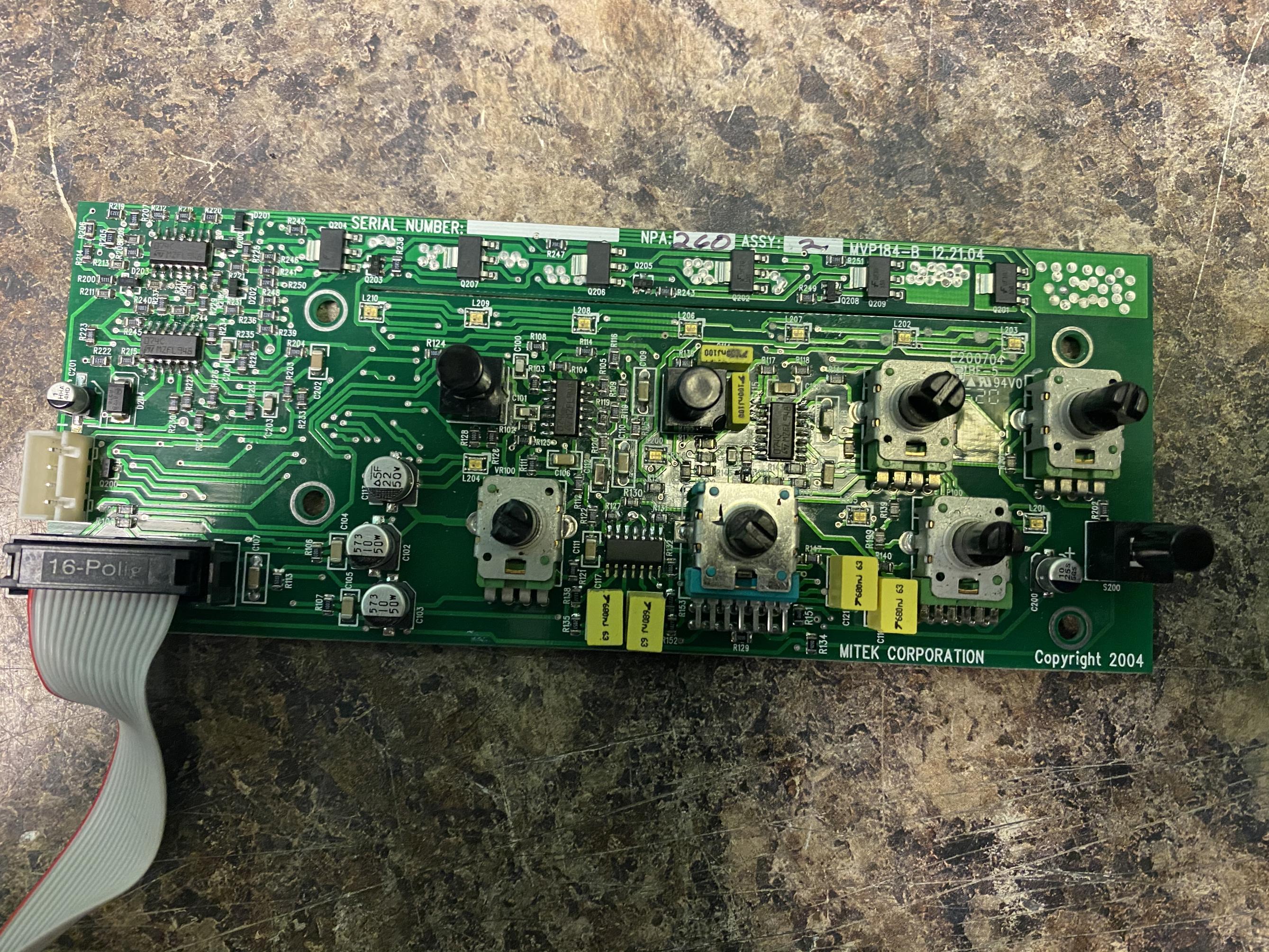

Do you have a pic of the preamp board that I have in this amp ?
Wanna make sure I installed the opamps on the right direction .
I have a problem with the preamp board still .
If I start pushing the buttons or adjusting the pots the fans kick on and off then stay on steady
