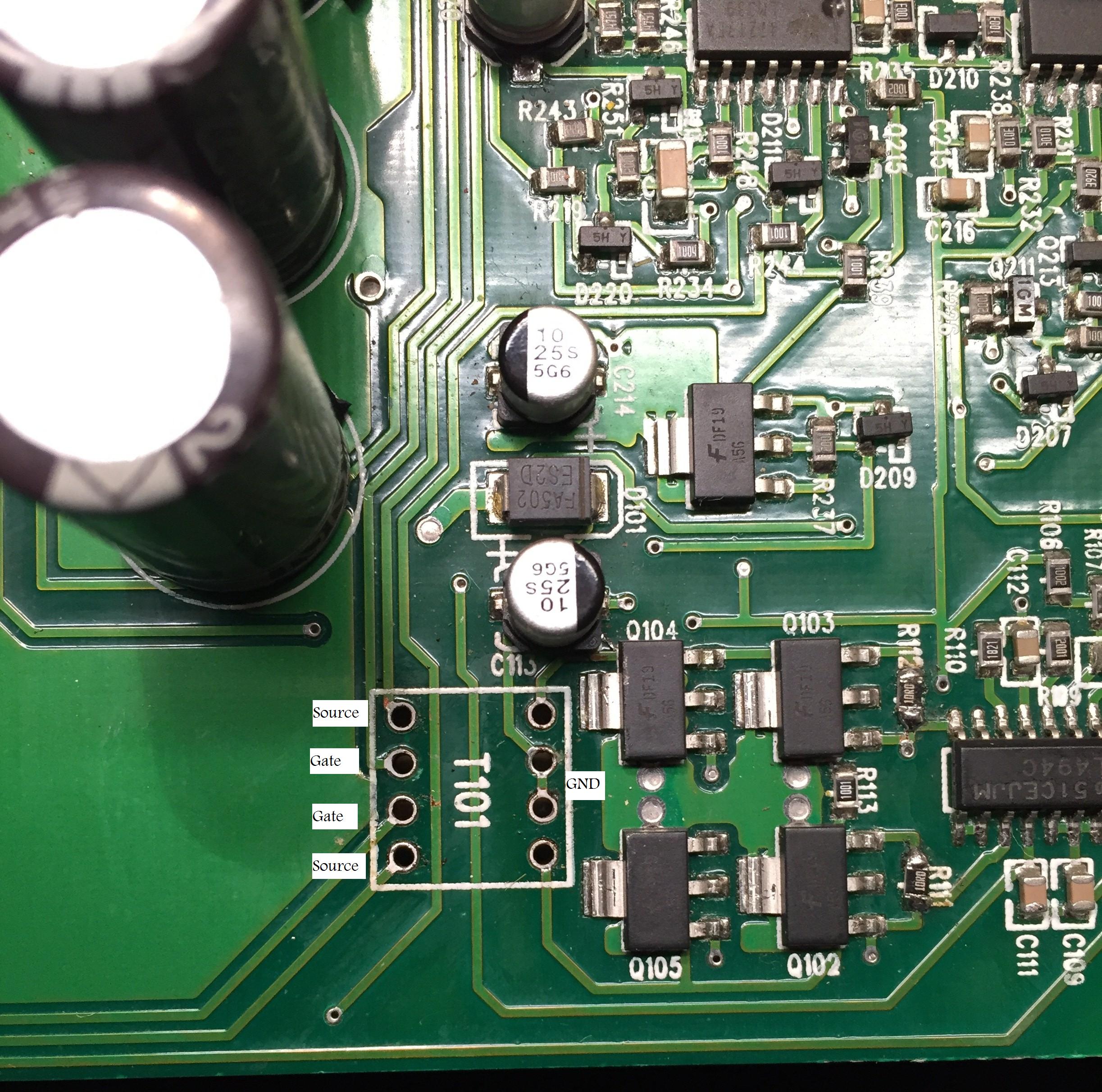

With the transformer back in,
I measure 2.28vac B+ to driver emitters
I measure .286vac source to transformer side of gate resistor
Voltage set to 10.25 at B+
So my problem is in front of the transformer.

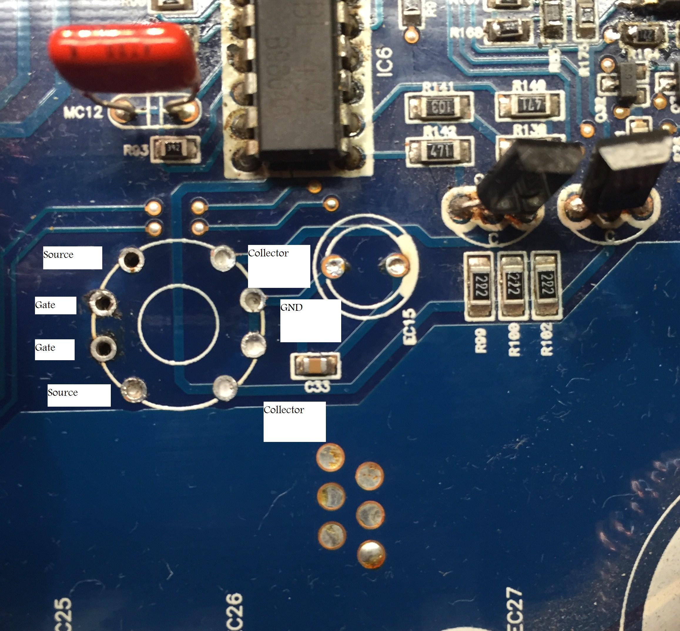

Look at the sony board and compare the transformer layout to the gate and source legs of the PS FETs. Do they have the same terminals of the transformer driving the same points in the circuit as the MTX?
What I find different on the Sony board is the transformer is driven by the driver collectors instead of the emitters, otherwise the transformer pin configuration looks the same where as the outer pins are at ground / source like in the MTX.
Are the gate and source for the adjacent pins in the sony for the same FETs?

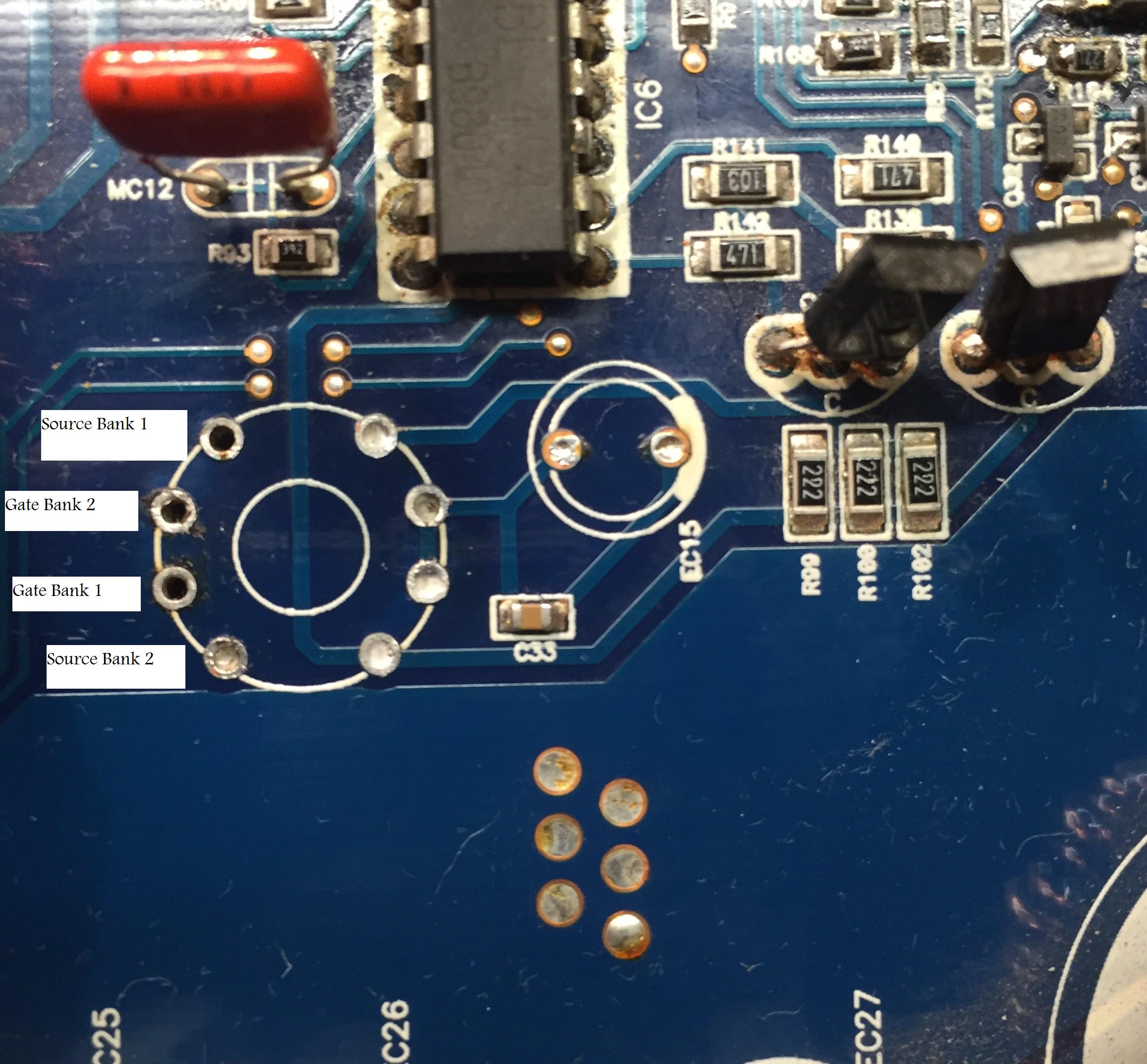

Reinstall the transformer in the MTX and see if you can find any 1:1 voltage primary to secondary but try all combinations on the secondary windings. I think you'll find the equivalent voltage between the source and the non-adjacent gate.
In the Sony the adjacent pins are not for the same FET like they are in the MTX.
You are correct, measuring across the non, adjacent pins I get the expected 1:1 voltage.
Here are the pictures with corrected labeling.
Did you try hard-wiring it with the terminals crossed to see if it would work?
Bare in mind that the polarity of the two secondary windings may be an issue so if it doesn't work initially, reverse the windings for one of the two secondaries.
I haven't had the chance yet, but I was thinking swapping the two inside pin locations on the secondary is the fix.
It will probably be couple of days before I can report back on it.
Sorry about the slow pace of progress.
Swapping those two inner secondary pins around seems to have solved the power supply restriction and allows the amp to output it's rated power on a very brief test.
I'll have a bit more time tomorrow morning.
With B+ set at 10.25V I measure 7.32VAC B+ to driver emitter and 7.31VAC Source to transformer side of the gate resistor. The amp is now producing +/- 50.5VDC rail and rises when B+ is increased. The power supply appears to be operating correctly now.
