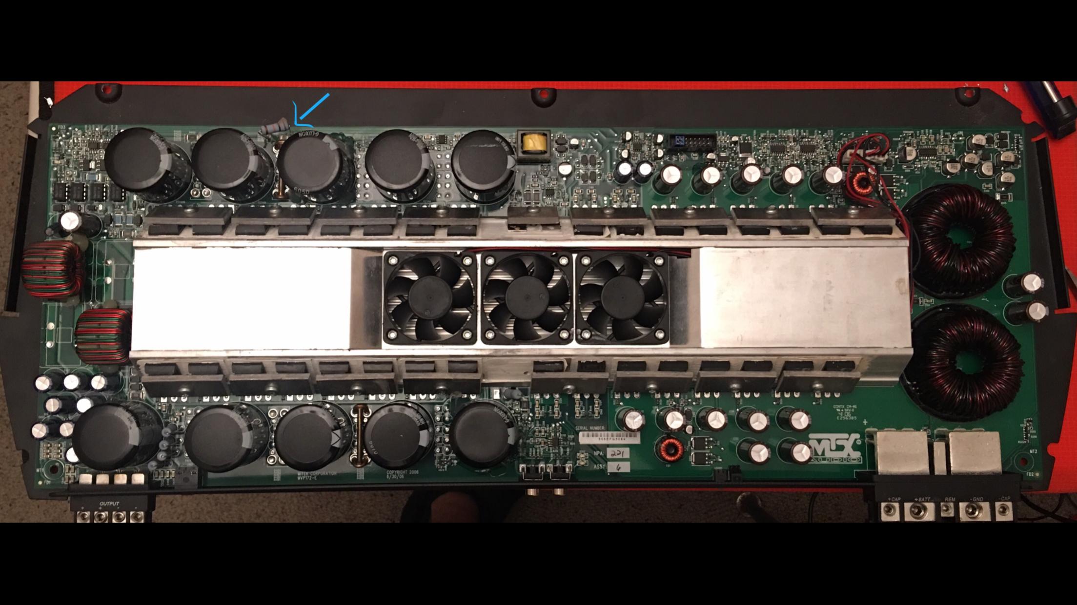

A friend asked me to take a look at this amp, apparently he didn't test it before buying it and it has some issues. :headbash:

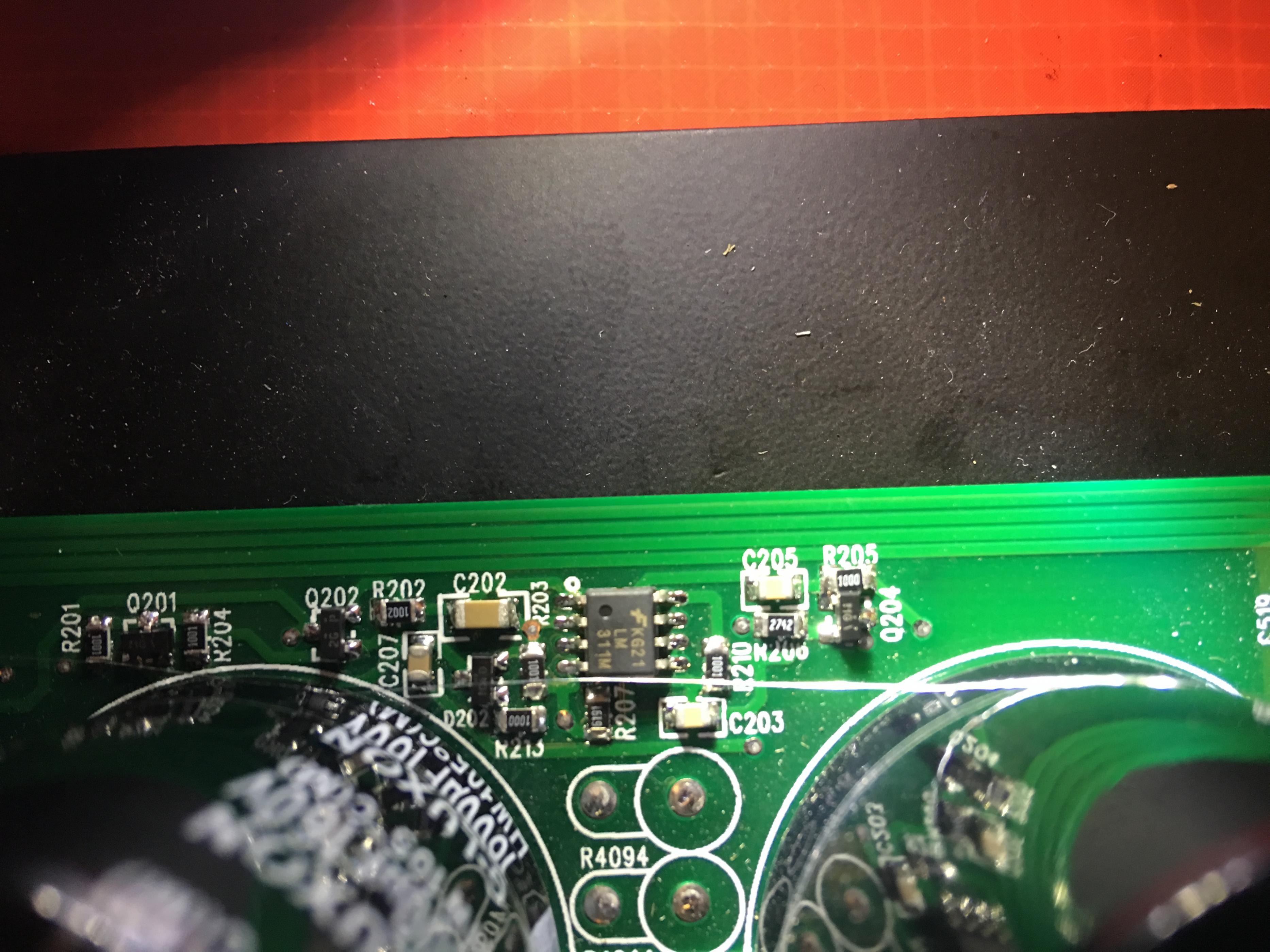

When I got it, the "SHORT" light would illuminate when applying 12v to the remote input (B+ and B- hooked up) and the fans would twitch for a fraction of a second. The power supply did not turn on -> pin 4 of the TL494 was being pulled high.
I checked the output FETs for a short and found nothing.
Seeing no obvious fault I lifted 2 legs of Q101 to bypass the protection circuit, applied power and it came to life.

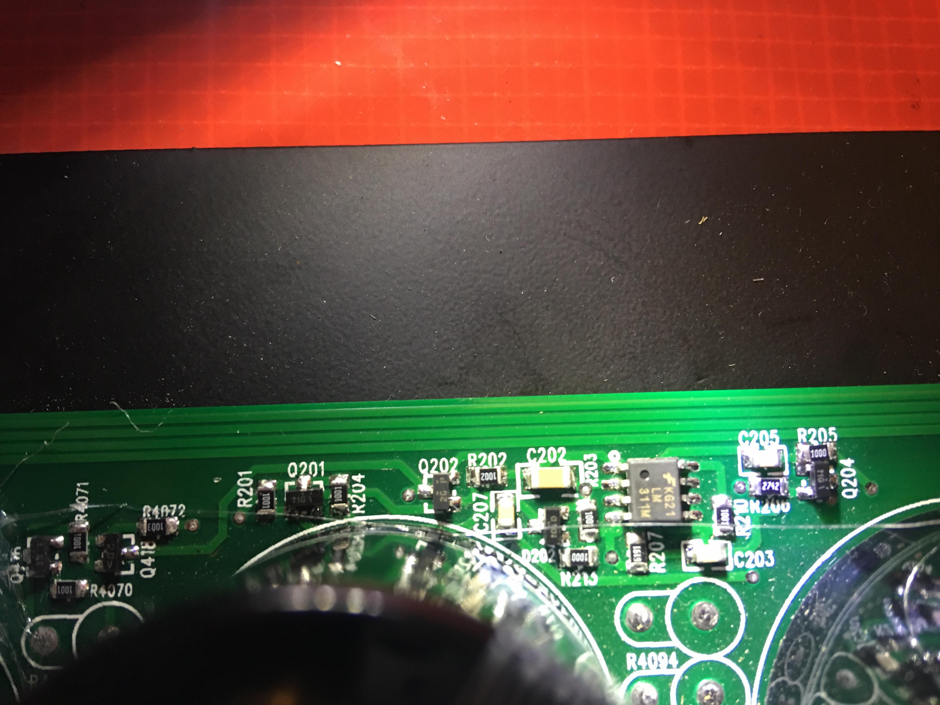

At this point I started drawing a schematic of the overcurrent protection starting at the shunt bars and checking components as I went. I found Q201 (marked 1G, I'm thinking it's an MMBTA06) to have 39 ohms between the collector and emitter and removed it from the circuit.
Is it safe to power up the amp with this transistor removed? My selection of on-hand spare parts is nearly Zero and I expect to need more parts as I find and correct the other issues.

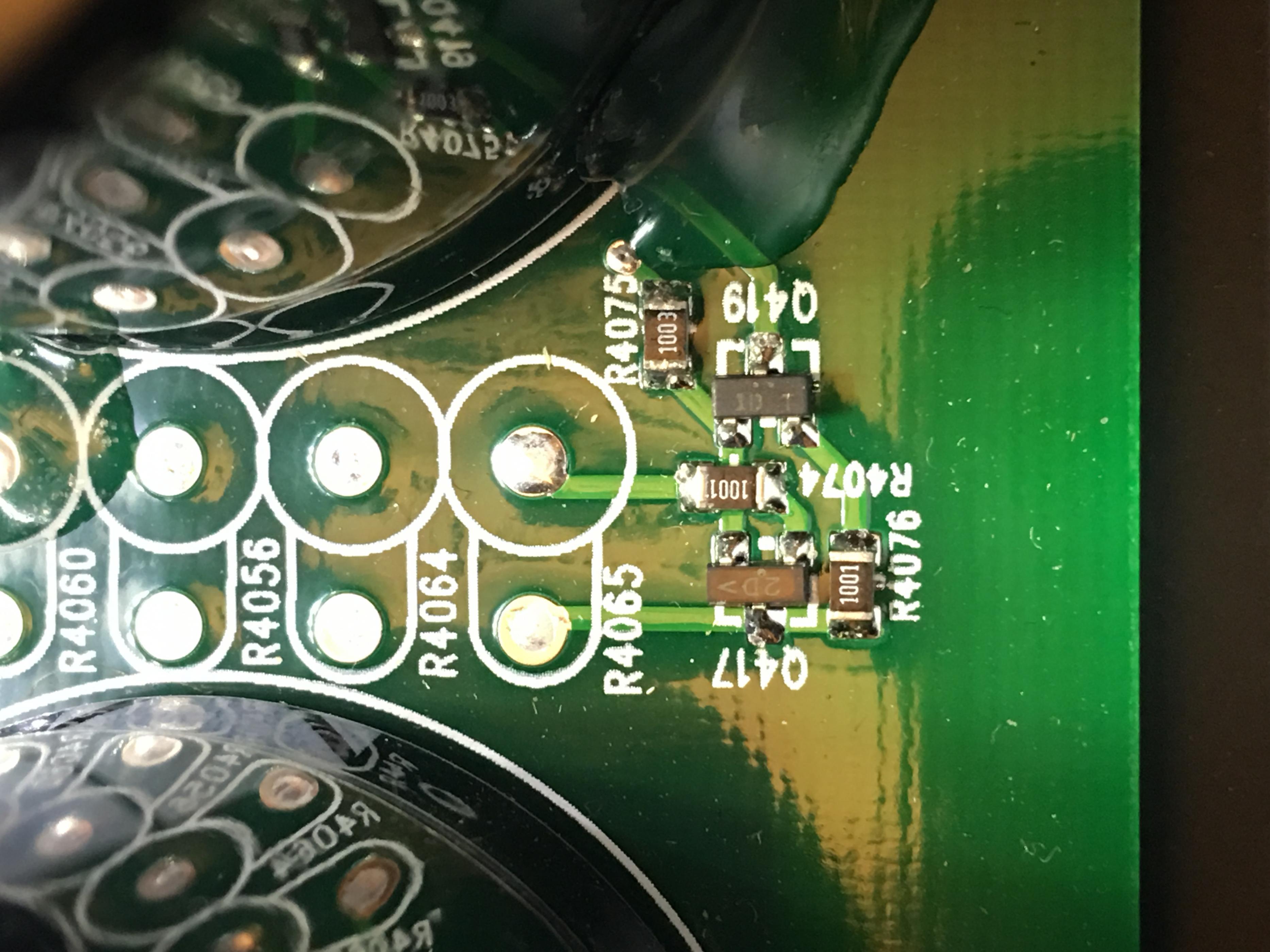

3.) Others have noted a through-hole resistor with silicone in place of 2 surface mount resistors that looks to have been done after initial production. (Link and Link) This amp has the same resistor (blue arrow in overview picture.) I found the short leg broken off. When this resistor is in-circuit there is DC present on the + speaker output terminal. When the resistor is not in-circuit, there is no DC on the speaker terminal. When the power supply is running, this resistor gets warm to hot (hurts to touch.)
4.) Two things you can't see in the pictures (thanks to the 3-layer PCB design) are the connections between the collector Q419 and R201 (pad closer to the LARGE electrolytic cap.) And the connection between R204 (again, pad closer to the LARGE electrolytic cap) and the emitter of Q202.

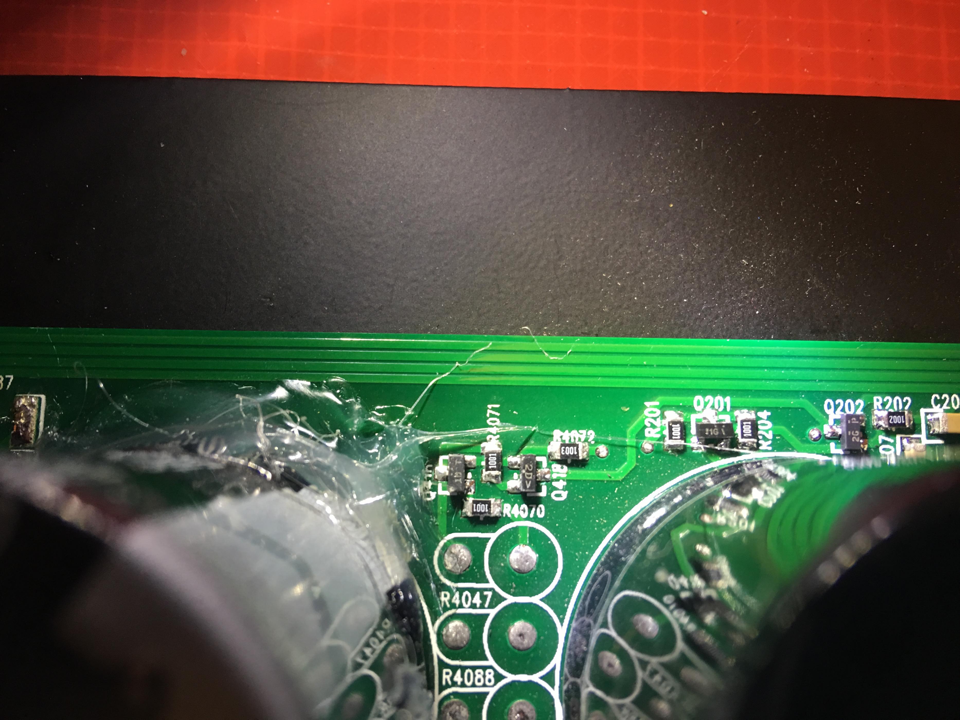

5.) It looks as though someone has been in here before- the solder for one of the large caps was done poorly and there are sections of SMD components that are not sitting square (last picture.)

3: What are the circuit board designations for the SMD resistor locations? Searching for those will be easier than having to read every note I have.
4: the connection could be to a supply voltage or ground.

I believe I've found the fault in the protection circuit.
The shorted 1G transistor (Q201) was a red herring, the real problem is the LM311 isn't switching its output. Pin 6 stays at a constant 4.019.
With Q201 in the circuit pin 2 of the LM311 is at 5.56v, with it out of the circuit pin 2 is at 0.001v.
To test I pulled R210 which ties pin 6 to pin 5 (Vcc) and the amp powers up normally. Unlike when the protection circuit was bypassed, the remote has control of the power supply again.

After replacing Q201 and the faulty LM311 the amp powers up correctly. There's 0.103 V on the (+) speaker terminal with no load attached.
I have not given it an audio signal yet -> The through hole resistor we briefly discussed earlier (replaces SMD parts R4082 and R4087) gets HOT just at idle. Touching it for a fraction of a second is painful.
Why does this resistor dissipate so much heat at idle and should I be concerned? I haven't yet figured out what job it performs. I'm a little concerned it could desolder itself from the board if it gets much hotter.
Look at the voltage across it. I think it's connected between the positive rail and the 18v Zener for the opto-couplers. Calculate the power across it to confirm that it's not above the 2w(?) rating of the resistor.
Resistors can operate at very high temperatures and not be at risk of failing. Check the derating curve for the type of resistor that's being used.
