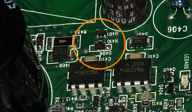

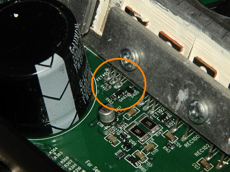

MTX 81001, Want to know the value of two parts
Replace any semiconductors in the circles if you're not 100% sure that they're OK.

I replaced Location Fet401
I also replaced Location D404, r410, Q401, U402, U403.
Then i turned the amplifier onn with a 12V 2A adapter.
Then i about 15 sec i heard something sizzle.
I turned the amplifier off immediately.
After i turned off the aplifier i saw the Elco at Location C408 was hot and distended.

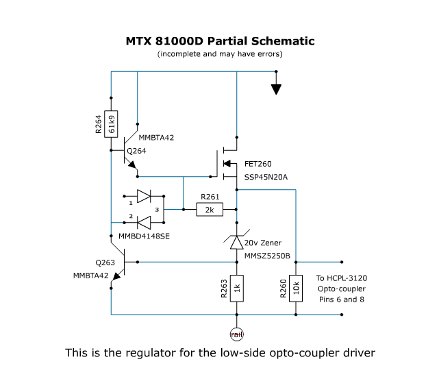

The 'regulator' is a voltage regulator. The opto-couplers cannot operate from rail voltage. The voltage limit is about 20v. The voltage regulator supplies a safe voltage to the opto-coupler.
There is no one part that makes up the regulator. It's made of a number of parts. I don't have a diagram for the regulator with the circuit board designations in your amp but the diagram from another MTX amp can be seen below.

At this moment i replaced all of the following locations beneath 3210 :
D404, r410, q401, d401,c408, c406, d405, d406.
I also replaced fet401 and resistor 407 and 403 seems to be good i think the q403 and d400 is not likely defective.
I also relaced a 100ohm resistor and a zener diode j5 under the 2 coils.
And replaced the optocouplers and when i turn op the amp on low voltage the capacitor c406 is distending.
