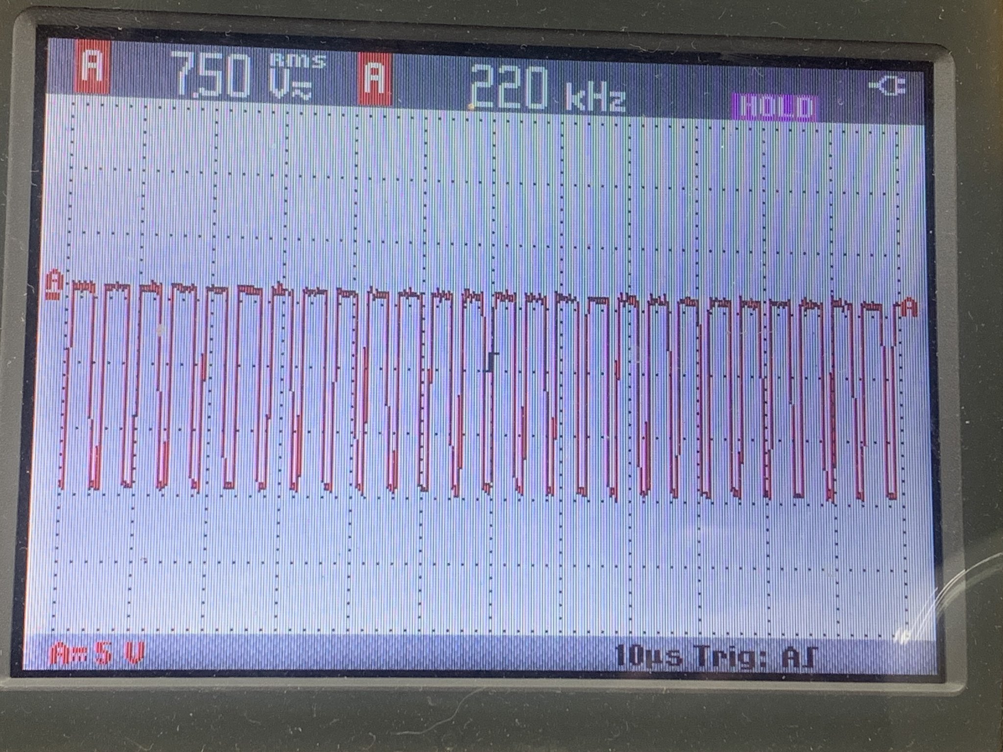

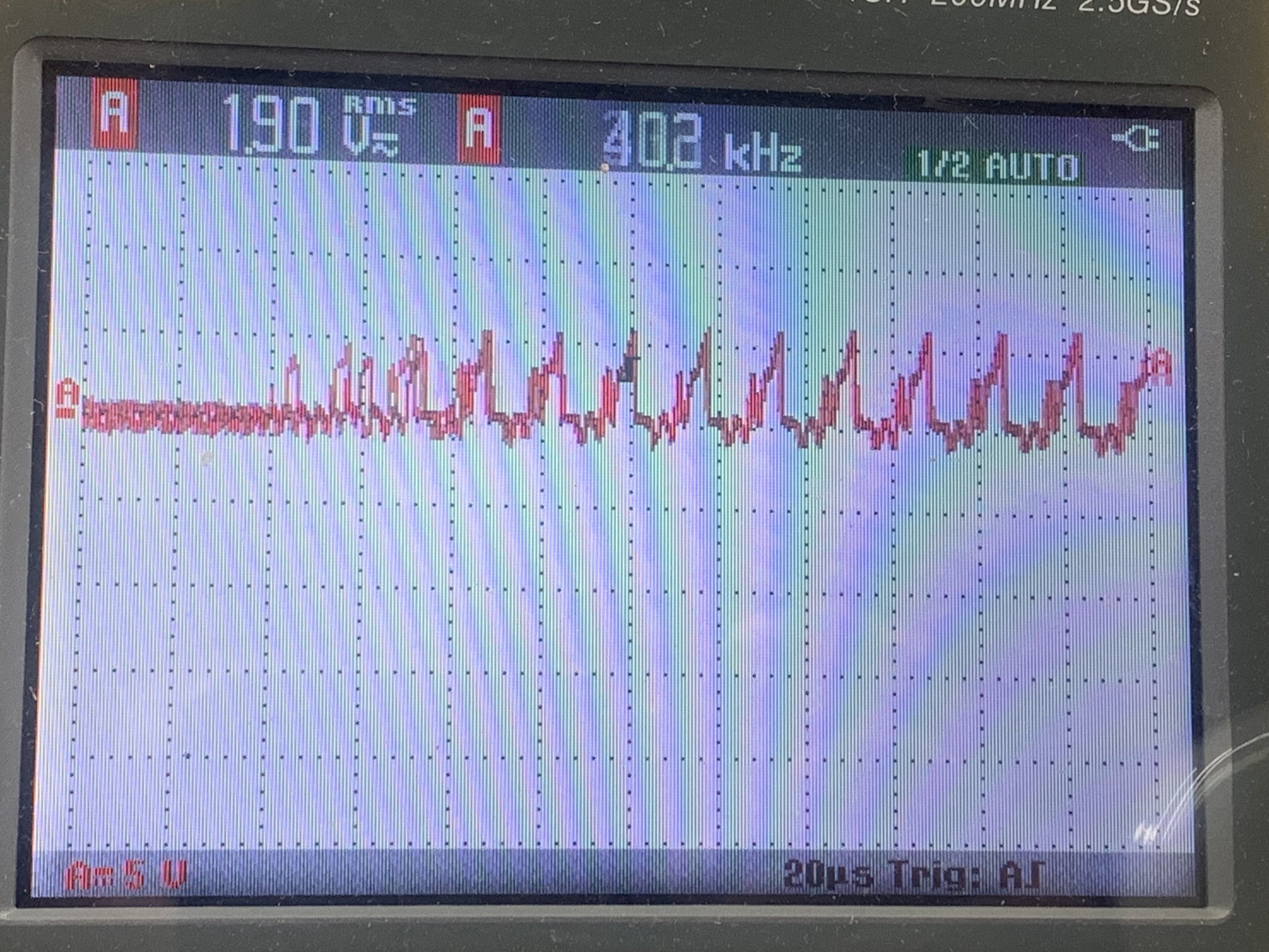

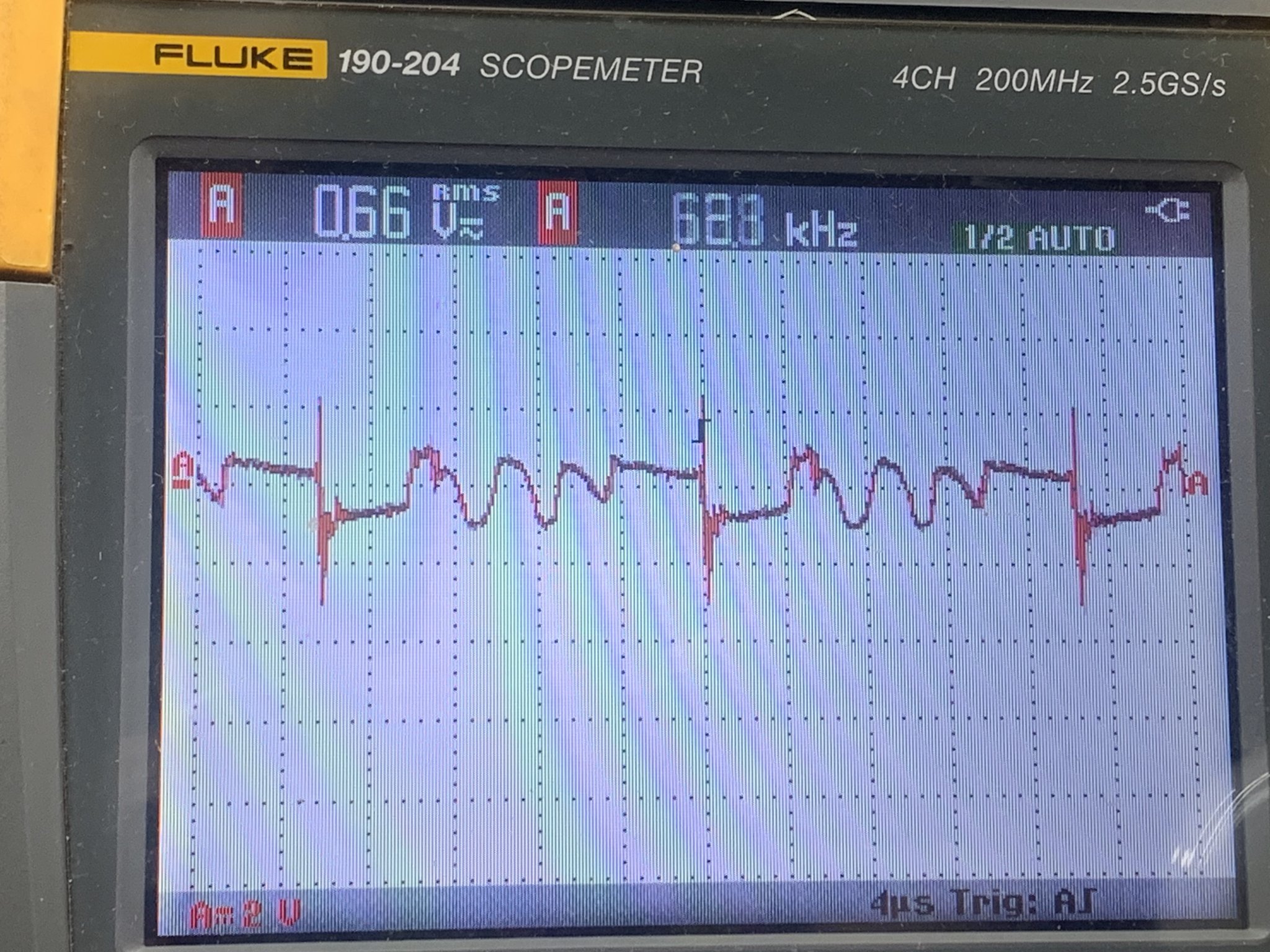

The sine wave at the Spk terminal is lost, I now have this this distortion at varying levels of input signal.
No I don’t have aprrox 20v drive at the gates, ground clip on source, LS (first pic)and HS FETs.
The voltages across the optocouplers and ne5532 are holding constant, except for the HS opto, it drops from 19.33 to 18.15vdc.

it’s the same as in the scope pics earlier
