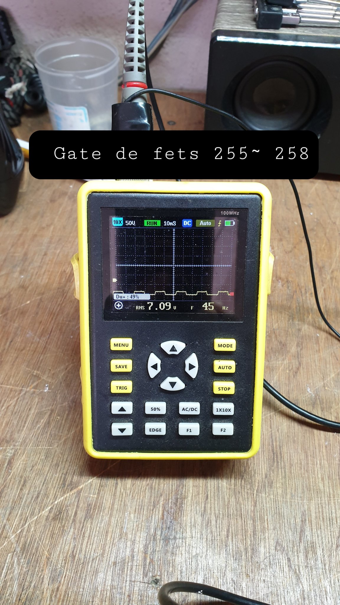

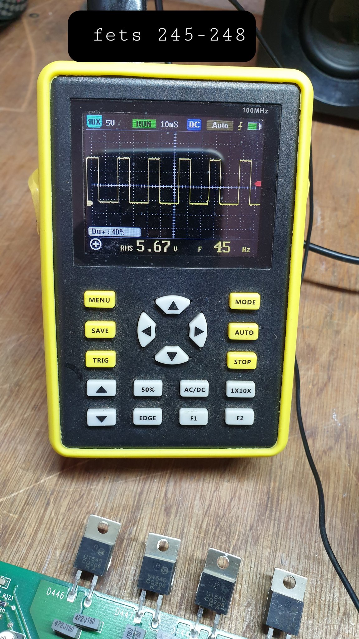

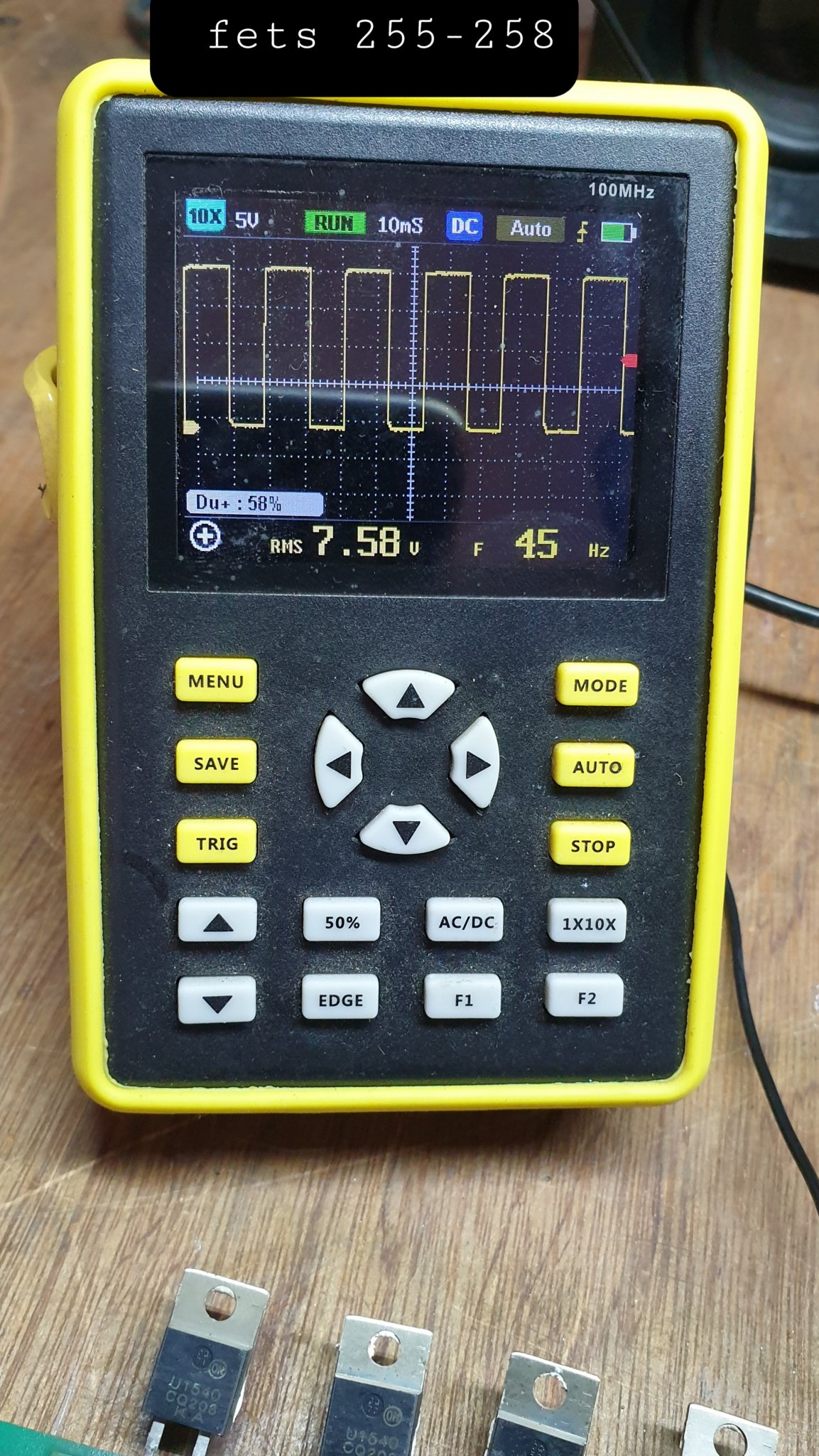

MTX 81000D LED 238 does not turn on and no audio

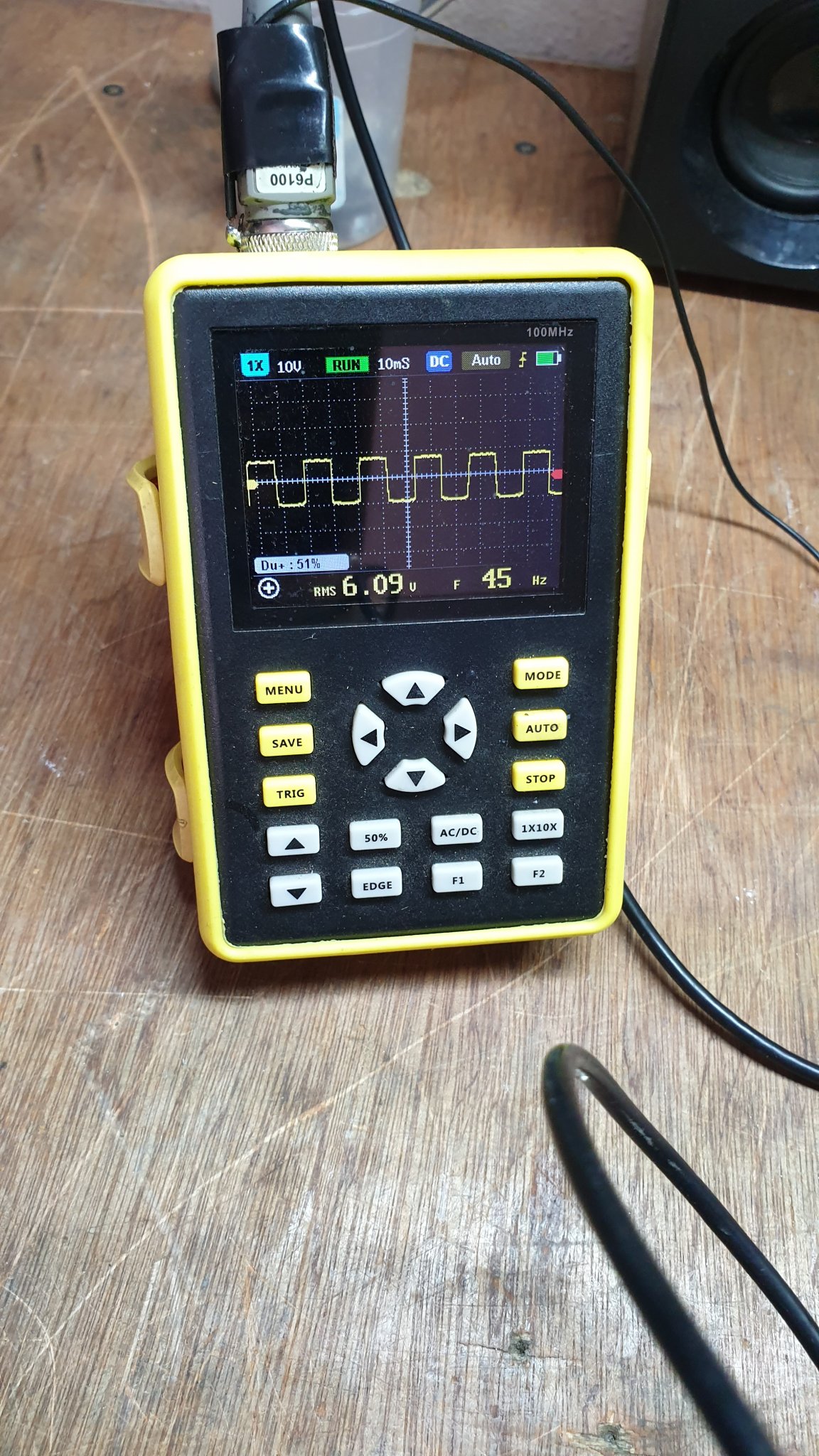

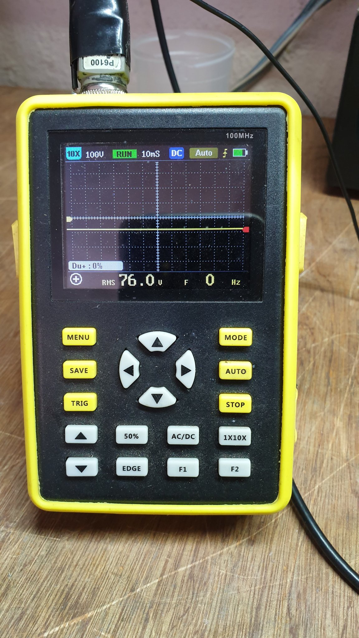

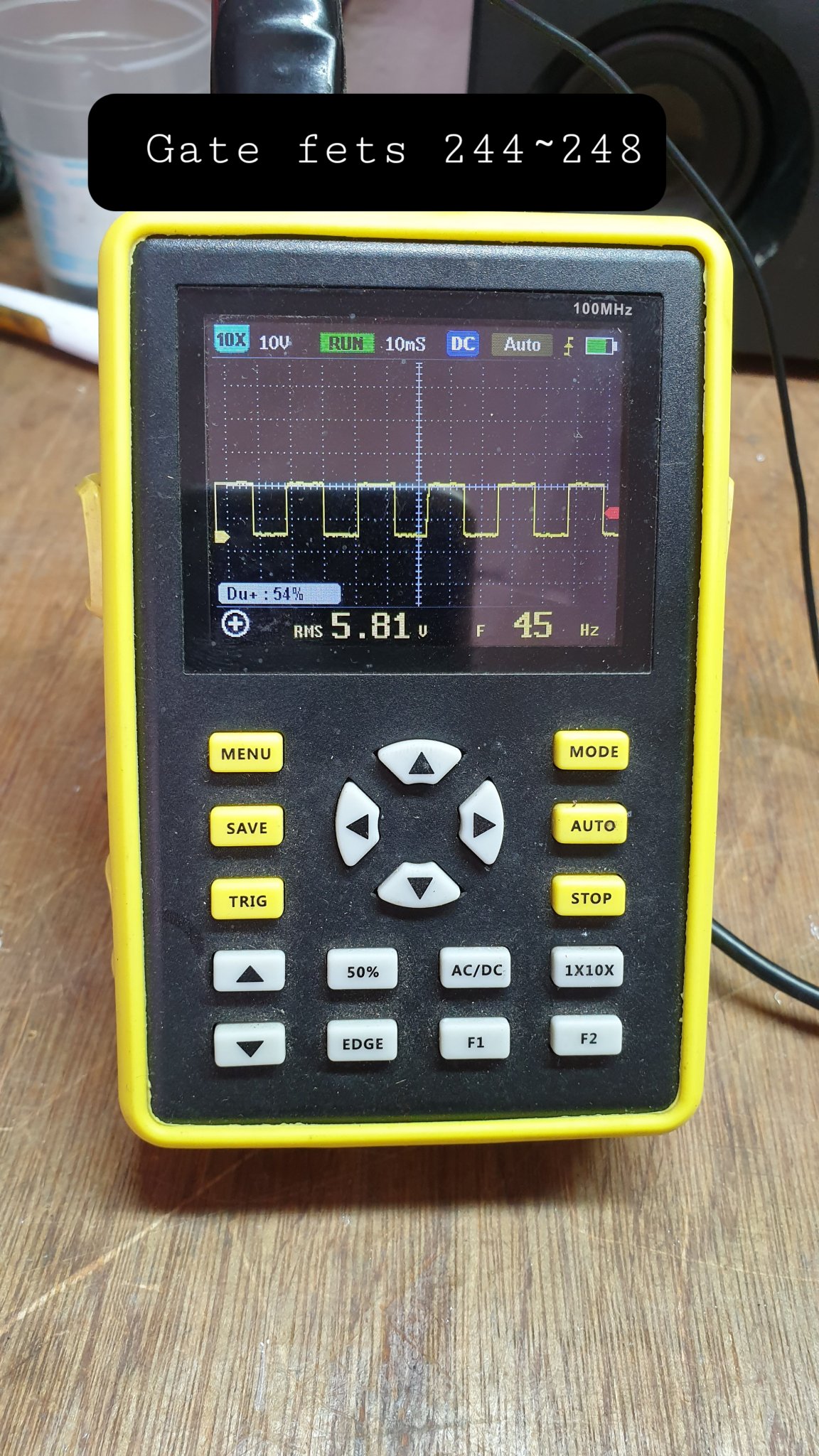

a square sign. I had to move the gain potentiometer to send a signal and the same signal is reflected in the gate of fets 245~248 and in the gate of fets 255~258 -76v

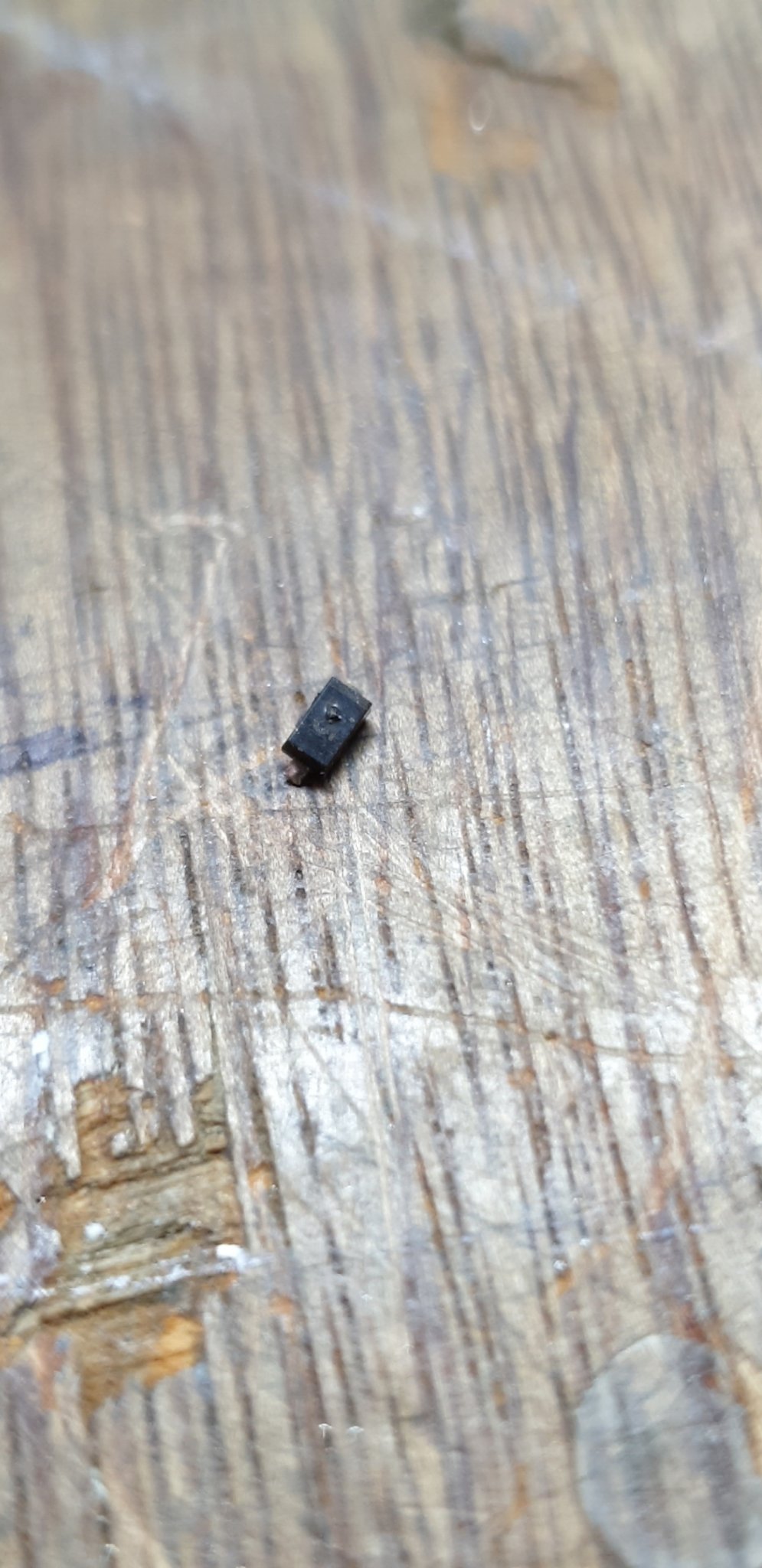

If it actually opened, the optocoupler that it was regulating for, may have failed.
MMSZ5250
Confirm that size is right before ordering.
Thank you, I already managed to get the diodes and the 3120 I have again the signals in the high and low side gate with a 0.1uf capacitor, in the end it was the resistance of r287 and the one of 100 ohms that is below d252, d260 and d253 and a 1000uf capacitor at 35v.
