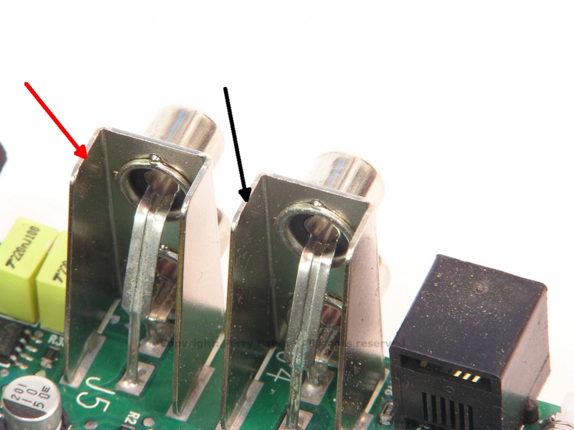

With nothing connected to the amp, what is the resistance between the shields of the two sets of RCA jacks?
Any resistance less than infinity can be considered continuity. Do you mean that you read 0 ohms?
If I understood correctly, you stated that you replaced the two 0.22 ohm resistors for the low voltage supply. Is that correct?
