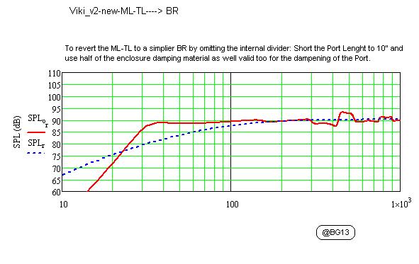

Hi viki,
Yet another option:
b🙂

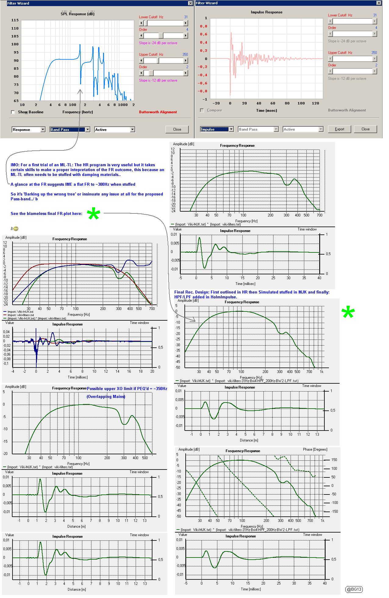

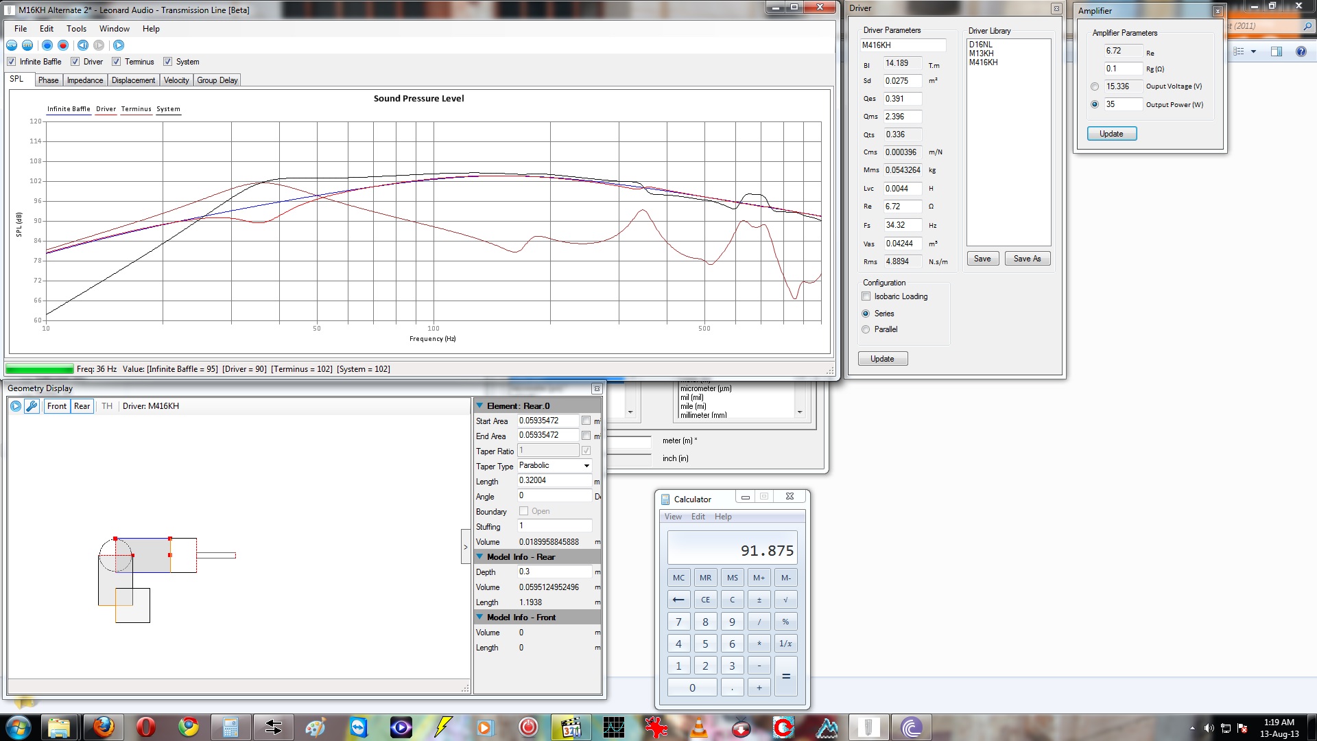

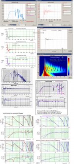

What software is this? It looks like HR but plotted in Holmimpulse, mixed with MJK worksheets?
The image is too small to see in any case...
Learn to use the forum tools, see the arrow thing in the corner of the image, it's an overlay, click it to expand. Title bar says Leonard Audio Transmission Line (beta)
http://www.diyaudio.com/forums/software-tools/220421-transmission-line-modelling-software.html
By using my method the driver maintains excursion control by limiting Vb to that of Vas and reduces all even order harmonics.
Example: If you make the enclosure too large the peak @ 2nd in the terminus (that results as the first peak in the driver response) that is to be ignored, causes it to become a null, larger the deeper the null is. If the driver center is offset incorrectly for a given alignment, the peak is shifted one way or the other depending on the phase angle of the node, but remains a peak none the less. It's back and forth repeat at every set to get the correct balance of all to work properly, eg in unison.

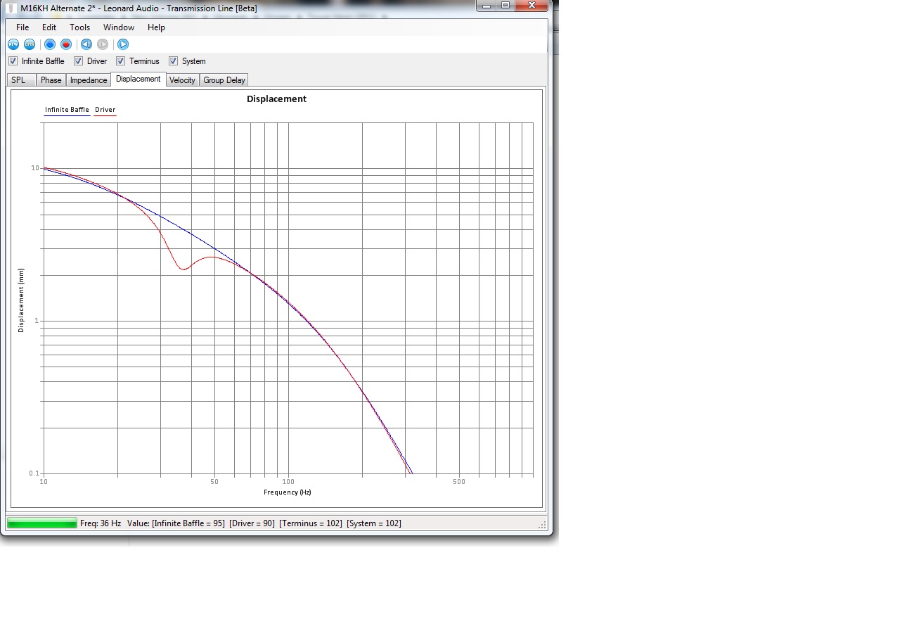

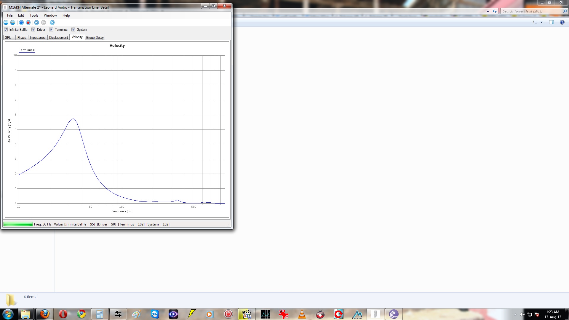

Hey Guys, I have been busy with TL Modelling software, See attached Image, See what you can make out of this. I targeted to do a MTM MLTL with design centre at 11" from top, tried creating few sections for varying stuffing,. I some how managed to do some geometries by fluke trying out various differences on resulting Spl.
Kindly check If I have done any good.
