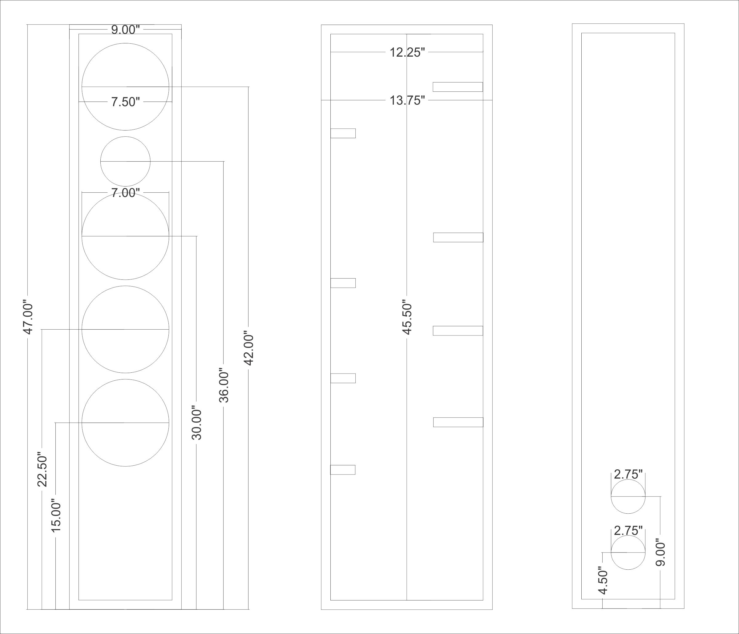

I have made a pair of MTMMM Floor standers. used Unibox to calculate enclosure.
I would appreciate if any one can help me optimize these with MLTL technique.
Box Internal Dimensions are-w9" x d12.25 x h45.5
Driver 6.5".
Two 7 cm ports at back located at 3.75" and 8.25" from Bottom , can be modified as necessary.
f(s) = 34.32 Hz
Q(ms) = 2.396
V(as) = 21.22 liters (0.750 cubic feet)
n(0) = 0.21 %
M(ms) = 22.84 grams
R(e) = 3.21 Ohms
Q(es) = 0.391
SPL = 85.31 dB SPL 1W/1m
C(ms) = 0.94 mm/N
Piston Diameter = 130 mm
Z(max) = 22.88 Ohms
Q(ts) = 0.336
L(e) = 0.220 mH at 10kHz
SPL = 89.27 dB SPL 2.83 Vrms
BL = 6.36

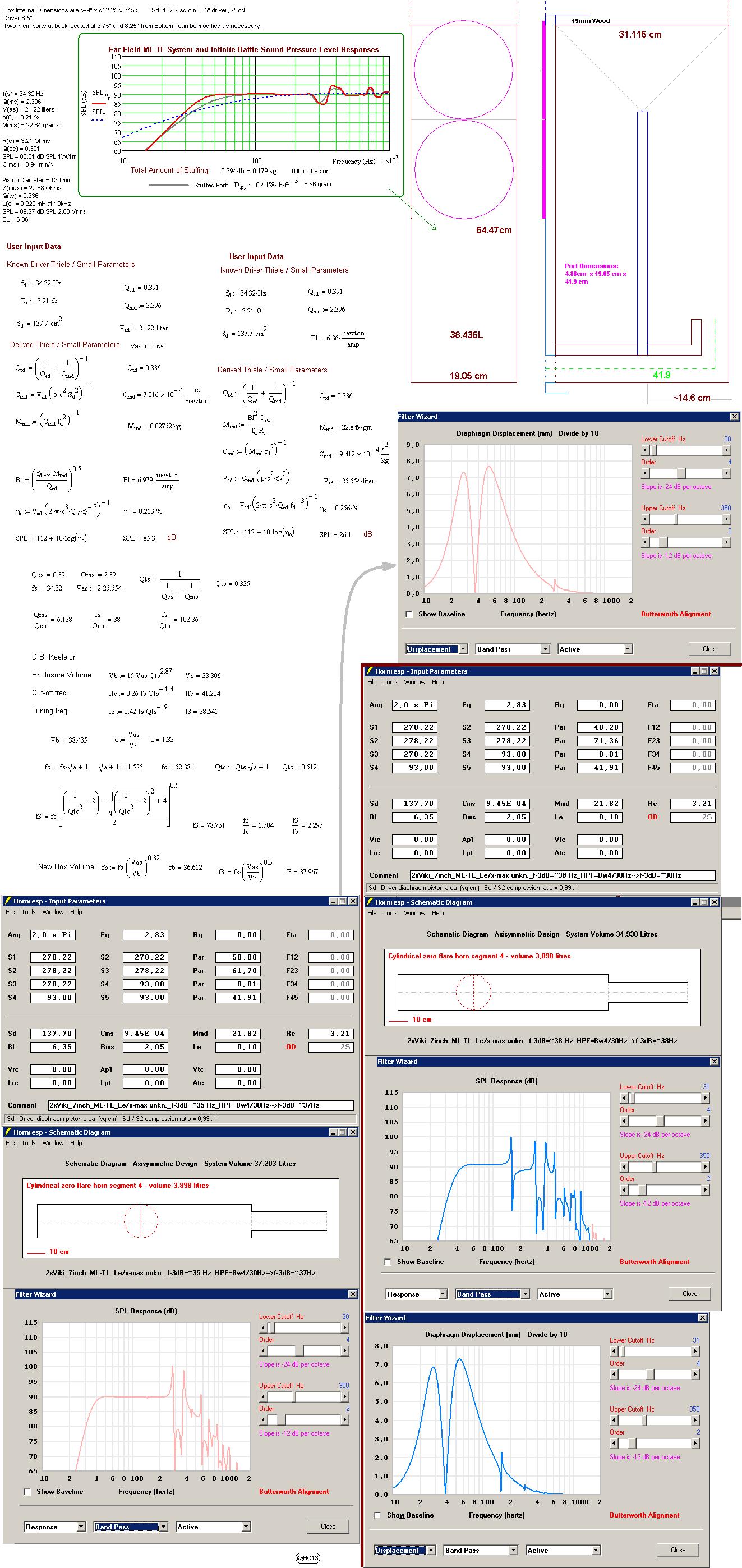

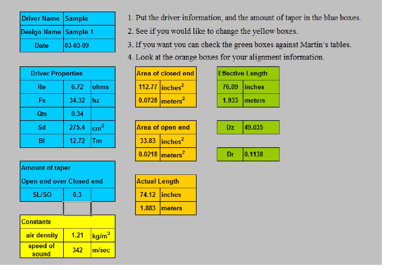

I tried Augsperger's TL Software ang have got following values for 2 drivers.
Kindly verify if these are good point for working, Also how to visualize the box for this.
Viki those numbers at a glace look fairly good, 3:1 taper no problem with that (similar to what I have going on with my design).
The issue I do see is that your enclosure picture doesn't show this taper, it's a straight taper MLTL. Additionally would suggest to isolate each driver to prevent plane waves from causing interference with adjoining drivers. Bracing is best if done vertically, split the panels width into thirds (roughly), will lend itself to be the stiffest and raises panel resonance to a point where it doesn't cause issue. Passes the knuckle wrap test, as it is often referred to.
Port placement should be less than 75mm from the bottom. Mine sit around 50mm. Is VERY important, sims show massive gains if this is done, if not at this position can have a negative result. Your ports are a tad on the small size and may cause vent noise if driven hard.
Modeling multiple drivers in a TL is problematic. I've taken the time to model each placement position and never like the result when combined. This complicated the heck out of the design, hence is not built, and months upon months of modeling, testing this or that, to get to where I am today... and I'm still not done.
What driver is this? Don't see an Xmax or power spec, which is helpful to know the drivers limits.
What you have is a bass reflex speaker. With the 4 woofers placed as you have them, there is no way you can make the cabinet resonate like a TL. Since there is no electrical time delay between the woofers, they will damp the standing wave in the pipe.
If the drivers are isolated or if the drivers are placed side by side at the same distance from top or bottom will yield a TL.
Isolation is best tho for a number of reasons. This is the reason why the Elsinore speaker that is a favorite of many is not an MLTL and is a Bass Reflex design.

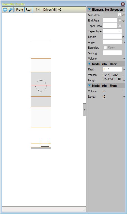

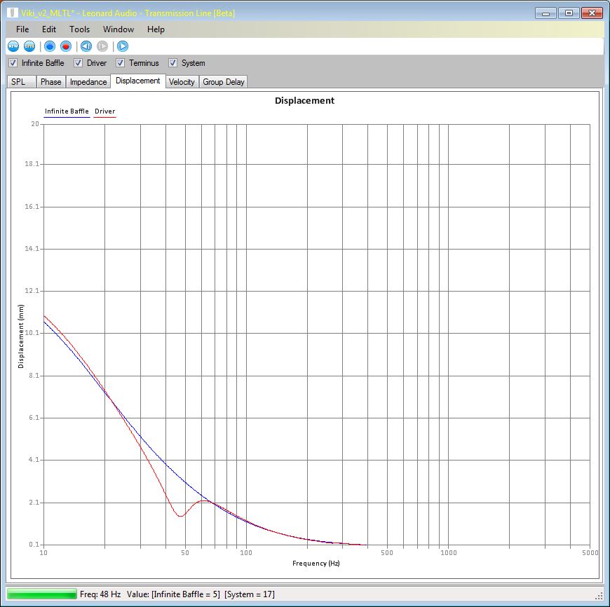

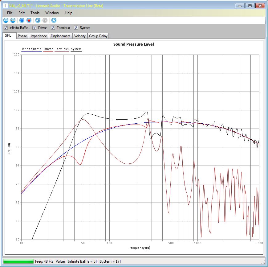

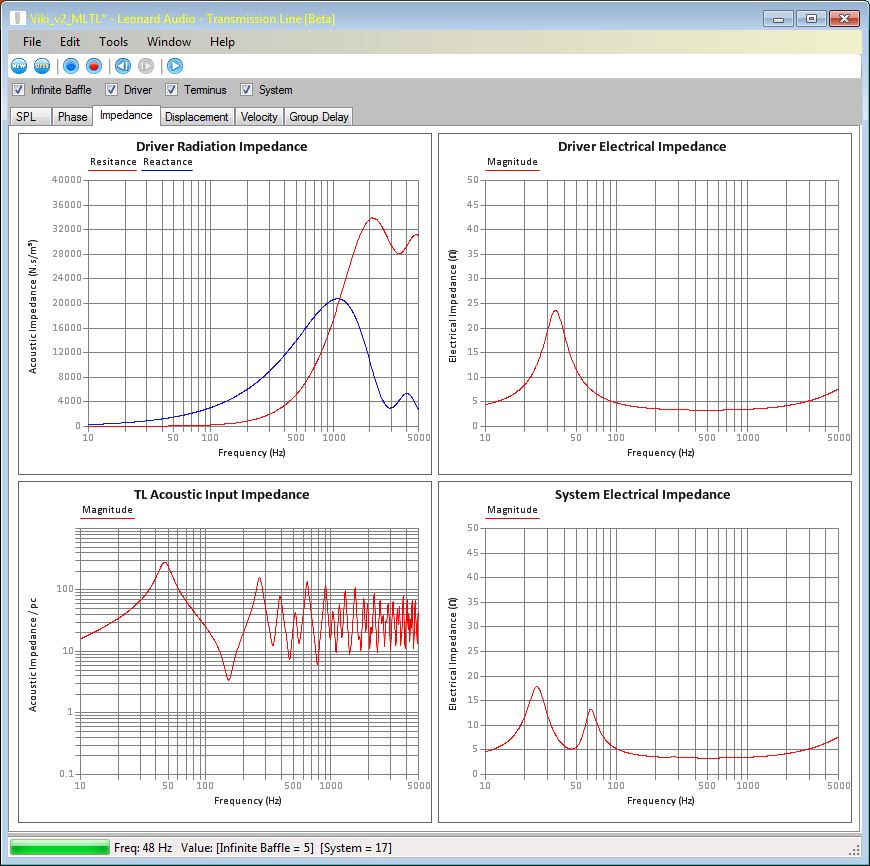

Here is an example using your driver, it's a basic straight line MLTL. Areas adjacient the driver is medium stuffing, next to that are lightly damped. The Base is 1" thick heavy dampening. All defined by default settings. Port is 76mm (3") diameter, 96.5mm (3.8") long and 6.35cm (2.5") from the bottom. Driver center is 54.4cm (21.4") from the top and 76.6cm (30.16") from the bottom. Total internal length ~131cm (51.56") with an internal volume of 22.7 liters. Port velocity peaks at 47Hz @ 7m/s.
Forgot to add this was at 20 watts single driver.
regarding PM you send I am posting here as I am not able to attach file through that .
I have made a drawing showing the folded 1:10 taper. I have not been able to figure out adjusting driver offset with tl software, also while working with 2 drivers , what will be the design center.

Hi viki_v2,
Have a look at this simulation using partly your dimensioning:
b🙂

I already have the enclosures made.The measurements you have provided reg partition and port will require cutting the box in half and lots of modifications, which will not be possible with current enclosure. I might as well make new enclosures with better design.
