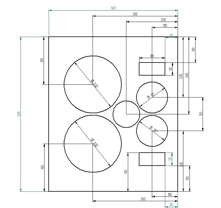

While discussing some possible project that i should design for someone, he asked if i could do an WWMTM with middomes in stead of cone middrivers. I tried to see if there are examples of that, but could not find any.
Is there a reason why this is never done before. Or did a mis some designs on that?

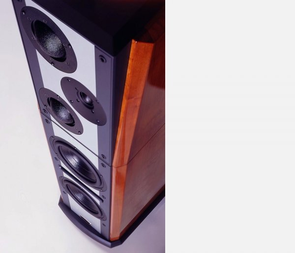

Does anyone remember this loudspeaker? SS woofers and tweeter, Dynaudio mids.

Certainly an intriguing idea! These are all good drivers. When choosing the mid/tweeter xover frequency, make sure you get a smooth dispersion. In other words, the off-axis SPL drop should be about the same for the mids and the tweeter at the xover frequency.His id was to use Bliesma tweeters and mids, and the purifi 8" woofers.

At minimum this will certainly need to be a multiple smaller LF driver 3 way system build to get the most from the mids. It also depends on his amplification and its low impedance drive capabilities. The problem you're facing with an MTM using larger mid domes (larger than 2") is the needed lower crossover point to avoid combing and the need to space them as tight as possible with the HF. Ideally smaller faceplate drivers are appropriate for this. If however, you're thinking of using the Bliesma T34B, I'd just do an WMTM with 2 higher end Scanspeak 6-7" cone mids and put the T34B in a waveguide. You won't be pushing that tweeter hard at all to keep up with the 2 mids, given the sensitivity and WG loading at about a 1.8k 12dB / 1.6k 18dB HP (for proper MTM vert lobe). If you choose to use dome mids, go with the T25B for tighter spacing. To my ears, the T25B sounds better up top, costs less and has a smaller faceplate too.

that is something i take in consideration, but i managed to get them close enough to do the crossover between tweeter and mid at 2kHz in my simulations, and both drivers would be very confortable at that point with a 3th order crossover i think. Distance between cones is 120mm, and distance between the two mids in that layout is 130mm. This is what the id is now. on the left the 2 middomes (M74A6), in the middle the tweeter and the woofers (PT8) on the left with the ports above and below the middomes. A bit inspired on the Dynaudio BM3 that someone mentioned here. Like this all drivers are very close to the tweeter.At minimum this will certainly need to be a multiple smaller LF driver 3 way system build to get the most from the mids. It also depends on his amplification and its low impedance drive capabilities. The problem you're facing with an MTM using larger mid domes (larger than 2") is the needed lower crossover point to avoid combing and the need to space them as tight as possible with the HF. Ideally smaller faceplate drivers are appropriate for this. If however, you're thinking of using the Bliesma T34B, I'd just do an WMTM with 2 higher end Scanspeak 6-7" cone mids and put the T34B in a waveguide. You won't be pushing that tweeter hard at all to keep up with the 2 mids, given the sensitivity and WG loading at about a 1.8k 12dB / 1.6k 18dB HP (for proper MTM vert lobe). If you choose to use dome mids, go with the T25B for tighter spacing. To my ears, the T25B sounds better up top, costs less and has a smaller faceplate too.
But as usual a lot of scenario's will be checked before i decide what it will be. This is not final, it's just the id i like the most at the moment.
I don't think that is a good design, the woofer has no breathing space on the back (it need to have at least some space because ofthe venting hole) and that MLTL is way to small to work well on higher volume. I did sim a MLTL for this driver and it is way bigger than here.Potential construction design for Hardwood baffle:

I wouldn't do it this way. The horizontal spread means that the horizontal lobing will be a mess, which will not exactly help the stereo imaging. I'd recommend to keep the drivers aligned vertically.This is what the id is now. on the left the 2 middomes (M74A6), in the middle the tweeter and the woofers (PT8) on the left with the ports above and below the middomes.

The external diameter of the Bliesma M74 is 121 mm. A Scan Speak D2004 tweeter has an external diameter of 55 mm, and a Scan D3004 has a diameter of 62 mm. The D2004 would allow a 176 mm vertical spacing of the mid domes, or 182 mm with the D3004. These numbers correspond to wavelengths of 1950 Hz (D2004) or 1885 Hz (D3004). So, to comply with d'Appolitos rules in my example, you'd want to keep the xover frequency at these values (or lower).
However, I would also look at the dispersion characteristics of the tweeter and midranges, and try to choose the xover frequency to get a smooth match at the xover. Looking at the datasheets of the drivers in my example above, the Bliesma starts beaming at about 2 kHz (or slightly below). The tweeters start beaming well above 3 kHz.
So, an xover frequency somewhere at 1.8 to 2 kHz would fit nicely (no beaming from both the mids and the tweeter), and would be nicely in line with d'Appolitos rule.
That driver config is going to generate some not so desired lobing characteristics around the crossover point and down into the mids. Not that it won't sound good on axis, but it certainly will behave unpredictably off axis. The reason i say this is based on experience with this exact driver setup on studio monitors. Given the output capability of a single 3" dome you're intending to use, it will be sort of a compromise on both ends to use 2 of them based on off axis performance alone, but also due to more complicated crossover design having both mids combine response and gain in a not so easy to manage way. In this situation I feel that less is more.that is something i take in consideration, but i managed to get them close enough to do the crossover between tweeter and mid at 2kHz in my simulations, and both drivers would be very confortable at that point with a 3th order crossover i think. Distance between cones is 120mm, and distance between the two mids in that layout is 130mm. This is what the id is now. on the left the 2 middomes (M74A6), in the middle the tweeter and the woofers (PT8) on the left with the ports above and below the middomes. A bit inspired on the Dynaudio BM3 that someone mentioned here. Like this all drivers are very close to the tweeter.

Changing to scanspeak tweeters is not what he wants i think. He's kind of set on Bliesma tweeters for various resons. I could maybe use the smaller T25 tweeter, i need to check if it can fit. Those are also 68mm wide. That could make it possible to put them only slightly offset of the tweeter. Would that be better? The woofer can go on top and bottom of that mid-tweeter config.I wouldn't do it this way. The horizontal spread means that the horizontal lobing will be a mess, which will not exactly help the stereo imaging. I'd recommend to keep the drivers aligned vertically.
