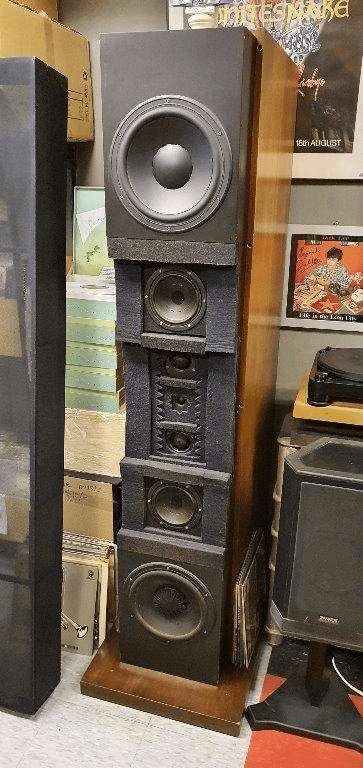

I would disagree. I have done a few & many drawings. Mirror image is essential. If one can get C-C within a quarter wavelength lobeing goes awayI wouldn't do it this way. The horizontal spread means that the horizontal lobing will be a mess, which will not exactly help the stereo imaging. I'd recommend to keep the drivers aligned vertically
dave
I don't think that is a good design, the woofer has no breathing space on the back (it need to have at least some space because ofthe venting hole) and that MLTL is way to small to work well on higher volume. I did sim a MLTL for this driver and it is way bigger than here.
The woofer's vent has enough space (look more closely), again though - I didn't provide the link with respect to the *acoustical design of the loudspeaker.
Instead I provided the link with respect to the construction of the hardwood baffle in relation to the box and drivers. Not only does it provide for expansion and contraction of the hardwood, it does so while also allowing back-mounting of the drivers with the ability to get back to the drivers again if needed/desired.
Notably if someone is going to the trouble of having hardwood for a baffle that they will likely NOT desire the aesthetics of showing the driver's frame and bolts - in other words: they will likely want the drivers back-mount on the baffle if at all possible.
*I didn't particularly like the T-Line either, but again: not the point of my post.
So you don't like the acoustic design and felt the need to dismiss what was actually offered based on that, yes?T didn’t say that wasn’t good, I don’t know etuff, it it is WAY more convoluted than any I have seen here, certainly none of the solid heavy builds I have. Given the”misinformation” I do recognize I would also discount that particular bit until I checked further. And the other parts of the box I do understand (bad) makes me leary… design & construction. And that they think it worthy of big buck drivers.

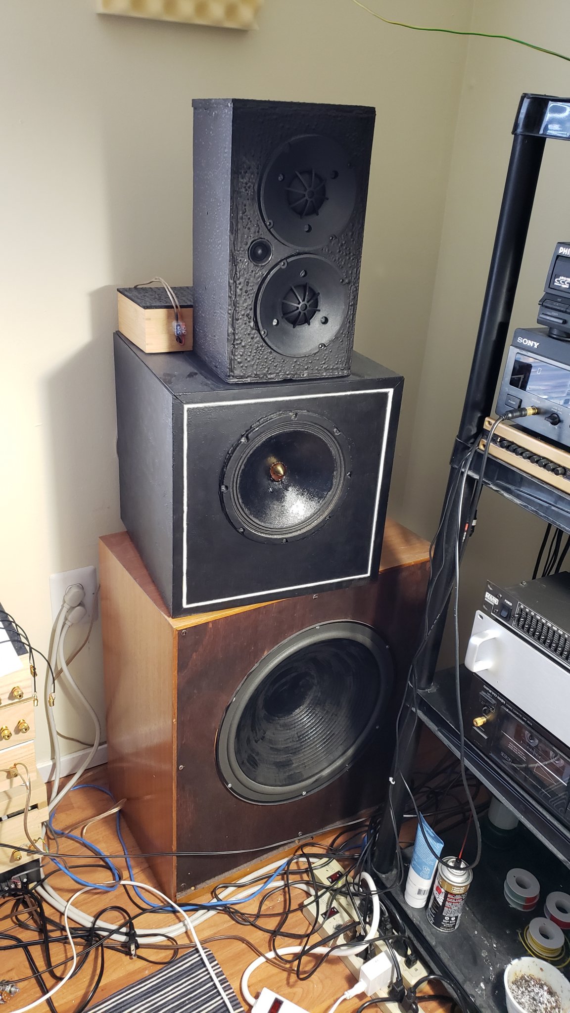

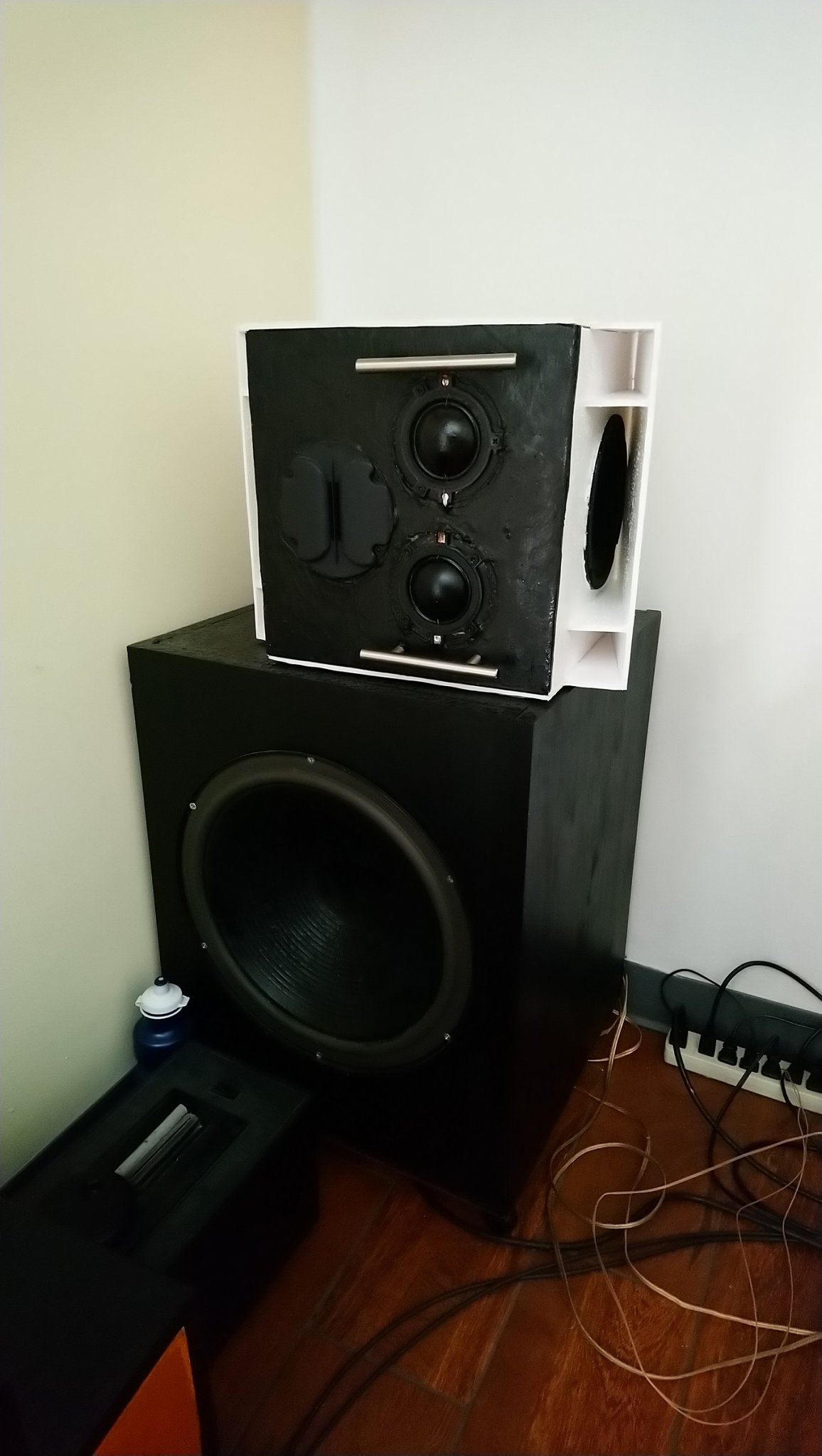

Some (early) Prototypes and some speakers:
2", 2,5" and 3" midrange domes.
But nowerdays I only use one midrange dome, I prefer the sound over 2.
- MTM with mid domes
