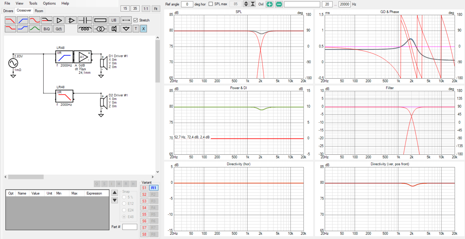

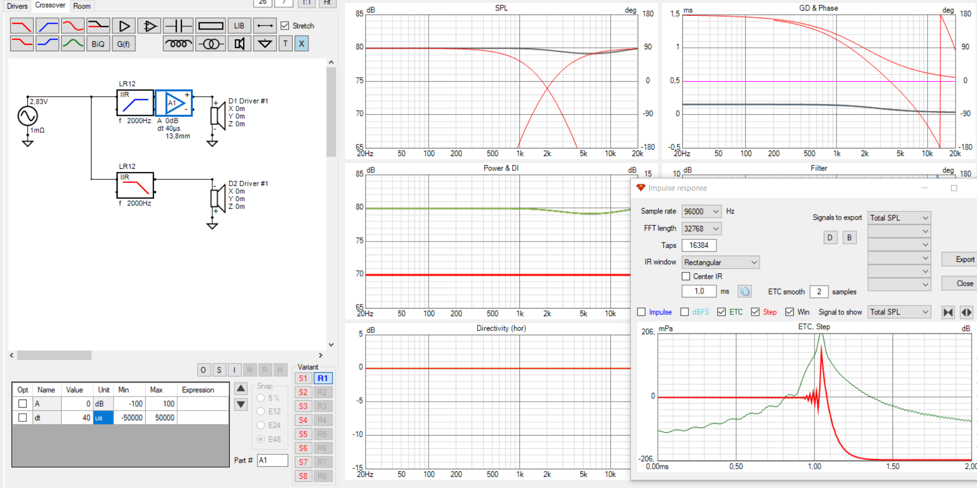

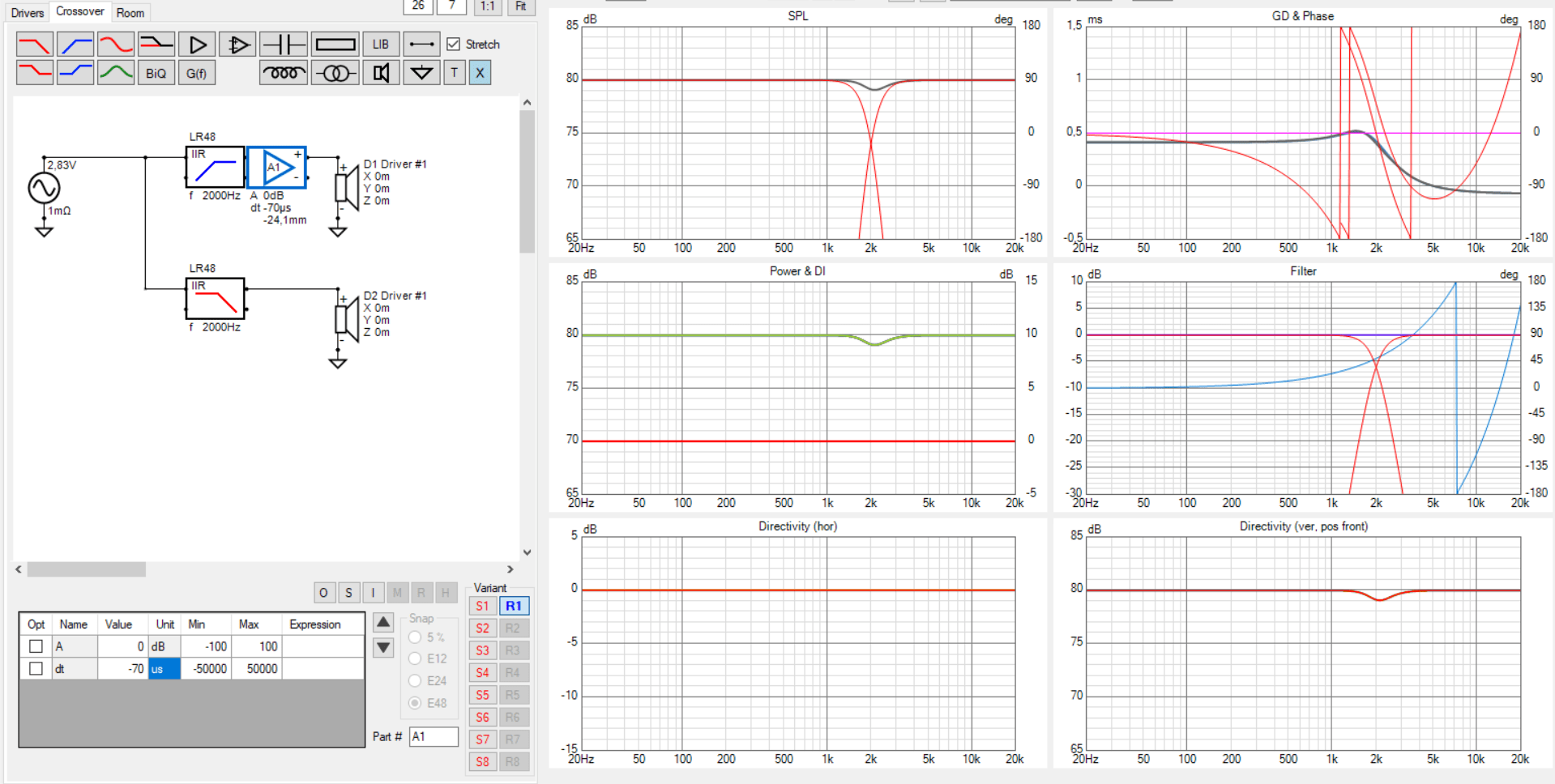

Well, fact check please, thanks 😀 Here some quick sims with ideal drivers coincident. As crossover order is low even small change lends itself to frequency response quick and even with quite steep filters delay past 1/8wl shows up in design axis frequency response as >1db. For example +/-2cm or ~0.06ms at 2kHz for 4th order LR filters makes the axial response vary ~1db. Still its about double what I guestimated on the previous post, or half the leeway.
Its also very interesting to have impulse response window open in VituixCAD and play with the delay see where the hair is. Note also group delay when "tweeter" is leading or lagging the "woofer". I have no idea how audible these are. Peak pressure in step response initial hit varies some, it seems to be much less if tweeter leads woofer and not that different if tweeter lags some. Group delay looks worse the otherway around, with more distinct bump with tweeter lagging woofer. Frequency response stays about the same with either "positive or negative phase difference" as the drivers are coincident. Non-coincident case the lobe would steer up or down depending which driver is leading.
Contrary to my previous post quoted above "timing" needs be much closer than I thought, especially with low order filters in order not to show up in frequency response plot.

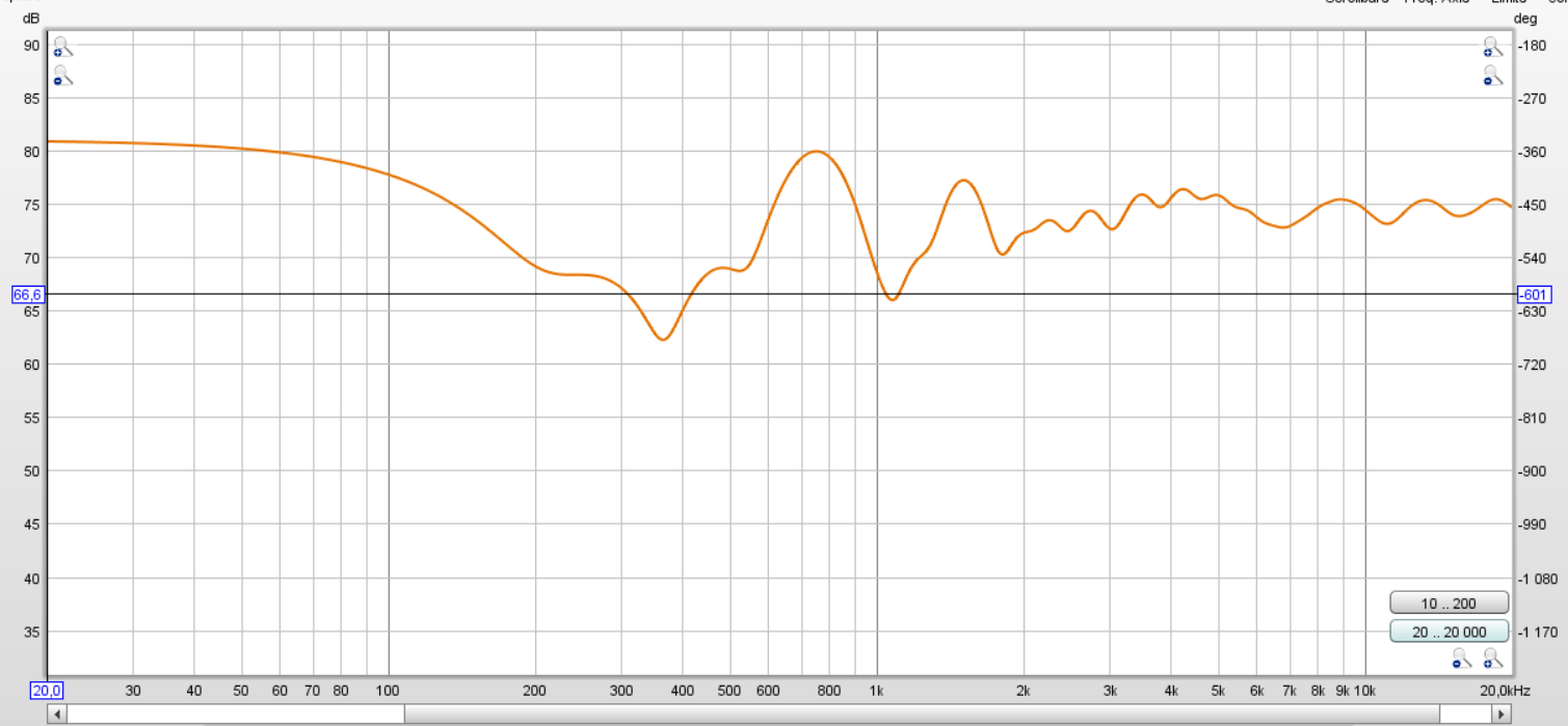

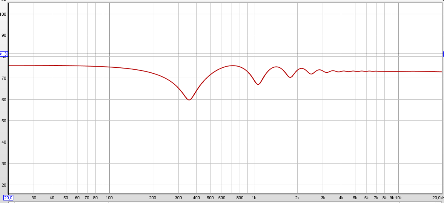

Attached simulated response of combfilter similar to what single floor reflection would make with direct sound (ideal sources in vituixCAD, other delayed 50cm in relation, but its irrelevant as the intention is just to demonstrate hearing system would smooth out the tight comb). REW:s psychoacoustic smoothing it smooths out past some kiloHz.
View attachment 1062878View attachment 1062879

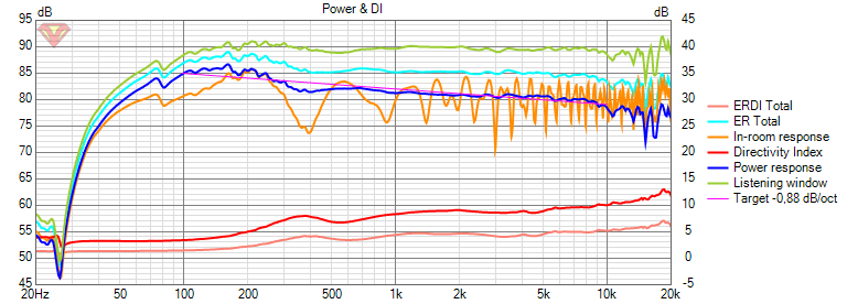

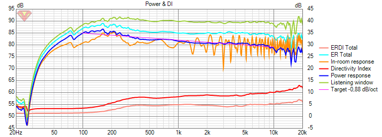

The orange line is a Vituixcad prediction of the effects of floor and ceiling reflections of a single driver vs an array of (25) similar sized drivers.
Having more vertical sources spreads the reflections and averages out the single space dips only one source creates. Basically it makes it seem
like floor and ceiling bounce don't exist for the array. Not included in the above graph is side walls etc. They will also have their own influence
that needs to be considered.
Even a coax will still suffer from floor and ceiling reflections. As will a MEH (multiple entry horn) as that can be seen as a very tightly spaced MTM and it acts as one source.
A WMTMW can be created to largely avoid the floor and ceiling reflections. As does the Fractal array demonstrated here: Fractal Array CBT by bbutterfield.

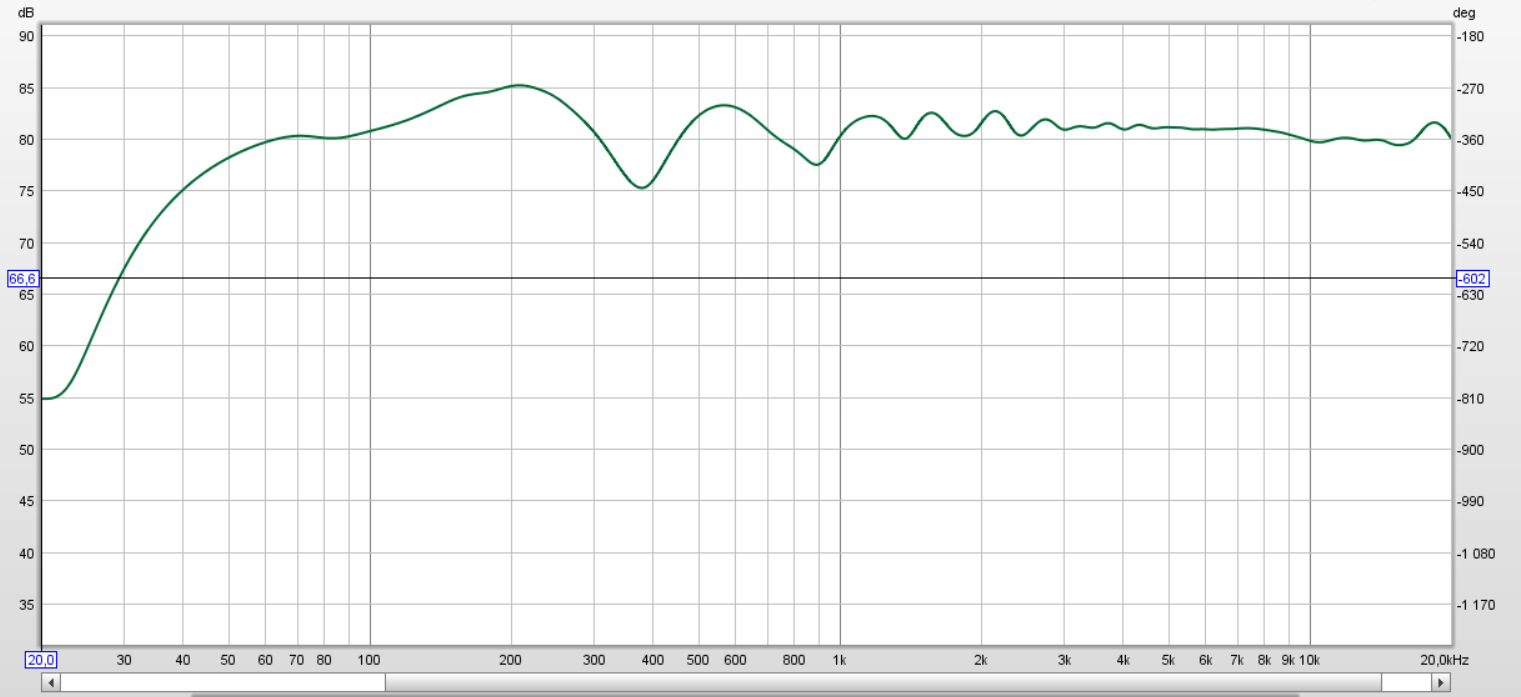

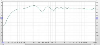

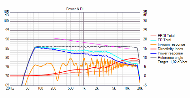

For what its worth here is a WMT speaker and situation if the mid is duplicated and made an WMTM system. Also with floor and ceiling reflections only.
Here REW psychoacoustic smoothed.
Much of the midrange <1kHz big dippers can be made go away which is nice. If crossovers were a bit higher, in other words smaller waveguide and mid transducers with reduced spacing the system would perhaps perform a bit better, narrow directivity bandwidth bit higher up to clean up better some of that 1-2kHz region. Perhaps narrower vertical coverage angle waveguide as well. Obviously much more interference seen here than with your full height array.
edit.
Just for sake of completeness here is the above WMTM with front and side wall first reflections included as well 🙂 But, its missing all the other corners in the room so not sure if this tells anything else than rooms and speaker positioning have huge effect on response, at least in simulation.
And here ideal point source in same location in simulator, so, to illustrate even ideal flat response point source (omni) got some issues with the room 😀 Some narrower coverage than omni is probably benefitical in any room. Unless, hearing system is just clever enough to mostly process the reflections away as they have exactly same response as direct sound, only delayed and attenuated some.
