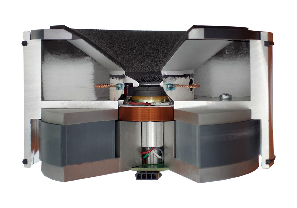

Only if we are talking about typical pro-sound coax with compression driver firing through the midrange pole piece.
For home/studio coaxials acoustic center separation is appr. 20 mm or less. This equals 50 deg phase rotation at 2500 Hz, or 1/7 wavelength. We can move the crossover even lower thanks to some degree of horn loading from the midrange cone.

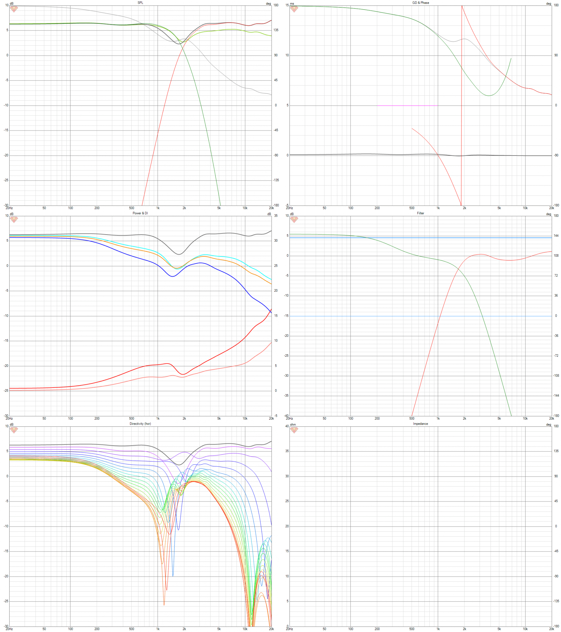

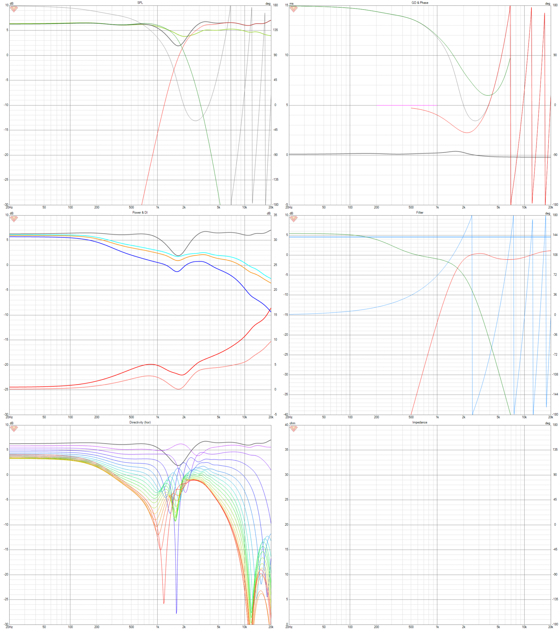

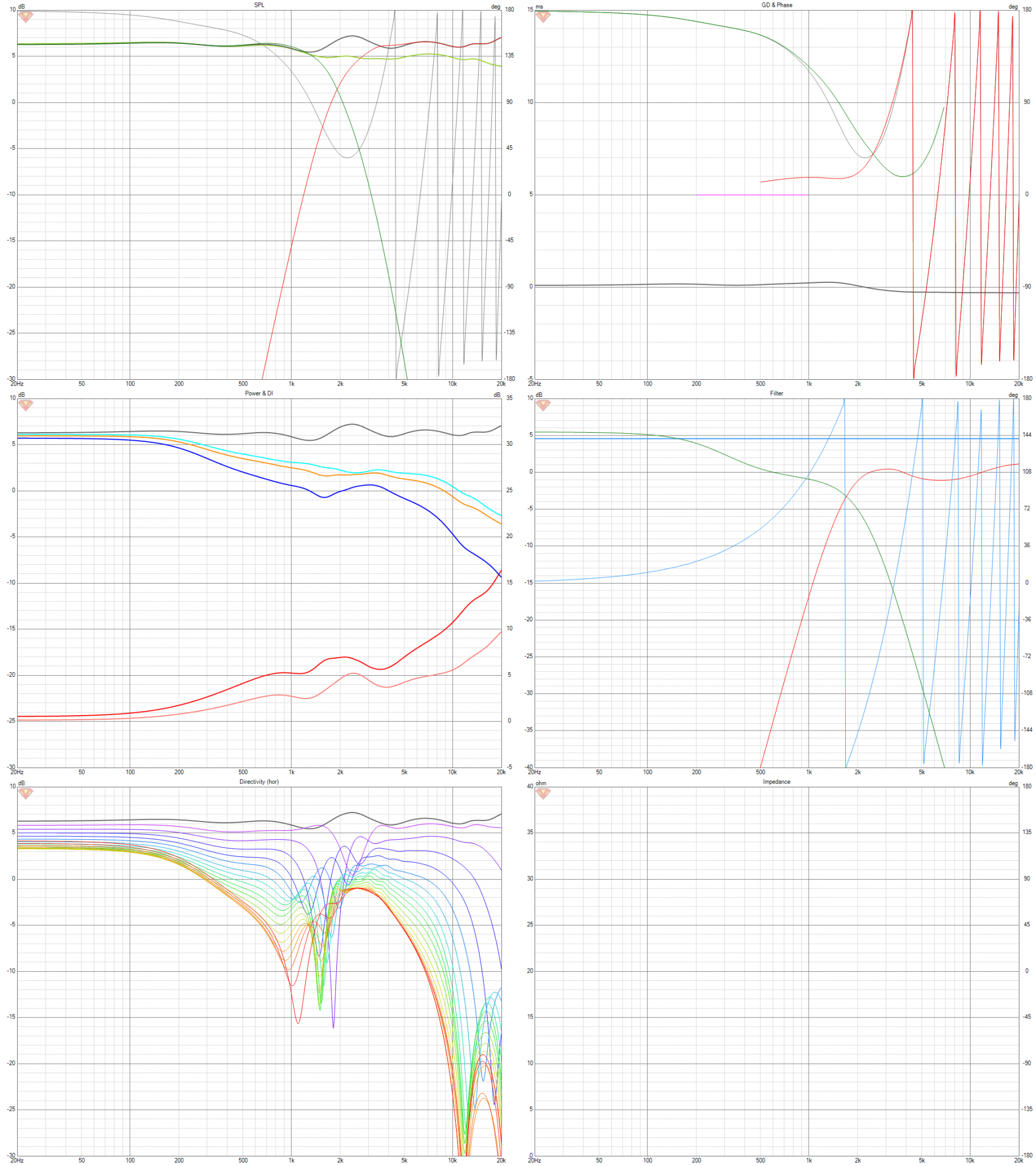

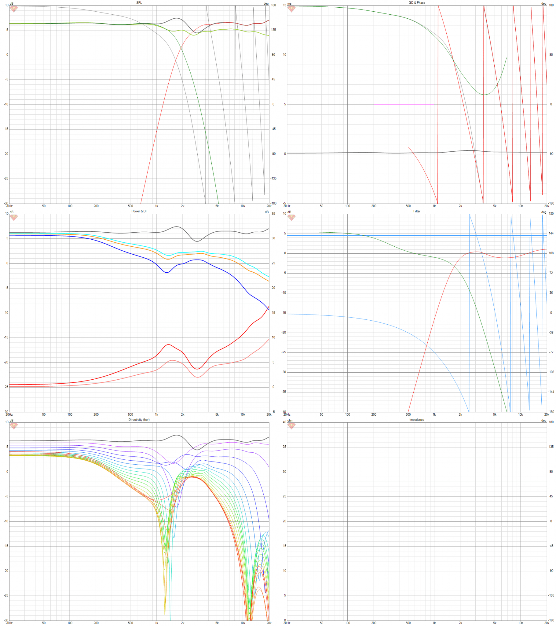

Have you ever used vcad and adjusted the timing between two ideal drivers?
edit:
I answered my own question... I used vcad on an ideal sim and changed the delay. I have the tweeter very far from a woofer. The sim says with a 0 delay I am getting an on-axis cancellation.

Yeah there is about 1/4 wavelength leeway around crossover not to have issues in design axis frequency response. I mean if the phase is past about +/-90 degrees between the drivers towards direction one is inspecting at it shows as dip in frequency response, simple as that. If the drivers are not coincident there is going to be dip anyway to some directions the drivers are stacked. One needs to take account path length difference from each driver to ear, if tweeter is at ear level and woofer below, then the distance to woofer is longer and this makes the difference in phase. Or just lift up the speaker to equalize distance from both drivers to ear. With coincident drivers there is not much issues with this except if the tweeter is crossed over too high, eg. the woofer is too big and response starts to narrow below crossover.
Example in numbers: 2kHz is ~17cm long so path length from drivers to ear can vary +/-4cm or +/-0.125ms and still have pretty much flat response towards the ear. Basically its frequency response to other directions, or lobing, one sees on polar maps that is the result of phase varying to an angle at crossover. This in turn affects response at listening position due to first reflections having different frequency response than direct sound.
Then there is the effect of group delay but the studies have demonstrated it needs to be quite much to start be audible, meaning that if there is single low order crossover at 2kHz on a speaker system then the group delay shouldn't matter much for perceived qualities in which case any perceived difference would come from the frequency response. Either design axis or off-axis through first reflections, basically watch out for the power response / directivity index.
To me this simply means that one should make the speaker so that DI is smooth. In addition try make sound towards first reflection points as much the same as direct sound as possible. Now the timings shouldn't matter mucho, they were fixed just by watching frequency response plots. Its pretty easy to notice anomalies in frequency response, linear distortion. There is case when high order crossovers and multiple ways on the speaker (or any stupid mistakes for example) add excess group delay so much that it starts to be audible but again this shouldn't be much of a problem if one is doing passive crossovers because the slopes are probably quite low order. With modern DSP it is possible to wipe out the excess group delay at will (FIR) but its also possible to make bad excess group delay, just be aware of what that is on the system. Hence first priority is to build the thing so that with crossover the system makes very smooth DI and nice smooth frequency response to important directions, then just checkout there is no stupid things going on with the filters so that excess group delay is reasonable and one should be golden. If not, its time to plan the system, the physical construct again so that such sound is possible!
