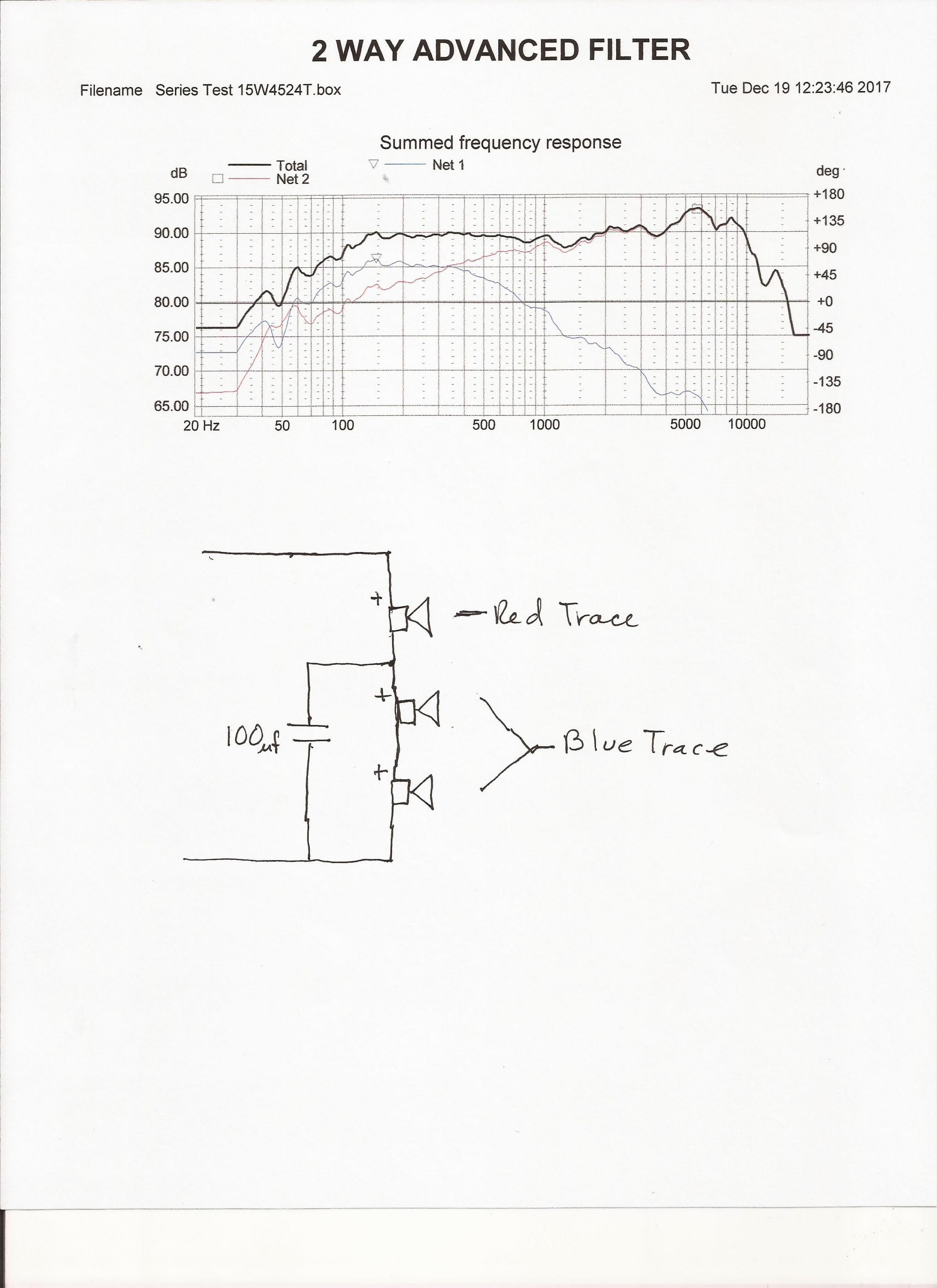

I do not intend to use the TMMM with all Ms going up to meet the tweeter. Only the upper one will. The lower 2 will be rolled off above 300 Hz in a series circuit with a large capacitor bypassing the lower 2. The attached sketch shows the configuration with a graph from an LspCAD sim showing the relative and additive response.
Some inherent directivity problem is common issue with multi-ways without coaxial driver anyway. Also MT has some lobing and power drop at the crossover range without phase mismatching or other tricks because M-T distance is usually 1/2...1/1 of wave length at the x/o frequency.
But if more vertical directivity at midrange is needed and wanted, and MTM or TMM is selected for the job, that should be done as good as possible I guess. Not by beauty or what personal guru writes on diyaudio. Target is high and extended total directivity (DI) without lobing problems within defined/normal listening window in vertical plane, and smooth axial and power response which is equal to smooth directivity index response. Usable range of drivers (non-linearities) shouldn't be exceeded of course.
I would measure MT prototype with selected or compatible drivers. Then simulate and optimize both MTM and TMM before making final decision and speakers.
Simulator should be able to calculate and visualize axial, power and off-axis responses in vertical plane. At least LspCAD 6 and VituixCAD are valid tools. The last one calculates also DI response which helps defining initial values for crossover optimizing.

Directivity is probably quite concentrated at the x/o frequency and slightly below. Some lobing might exists in horizontal plane. Otherwise it's kinda mix of both MTM and TMM. Impossible to say is it better or worse than plain MTM and TMM with the same drivers.
I'd never cross an mtm or tmm above 2khz anywayDirectivity is probably quite concentrated at the x/o frequency and slightly below. Some lobing might exists in horizontal plane. Otherwise it's kinda mix of both MTM and TMM. Impossible to say is it better or worse than plain MTM and TMM with the same drivers.

I made quick and dirty simulation with horizontal offset of tweeter crossed just below 2 kHz. That doesn't look very promising. DI and power response curves could be quite difficult to handle.

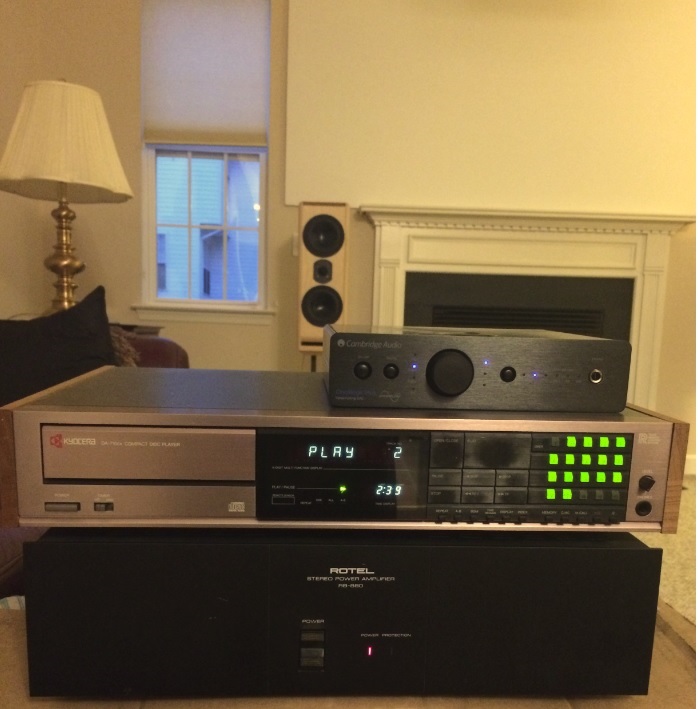

This combination was unbelievable - put on your seatbelt plz.
This vintage 880 has plenty of life in it, the kettle drums are amazing.
[mini DAC is very convenient, for fast hookup, and also has preamp functions]
Sounds like the National Symphony Orchestra at the Kennedy Center.
