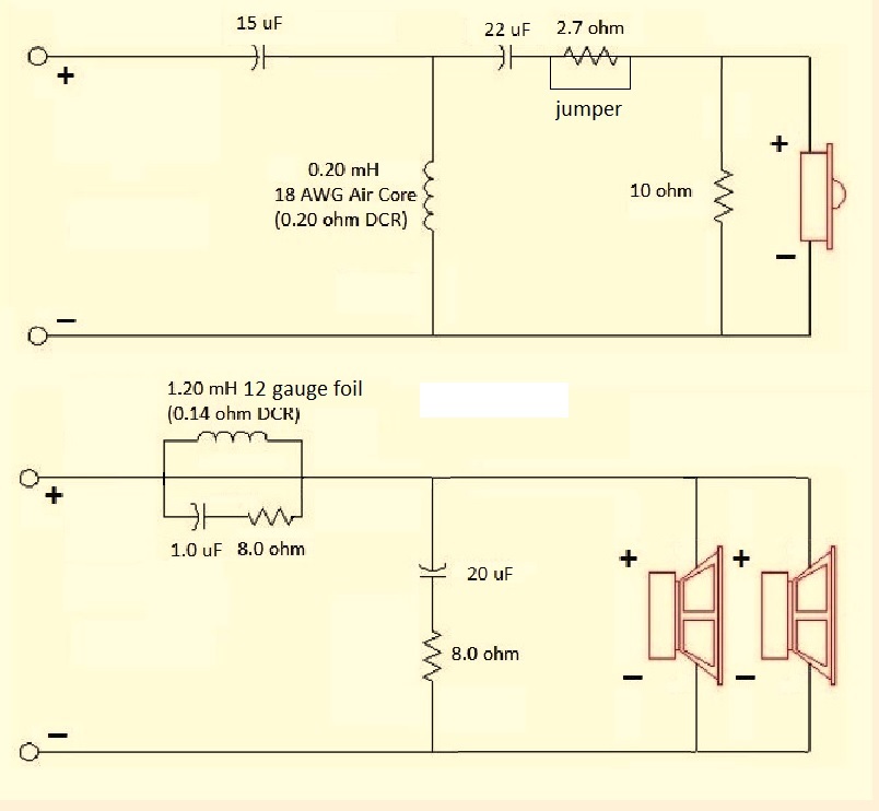

The xo's were modeled, attached:
The heaver coils are on the way, should be here the end of the week, and will dive back into that this weekend.

It looks as though you have modelled that crossover on making a perfect null on axis with reversed polarity. Now, I'm only guessing here but when I design a crossover it doesn't always do that because all directions are being considered (for TM or MTM). Another example, IIRC D'Appolito explored 90 degrees phase difference to splay the two inverted sets of lobes to fill the gaps.
What I would be interested in here, is vertical polars. Woofers on their own, and all drivers combined. I'd also wonder if there is any difference between the two speaker types if their response was the same and there were ceiling absorbers. -Just thinking aloud, please carry on.

Allen, I thought a perfect null was the always the goal.

If I use a standard first order filter as an example, response is -3dB for both drivers and phase is 90 degrees apart. On axis the response adds up to 0dB but on one side of the lobe it rises to +3dB and on the other side it falls toward a null. If you were to bring the phase together on axis, all that changes is the physical angle of the lobe, and the on axis response.
Took longer than expected, but new xo's are finished. There are a few small changes to the mtm xo design, which I would recommend. They needed just a little more top end, so bypassed the 2.7 series resistor, which sounds very nice, balanced and mellow. Dialogue is better than ever. These mtm's do have a better sound stage; sounds from far left/right. As mentioned the sound is very relaxed and easy listening.
