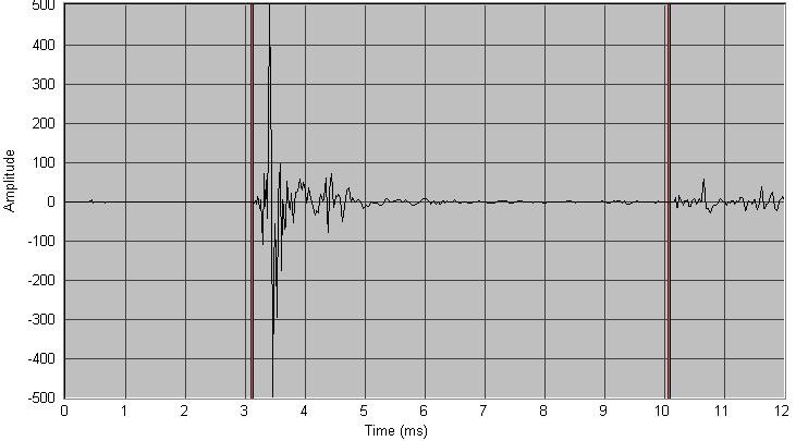

Below is a sample impulse response for a Seas 27TBFC/G. Note the start marker just before the impulse, and end marker before the first reflection:
You can advance the start marker even further before the impulse (it doesn't have to be just before the impulse). The benefit with advancing the start marker (ie. making closer to or at zero) - is it increases the gate length = greater resolution in SW.
The disadvantage is you will get more phase wrapping potentially making crossover design more difficult.
For most measurements - a sample rate of 48K and sample size of 65000 work well.

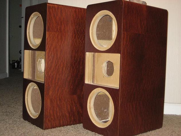

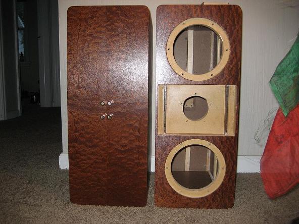

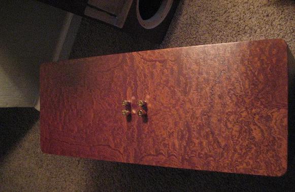

Thanks Dave, I havn't gotten to measurements as yet. I spent finishing the enclosures today. The veneer is a sapelle pomelle and looks really nice; the pictures don't do them justice. I finished it off by spraying a couple of medium gloss lacquer coats.
The brown stuff in the enclosures is the melamine/felt constrained layer damping. I used a simple cross brace across the sides and back. Tomorrow I'll try and finish the crossover and if I'm lucky, I'll have these babies up and running
The cabinets look beautiful. The veneer is great.
The only concern is the way you have recessed the tweeter. The cavity might cause some nasty diffraction effects, requiring more crossover work to smooth out.
If you are recessing to time-align the drivers, that is not necessary. You can usually achieve this via some asymmetry in your crossover slopes
David.

Hey Dave, glad you like it. I'm really happy with it as this is really my first project. i'm basically cloning the Lipinski L 707 which in turn were inspired by the truly venerable Dunlavys.
http://www.lipinskisound.com/l707.aspx
Just like these, I'm using an open cell foam for the tweeter surrounds. Inductor has been helping me out with the crossover which is a non symmetric crossover. The tweeter is a second order LR while the mid range driver has a first order butterworth.
Once I have these hooked up I'll be able to take some good measurements with SW and fine tune the network from there.
I'll post some more pics soon... and thanks again
Jason.
