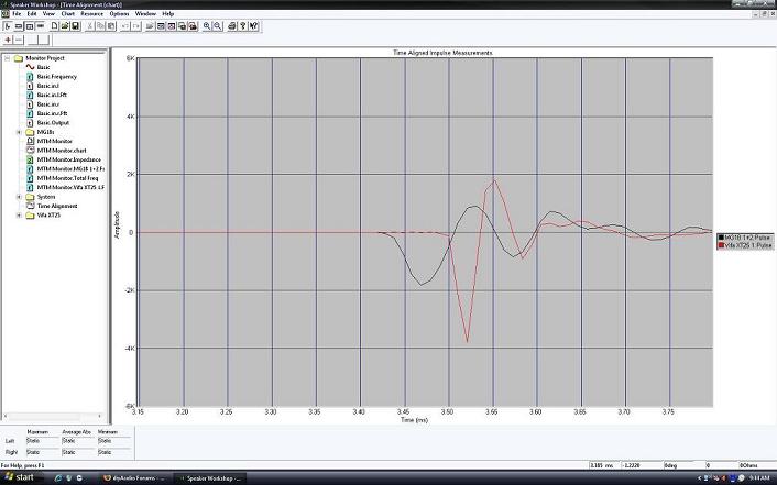

i'll take Thanks Inductor. Once I build it, I'll take some standard measurements using speaker workshop. Then I can take it on from there
If there is a dip in the xover region we can recheck everything again, but it's very much like the "original one" in Stereophile, at least with similar results, you know, the rool overs and atten. at 2K and peak from the woofer at this frequency with also the tweeter "integration". Check if the tweeter is "at your level" in output from to 2k~5K where the woofer falls or to low, and then the balance of the overall.
I also checked the time alignment using speaker workshop and it appears to be pretty acceptable at about .03ms time lag between the woofer and tweeter. I had both tweeter and woofer hooked up in phase and measured from the same distance. I just moved the mic up and down to align it with the respective driver at a distance of about 3 inches.
The chart legend is wrong; the red trace is Vifs MG25 mid range and the black trace is the XT25 and therefore, the mid range is about .03ms behind the tweeter
