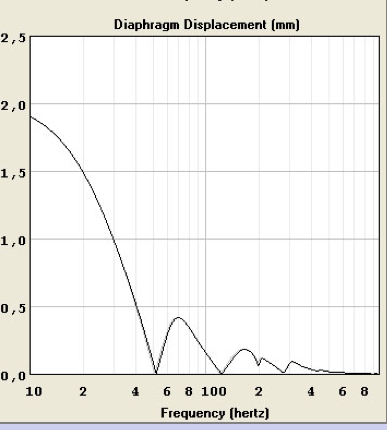

I had them crossed at 45Hz with a 24dB BW slope and i think i might raise that to 50Hz in hope of getting rid of some cone movement.
Assuming the Tham 12 simulation is correct, (which you could confirm with sine wave testing) the excursion minima is around 51 Hz.
With a BW24 at 45 Hz the drivers are more likely running out of excursion in the 60-80Hz range, only way to reduce that is turn down the volume.

Can only say that you are absolutely correct according to that simulation.
I will have to do some proper testing to find out how much power they can take without exceeding xmax.
As i am looking at the drivers moving it seems to me, that they sometimes move quiet alot, but is there an easy way to see/measure how much the cone is actually moving?
So in 60-80hz it seems that the graph suggests that the output is less than 0.5mm, is that supposed to be 0.5cm? The driver has an xmax of 7mm so 0.5 cm would make more sense?
Perhaps I misunderstand something else?
Simply put a white dot on the cone, run sine waves through the cone, and compare the dot's peak to peak movement at various frequencies with a ruler.
When approaching Xmax (half of the peak to peak distance), make sure to not run sine waves for more than a few seconds, and leave at least double the time between tests as the individual tests take.
If you don't want the detail, use pink noise. If you raise the HP to 50 Hz and the cone is still over Xmax, you know the problem area is above Fb.

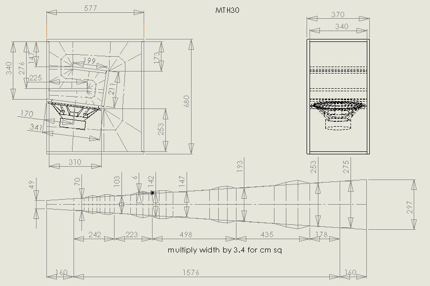

I decided to unfold the MTH30 to be able to compare the design with the Tham 12:judge:
The MTH30 is bigger and the horn is wider but the path is much shorter
S2 to S4 (Or S3) is 157.6cm compared with 172.3 for the Tham 12
The MTH fold is very linear and the only comment I have is the 199MM panel could be increased by 11mm to gain a little path length and linearity.
In its basic form, without any adjustment for the driver, the sim in Hornresp could be done with only 3 sections.
Screen grab of MTH30 unfold, and PDF comparing with the Tham12
Lots of extra dimensions for Akabak fans!
Regards Xoc1

Thanks for the comparison. Can some of you try to connect the differences in the design to expected or measured differences in performance? If we suppose for a moment that either the MTH had a slightly longer path or the THAM a slightly shorter path, what does this mean?
Hi ghettosynth,
How about comparing:
Post #27: Hornresp for MTH30
Post #89: Hornresp for THAM12 ?
Then use the Wizard in Hornresp to see what dimensional change produces what result?
I'm sorry if I wasn't clear. Indeed, I've been playing with these designs for some time. Many of these variables are not independent and it is often not clear what in the system is changing when a parameter changes. I was really trying to get a bigger picture here.
Bl of PD.12SB30 in post 89 is wrong, It's 19.3 and not 18.3
Sim of MTH-30 (black) and Tham12 (grey), same loudspeaker PD12SB30
So, to me, these look similar. The MTH looks like it has a bit more low extension but the roll off of the THAM is less steep, also, given that people observe that the sims are "peakier" than reality, I would expect that the MTH is slightly louder for the same input.
Based on experience, do you guys think that these boxes would produce similar results? Which box would you build? I read elsewhere that they could not be compared because the MTH has much larger volume? I get that the horn length relates to the tuning of the box, but it's still not clear to me how, holding horn length constant, how an increase or decrease in volume will affect the system.
