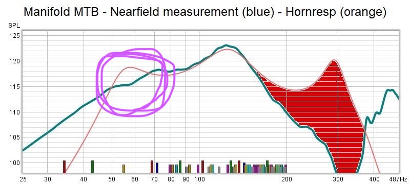

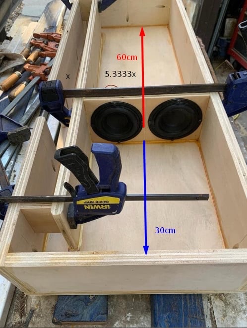

When building the cab, to get the driver in and out without rear mounting it with an access panel, I had to move it closer to the mouth. I never adjusted the simulation after this
Running the numbers again (with the correct driver offset), the sharp drop at 300hz occurs in the simulation. Note that the driver offset is indeed 1/4 wavelength of the null in the simulation, as LORDSANSUI suggested.
There we go - the build didn't match the sim 🙂
If you want some of that lost SPL back, try stuffing the closed end of the horn that's behind the driver. That should reduce the impact of the reflection from the closed end of the horn on the overall output.

I am curious weather your sim was also improved in the 55hz region, as your previous comparison showed a pretty significant decrease in spl in that area.
I would personally be way more concerned about that, than the dip at 300hz, as you will probably be crossing over way before that anyway. As @Brian Steele pointed out, the 300hz cancellation might be an advantage, as it tidies up some of the mess outside the bandpass.

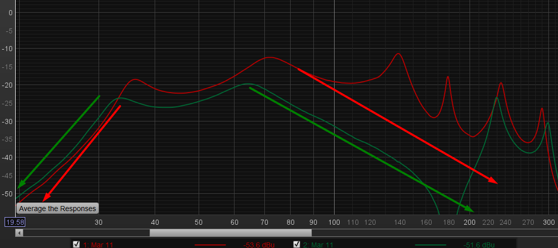

Do you find the center of the cancelation area to be very closely related to the actual full wave length that ‘fits’ between front and rear location of the driver?
I notice in my measurements of this it’s the 192 hz (180 cm) (the green one)
