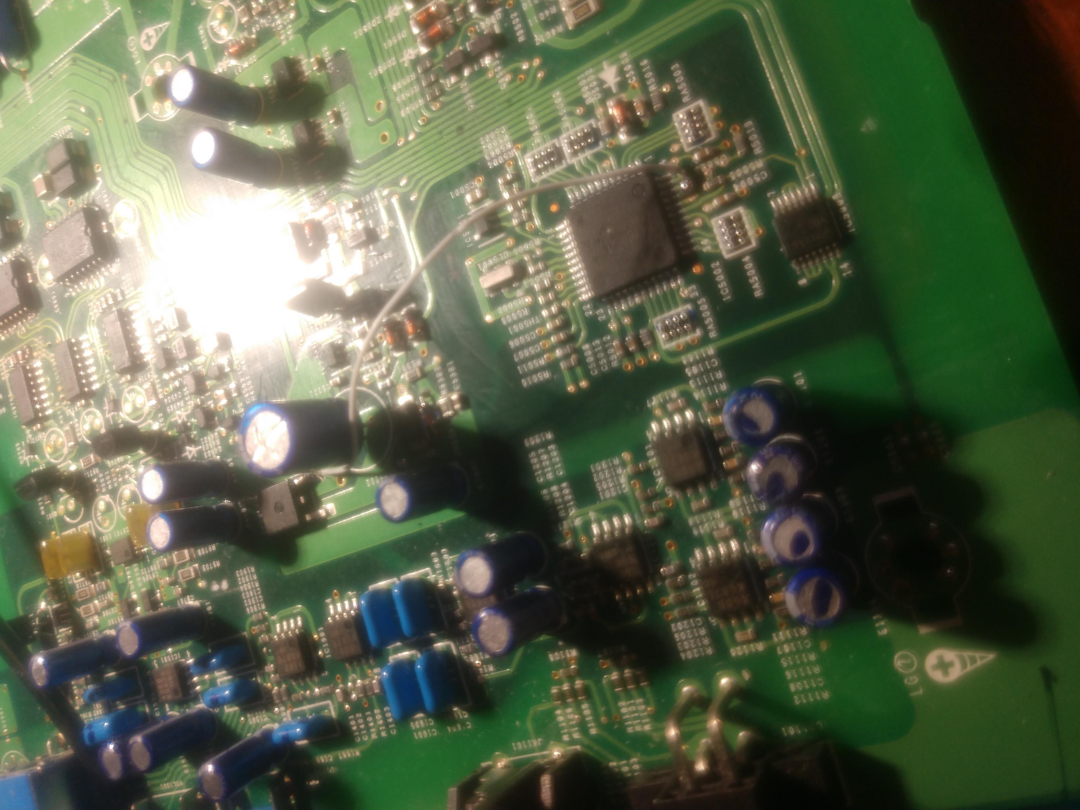

Hey guys, I know there are a lot of threads on this amp, and I have read all of them I
Could. I am having problems getting +vcc to the tl494 to get a square wave. I'm guessing something in ic5002 has the +vcc blocked. All pwr supply and output mosfets are out of the amp. I replaced both voltage regs. I replaced ic5201(battery detect). any thoughts?

Well... I jumped Q9101 and got power to the TL494 but still could not get a square wave. So then I realized that IC5002 has a tl494 control (pin41), which had 0v, so I ran a 5v jumper to pin 41 and now I have a square wave and I got the power supply back up!
Picture of jumper
With Q9101 jumped I had +vcc to the tl494 but still no square wave, also all the pins on ic5002 were the same, no change. Once 5v was applied to pin 41 the tl494 produced a square wave. I won't know if I have audio or not for a couple of days I only have 4 irf3415s and had to order more from mouser, I will have them Monday.
