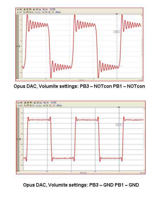

Volumite settings and measurements
There was a deleted picture posted by IO because of his post seemed out of ongoing topic. I repeated some of his experiment, using 1Khz/0 Db square pulses. My results confirm Russ's interpretation, there are remarkable effect of filters of Opus (in case of squre pulses). The first picture corresponds to Filter 4 and the figure on the bottom is shows Filter 1. Clearly seen why some of us would better prefer the later one. The balanced outputs of Opus + Volumite were used (+ default Elna Silmic II caps). There was no difference in between filter settings using sinus waves. Cheers, János
Make sense. And thanks for the pictures.
(Not sure what you label as filter 1 and filter 4)
According to the volumite code published by Russ and the latest WM8741 data sheet,
The volumite setting setting for photo 1 is for OSR low and filter 2: "minimum phase soft knee". Minimum phase reduces pre ringing and increases post ringing as you can see in the photo. "a lot of people" think this is "better" because it has less pre-ringing
The volumite setting for photo 2 is OSR low and filter 4: "linear phase apodizing". Linear phase has preringing and post ringing (as you can see in the photo). Apodizing means it rolls earlier than 20K, so you may loose some of the HF information.
