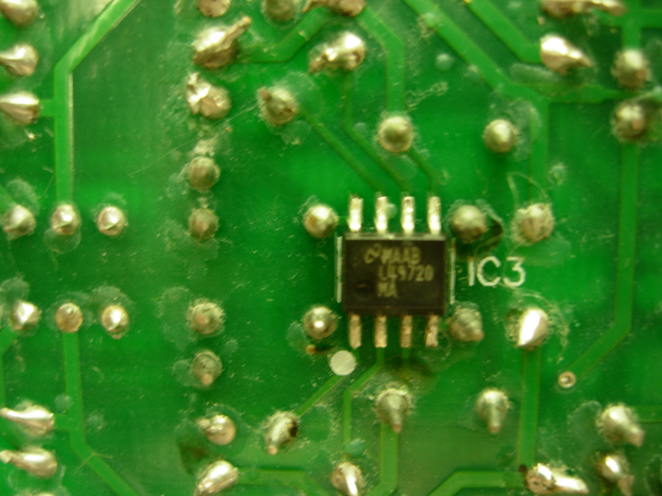

I checked around IC3, I reflowed the joints because they looked kinda crappy. I also looked around at all the joints, some not the greatest but seem ok.
I also checked what I could as far as correct parts. The only thing I question is R13, 14, 15, 16. according to the schematic they should be 2K for stereo and 1K for dual mono. As of now they are 1K. I don't know if this is a problem.
Still the same result, no volume.
The only reason I am not running dual mono is because I didn't know if I could just use + and G from balanced mode without hurting anything.
As I am sure you could already tell I am a rookie at all of this, and I apoligize for being a dumb***. I am learnig very slowly. Only started with diy audio to keep my old brain more active with something I didn't know anything about. What's interesting to me is that I don't even get frustrated or p-off about any problems I have with electronics.(unlike my day job)🙁
Just another learnig experience. 😉

I would look at the IVY. Make sure the relay is activating. The the voltage into the IVY is too low the relay will not activate.
Also check the that relay is not in backward.
If it is not your output will always be shunted to GND.
One other note. When using the IVY you can short the output caps on the Opus. I usually omit them and just use wire jumpers from clipped resistor leads or such. You will get better results this way. I highly recommend it.
Russ, I finally got back to working on this. After closer inspection I believe you were correct with your first diagnosis, the relay had 1 leg not connected. I desoldered it and it had a broken leg, I suppose it was me being ham handed.
I will order a replacement and post results when replaced.
Thanks again for pointing me in the right direction.
jim

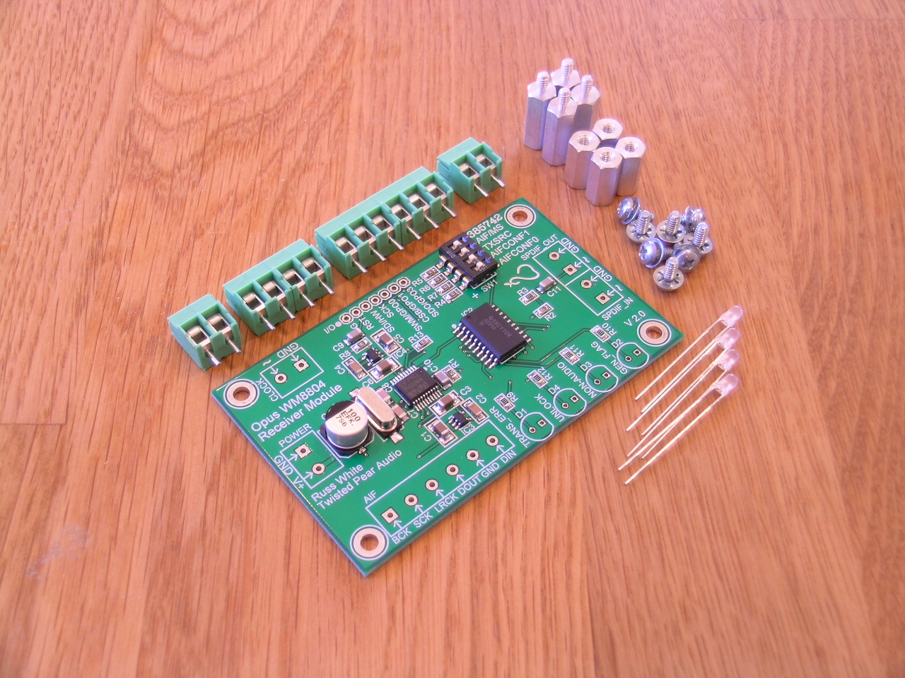

Hi
I'm reading this thread and find the Opus dac and WM8804 receiver module very interesting.
I've readed the WM8741 and WM8804 data sheet. But I'm not a digital gear geek.
To help me to better understand the data sheet, I have questions.
For the WM8804 in the data sheet, which pin number are for the AIFCONF1, TXS, AIFCON1, AIFCON0 ?
And for the WM8741 in the data sheet, which pin number are for the I2S, DM1, DM0, MUTEB, MODE, IWO ?
I found those setting, they are the standard setting for a Opus dac module with the WM8804 receiver module ?

Hi
But for the WM8804 in the data sheet, which pin number are for the AIF/MS, TXSRC, AIFCON1, AIFCON0 ?
In the TPA website, the wm8804 receiver module manual there are the setting.
AIF/MS - HI
TXSRC - LO
AIFCON1 - LO
AIFCON0 - HI
I think that it good to understand a bit the data sheet before doing the wm8804 receiver and Opus dac modules wiring.
Thanx
Paul
Hi
So, to be sure I understand ok.
To correspond to the data sheet, the pinouts for those settings on the WM8804 chip for the the wm8804 receiver module are :
AIF/MS - HI --- are pin 1 on the WM8804 chip (SLK)
TXSRC - LO --- are pin 5 on the WM8804 chip (CSB/GPO1)
AIFCON1 - LO --- are pin 2 on the WM8804 chip (GPO0/SWIFMODE)
AIFCON0 - HI --- are pin 5 on the WM8804 chip (SDOUT/GPO2)
Is it correct ?
